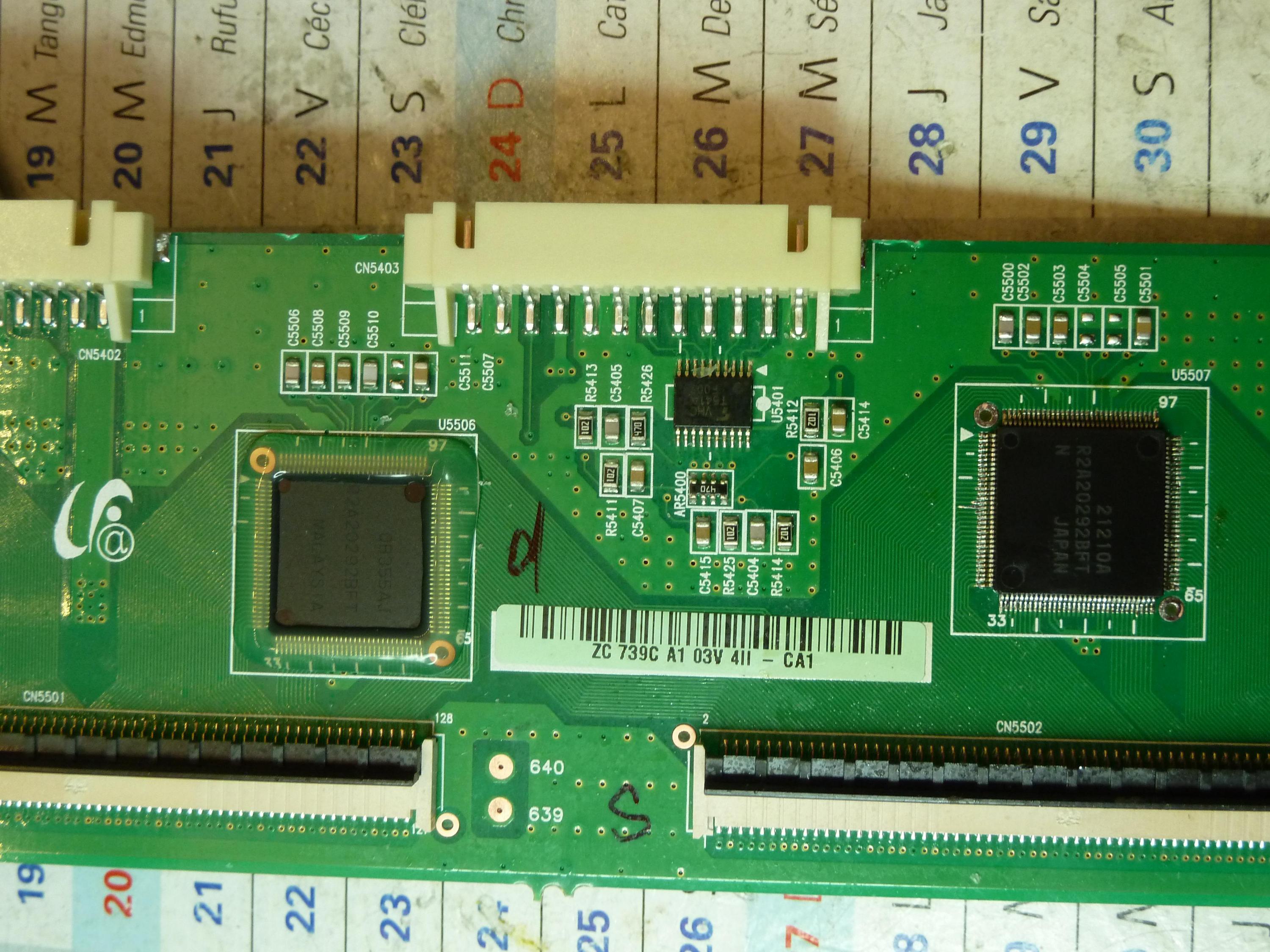

      Hi All,
      Replacing these Buffer IC's is a nightmare specially, (as I do), if you use conventional soldering tools.
      You have to work with patience and very carefully, using a correct magnifying glass.
      Before starting, you should consider the following :
      1) There are several Y-buffer IC's vertically arranged on board(s), each IC driving a corresponding horizontal image stripe.
      2) The first driven IC is usually the top one, each following IC being driven by its upper neighbor.
      3) The input IC pads are usually located at the center of on one side of the IC oriented towards the connector(s) going to the Y-sustain board. All other pads located on the four sides are outputs going to the panel connectors (easy to check following the PCB tracks).

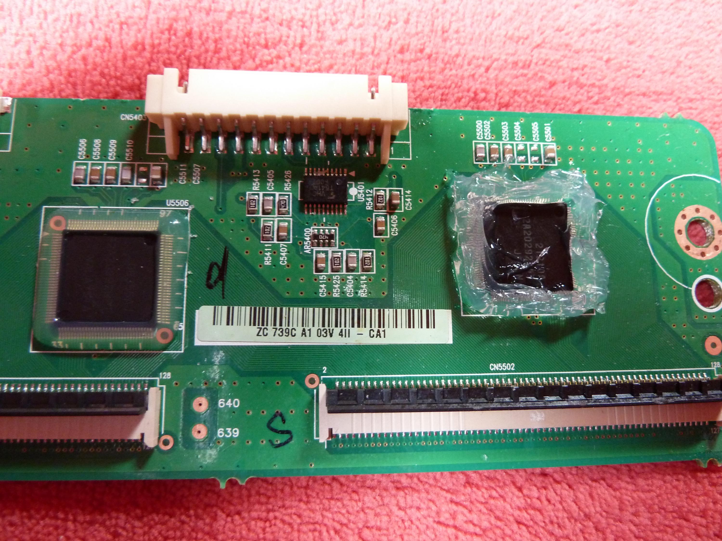

      Removing silicon glue above the IC pads :
      It is essential to remove as much as you can this glue before starting to desolder. You can use a special silicon removal paste (plumbing toolpaste).
      Clean carefully with isopropyl alcohol after process done.
      Desoldering :
      1) Desoldering the IC's is quite impossible without hot-air because of the center thermal pad located under the IC. I personallly use a hot gun (paint stripper) through a metal cache to avoid small other components to melt or desolder. You can use solder flux to ease solder melting.
      2) NEVER APPLY STRONG FORCE WHEN REMOVING THE IC FROM THE PCB TO AVOID DESTROYING PCB TRACKS. REMOVING MUST BE VERY EASY IF IC IS HOT ENOUGH.
      3) Clean very carefully IC pads on PCB removing as much as ou can solder residue in order to have a flat surface under the IC. Use solder flux and desoldering wire wetted with flux. Try to avoid sliding the desoldering wire perpendicularily to the pad tracks, but it is OK in the direction of each pad track.
      4) Check that no other component has been unsoldered when the hot-air was applied. If so put them back on place.

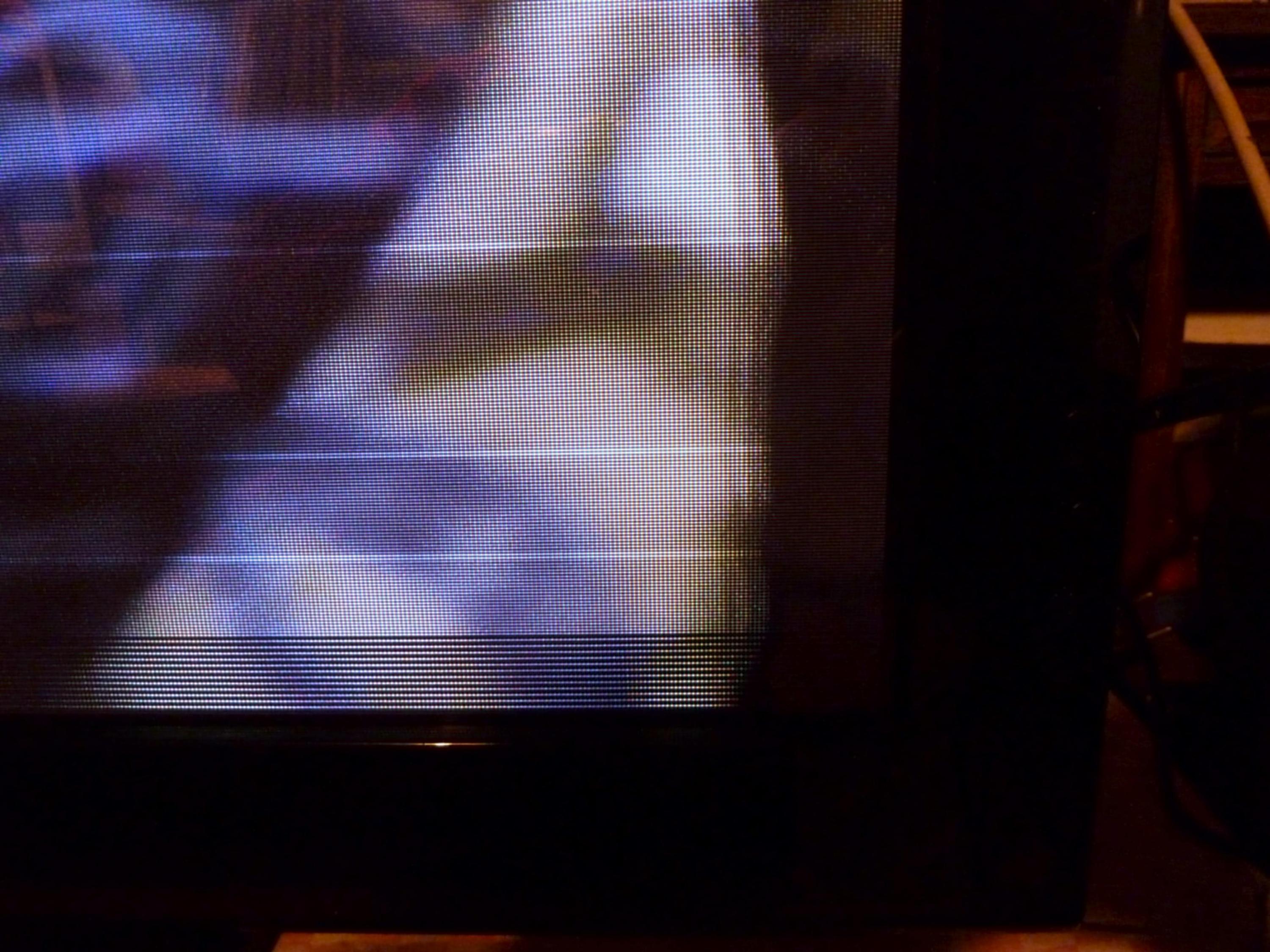

      3) Assuming the image above the section driven by your IC is good, An image stripe corresponding to your IC position should be displayed.
      -If all black, you input pins are not connected.
      -If correct, you are lucky, ready to proceed to the next IC.
      -If the image is all fuzzy, check your input pins.
      -If image can be identified but is not all correct, consider the following :
      >Black lines correspond to unsoldered pads.
      >Uncorrectly displayed set of consecutive lines (mixing colors/content) indicates shorts between IC pads.
      4) Unmount the buffer board and use solder flux and desoldering wire to achieve correct pad's soldering, try again.
      The above figure shows opened and shorted pins.
      Working on the IC solders and repeatedly checking this way should allow you to get a good result.
      Proceed this way for each IC to be replaced.

      Then, when everything looks OK, clean very efficiently the PCB and the IC's with alcohol and apply Silicon glue (I use plumbing silicon joint paste) all over the pins and pads of the IC and PCB to avoid dust and humidity to reach the pads in the future. This prevents future shorts or arcs between pads.
      Let it dry for several hours before appliying power again for fianl vérification.
