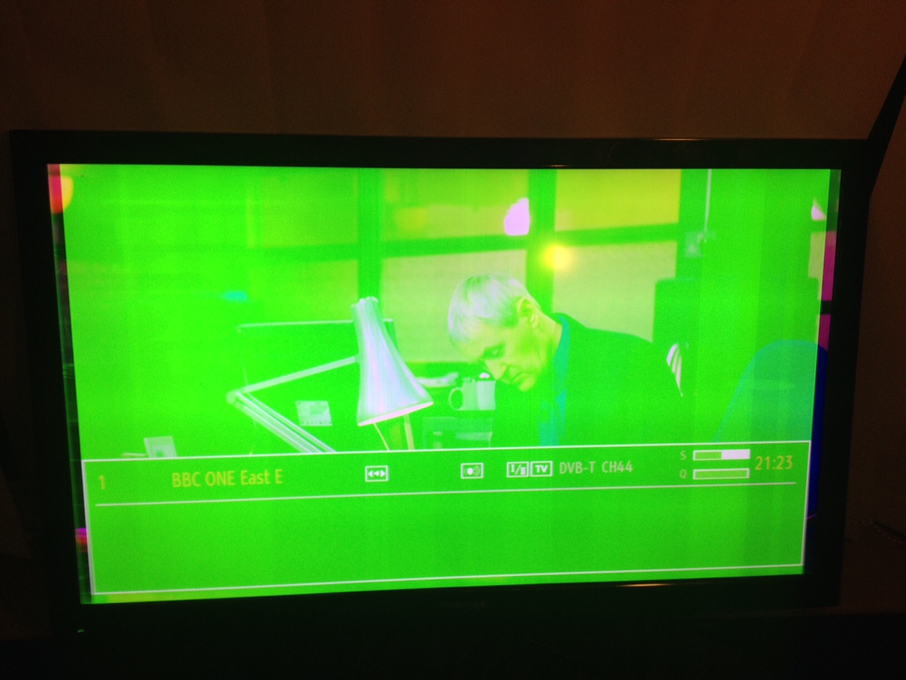

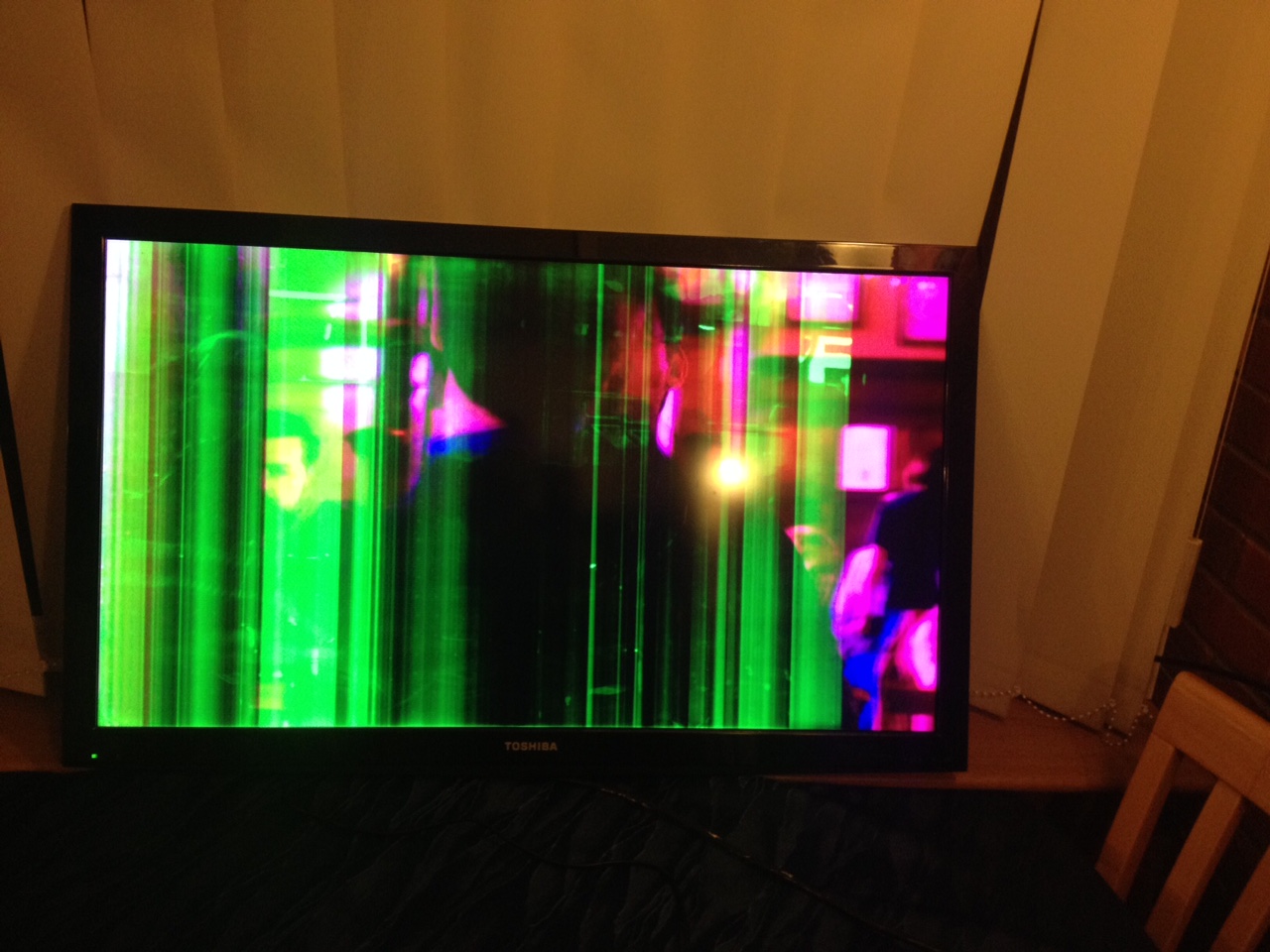

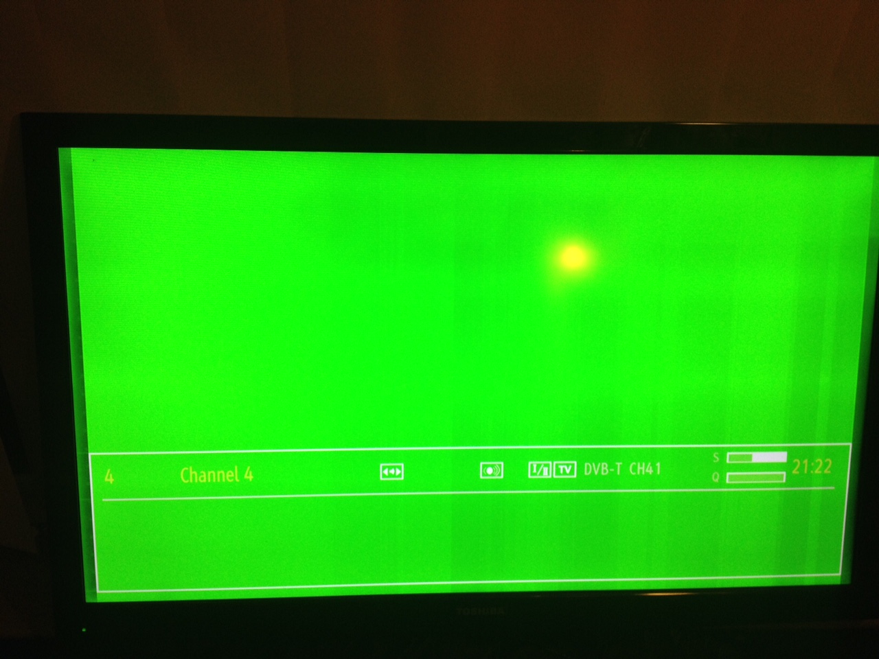

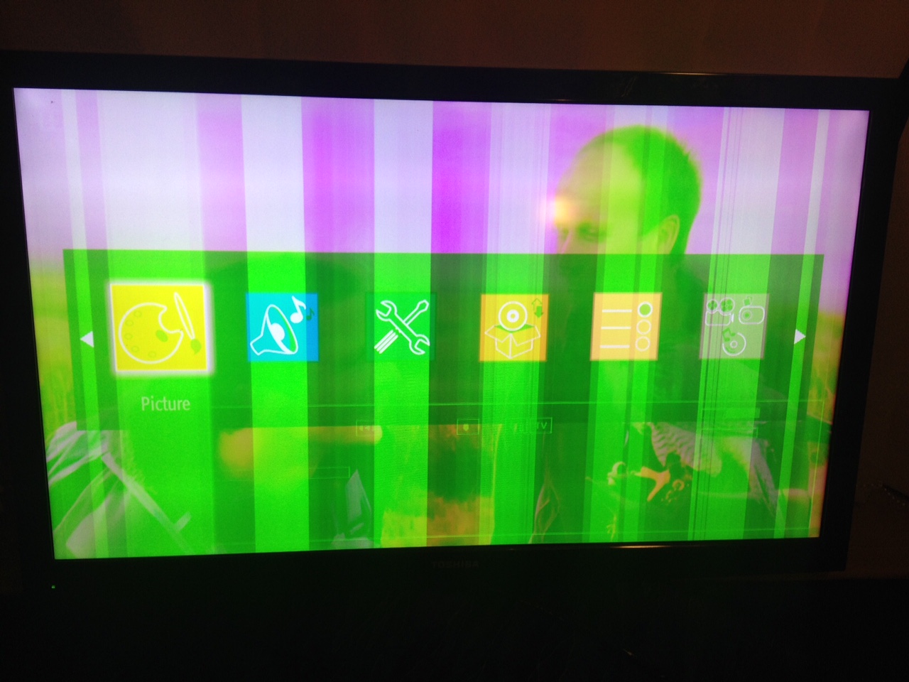

      Hello,I have a problem with my Toshiba 40BL702B

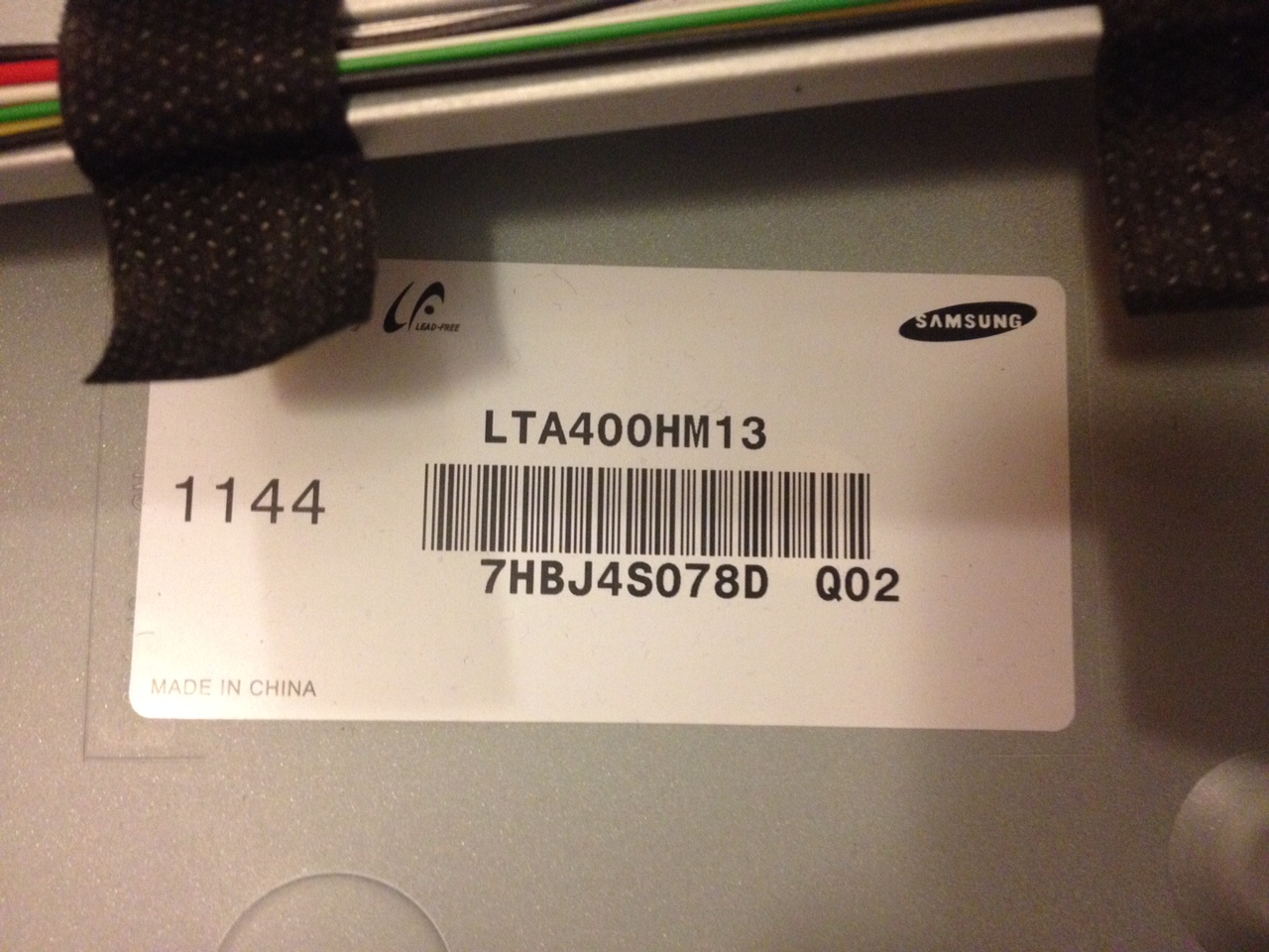

      Screen model : LTA400HM13
      Could be the problem with the main board 17MB65S-2 giving me this green colour picture ?
      Sound and other functions are fine.
      Any help would be much appreciated .

        I would say this is a defective LCD panel most likely, though it is hard to be certain.

          Yep failed panel, them Hm** panels are total trash very high failure rate. Seen several failed in the same way.

            I have try to start Gently press each film line as to make the picture complete but nothing happens .
            Is this main board have like a T-con IC Driver ?

              Its a bad panel IMHO seen too many of these fail in the same way.
