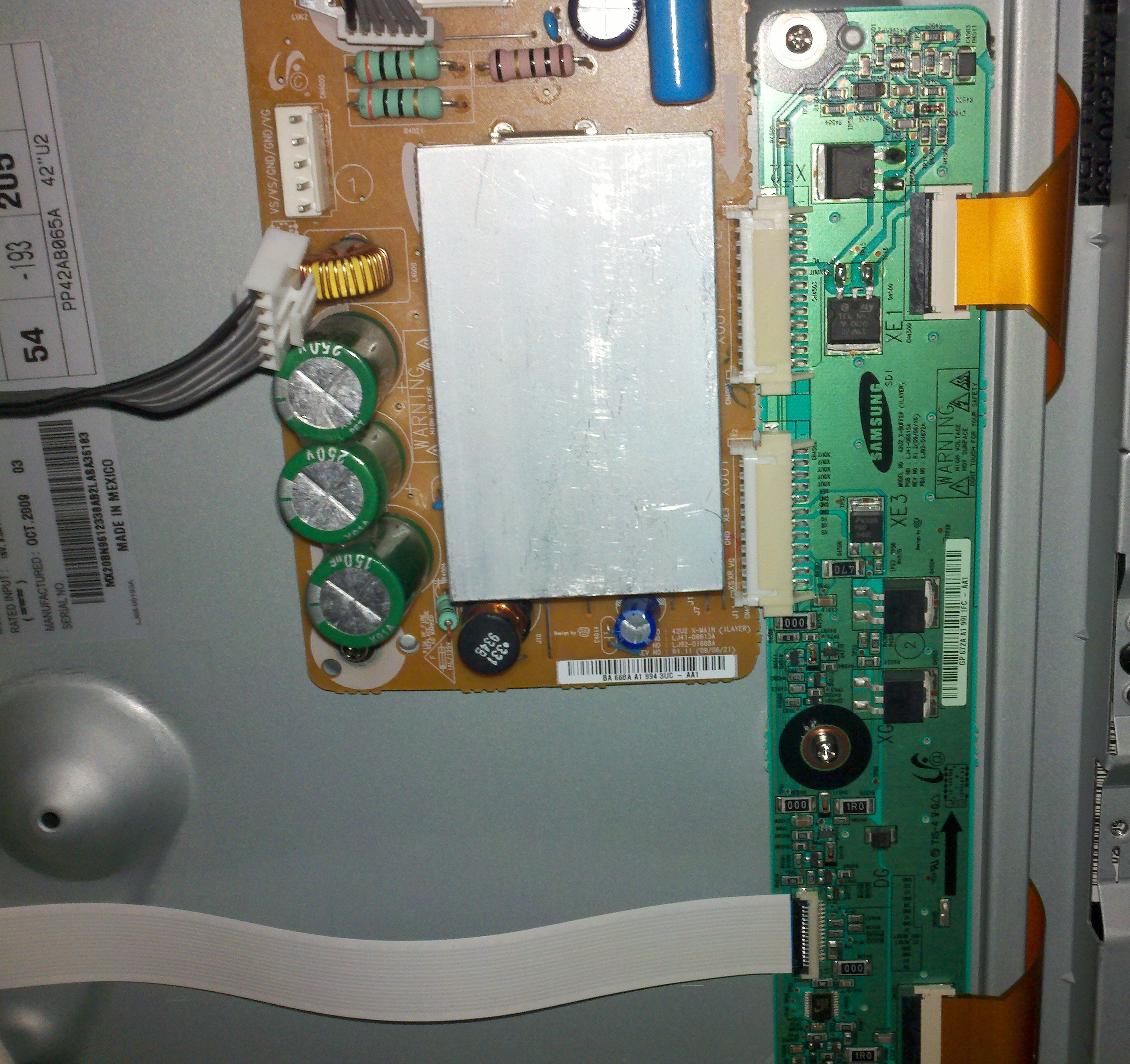

    I'm working on a Samsung plasma (PN42B400P) that has sound but no picture.
    Here is the sequence of events to this point and some tests I performed:
    Sequence of events:
    (1) SMT component on Y-main was broken by previous owner who removed the Y-main and X-main, so I replaced the Y-main (ShopJimmy).

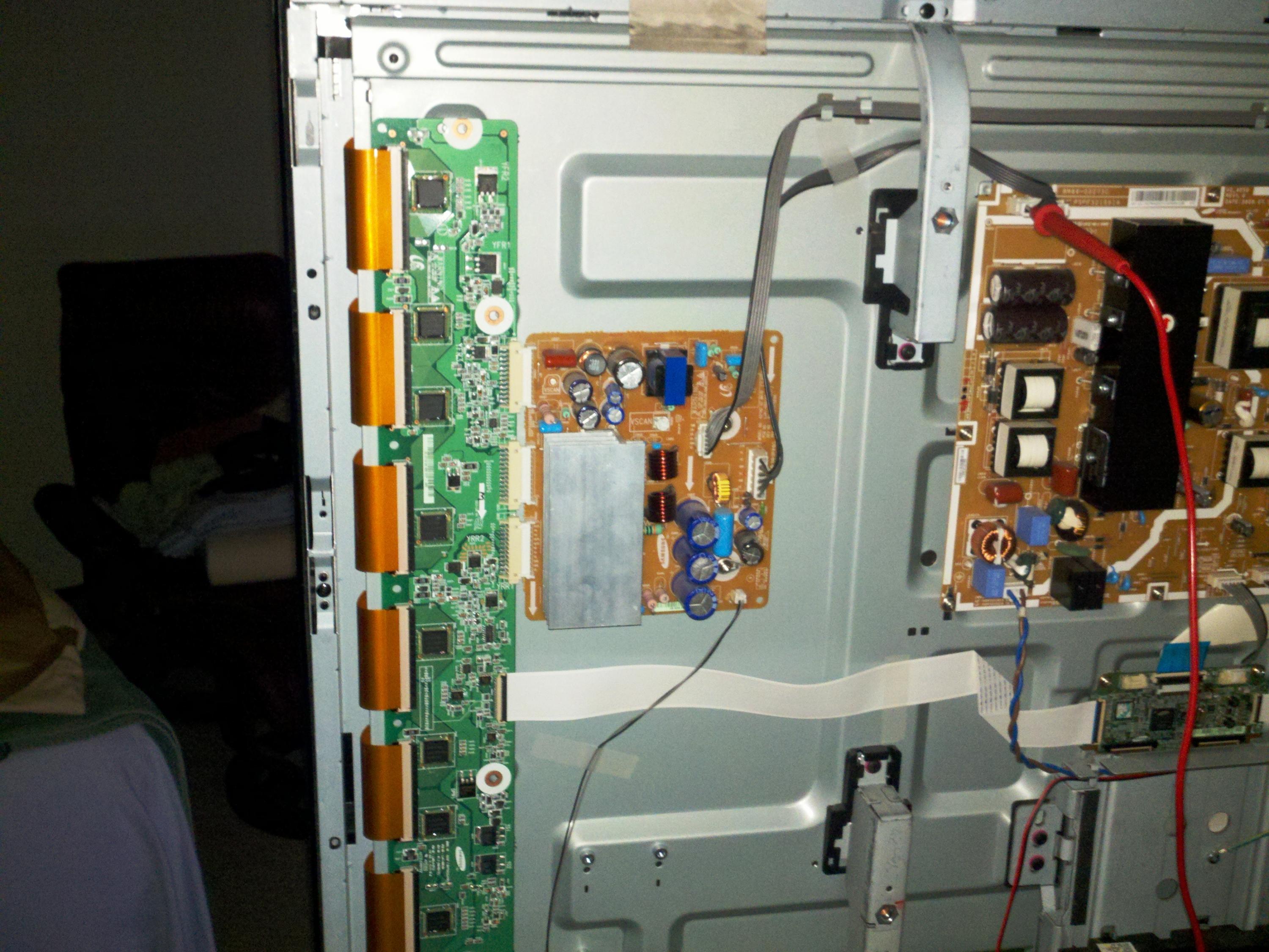

    (2) After replacing the Y-main, the VS and VA voltage would drop when the powering on the TV. I disconnected the Y-buffer - voltage stayed up.

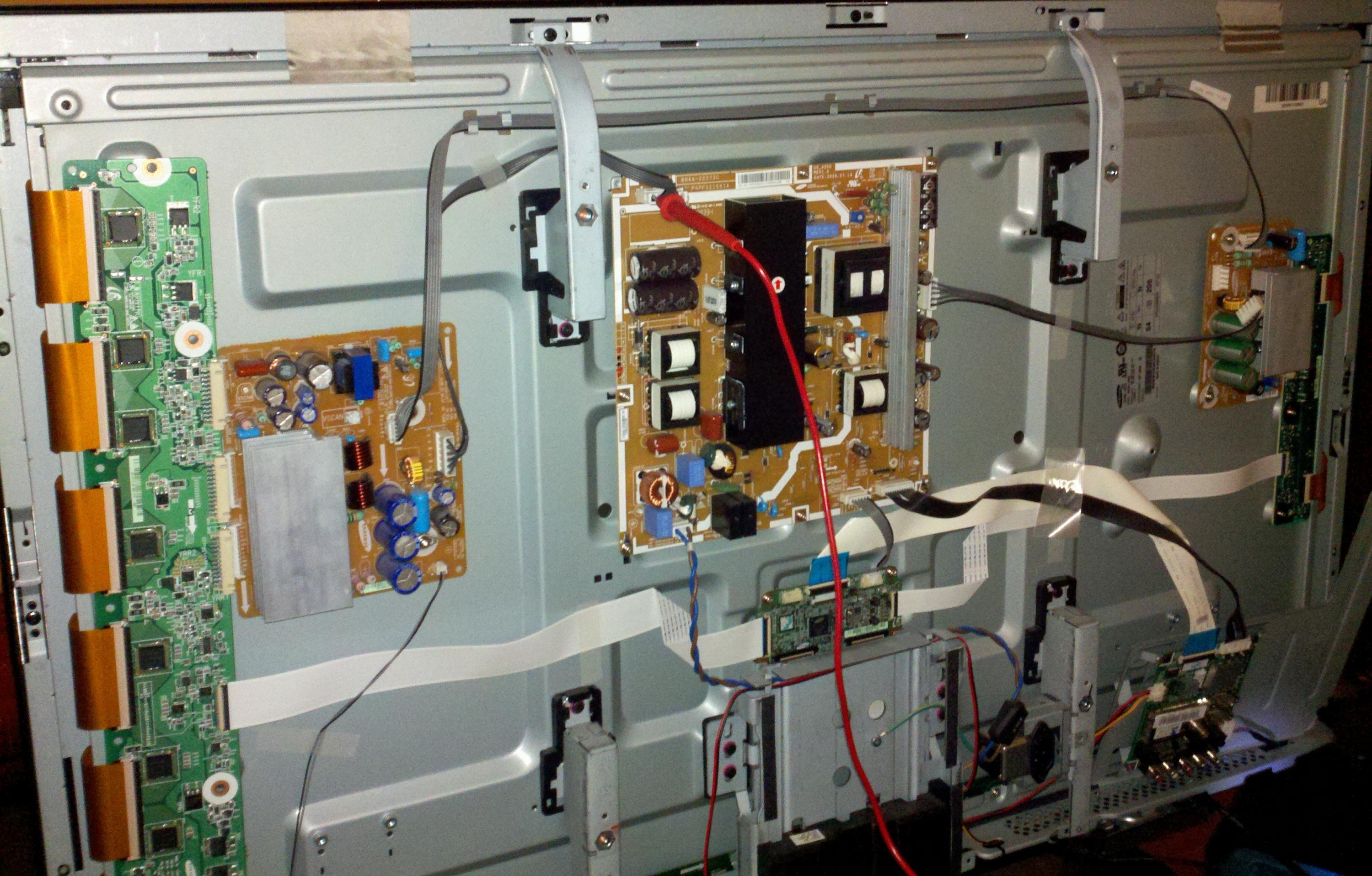

    (3) I replaced the Y-buffer (ShopJimmy), but I still got no picture. I then noticed that the 1A 125V pico fuse for the 15V circuit on the X-main was blown (not sure if it was blown when I picked up the TV). I replaced the fuse and continued on with the following tests:
    (1) Power supply only - VS, VA, and 15V stable
    (2) Power supply and Y-main connected - VS, VA, and 15V stable
    (3) Power supply, Y-main, and X-main connected - VS, VA, and 15V stable
    (4) Power supply, Y-main, X-main, and X-buffer connected - VS, VA, and 15V stable
    (5) Power supply, Y-main, Y-buffer, X-main, and X-buffer connected - VS and VA voltages dropped. 15V remained stable.
    Any ideas? Could I possibly have a bad panel?

    So the VS and VA dropped when you have everything connected. Disconnect the flex ribbon cables going into the panel from the Y buffer board and see if the voltages stay up. (Obviously disconnect with the set powered down). Wouldn't leave it powered up very long like that.

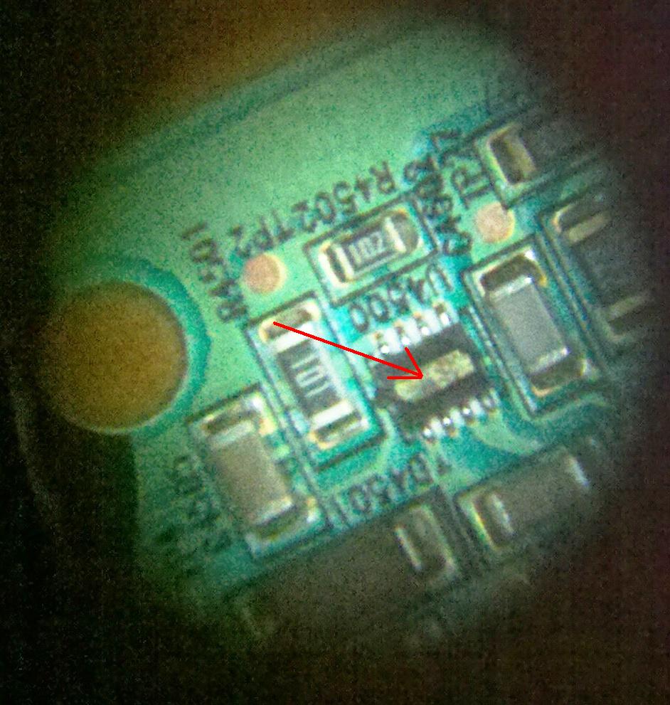

        Ok, I found about six components that were bad on the X-main. Dummy me...I fell into the lazy trap of just replacing the fuse in the X-main without checking the board's components - thought the VS and VA voltage drop was caused solely by a bad Y-buffer I also found a blown component on the X-main buffer (top blown off it). This is turning out to be a more expensive repair than I figured.

                    Samsung must be churning out some junk TV's in recent years. I picked up my 5th of these thin-profile Samsung TVs today. It was evident that the Y-main was bad, as there was a burn mark on the back side of the panel under the Y-main. I found something like 8 shorted components on the Y-main, including two badly burned SMT resistors and a burned SMT cap.
