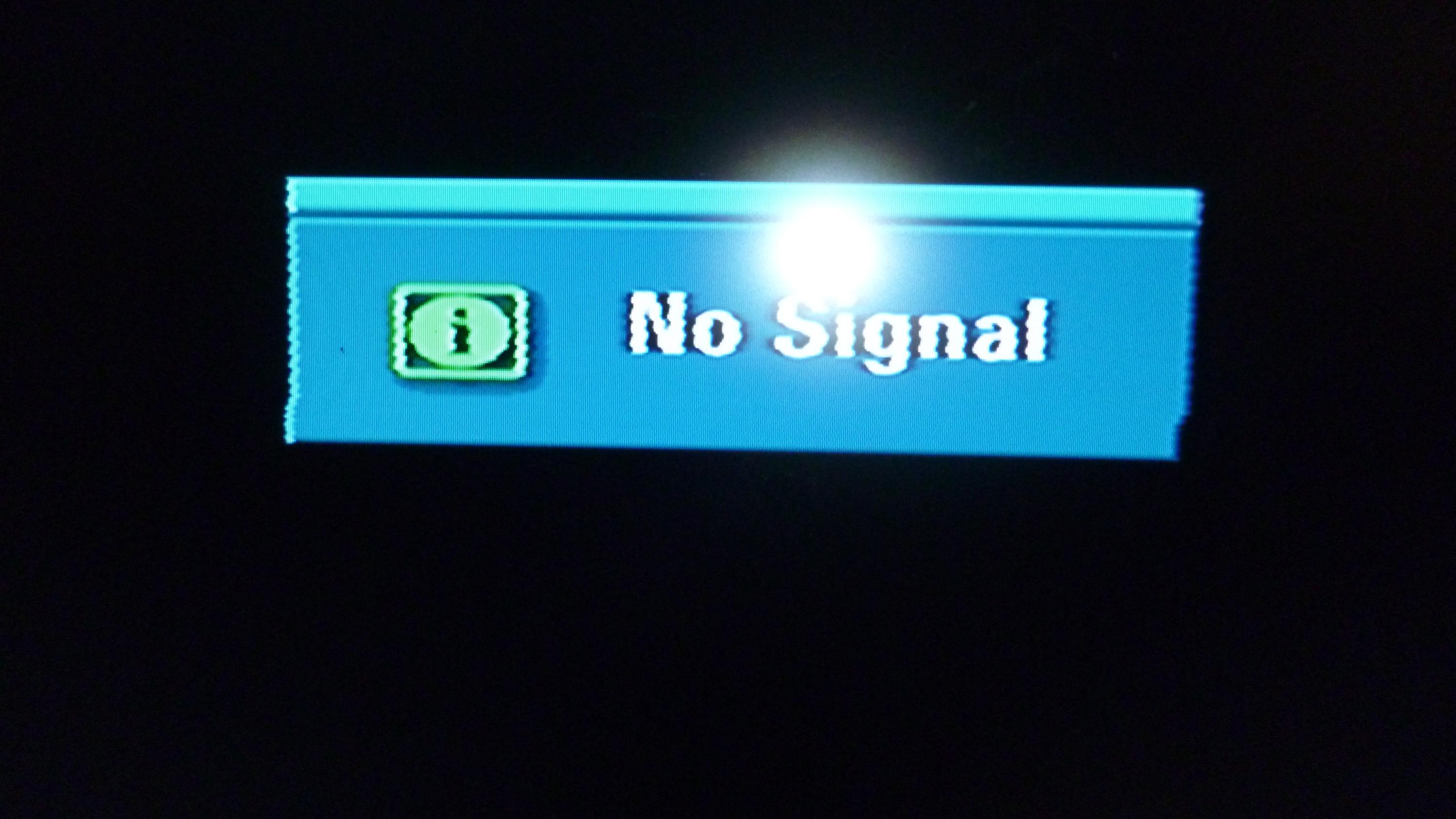

                        Tom66 just to update you, i was half way through doing the pins there and tv has stayed on for a few minutes and turned it round and was faced with a picture on the screen, fuzzy though i have attached a picture if it helps but will post results of pins as soon as im done

                            ok there are 2 leads going to mainboard, after i posted that picture and finished the pins the picture has got clear and the AV board is realy warm at the top but picture isnt fuzzing anymore... so think its down to AV board Tom66 ?? is it repairable or will i need to buy new board altogether
                              exactly the same as min, if you change the input the fuzzy text fixes itself
                              found no solution for mine as of yet
                                Re: Faulty Samsung LE26R87BD, is it repairable ?
                                The rails appear OK.
                                I would switch off the TV and cool it down.
                                Then heat up parts of the main board -- hairdryer and cardboard tube is one option.
                                When you find heating a part improves it, turn the set off, and repeat the test.
