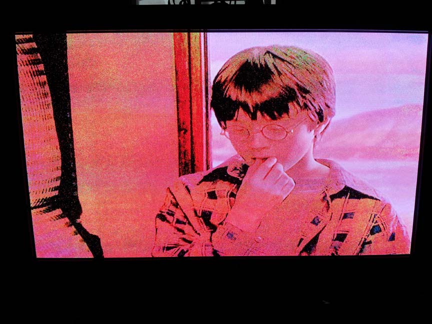

    I am attempting to repair a Samsung Plasma TV. I have already replaced a few bulging caps on the PS and Z-Sus boards. I have checked all the electrolytic caps on the PS, Y and Z-sus boards with a home-made ESR tester that I believe works, and they all test good (I removed most to insure no parallel reading effects).
    The TV fires up, but when it first comes on, there is intense color snow, as shown in the attached picture. The snow fades as time elapses, but never goes completely away.
    Any help would be greatly appreciated.

    Hmm, could be a main board, digital (main logic) board or Y-main issue. Have you checked Vset and Ve? Also, what is the model of this TV?
    See here for a self test which can rule out a Samsung main board. https://www.badcaps.net/forum/showpo...61&postcount=2

      Thanks for the quick reply.
      It's a Samsung model HP-S4253.
      Vset and Ve, as well as the other voltages on the label are "close".
      I ran the self-test and it ran fine. The display was "discolored".
      Next?
      Thanks again!

        I would suspect the control board, which is the board that has the self test function.

            Before you replace anything else, try adjusting Yrr/Yfr on the Y-main.

              I tried, but no difference.
              It seems the red is most intense, followed by green.
              It's really bad when the TV first comes on, but about 10 minutes later it's not too bad. The picture is fairly good, just a lot of colored snow.
              Still recommend the controller board?
              Thanks much!

                Perhaps not. It does seem simply like overdiffusion, too many pixels sticking. Odd colour balance is a clue, too. I would check Vset, Vscan, Ve, and Va, match them to the panel sticker. If not it could be a control board fault I suppose.

                  I did set all those voltages according to the sticker.
                  I guess I'll look for a new controller board.

                    Before buying any more boards and playing poke and hope, I was able to determine that the Yrr pot on the Y-Sus board was dirty. Now that I've cleaned it, the initial "warm-up" problem has gone away. The only issue remaining now is colored snow, especially in the dark areas of the image.
                    I found a YouTube video claiming that this problem was due to bad cap(s) in the 5V section of the PS. I checked them before, but I'm going to go back and tack in some more capacitance to see if that works.
                    Any other thoughts from anyone?

                        It's more like a color blizzard.
                        Those adjustments don't do it.
                        I'm going to replace the Yrr pot and see if that gets me anywhere.
                        I tried caps on 5.3v and Vg (15V) with no success.
