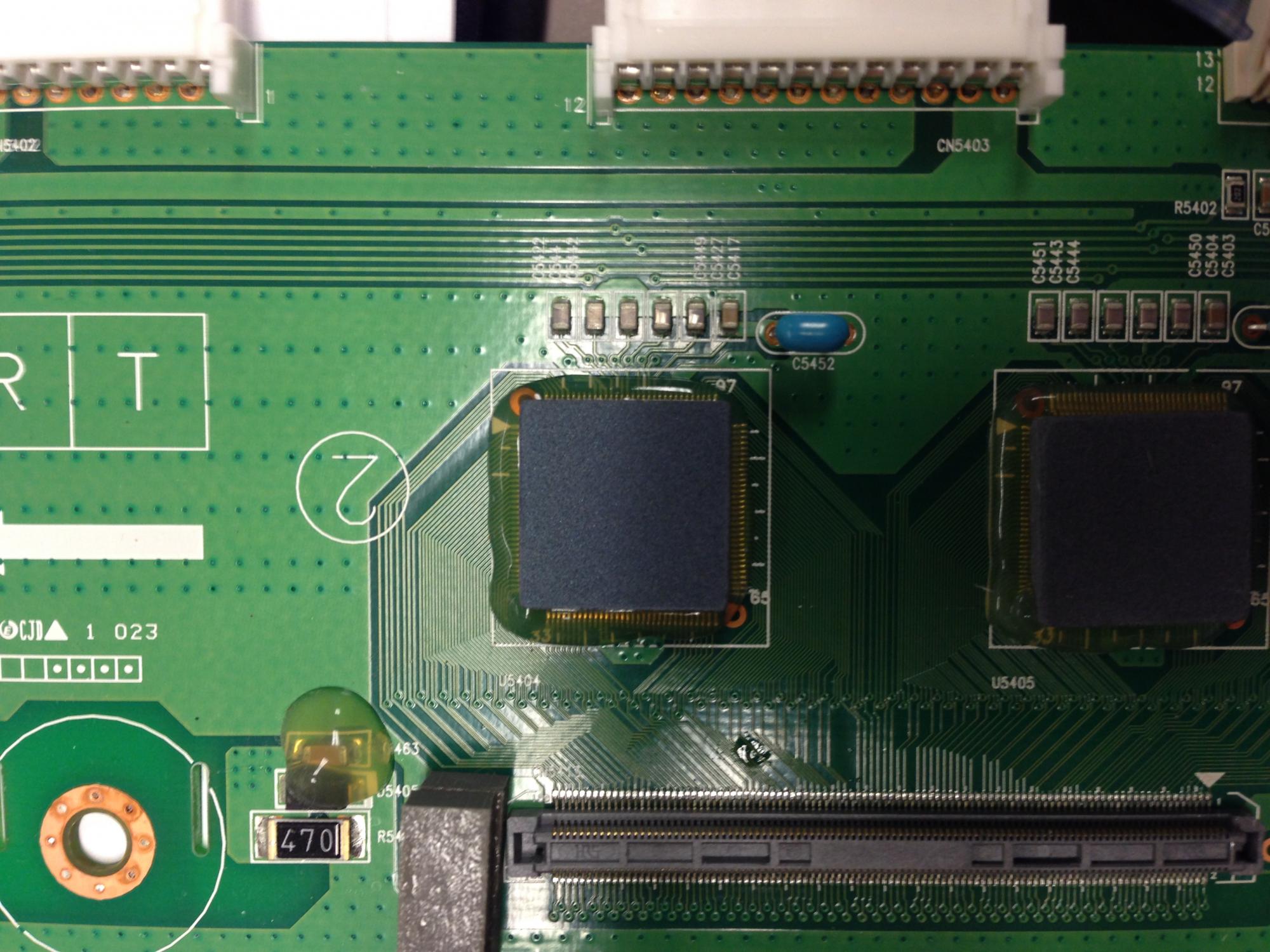

              I found the bad part on the upper Y buffer. It was a resistor marked 470. Anyone know where this exact part is sold and the actual part number?

                Re: Samsung PN58C550 Blank Screen with sound
                http://screencast.com/t/RGkQx9H0ps
                That's a 47 ohm resistor. You should be able to find it on mouser.com or digikey.com. You'll need to measure the length and width to determine the correct size (normally in millimeters or inches). You could solder on a through-hole resistor; I'm guessing it's a 1/2-watt resistor, but you may want to go with a larger wattage resistor just in case.

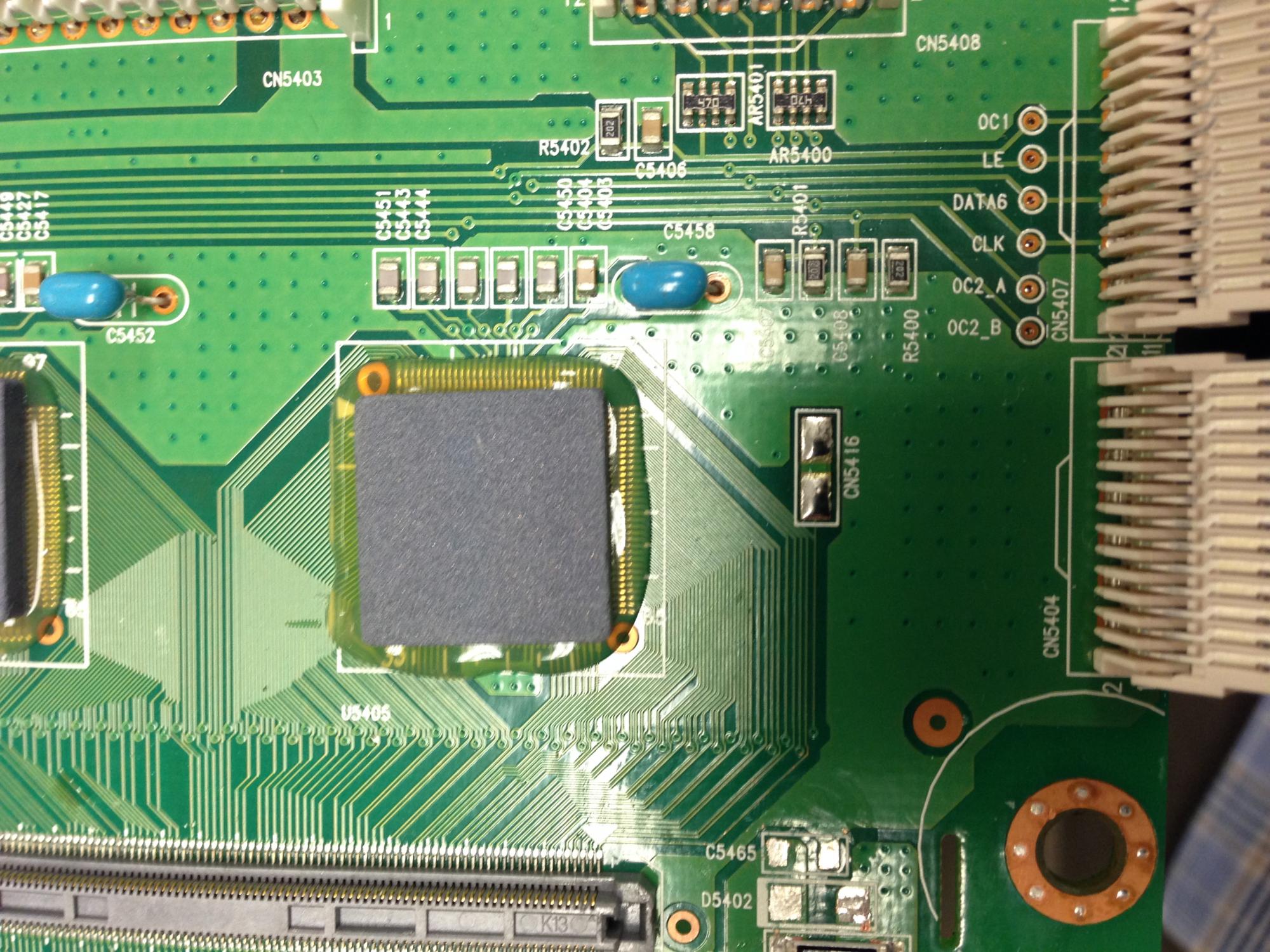

                                #35

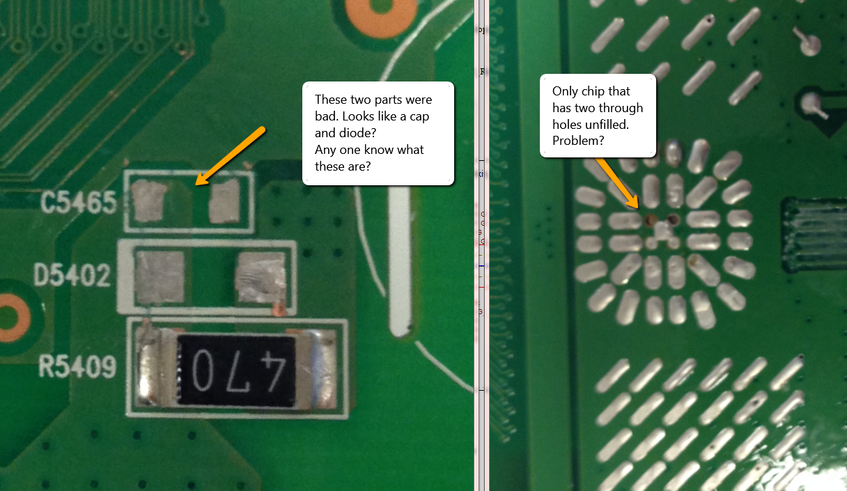

                                Ok here is a pic of what I have found. Can I easily get these parts? Does anyone know what they are exactly? Also one chip has two pin holes on the underside of the board.
                                  #36
                                  The diode will be a 1 amp, 300V or higher rated schottky or fast silicon. The capacitor I'm not sure, but if you have a capacitance meter you can measure the others in the same position (out of circuit), and then select any 300V or higher 1206 ceramic X5R/X7R/NP0/C0G capacitor of that capacitance or near abouts.
                                  The unfilled holes are unlikely to be a fault, what is more likely is the buffer chip is bad. Can you provide a closer shot of the chip? (top side)

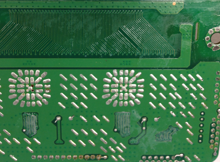

                                    #37

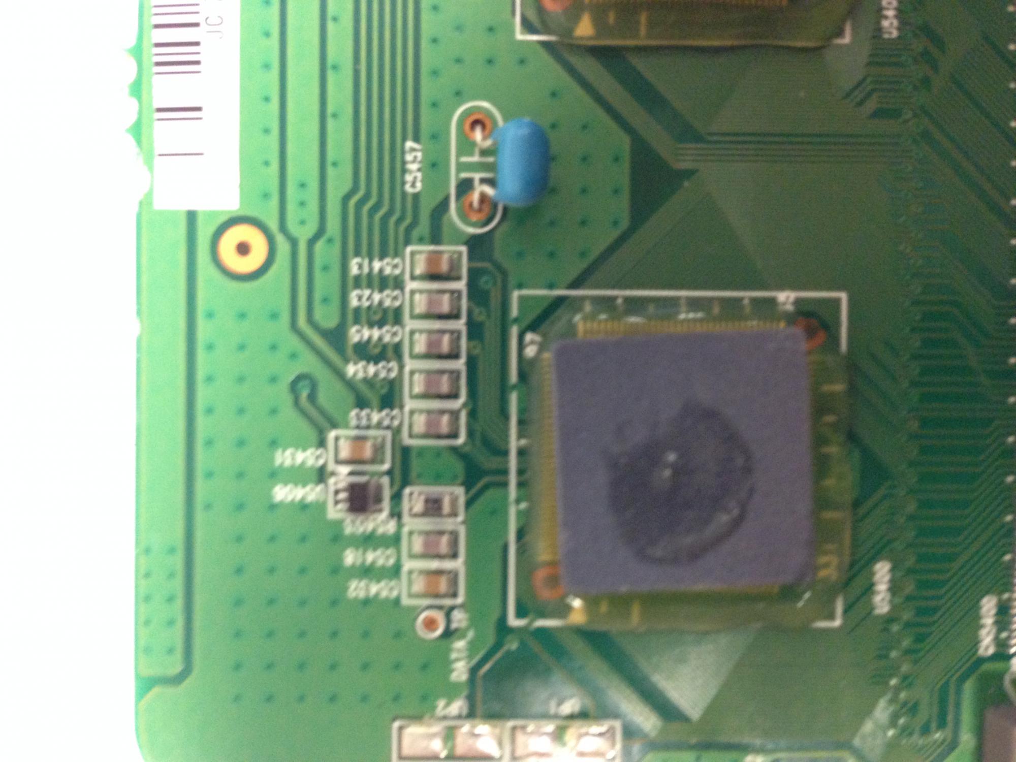

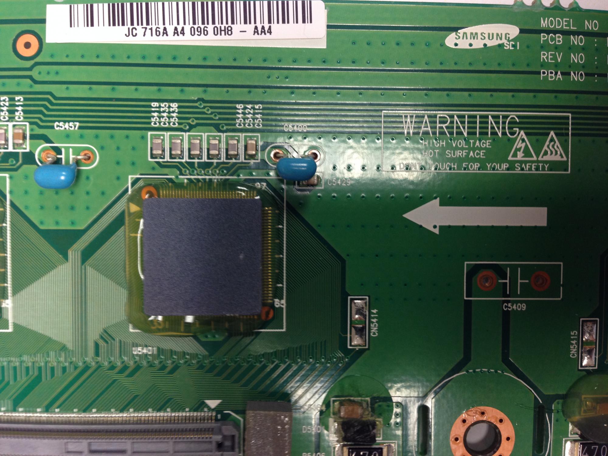

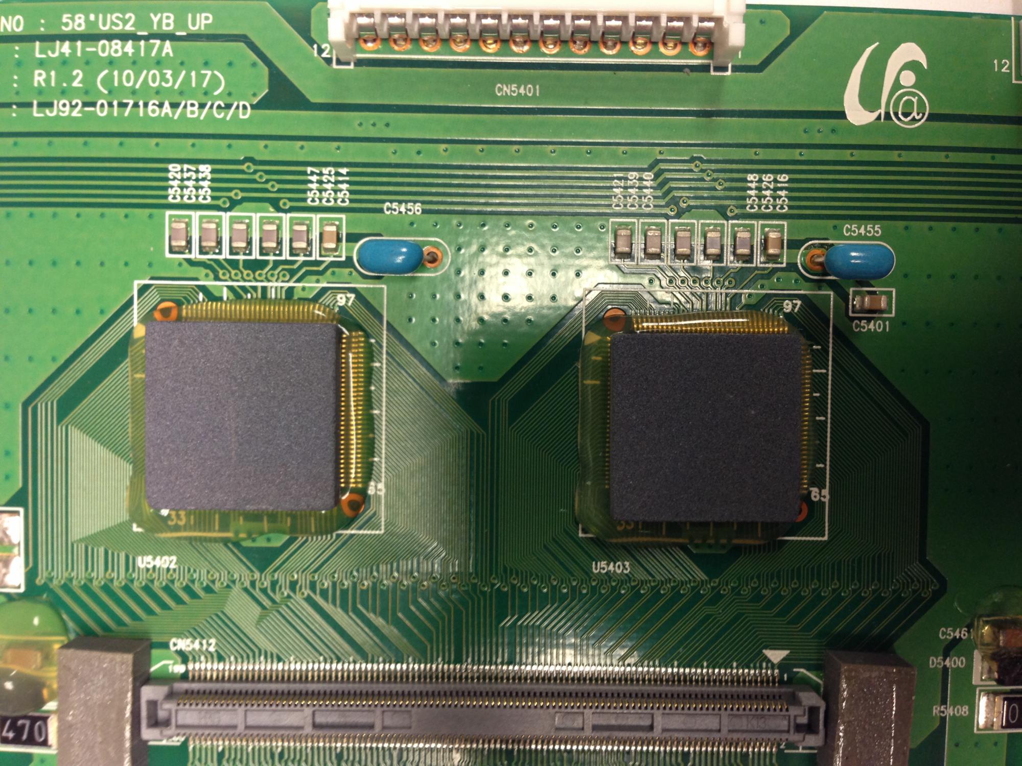

                                    Attacher are the pics. I was not sure what the buffer chip is. Hopefully it is in one of these:
                                      #38
                                      Buffer chips are the black/grey squares. Can we see a picture under this chip?
                                      https://www.badcaps.net/forum/attach...2&d=1375288571

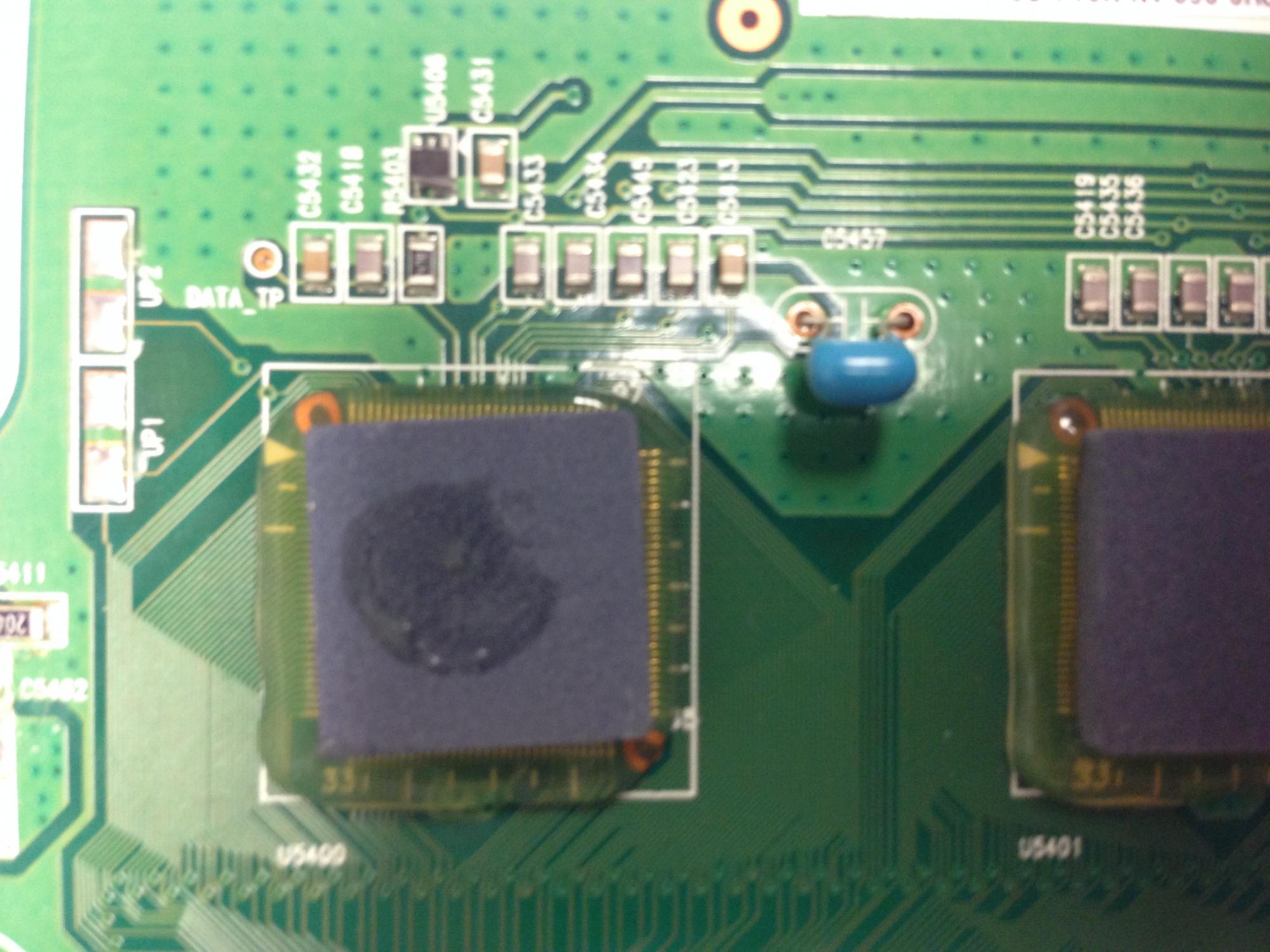

                                        #39
                                        Here ya go! Any way to test the chips with the blown cap and diode? Please let me know what the verdict is and if I should just buy a new upper board.
