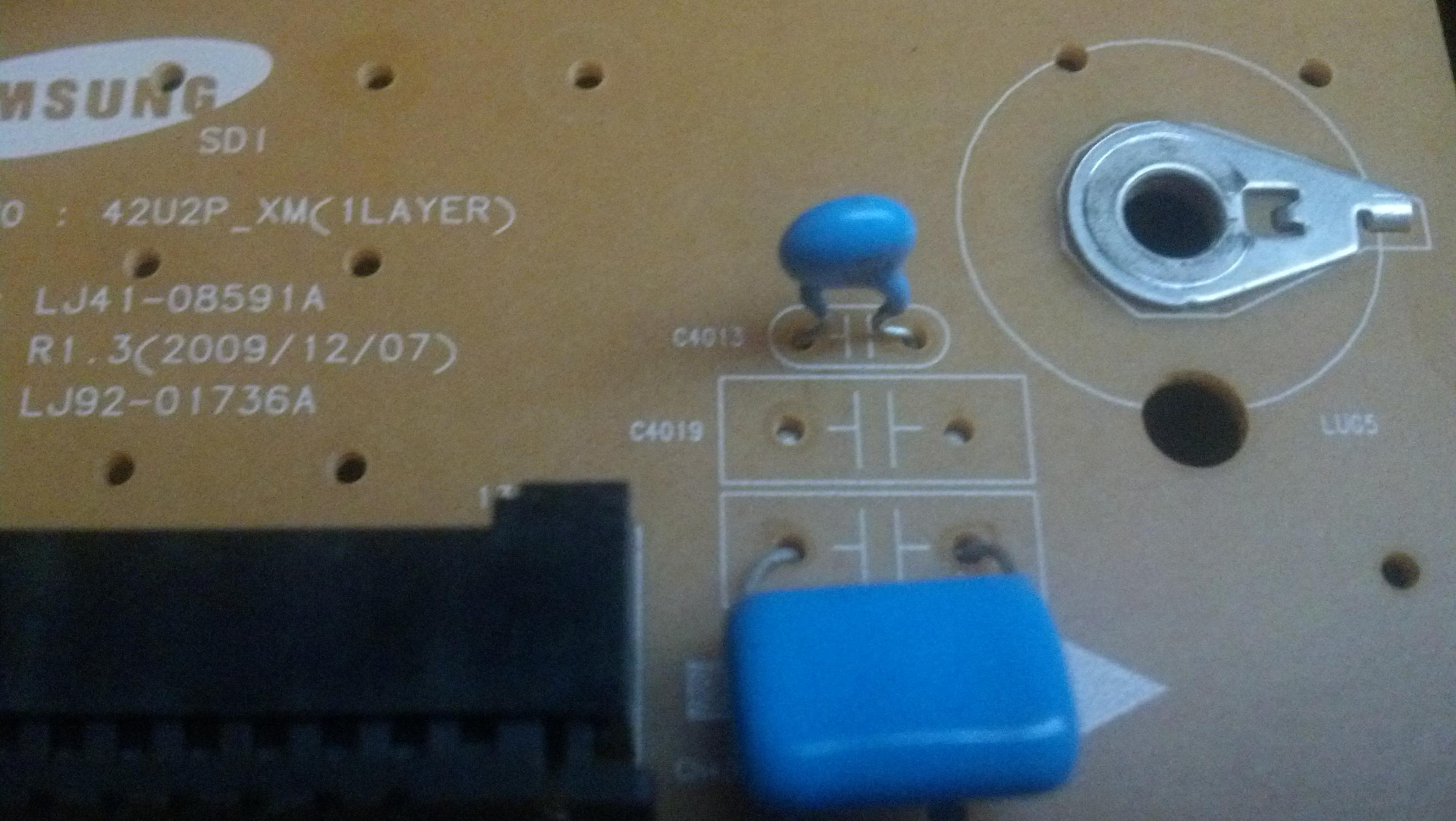

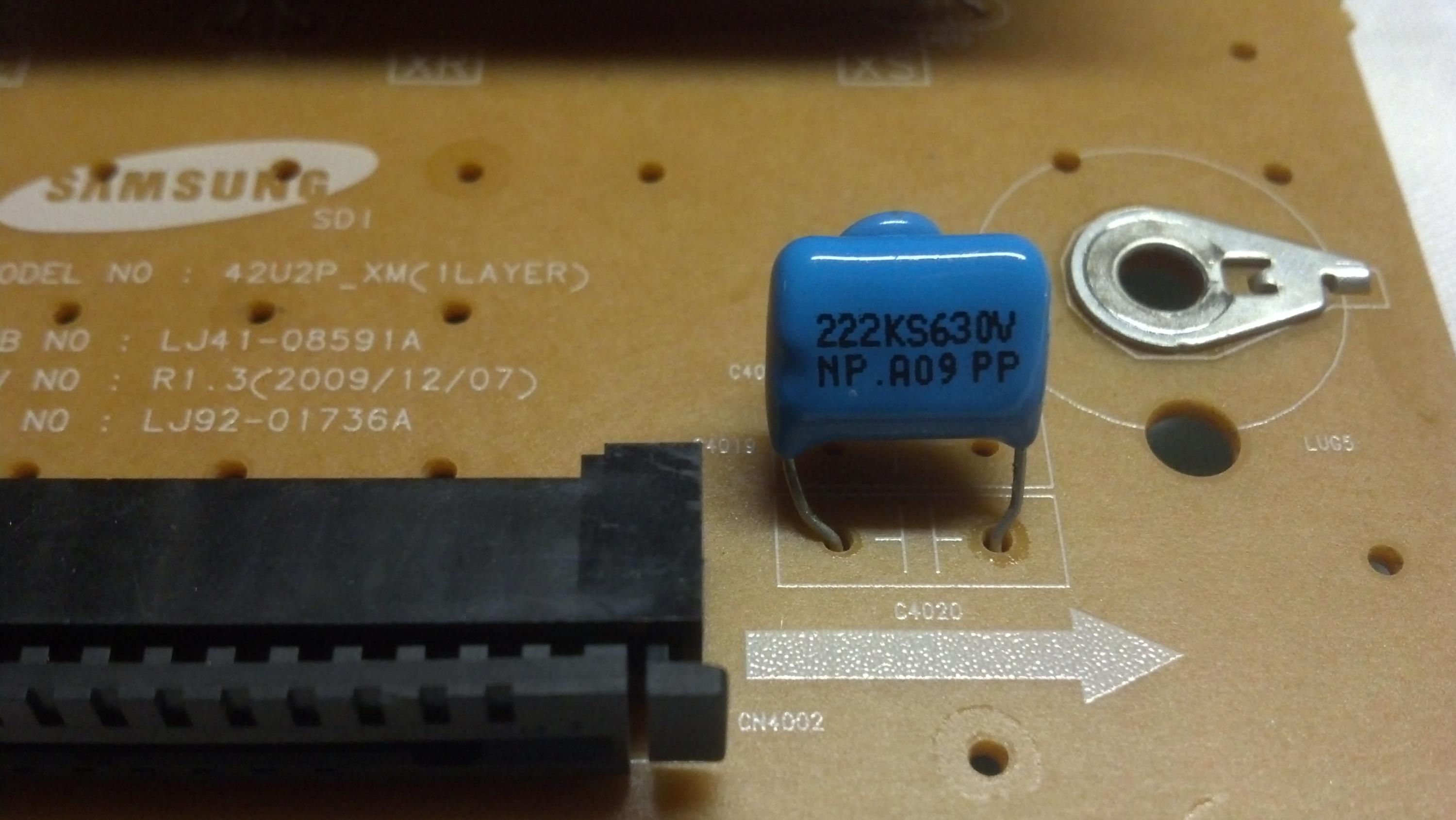

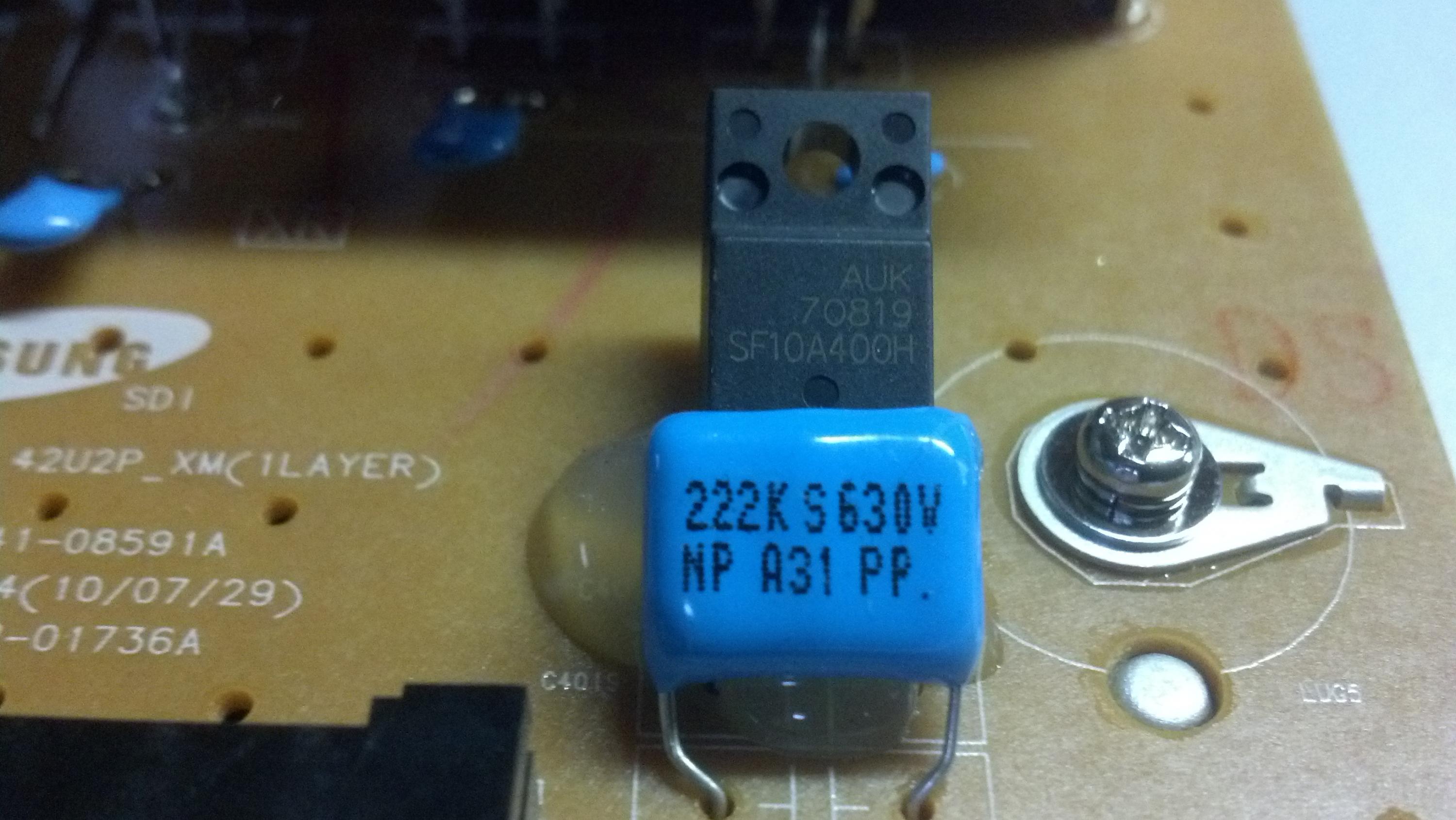

                            I just wanted to update this. I received the replacement Buffer and X-Main. TV has been working great for the past 3 weeks. Thanks again to everyone on this great site.
                            One other thing I noticed on the replacement X-Main I received is this one has a SF10A400H Ultra Fast Recovery Diode in location C4019. The original that came out of the tv and the 1st replacement board did not have this. The new replacement has a newer date code then the other 2. Any thoughts that this may be a revised board since these X-Main's have so many problems?
                              Re: Rca 42PA30RQ No picture Multiple clicks
                              It's probably to provide extra protection to the main FETs.
                              Did you apply the software update to the TV? Is it even possible on an RCA plasma?
