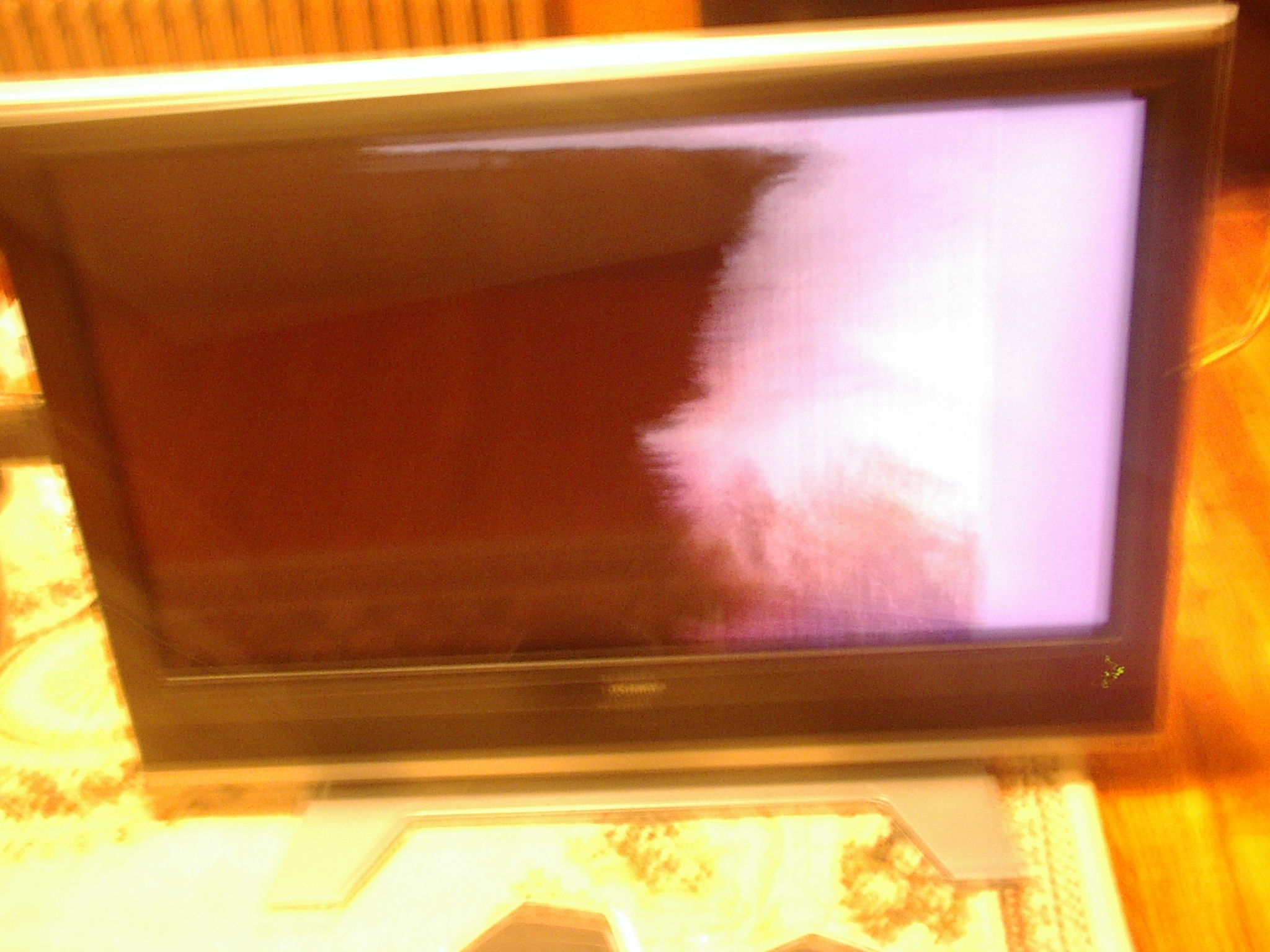

    i have seen a thread where they were talking about mura effect,,i'm not sure if this is what this tv has or not ,,but i will post a few pictures. this set had a warranty plan and the tv tec's replaced random parts,,after 3 or 4 attemps they decided to to pay the owner a partial amount for the tv. the tv has sound . the black streak is over 3/4 of the screen ,,,could this be x main ? or y main issue ??
    Re: toshiba 42hp66(black streaks)
    You will need to supply a picture of the defect.
      if this picture isn' that good i will get another picture
        Can hardly see anything in the picture... Put yourself in my position: Look at the picture you took... Now without looking at the TV [maybe you're a visiting Martian and have never seen this TV] describe the symptoms to me.
        Or post a better picture.

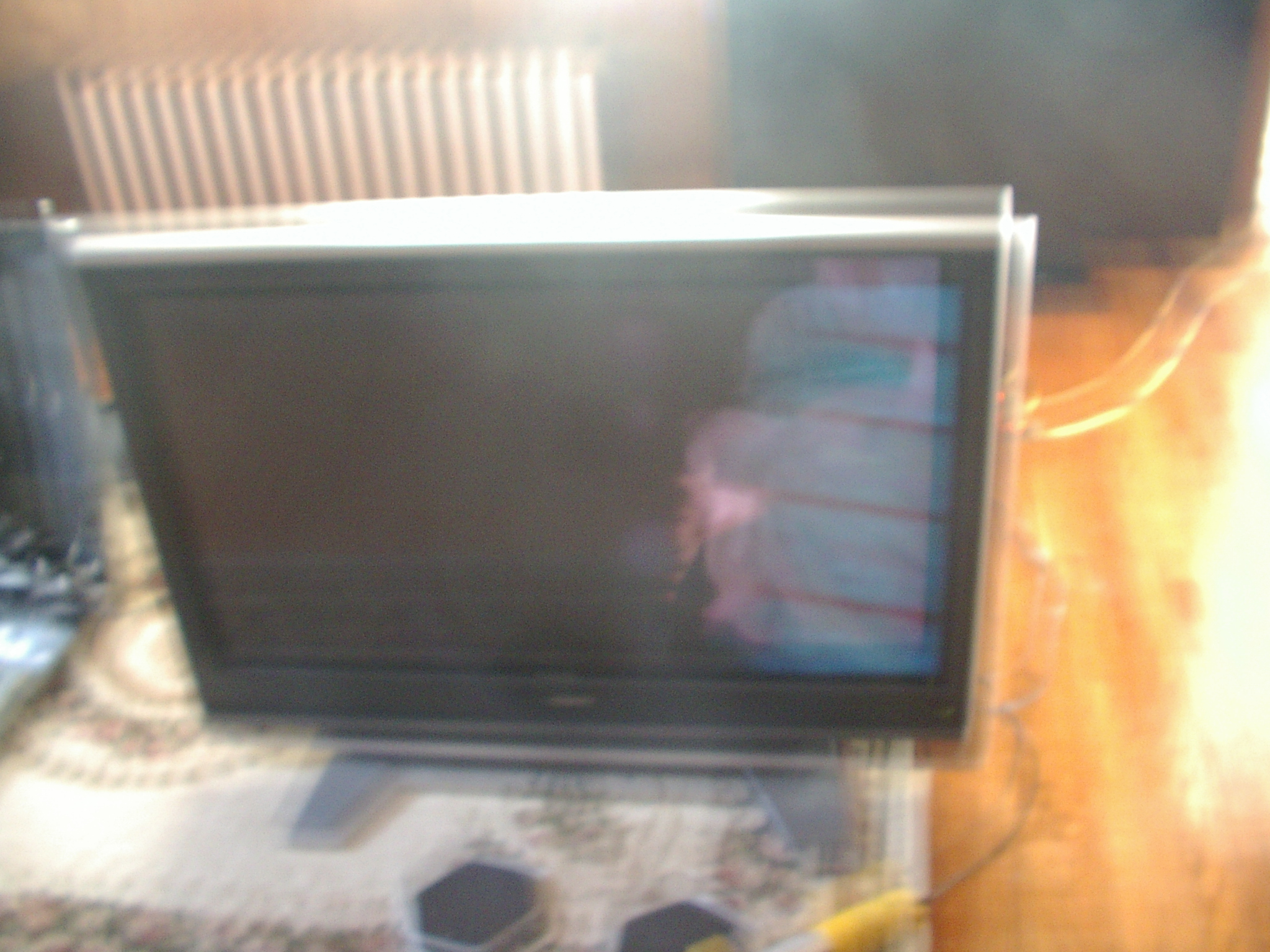

          the power works as it should without playing a movie the screen looks black/dark grey with a movie in you can see maybe a 1/4 of whatever is playing the rest of the screen is black were it looks like its was creaping across the screen. the origional owner said it started slowly and after time it got worse .
            i will have to try to get more pictures if this one don't help .
              Better.
              Picture is underdiffused: It's the X-main.
                i dont think that picture is going to help you either ,, i will try to get you a few more pictures ,, cause it will help !
                  I have seen it before and it is the X-main (Z-sustain if it uses an LG panel.)
