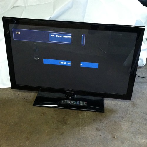

    hey guys got a samsung pn42c450b broken screen it works fine other the screen there is one on ebay only 1 day left but its screen is not broken but has some some problem on the screen please see the picture..with my good parts can i make one good tv? or is the sceen bad on this tv?

    As long as they share the same panel, it should work.

      missing stuff dont matter? video board? x or y boards
        Re: samsung pn42c450d need help fast about ebay auction
        Black bar is the panel or X driver board defective. But the rest is pretty much guaranteed working.

          If you are hoping to use that TVs panel with another TV to make a good one, it would not be a wise gamble. That black bar has a high probability of being a panel failure.
