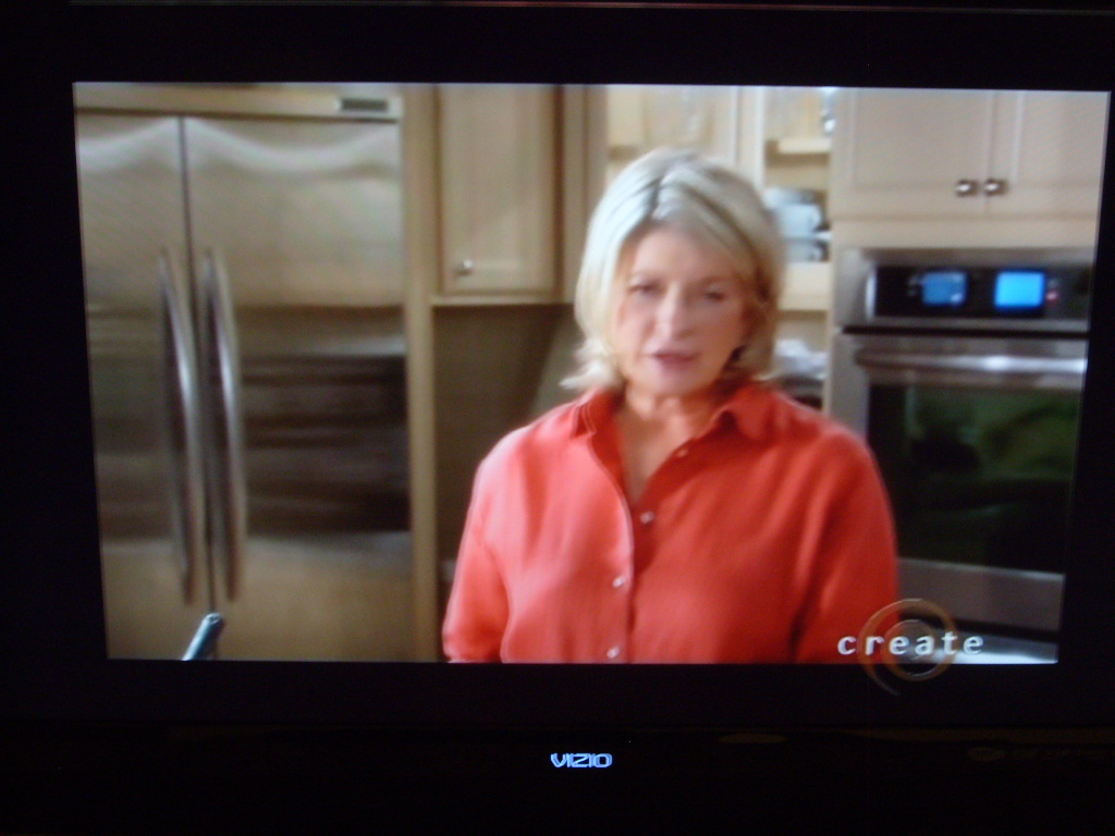

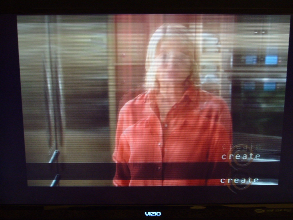

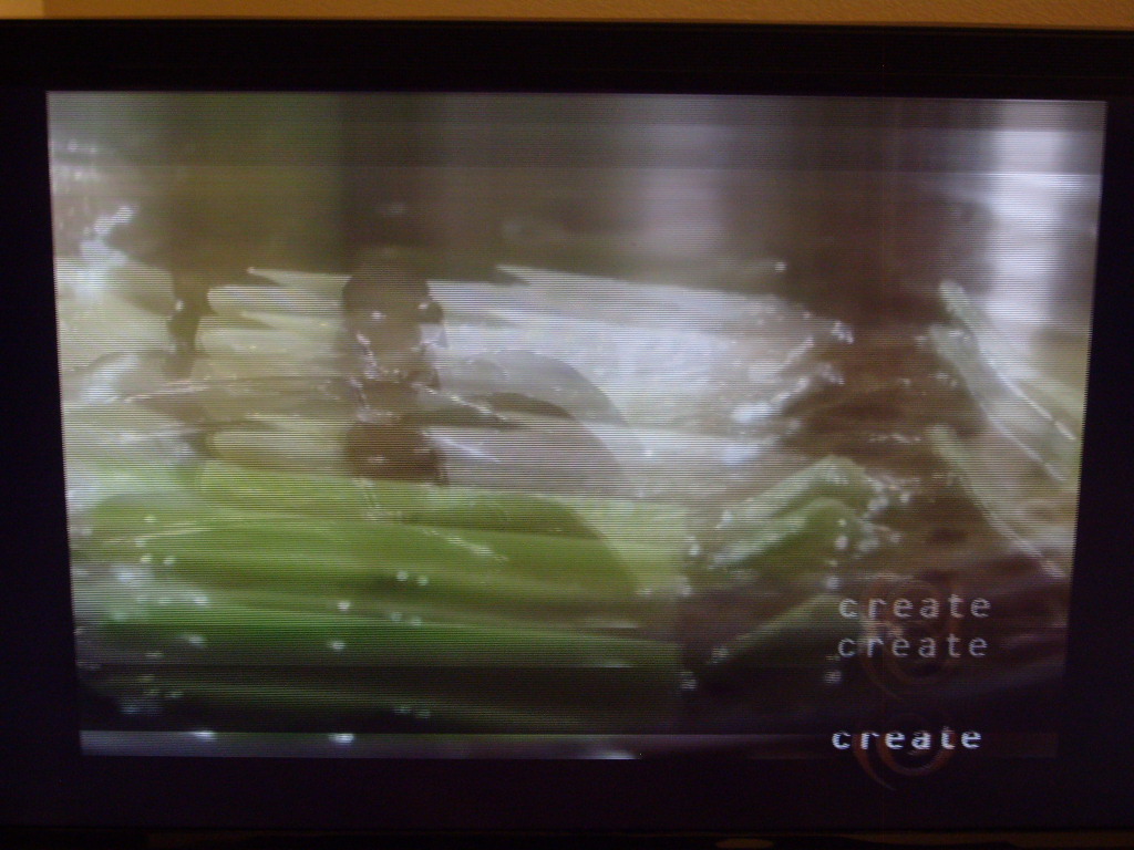

    Hi everyone,
    I have a Vizio E420vo TV. It has problem.
    Screen is blurred with double vision.
    I attatched pictures of tv.
    Please help me to find out problem.
    Any suggestions would be greatly appreciated.

    The LCD panel is defective, it may be repairable.

          This symptom looks like the Westinghouse I repaired long time ago due to bad T-CON.
