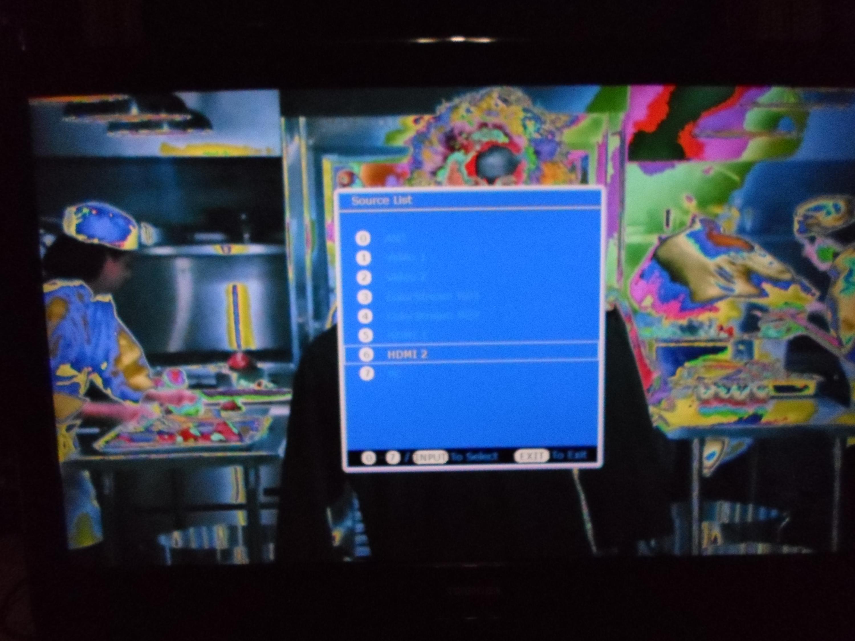

    Hi, I bought this TV along with 4 others from someone who bought a foreclosure and the owner left at least 8 TV's and other misc. electronics in the garage. They all had been opened up which sucks and I usually stay away from those but I only paid $16 each and they all power up with misc. issues.
    (Tom, 2 are big 50" Plasmas I will be counting on your help with those for sure !! I haven't repaired a plasma yet...
    This one has powers up and has normal audio and backlight, however as you can see the colors are inverted. I've seen this problem before on here and assumed the main board to be the culprit but never saw a resolution..
    I tried HDMI, component, RCA, and coax inputs and all do the same thing. However, the on screen display seems OK although around the borders there is some colors that don't seem like they would normally be there.
    Any thoughts on whether it's main or T-CON board? Thanks!

    For this set the T-con setting is almost certainly wrong, as I have seen it before on Toshibas. Sometimes turning down the contrast gets the picture back to normal but the best way is to set the panel data correctly from the service menu.

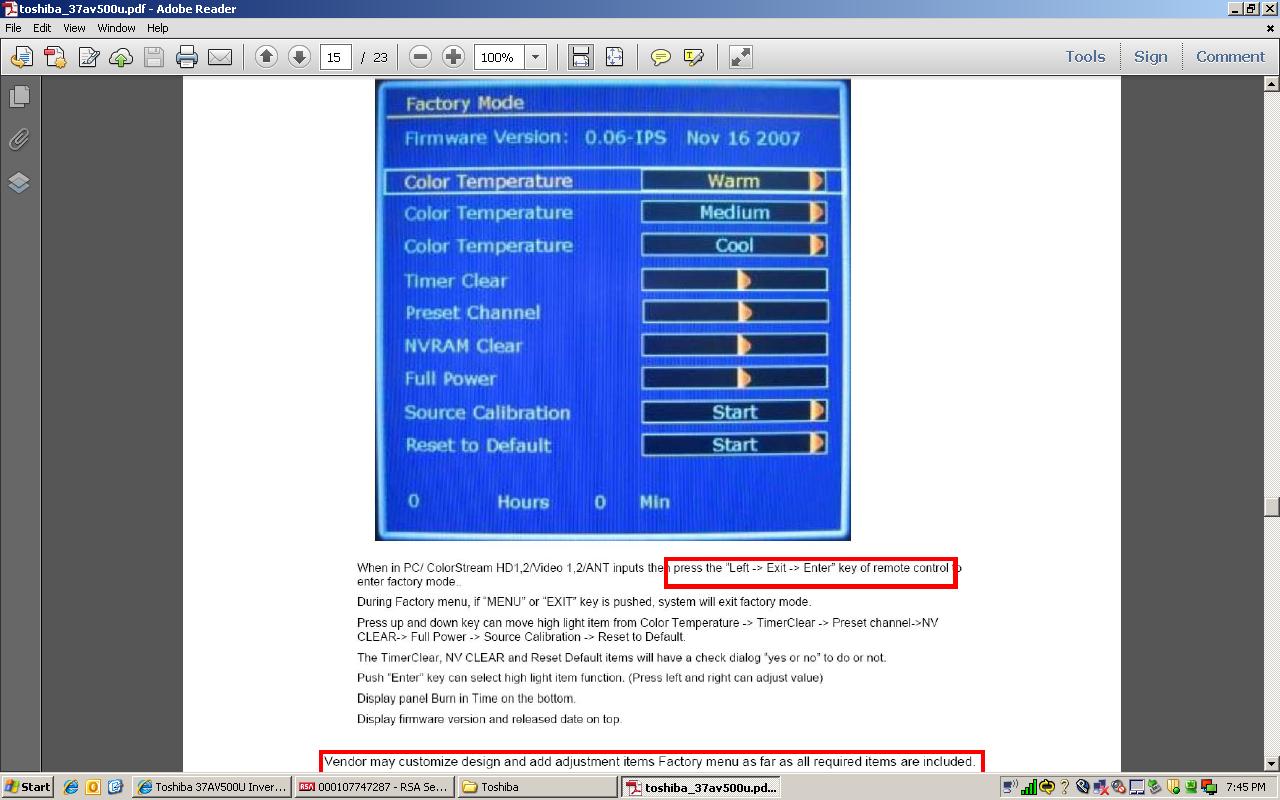

      Turning down the contrast helps the picture but doesn't fix it. Unfortunately I don't have a Toshiba remote to work the menus so I just ordered one. When you say set the panel data correctly what do you mean exactly??
        Re: Toshiba 37AV500U Inverted Picture/Colors On All Inputs
        There are settings to control which panel the main board is configured for.
        BTW, which panel does this model use? LG Philips is common for Toshiba of this generation.

              So it looks like I need the remote to get into the service menu, and what should I be looking for??
                The service manual will tell you.
                My service manual site is down temporarily, it will be up soon.

                  I have the SM this is the only page on it...

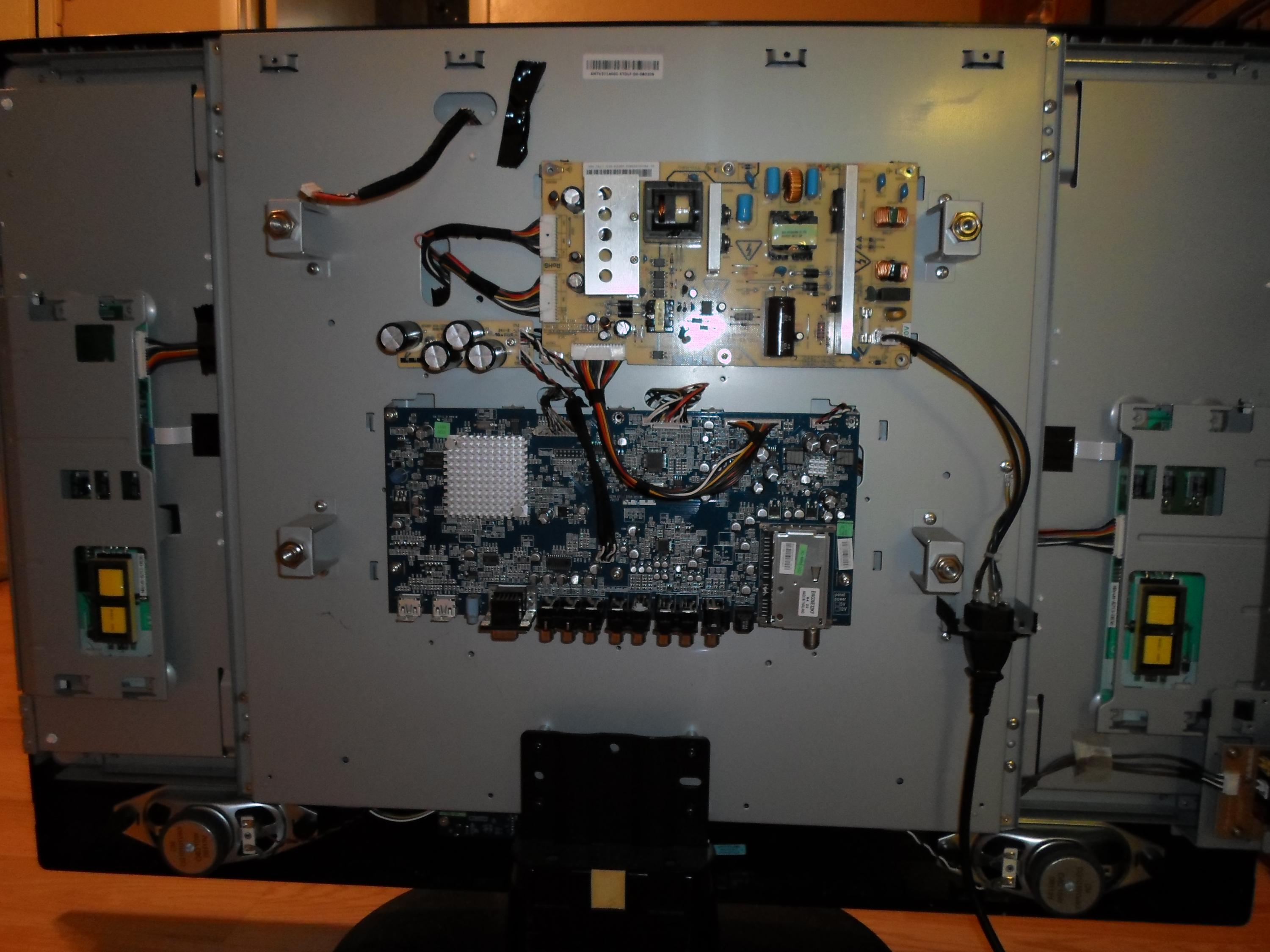

                    I see it has "-IPS" in the firmware version so you may simply have to find a main board which is from the IPS version. The main board is probably for a different panel and that might not be something you can change.
                    On some Toshibas it is possible to update firmware through PCMCIA/CableCard slot.

                      Tom so you think the main board may have been swapped??
                        That's the only way I can see that happening, or if the panel has been swapped and the main board and PSU are originals.

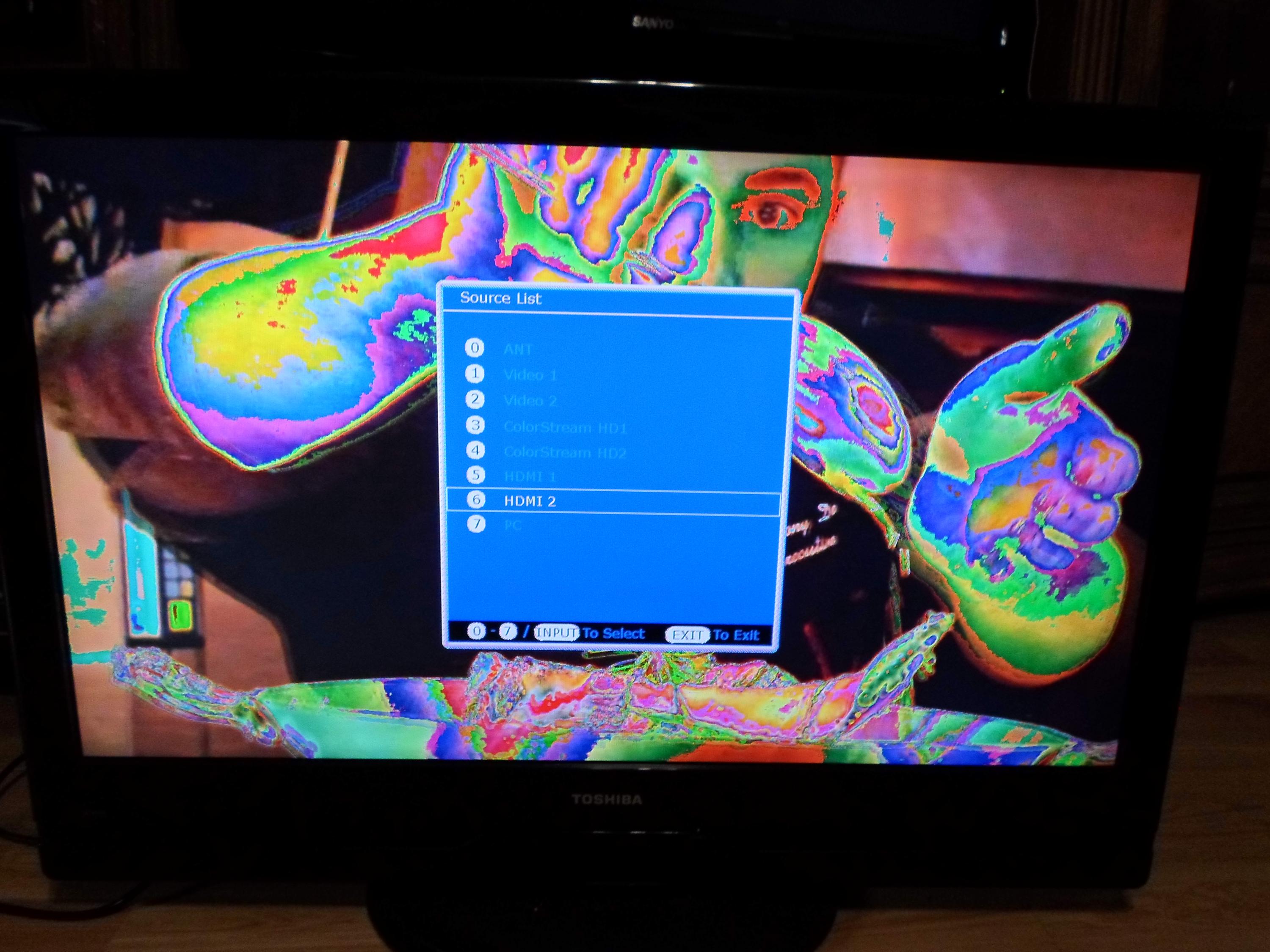

                                        Tom just realized that that a Toshiba 32AV500U was also part of this package of TV's I bought, it has a bad slave inverter but seems to be fine other than that. It also has an IPS Alpha panel AX080E002B. Is there anything I can do or try from this TV for this contrast issue??
                                        By the way any chance it could be the t-con board?? I think I saw one for about $12..
