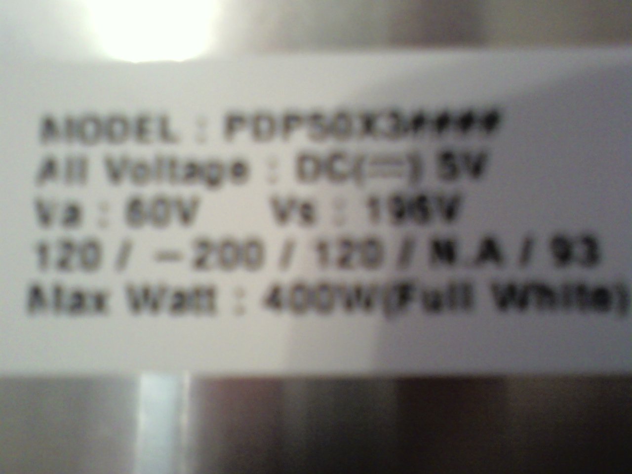

                -Vy looks too low to me. Should be close to -200V. Can you post a picture of the plasma panel voltage sticker?
                Also, you need to check Vs when the screen is flickering.

                    Re: vp50hdtv10a Buffer testing
                    sorry for poor picture quality.

                        drp, you are right the -vy is -199, the vsc is 114. Wouldn't I need a scope to adjust the vsc?
                          I think you need to get -Vy first. -Vy is important for erasing the display, pixels will get stuck on without correct -Vy.
                            I can do this with a vmeter, just adjusting the -vy pot?
                              Yes.
                                Alright -vy is up -200, +vsc 120. Should I just go for it and run the set, these y boards are so expensive. Nothing else I need to test?
                                  Just run it.
                                  As SOON as it starts flickering, cut it off.
                                  If it doesn't short then, no damage done.
