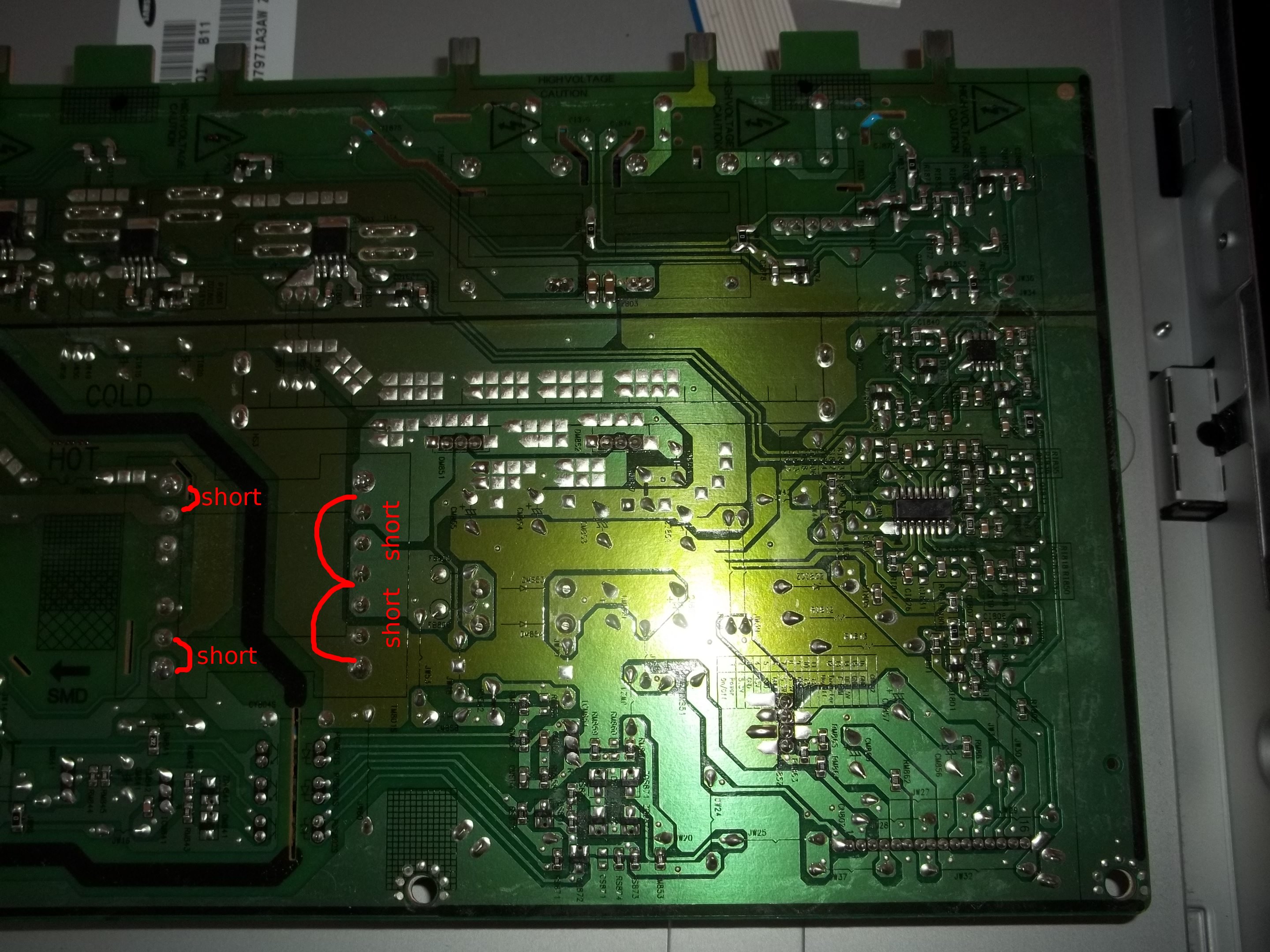

    Can you post a picture of the bottom of the board? You can determine which windings go where by looking at the schematic, usually.
    • Peale
      • Apr 2009
      • 96
      Re: Samsung 32" ln32b360c5d
      All of the photos of the boards are here:
      https://www.badcaps.net/forum/showpo...37&postcount=2
        OK, it is very rare for a transformer to fail, but here is how I expect the windings to appear shorted.
        • Peale
          • Apr 2009
          • 96
          Either I'm doing it wrong, or it's very, very shorted. Every one of those points appears shorted. But, wouldn't that not allow the TV to operate, at all?
          I'd been talking about the inverter transformers, above. Those I finally figured out, and they read: 1.073, 1.076, 1.043, .993
            Nope, it should be shorted.
            An inductor (which is basically what a transformer tap is), should always appear shorted.
            You need a ring tester to verify the transformer turns are not shorted. However, this is very rare with SMPS transformers.
