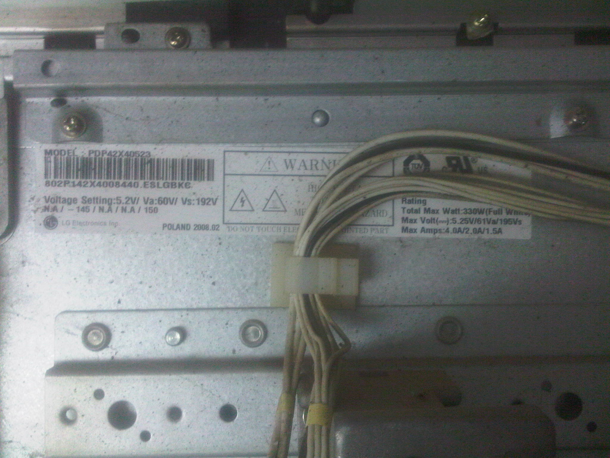

    the tv uses the panel PDP42X40523, psu EAY32808901, YSUS EAX36953201, ZSUS EAX36921501.

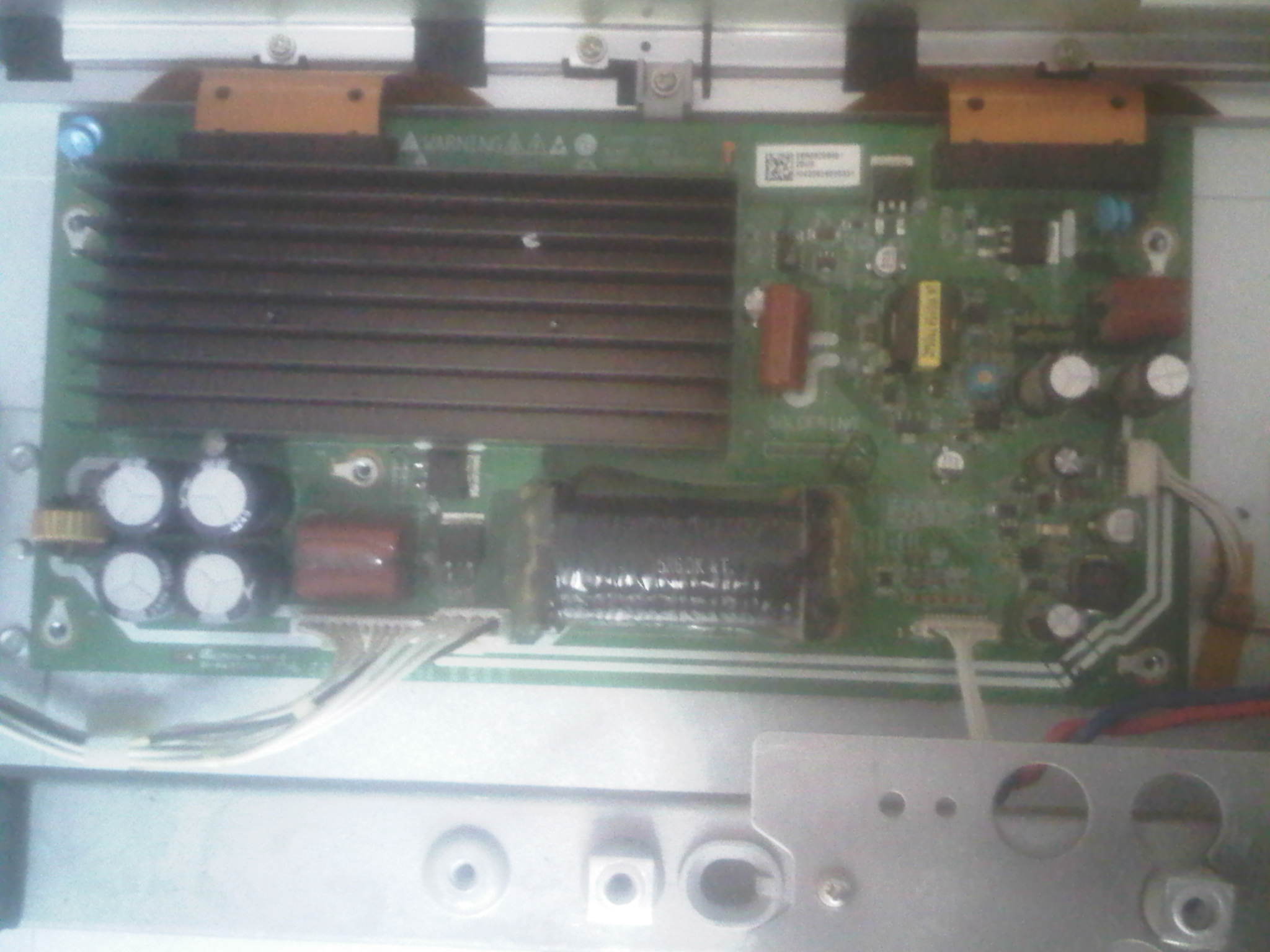

    -inspecting the boards.

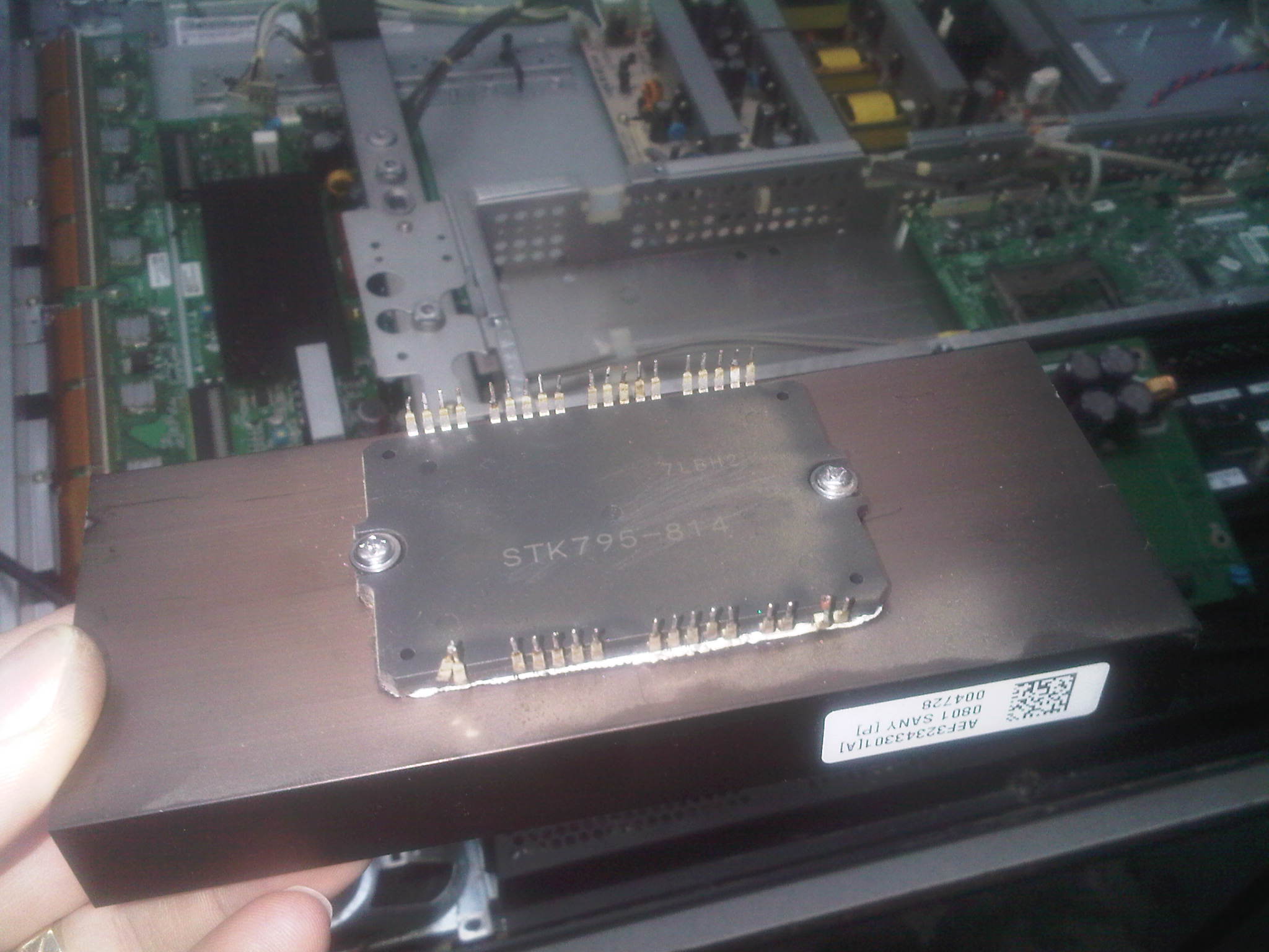

    although no fuses are blown, i found the main IC hybrid in the ZSUS shorted.
    read that this is a b*tch removing. since i do reballing, i used my tactics. preheated the board to 150'C and then desoldered the IC. its a Sanyo STK795-814. ordered through ebay and received it today.
    after soldering it hooked everything up with enthusiasm to find that the tv was again blinking 6 times.

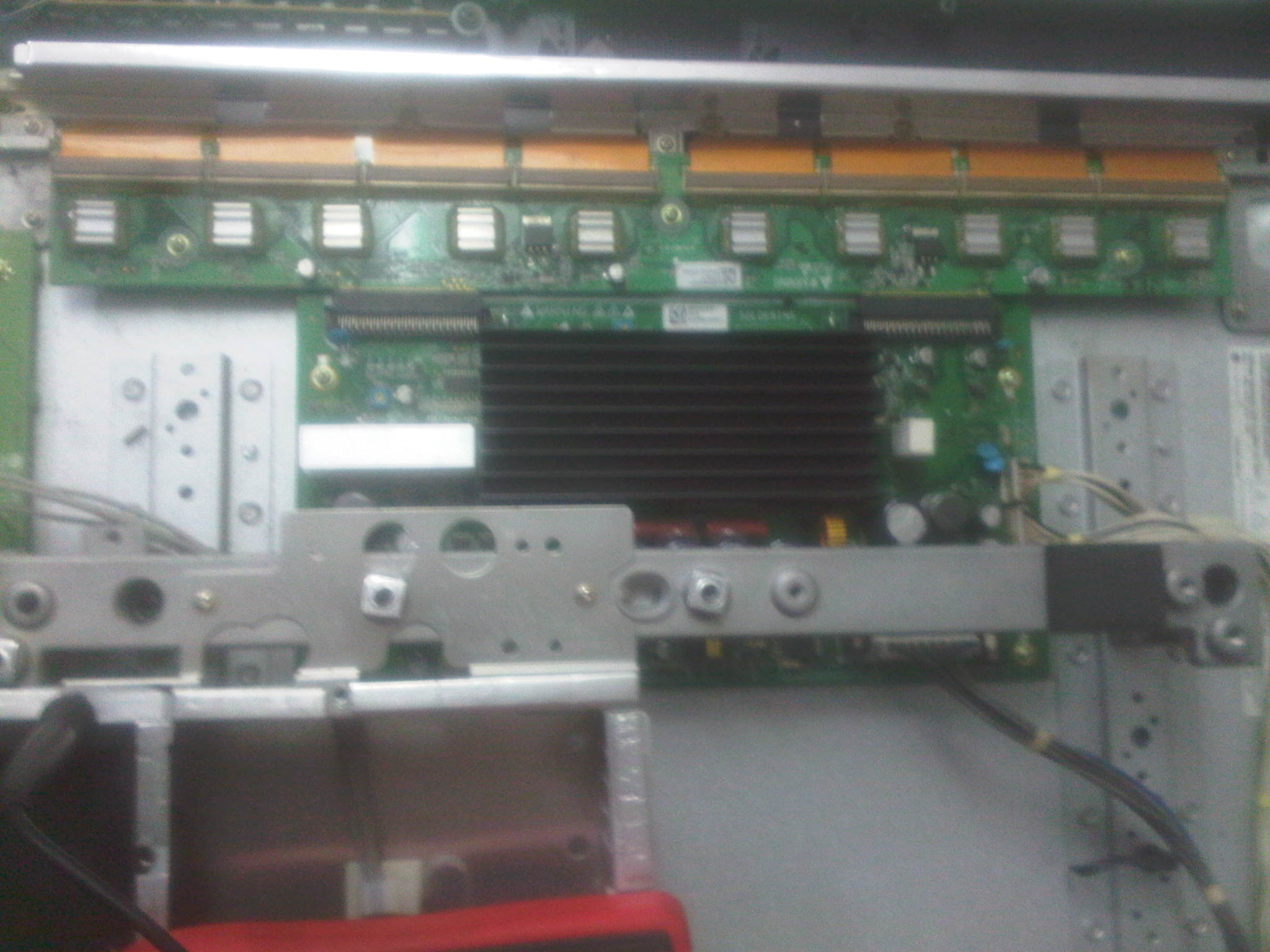

    i am trying to learn about plasmas and i have read that since the panel doesnt glow it must be sth with the YSUS or the panel itself.
    i need your advice. thanks in advance.
    Re: LG 42PC35 blinks green led 6 times
    Green blink isn't error code but normal start up.
    Sometimes Y-sus IPM fails, without short.
    If you get no glow, it is the Y-sus. A removed Z-sus causes faint, but visible picture.
        at the YSUS, at the IC pins, YER is shorted to Vs. Normal?
          nope, bad... there is usually a diode drop between them.
              STK795-813, and the Vs to YER is shorted!
              order a new hybrid? worth it?
