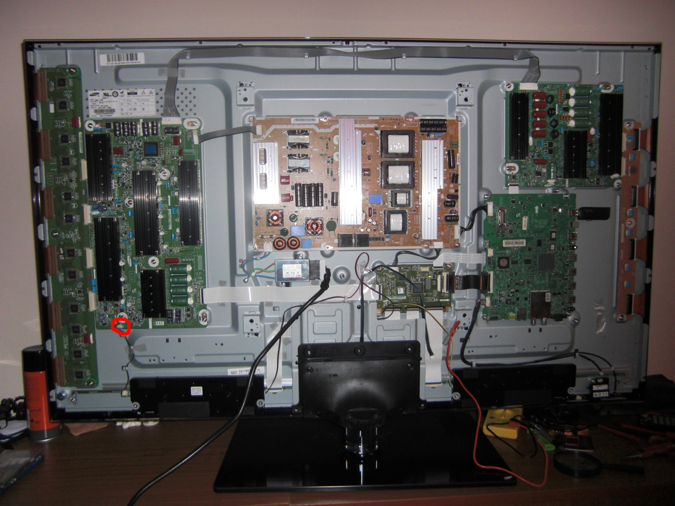

                    OK, next steps.
                    In the picture below the Y-main is left hand board, X-main is right hand board. Between Y-main and plasma panel there are the buffer boards. The X-main signal goes through a distribution board, but this is just like a piece of wire (it usually has no functionality.) The power supply is the middle board.
                    https://skydrive.live.com/?cid=EB469...FBD33875%21109
                    Turn the TV off and wait 30 seconds.
                    Unplug the main power connector going from the power supply to the Y-main.
                    Try to turn the TV on. Does it turn on now and make the Samsung tone?
                    If so, the Y-main or Y-buffers are at fault.
                    If not:
                    Unplug the main power connector going from the Y-main to thepower supply X-main.
                    If so, the X-main is at fault.

                          Re: Samsung PS51D6900DSxxc- Stays in standby
                          You have Vs?
                          But no Va?
                          It may be bad plasma panel (bad address buffers.) Can happen on Panasonic TVs. Not heard of it on a Samsung before, but it could happen.
                          To isolate the address buffers disconnect the connector in the image, make sure all other boards are connected.

                            I followed your instructions and disconnect the connector of the image.
                            Connect everything else
                            But still in the same state., Stays stb
                            I appreciate your help.
