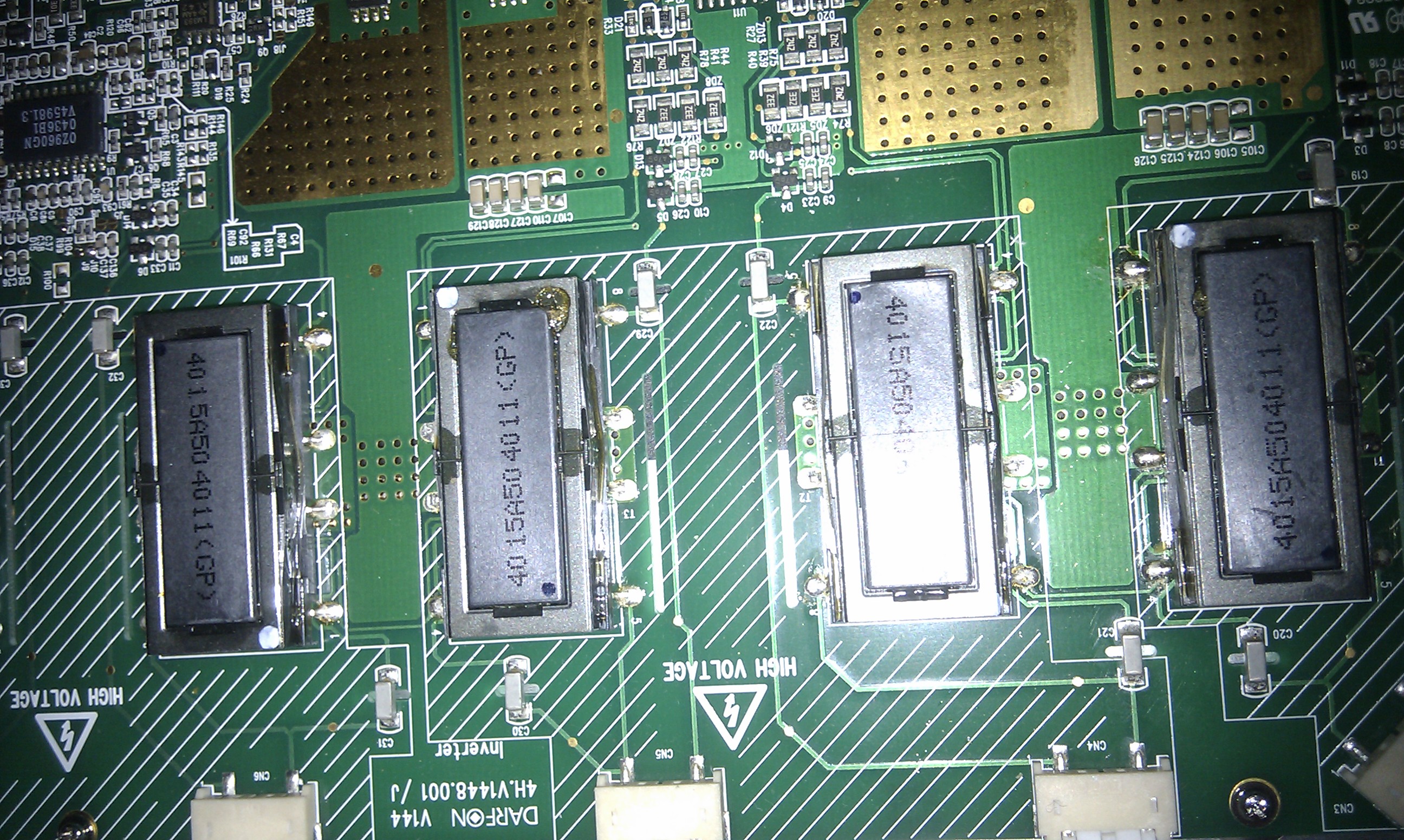

            See attached a photo of a couple of transformers on the inverter board. Does the one of them look bad to you- it's got some orange goo coming out of one of the corners. I think it might measure resistance a bit low, but I'm finding them hard to measure in circuit.
              Re: Toshiba 30" TV 30wl46b TV 2 seconds to black(ish)
              That's just glue.
              For these transformers you test top left to bottom left, as one winding, then top right to bottom right as another.

                          I've found a bad transformer!
                          I've also found a schematic diagram for the inverter board as made by Darfon. You can get it here:
                          I don't think that's true. Using the schematic and by looking at the transformer I removed, I worked out the following pinout, where 1 is the blue dot on the top.
                          1- Secondary 1
                          2- Primary 1
                          3- Primary 2
                          4- Secondary 2
                          5- Secondary 2
                          6- Primary 2
                          7- Primary 1
                          8- Secondary 1
                          On this inverter board, pins 2 and 3 are joined, and pins 6 and 7 are joined to join the primaries in parallel.
                          Pin 1 and pin 4 are joined to make the secondary go from pin 8 to pin 5, and pin 1 and 4 is a centre tap.
                          You can see how this is wired using the schematic diagram.
                          I was getting around 2k between pins 5-8, made up of 1k between pin 5 and pin 4 and another 1k between pin 1 and pin 8.
                          On one of the transformers, I've got one secondary at 18k, rather than 1k. I'm going to try and swap it.
                          Just for reference (and maybe google), my transformer has the part number 4015A504011 (GP) written on it.

                            Out of interest, how did you diagnose that the inverter board had bad transformers?
                              #34
                              The secondary resistance was twice or more of the others.
                              And I have replaced four, on four separate inverters. Usually only one goes after 3~5 years due to a consistent manufacturing defect.

                                  OK, so now I've got my replacement transformers. I bought them from eBay (http://www.ebay.co.uk/itm/2710080382...84.m1439.l2649)
                                  I've soldered them in. It still doesn't work. The TV power supply just clicks now.
                                  It has a slightly different resistance on the secondary- 1.4k rather than 1k on the original transformers on the board.
                                  a) D'ya reckon these transformers are no good? They say 4015A on them like the ones I'm trying to replace?
                                  b) Where do you get your replacement transformers from, rather than Chinese eBay sellers that take a month to ship them?
                                    #37
                                    Those transformers are the wrong type, I have had it before when trying to replace 4008A ones, there are ones with different secondary resistances but no obvious markings.

                                          Sorry about digging this thread back from the grave, but I thought it would be useful to post a conclusion- I got another Darfon inverter transformer from CHS, and that made the TV work again.
