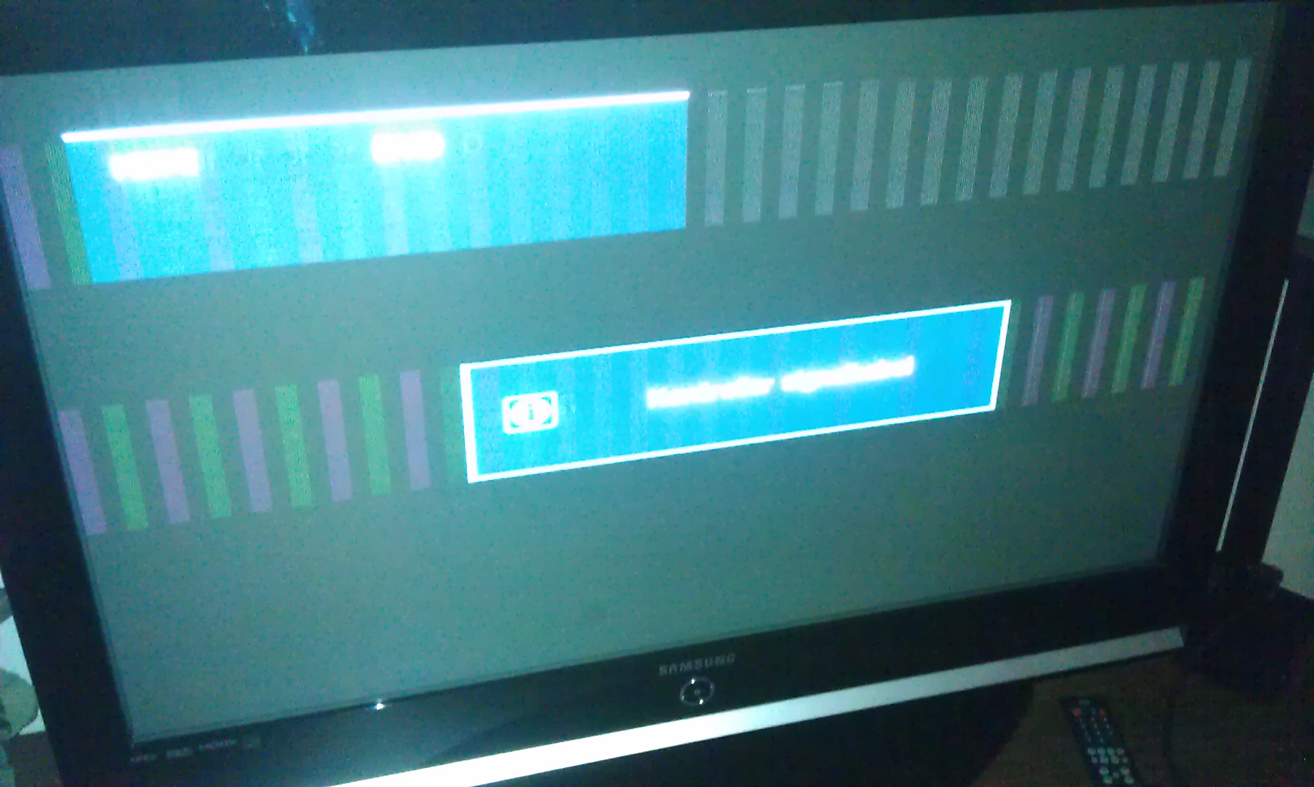

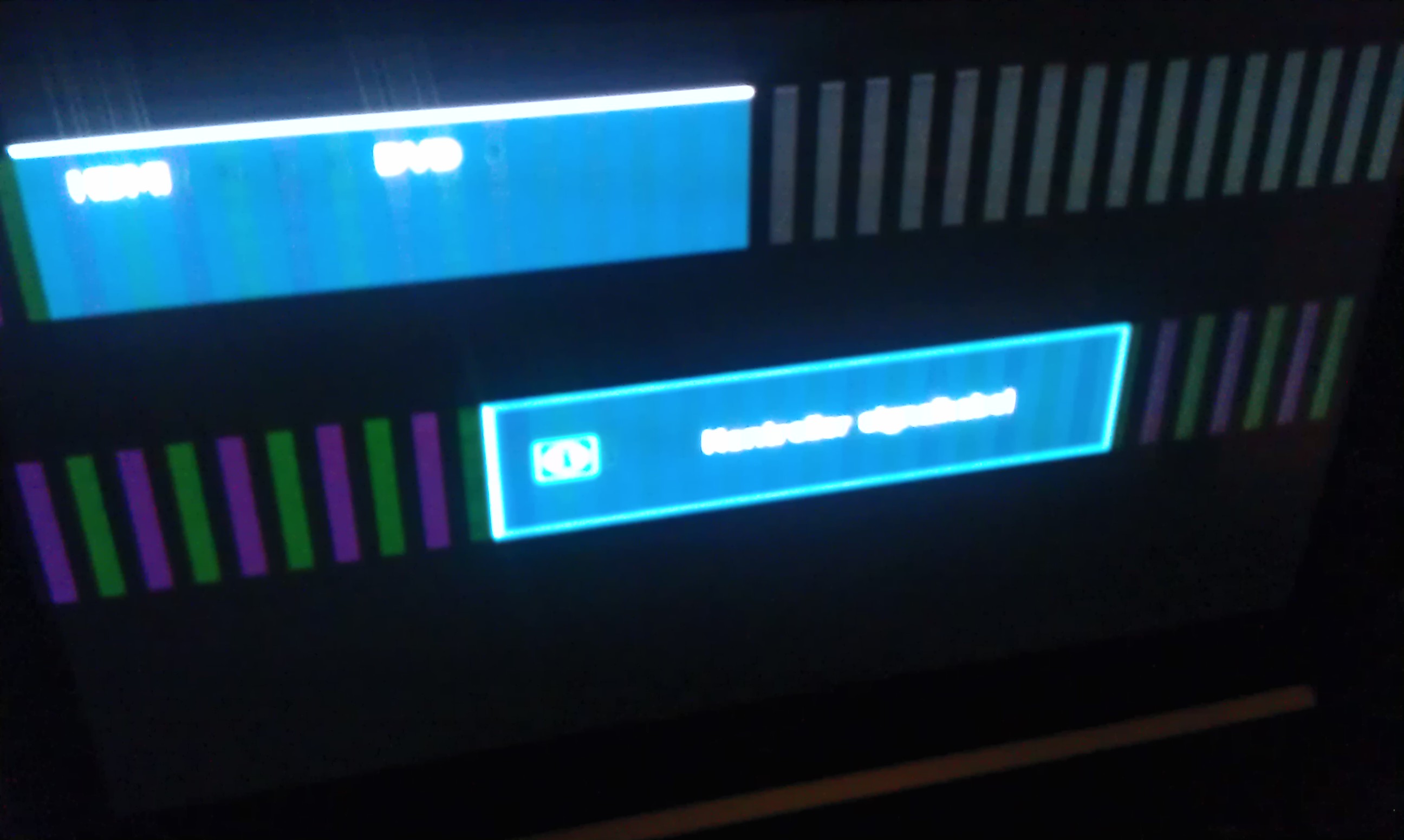

    Hi
    Having some problems with the image on my plasma.
    Does anyone know if this is a fairly easy fix?
    Regards
    Snorre

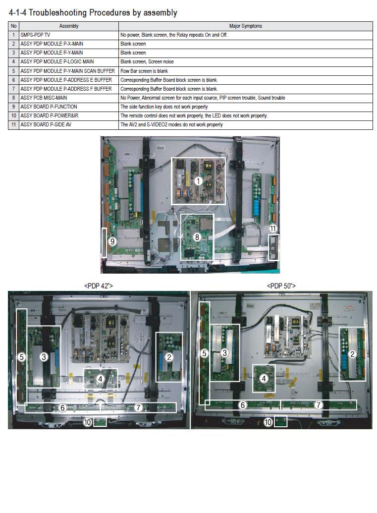

    It looks like it may be faulty buffers, or a control board failure; more likely to be faulty buffers.

      Re: Problems with image on Samsung PS-42Q7H
      Thanks for a quick reply!
      I guess I'll need to find a service manual and get started then.
      Snorre

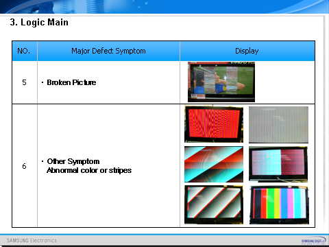

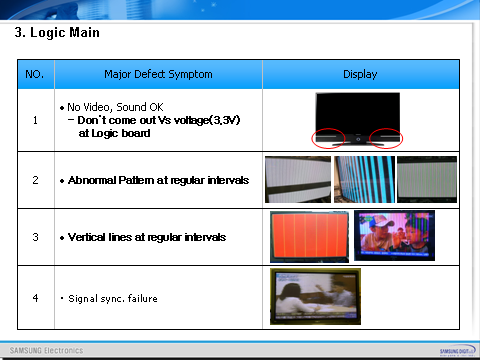

        Maybe logic main?
        #3?
          Thanx a lot!!
