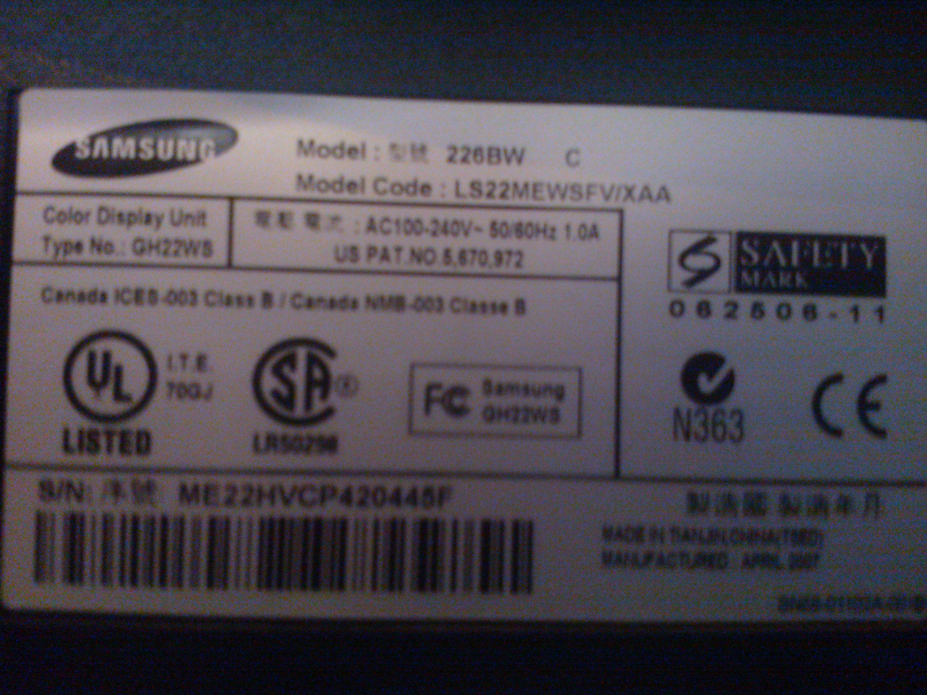

    I have a 226BW with the dreaded flickering. I have taken the time to look into this issue and I stumbled across some older posts from this forum indicating that the capacitors need to be replaced. While the older posts did have some good information I'm honestly not sure what I'm doing. There is mention of several variations of the board where some capacitors won't even fit due to size limitations. So as of now I feel very confused on what type of capacitors I will need. I'm looking at replacing the majority of them on the power supply board (I think I'm correct).
    I will link in a picture of the sticker on the back, and if needed I could try and take it apart and take pictures of the board.

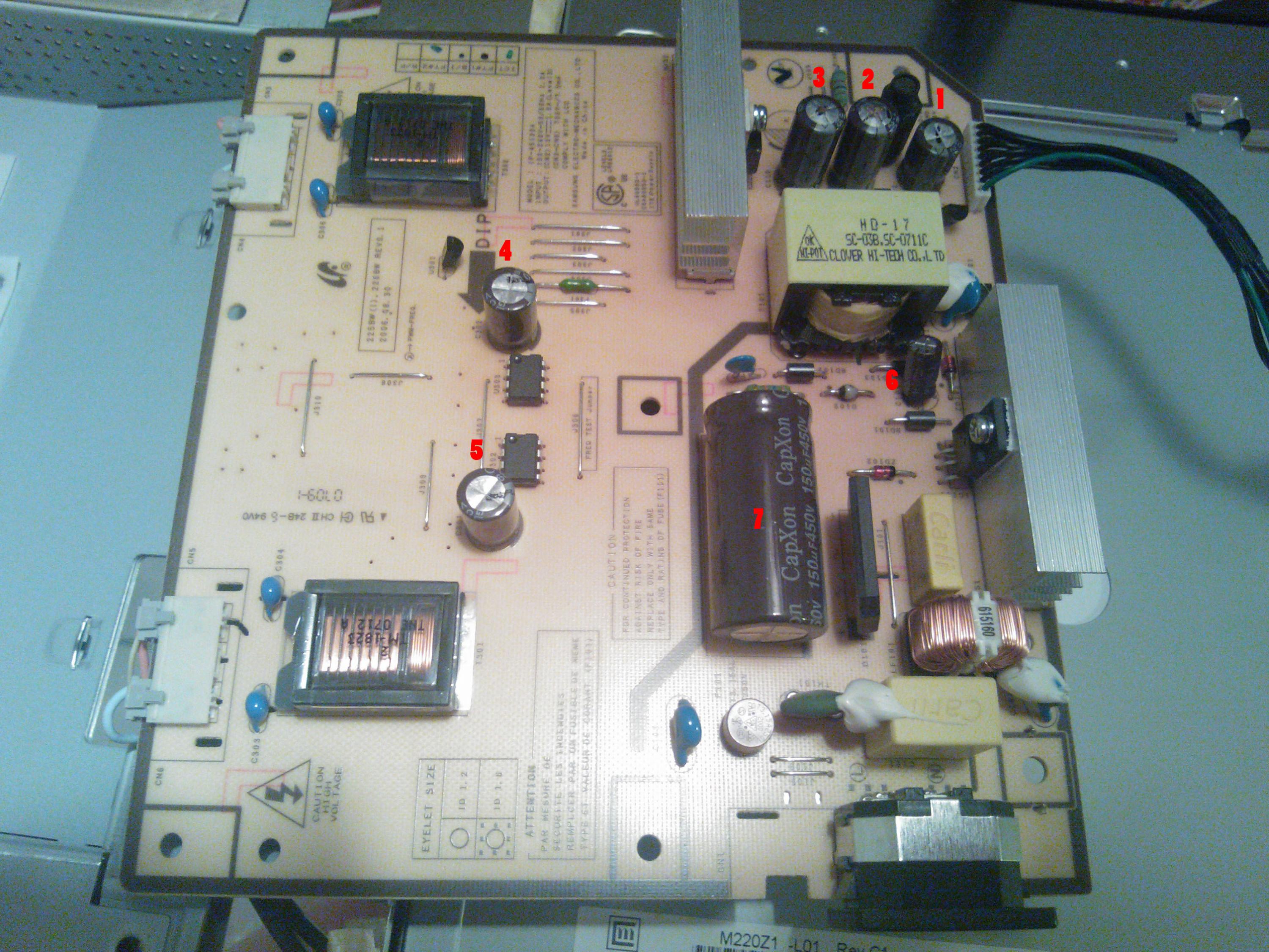

            I took apart the monitor tonight. Was a bit frustrating to do but I eventually got there. There were 2 possibly 3-4 bad capacitors on the board.
            Here is the info for all the capacitors.
            1. 330u 25v 10mm x 15mm
            2. 820u 25v 10mm x 20mm
            3. 820u 25v 10mm x 20mm
            4. 680u 25v 10mm x 17mm
            5. 680u 25v 10mm x 17mm
            6. 47u 50v 5mm x 10mm
            7. 150u 450v 20mm X 42mm
            On the old forum post I found this list here from someone named Plainbill. His list seems to be identical to mine but his contains item IDs for purchases. Is this list suitable for me?

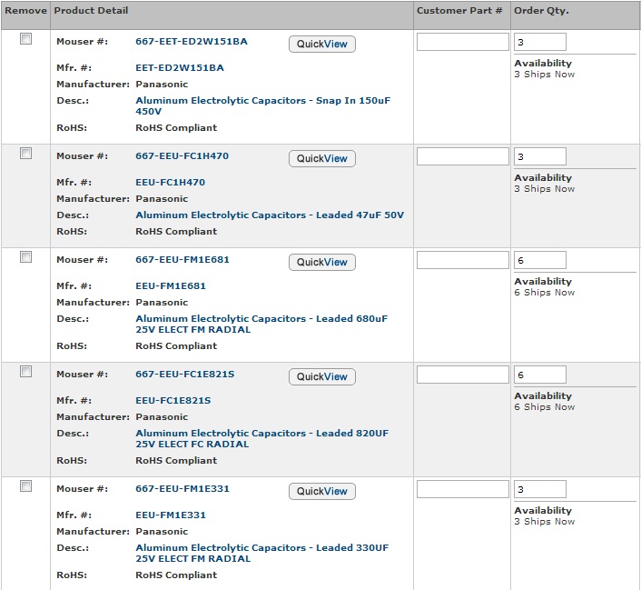

            Edit: I added a screenshot of the Mouser shopping cart, if someone could take a look and see that I'm doing things right. Also I decided to get EEU-FC1E821S instead of the EEU-FM1E821L as its 5 mm shorter.

              No, stick to FM or FR for those 25v rated capacitors. You have the room for those.
              FC will work but only just, it's kind of lousy with life rating, something like 2000 hours @ 105c compared to 6000-8000 hours @ 105c
              It's unlikely the large 450v capacitor has issues. Save some money or put the difference into getting FM or FR capacitors.
              They're 820uF 25v FMis 10x25 mm, but i'm pretty sure they fit without touching the top case. Test it out, if they do, you can always put them on the board horizontally, you have room there. But you have FR which is smaller.
              Why 3 pcs of some capacitors in that order?
              820uF 25v , first is 20mm tall, next 2 are 10x25
              FR 10x20 : http://ca.mouser.com/ProductDetail/P...Ttf5M3IJgpU%3d
              FM : http://ca.mouser.com/ProductDetail/P...16jrIr2Il7c%3d
              KZE : http://ca.mouser.com/ProductDetail/U...3R5Rr%252bA%3d
              680uF 25v
              FR 680uF 25v 10x16: http://ca.mouser.com/ProductDetail/P...7jgDC0Mw8O8%3d
              FM 680uF/25v 10x20 : http://ca.mouser.com/ProductDetail/P...2f7Rt9ZHgBw%3d
              KZE 680uF /35v 12.5 x 20 : http://ca.mouser.com/ProductDetail/U...252bZHe0pm0%3d (higher voltage is fine, you have room on board for 12.5mm)
              If you already placed the order, then it's ok but your monitor will last long with capacitors with better life rating.
                Re: Samsung LCD Syncmaster 226BW
                Thank you for the suggestions mariushm. I have not ordered them just yet, I was actually waiting for comments as I was a bit unsure. I have swapped out the 820uF with the FM and the 680uF to the FR based on your recommendations. I'm ordering multiple of each because I actually have 2 additional 226BWs here that are starting to show the same signs.
                  Well, get the FR for 820uF 25v then, it's 10x20 so you don't have to worry about having room for them.
                  FM and FR are about the same specs, just different dimensions, depending on uF and V combinations.
