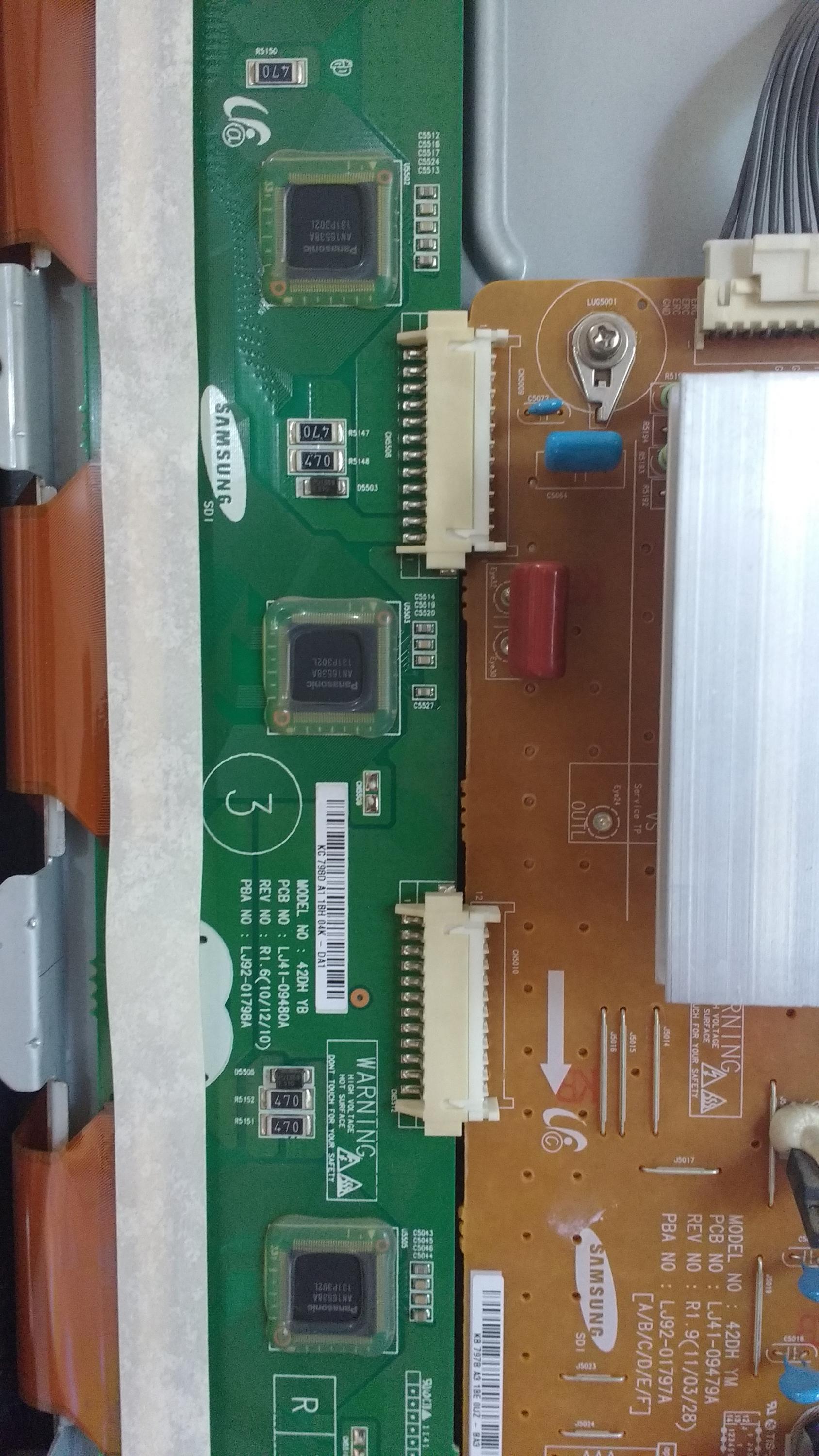

                            hi, am new to this forum. Dont know if this is the right place to post my query. Correct me if i am wrong ;-)

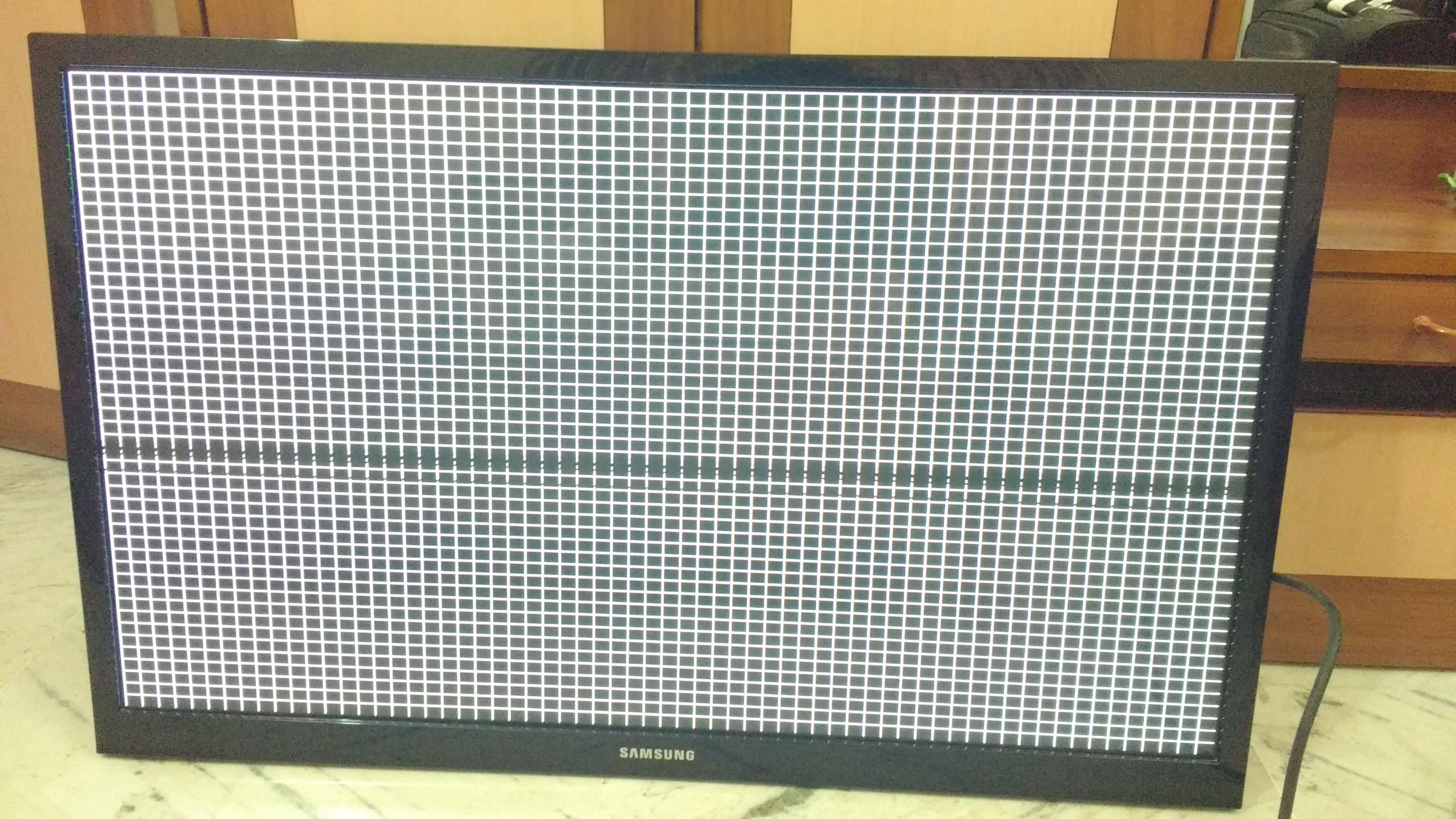

                            I too have a Samsung plasma tv PS43D450A2 model with horizontal black lines in the middle part of the screen. The tv is fully operational.
                            The voltages on all test points of the power supply, y-main board test points read fine according to plasma screen stickerwith Va, Vs and Ve readings. The X main voltage at test point XS-E is 78V
                            But when i test the voltages across the smd resistors R5149 to R5154 and smd zener diodes D5504 to D5506 (marking PJ1389) on the Y-buffer board, i found that the voltage is fluctuating between 45V and 30V. It keeps dancing up and down on all the resistors and diodes across the y-buffer board.
                            I felt the ICs on the board with my fingers and they were all warm. Nothing too hot or cold. Is this a voltage regulation issue from the y-main board or a y-buffer board issue? Little confusion here ;-) The heart beat on the logic board is good. I have tried re-seating
                            the flex cables on the y -buffer too. The only thing bothering me is the fluctuation in voltage across the resistors/diodes on the y-buffer board.
                            Could it be bad capacitors on y-main board? But the test point voltages on the y-main read ok. So the confusion haha.
                            Any feedback will be really helpful. Thanks n regards?

                              A picture of the fault would help also you could try test patterns to see if its the panel at fault

                                Hello, thanks for the reply sir.
                                Sorry for me replying late as was not well so this TV repair project was stalled.

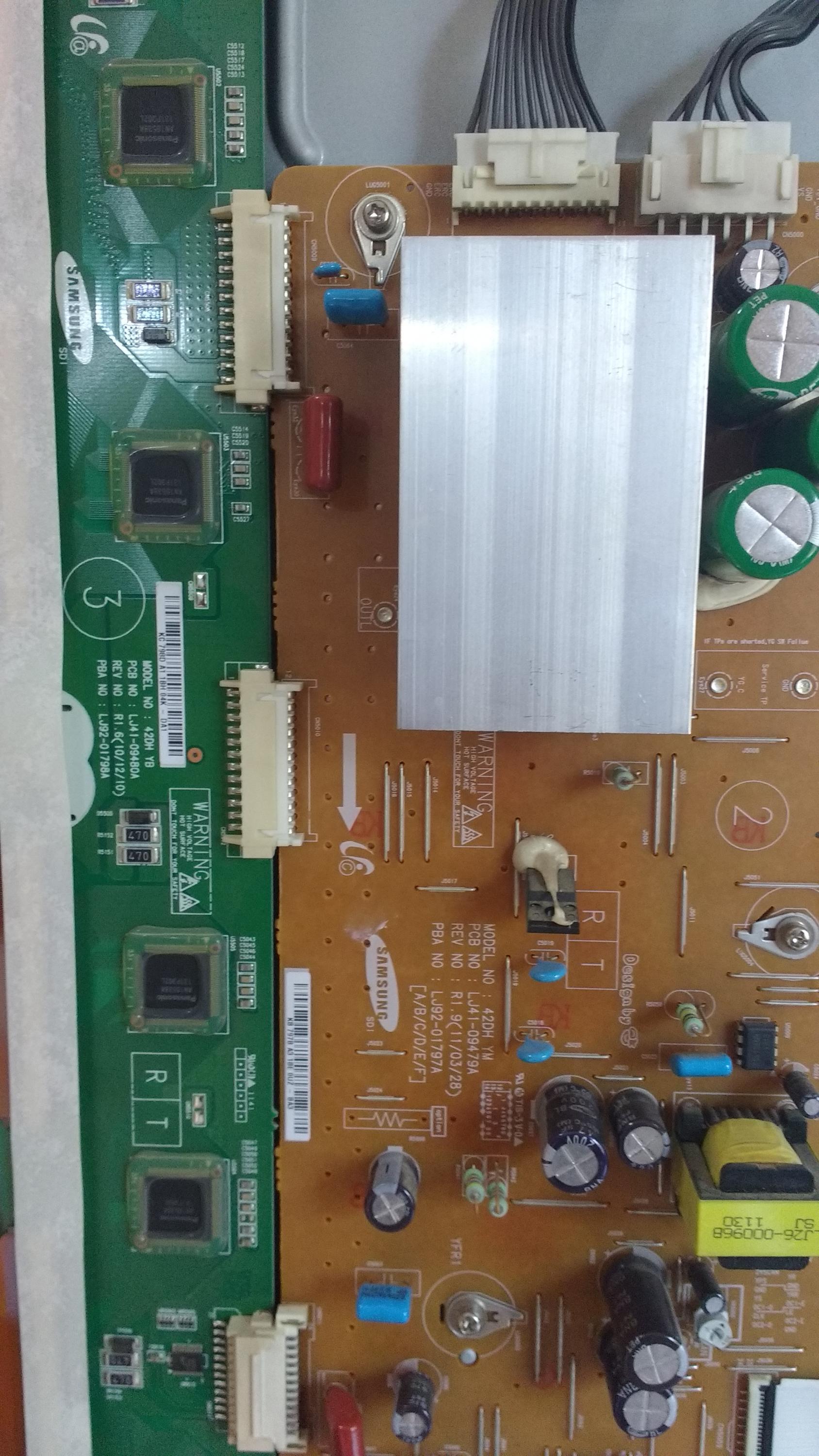

                                Anyways, I have attached pictures for better understanding.
                                I mostly suspect the Y-buffer or the Panel itself to be bad. I have ordered a new y-buffer board to test the same before i trash the tv.
                                The voltages across the resistors/diodes on the y buffer should be typically 58V but its way low to 41V and fluctuates on the lower side till about 28V or so.
                                There are no shorts on the y-buffer board and i checked for that. One thing i did notice though, that the diodes are conducting in both directions i.e. i get a beep, although the sound is little low on the multi-meter buzzer. But it should not do that. What's puzzling is how can all the diodes behave in that same manner. The smd resistors marked 470 measured 32 ohms on the multi-meter. More than 20% lower here. I am really curious to test the new y-buffer board that i ordered and compare the resistor and diode readings.
                                It will be some time before the new board arrives. I will keep you posted.
                                Thank you. If you have any ideas, do let me know.
                                best regards

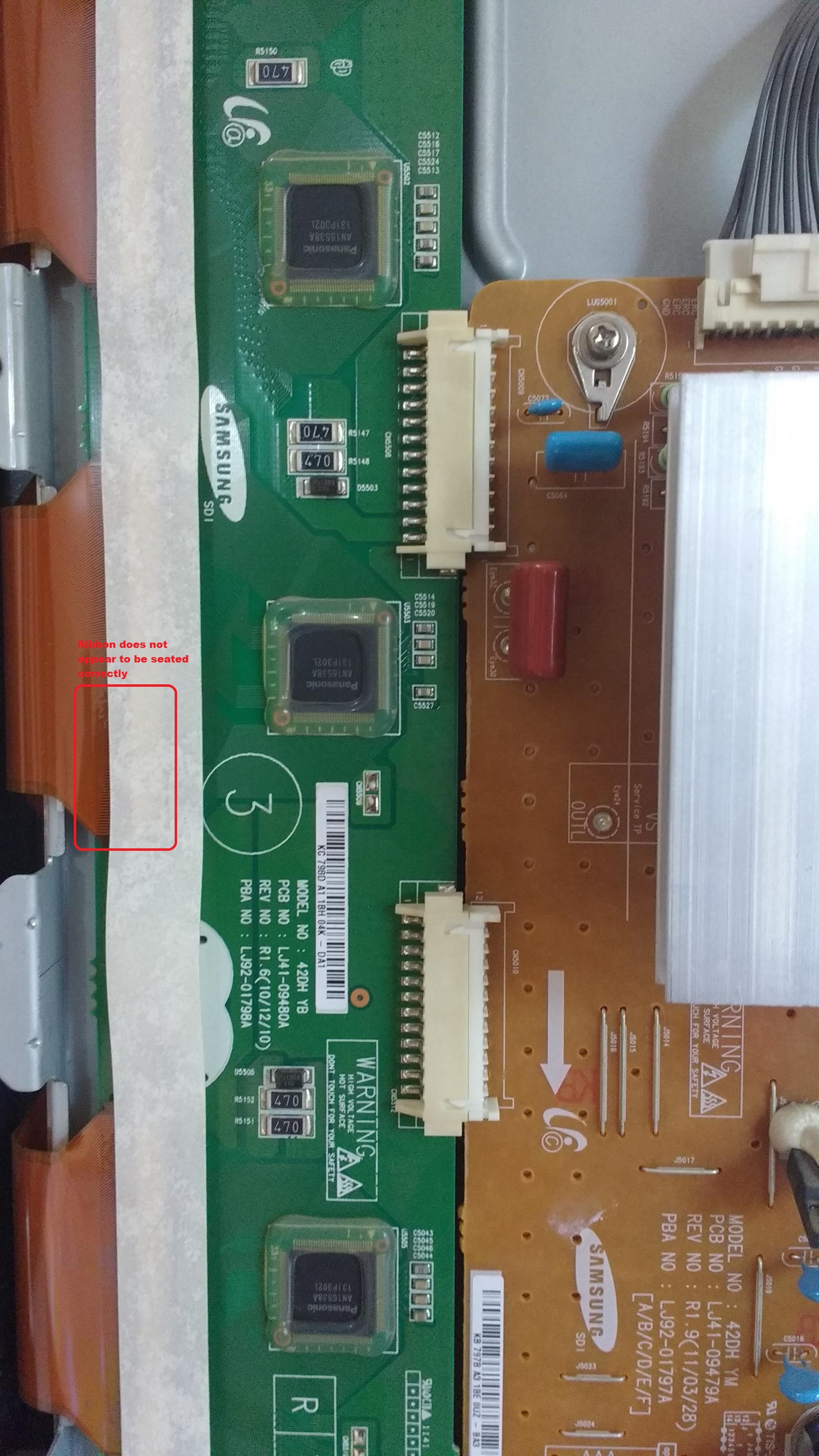

                                  I think you need to double check that all the Ybuffer ribbons are located correctly into their sockets. The one in the picture does not look right.

                                      Thanks dick_barton and tvtimmy for your observation. Will do a cross check once again. Althogh i tried re-seating the cables many times. No harm in re-checking i guess.

                                        You need to be patient to reseat the ribbons carefully into their respective connectors and then double check that they all look identically seated. Sometimes this has to be done several times. Any ribbon not in place will give you lines across the screen or may even damage the buffer chips.
