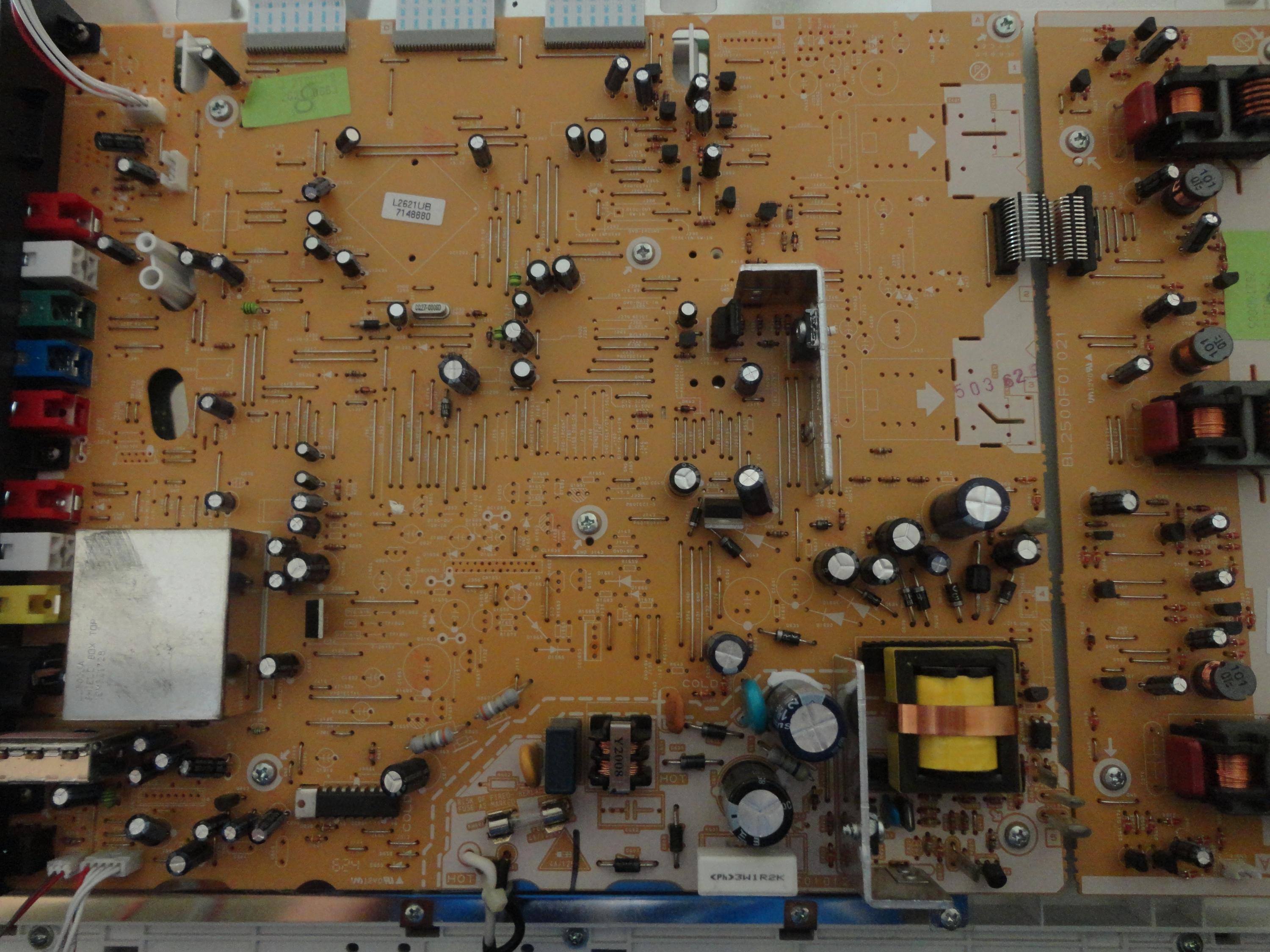

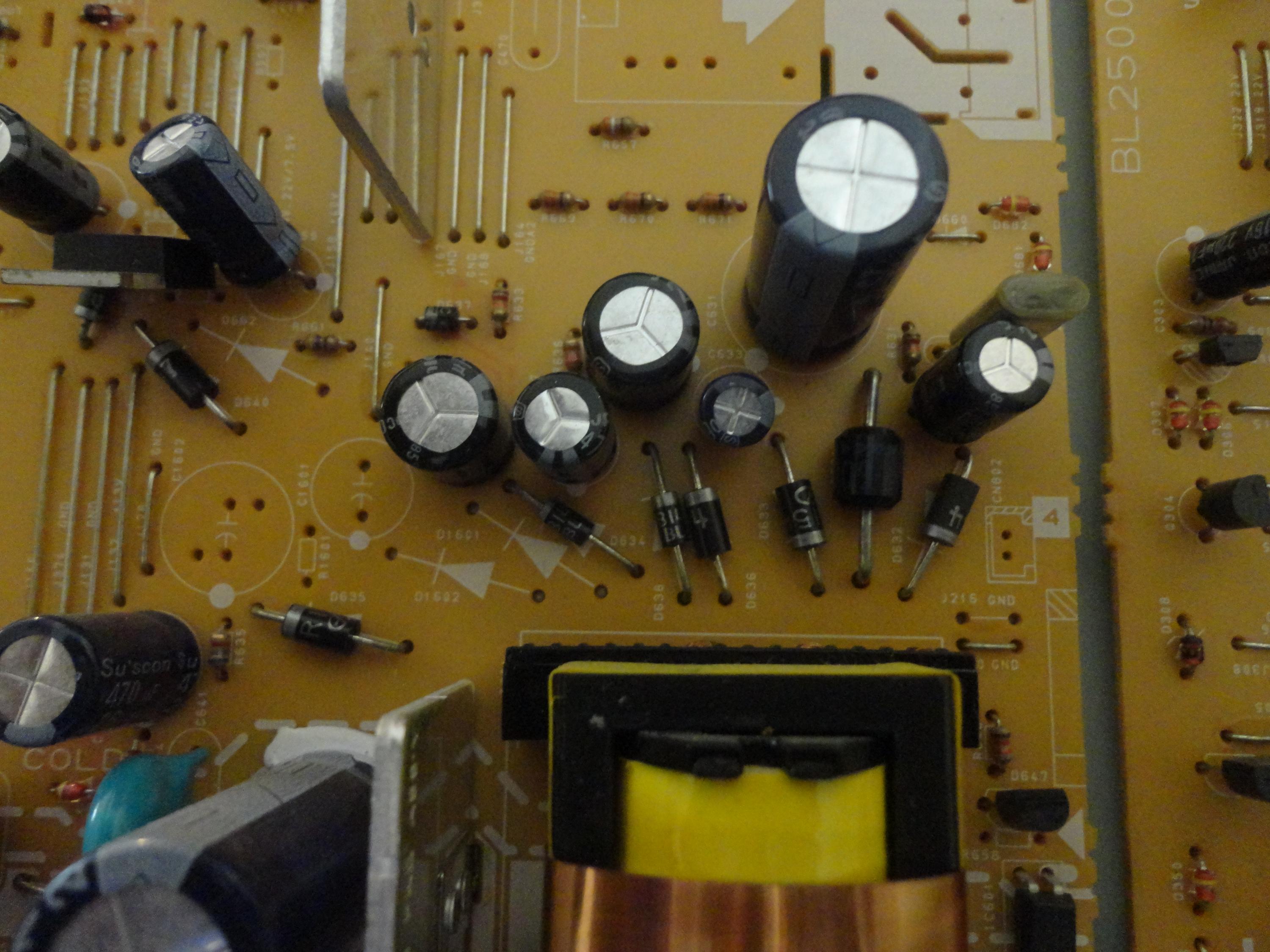

    emerson 20 tv with double image
    i chech my voltages on power/main board on q601 part 2sk3869 is swithing looking at it with the three pins down left being one midle 2 and right three.pin one -51.5 pin two 56.1 and pin three -54.6.there voltages should read s 0.1 g 4.9 and d 165.5also ic 601 has pin 2 has 34.3 and pin1 has 35.4 which is correct but pin 4 has -54.2 it is suppose to be 19.9 and pin 3 has -40.9 it is suppose to be 0.6. this is on led side.ic is for error voltage det.will post pictures in a second

    Re: emerson 20 tv with double image
    here are pics
      my bad on the reading recheched them and the are up to specs.know i know the importance of always using correct ground i was using cold ground to check hot voltages once i switched my ground to hot.they all heard correct so now i am back to step one.looking to see what is causing my double image and tv to shut down.
