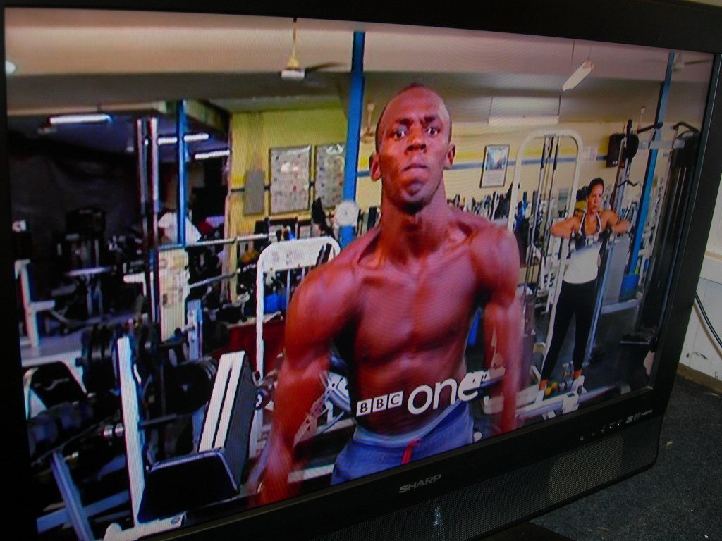

    Picked up two TVs from Portsmouth today, this one is an interesting one. Has a picture, but basically anything which should be black is green tinted. Picture is otherwise okay; the tinting seems to be quite variable.

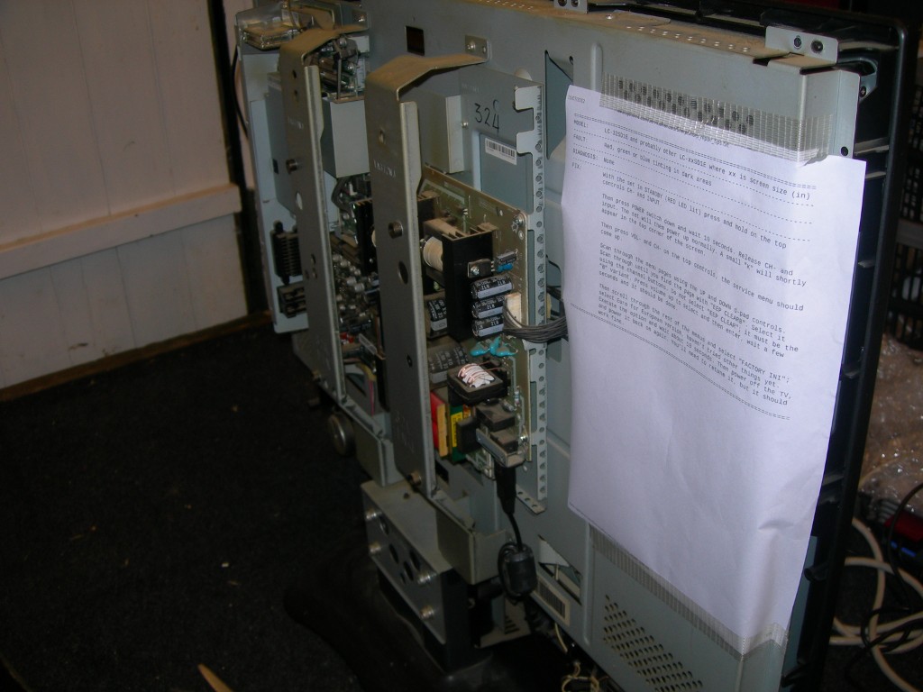

            I'm going to print out the instructions and include them inside the TV next time for any future techs who need to fix it.

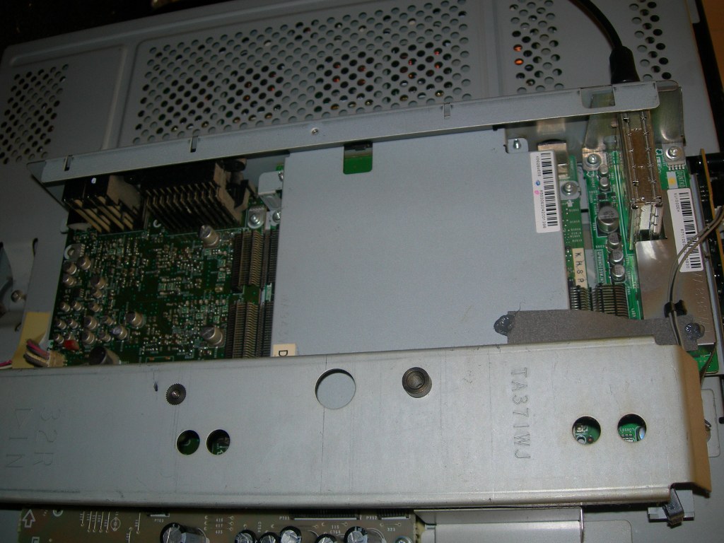

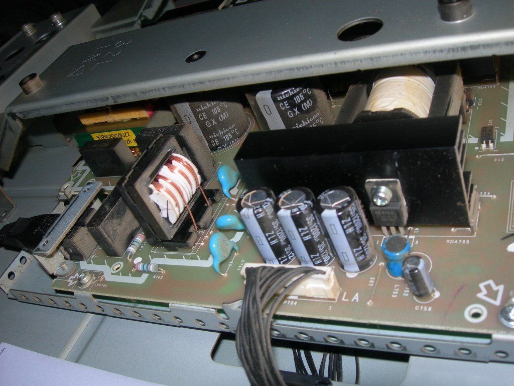

              Here's some pictures of the teardown, although the repair can be completed without undoing a single screw...

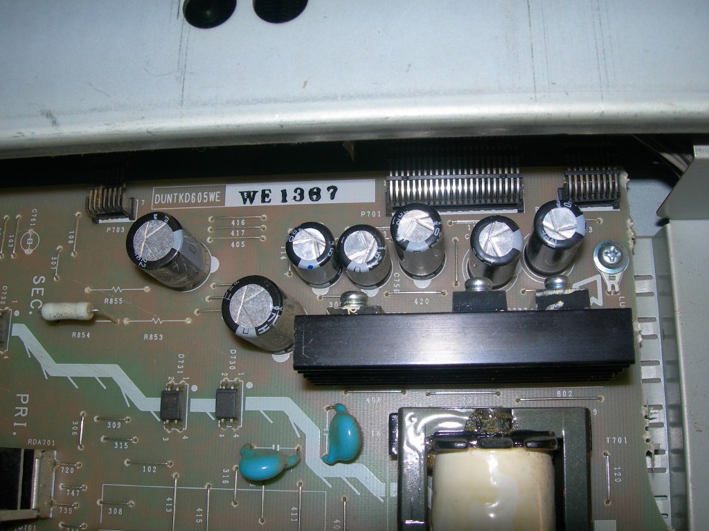

              Overall very high build quality, better than the two Toshiba sets I have repaired, formerly would have put them on a level playing field as 7/10... but the Sharp is definitely better, approaching 10/10 on build. Deduct one point for ridiculous use of odd screws for stand but you don't need to take stand off to work on it. Has a Sharp LCD panel as well as Sharp main stuff. PSU is Sharp too, with Rubycon and Nichicon exclusively, and all black anodised heatsinks. Very nice.
              Seems the only things that bring down these well built TVs are obscure main board issues and software issues, rarely PSU issues.
              You can see the note included inside the TV - should save someone time if this happens to be an issue although from reading up it seems to be fairly uncommon so may be a rare situation which causes it. (There's nothing on the side I've taped the note to, so there are no cooling issues...)
