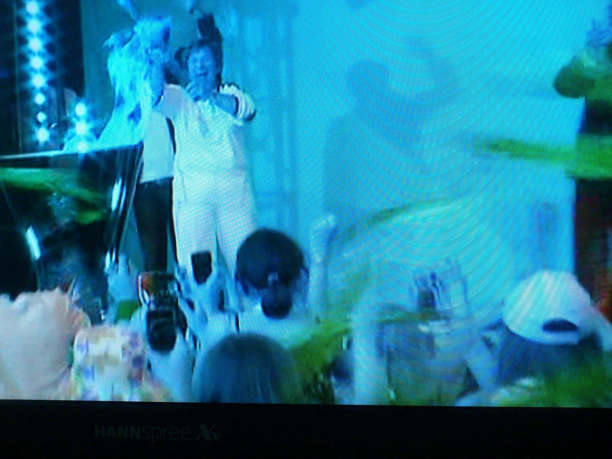

    hi all, i havent had time to look at this one yet, but i thought id put it up to see your thoughts on this one, as you can see the picture is blue saturated, everything else works ok and the menu is not effected by the blue (normal colours)
    any ideas? is it more likely to be main board or the t-con?
    i know its hard to say without me opening it up but i havent got the space at the moment

    The T-con can't differentiate the menu and the image*, so it's a problem with the main.
    *one exception on a Samsung LCD I serviced; it masked the menu out when the Motion Plus feature was turned on. But unless the TV has a 100 Hz motion processor... I doubt it's important.

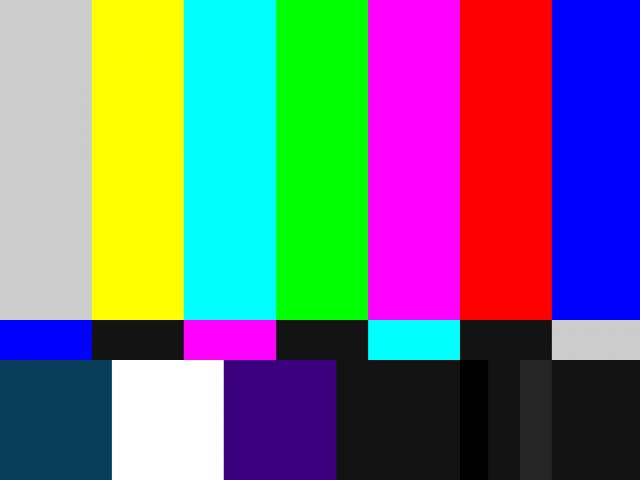

    The distortion looks more like a lack of red. Hence the blue-green tint. Test it using a computer with some colour bars, like the attached.
    On all inputs, composite video and component, HDMI, VGA...?

        LCD fixed.....new main board.....fault was only on HDMI not through Freeview, so order 2nd hand main board and its up and working as it should now
        cant thank you enough tom for your advice on all my topics
