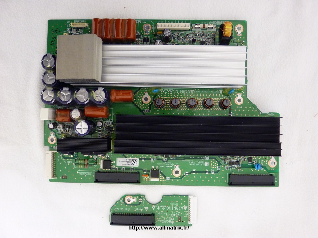

plasma tv LG model 50PS3000-ZB, Z SUS board EAX 55361501
  • ANDRASONI LUCIAN
    • May 2012
    • 56
    • Romania
    I need schematics diagram for this board because Ihave IC402 very burnt and I can'nt read his marked is some ISR2****.Image is very dark .Thanks,from Romania
    Re: plasma tv LG model 50PS3000-ZB, Z SUS board EAX 55361501
    Sadly you won't find a service manual for these boards because they are not published by LG. What is the fault with your model?
      Thanks for reply.Image is very dark sound OK.I have replace IC 402 with ISR21814, but i'm not sure if is the correct IC, because original IC is very burnt and I can'nt read the marked.
        That is the classic sign of a bad Z-sustain, so that board is likely at fault. Can you post a picture of the area the chip came from - it may be possible to make a guess/estimate of what component was used there.

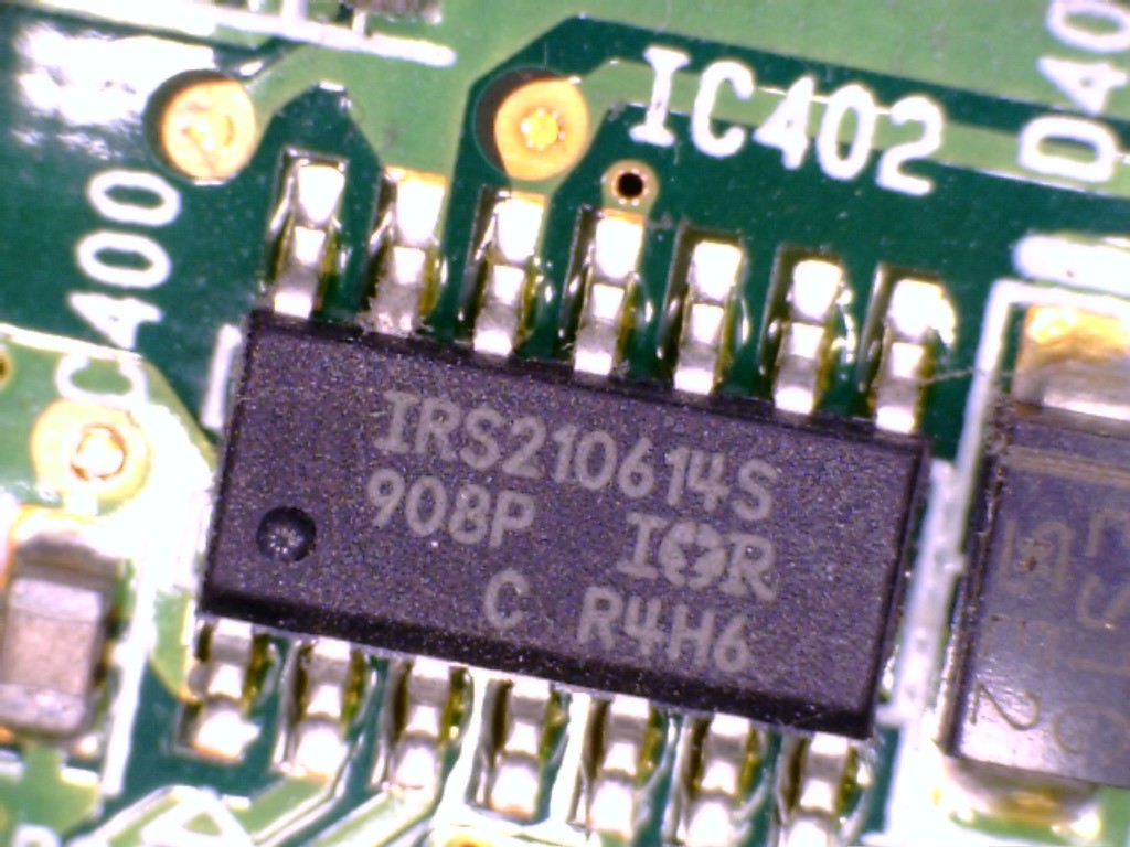

          I try this, IC402 is near diode D401, right down, thanks again very much you try to help me and scuse me if my english is not too good
            Your English is better than my Romanian!
            I can't really see the designations on that board - could you highlight the D401 component and the burnt IC in an image editor?
                That chip is likely a gate driver IC. Does it connect in any way to the MOSFETs on the Z-sustain board?
                  Yes, but i do'nt know the IC who i replace it is the correct IC , all service manuals who i find no contains Z sustain board, Ysustain board,POWER SUPPLY board and components list
                  • caryg
                    • Aug 2009
                    • 36
                    Probably too late for the O/P, but if anyone else has the same problem it's an IRS210614S
