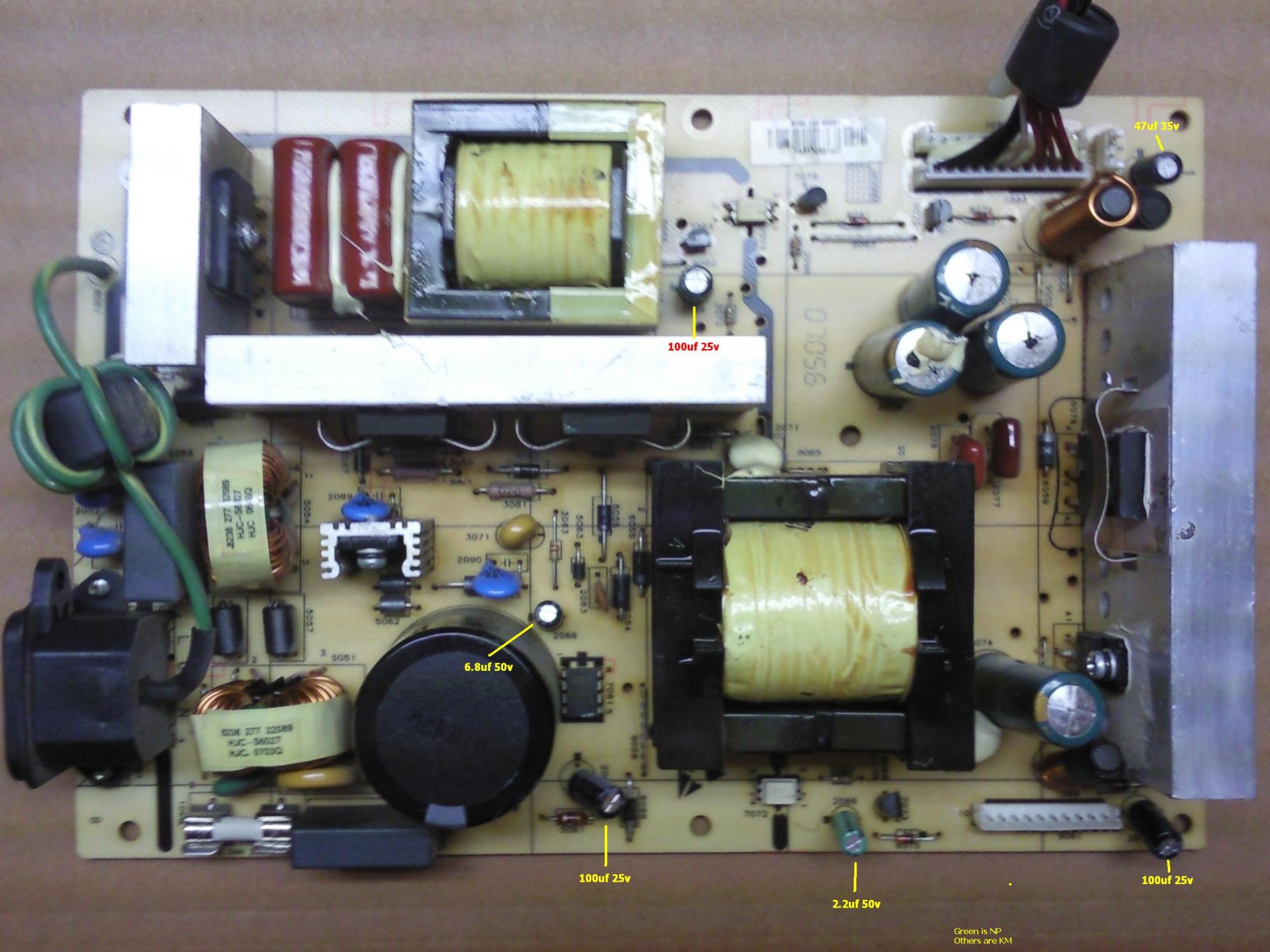

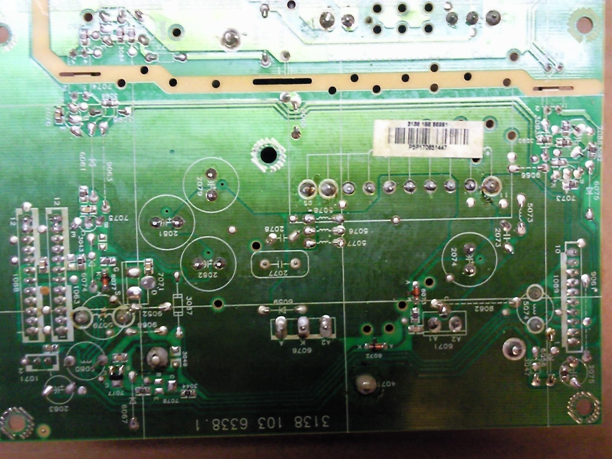

    Trying to see if I can fix this for a friend of the family. Symptoms are a steady flashing power button after it is pushed with no picture or sound. Has the normal bad caps and seems the diodes check out.
    I was able to find the spec sheet for the capxon gf caps so have 1 P12384-ND and 3 P12409-ND for replacements in the cart.

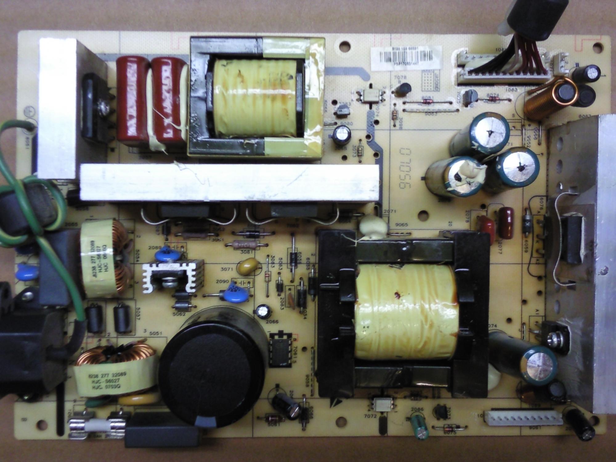

        Can you post a pic of around the connector going to the main board, and going to the inverter?
          Re: Magnavox 42MF521D/37B
          This power board probably has the same suspect diodes 6054, 6055, and 6056 as the Philips models.

            All diodes seem to read one way but some do climb. Those you listed are 500-600 and steady.
            The frame does have a LG.Phillips sticker.

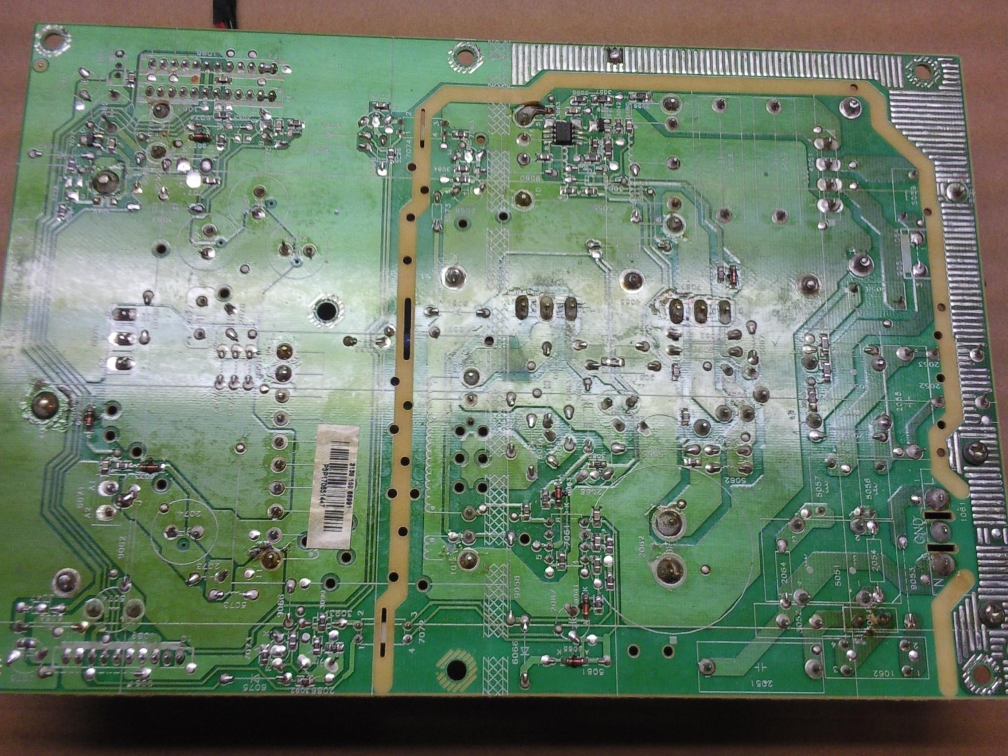

                Well i tried it and at first the power button lit up and got bright staying on like it should when working fine but the screen never lit up. I turned it off and realised i forgot to plug in the left inverter. So i unplugged it, let it sit for a bit and plugged in the inverter to try again. This time it acted like it did originally where the power light blinks and won't shut off after being pressed.
                Sorry for the bad pics, all i have is a cell camera.

                  Check you're getting a good +24V going to the inverters.

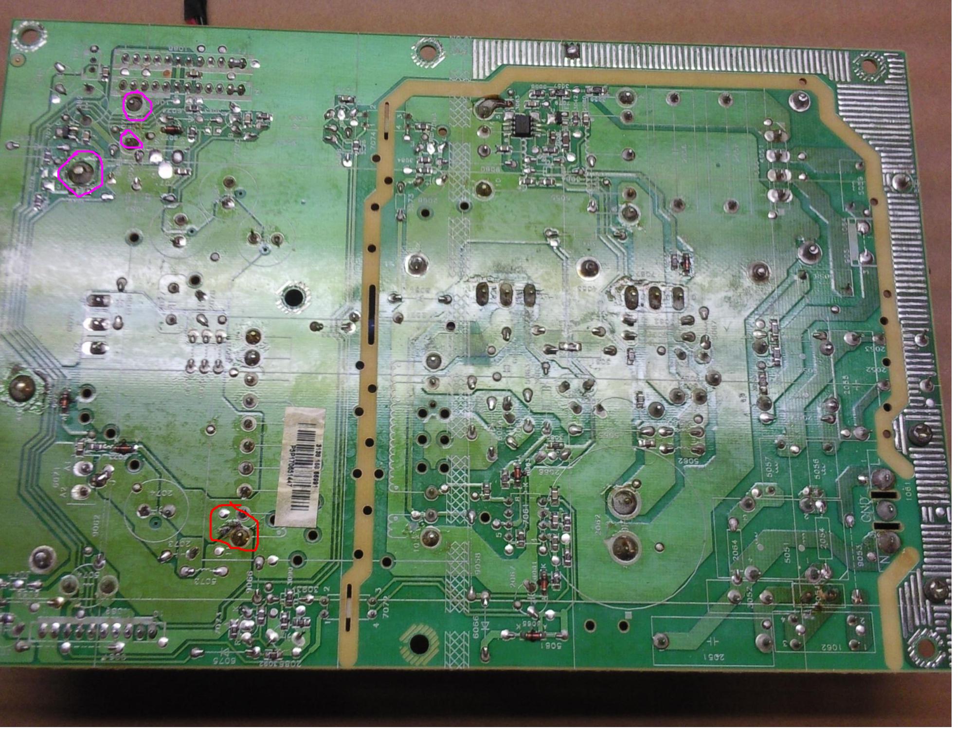

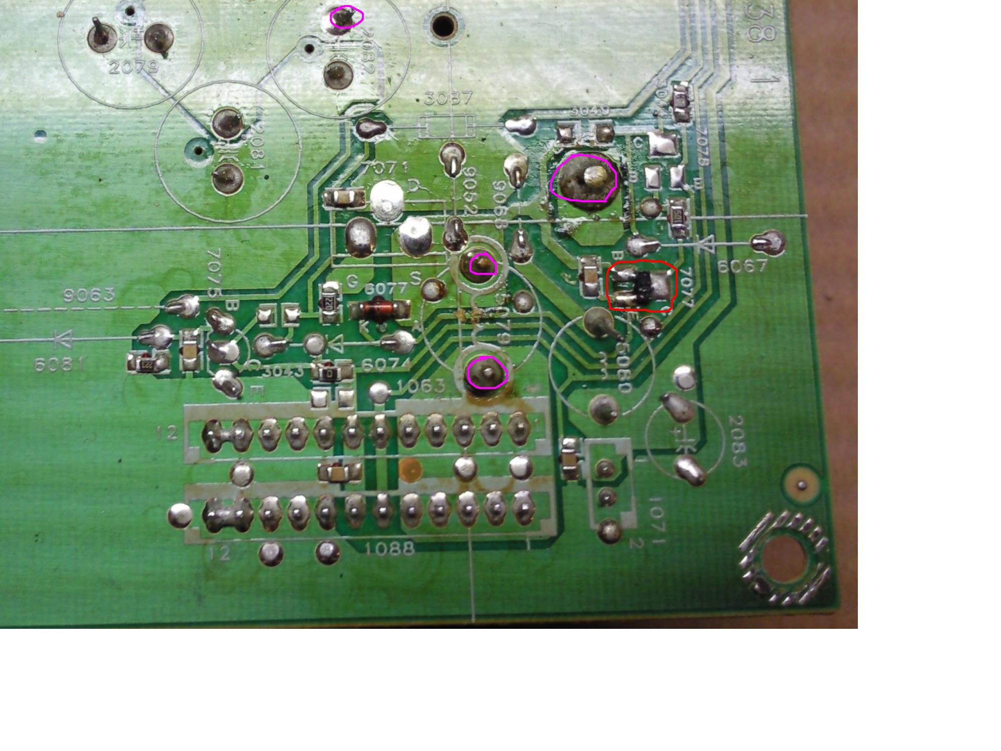

                    As you say pics are not great however can you look near pin 11? on the big transformer
                    there is something doesnt look quite right as though it might be shorting/arcing.

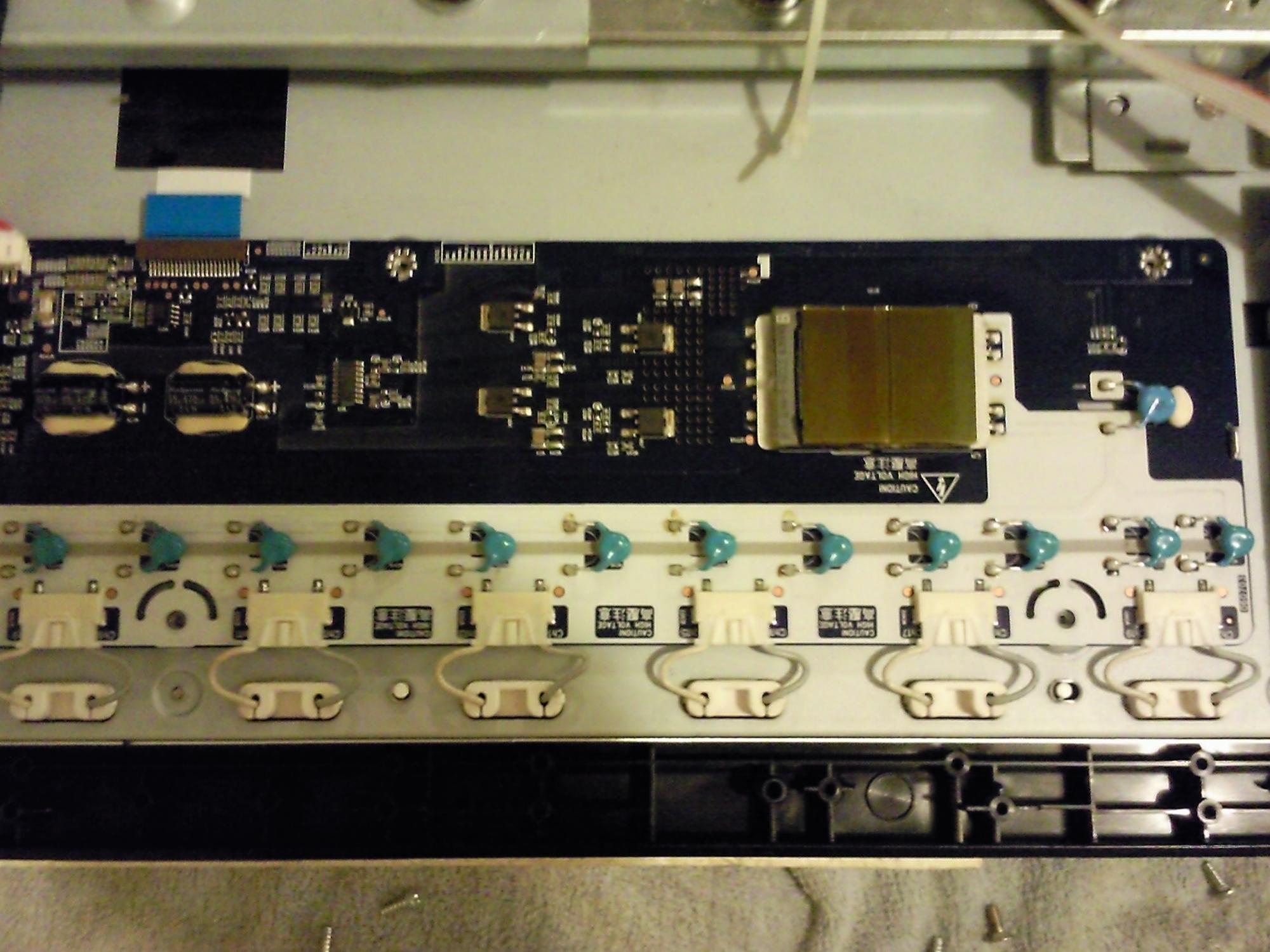

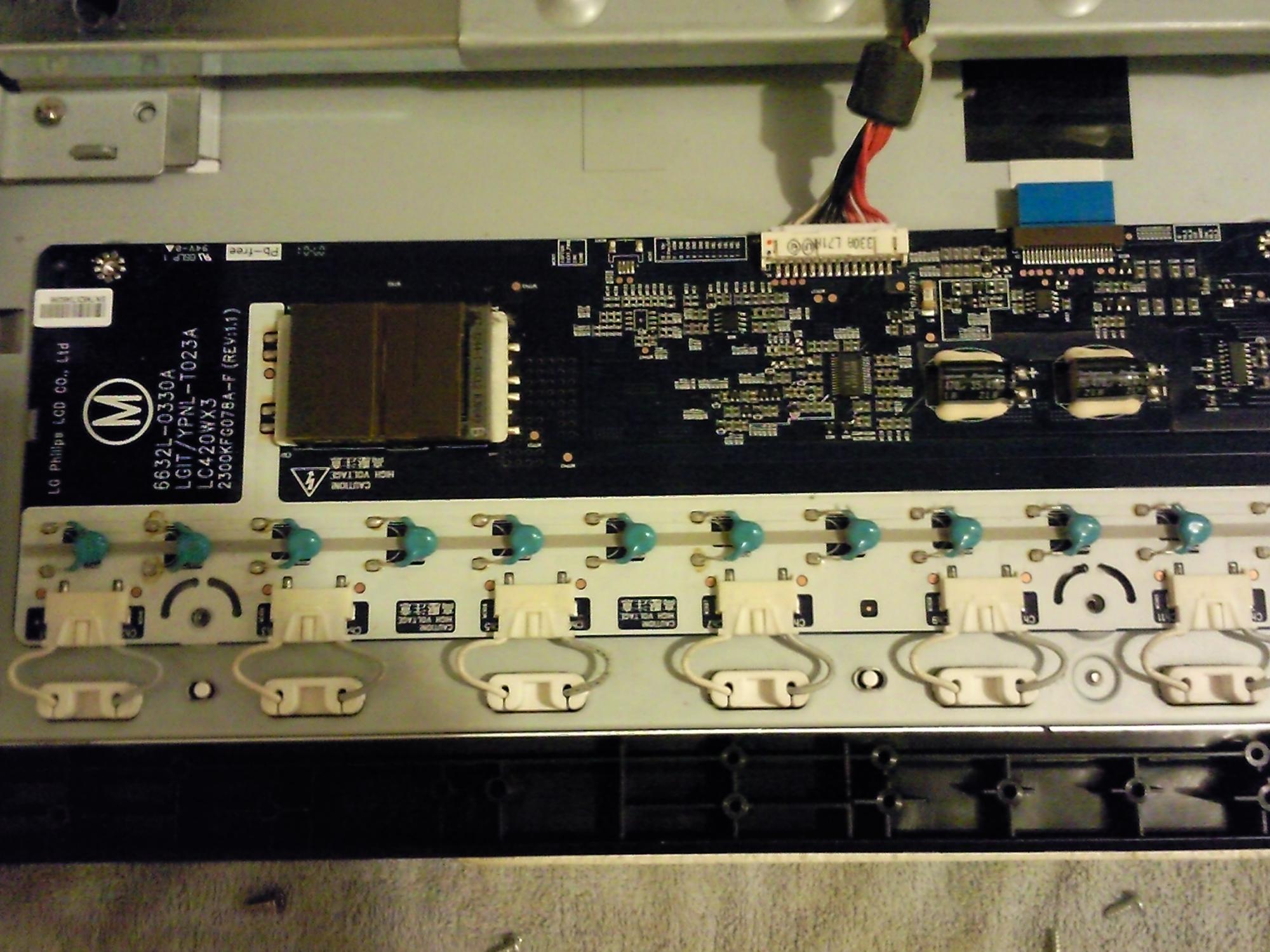

                      Here are pics of one of the inverters.

                        Yes 11/12 on both plugs are bridged. Looks like it is supposed to be there.

                          DC 200V range. Test the red and black wires. It might be easier to test it at the inverter plug.
                            They were all bouncing from 15-23v except the out side red on wire on the left inverter. It was dead.

                                No didnt mean that - see attachments I meant the red circled bit in reflow2
                                In reflow I have marked in red something which looks a bit burnt - is it just the pic.? I have also ringed joints in pink on both that could probably do with
                                re touching but again it could just be the pic.

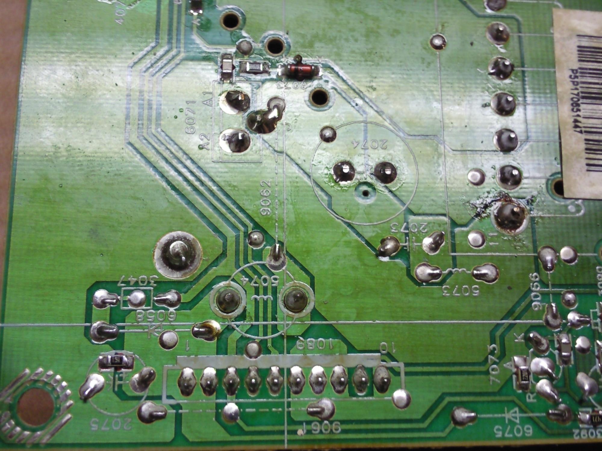

                                  That is flux that was on there and the pic. Some joints did have a bit too much solder and those pics are from before i capped it.
                                  The fuse was the first thing i checked.

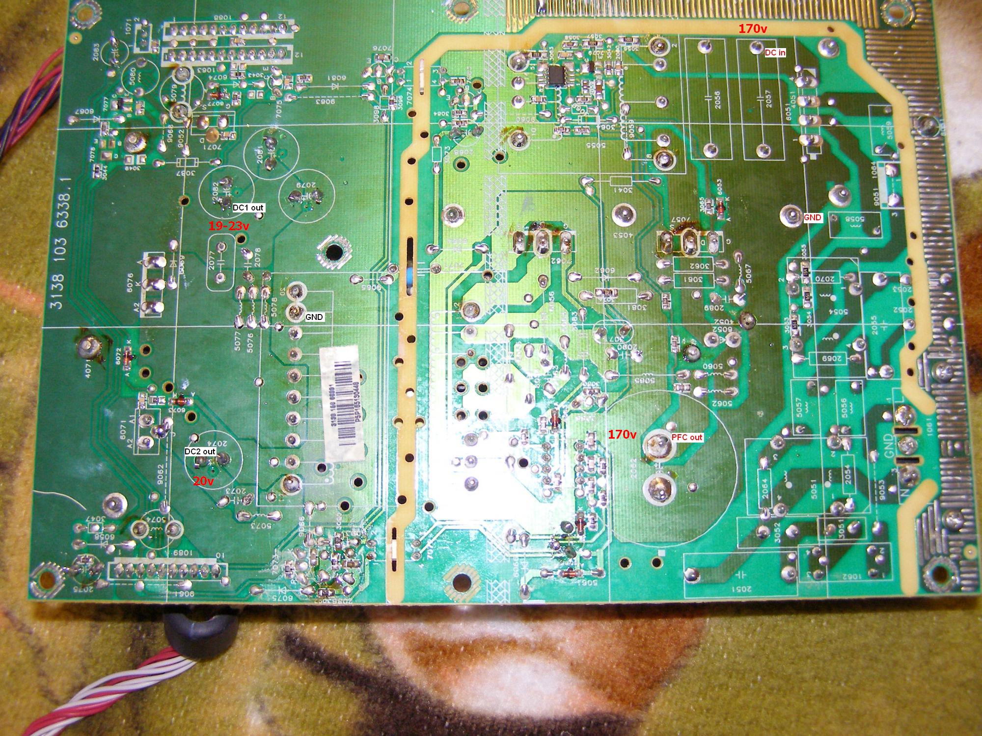

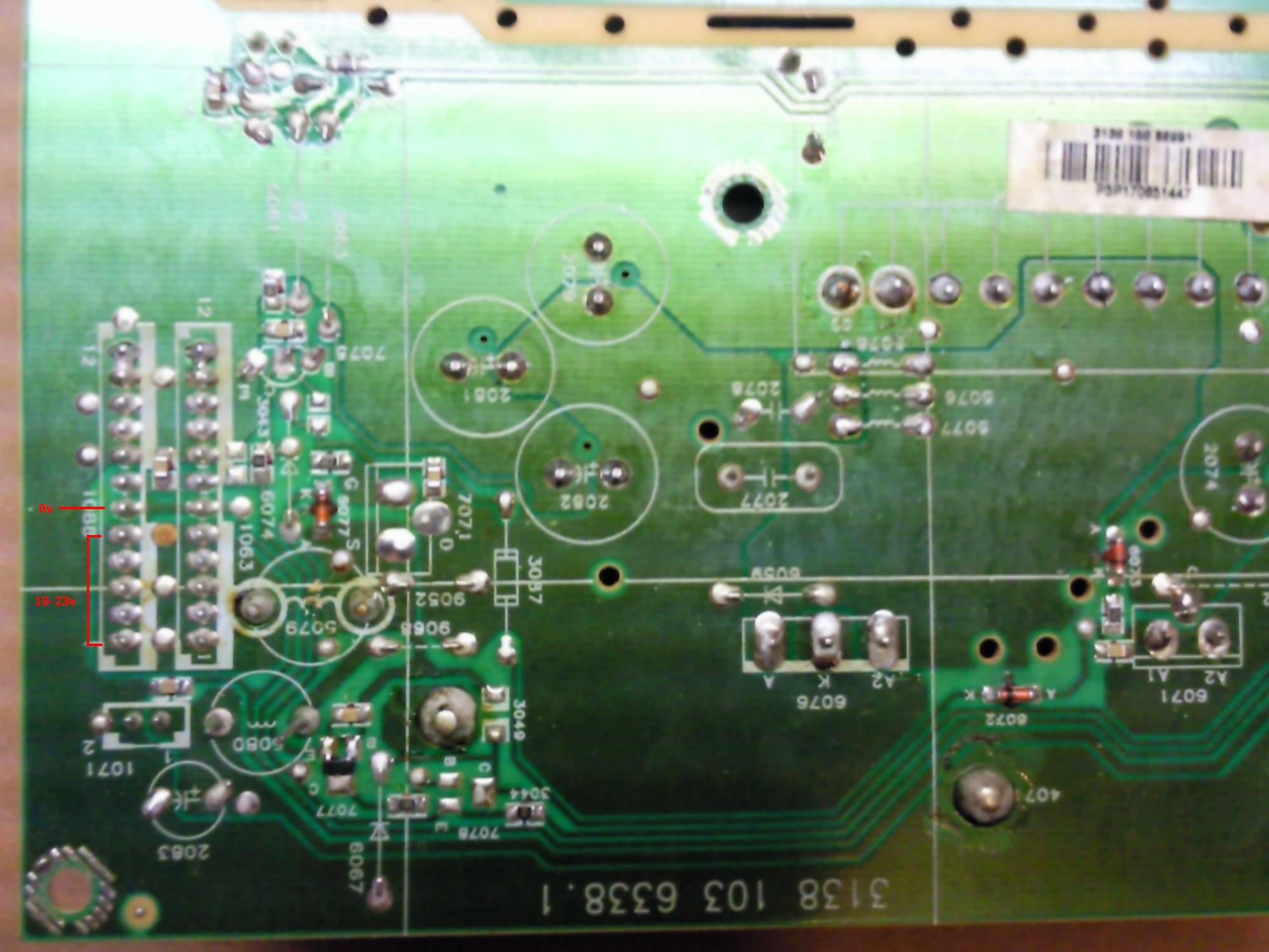

                                    Following a test that Plainbill suggested in another thread on one of these i came up with a low voltage and fluctuating readings.
                                    https://www.badcaps.net/forum/showpo...2&postcount=13
                                    DC1 19-23v
                                    DC2 20v
                                    In the 2nd pic it shows the voltage for the inverters. Should i be getting any reading on the middle 2 pins?
                                    I'm not sure what i should be getting on the pinout for the logic board or what is what. The wires alternate red/white/red/white etc so I didn't poke around there.
                                      Did you miss Tom's post where he said it could be the startup cap?
                                        Woops
                                        I'm guessing it would be near the ic chip and the big cap. There is a 6.8uf and a 100 uf and i'm not sure which it might be. I've actually been trying to scrounge up some from junk i have laying around to test but all i've come up with is new 2.2uf fc's i bought extra of.
