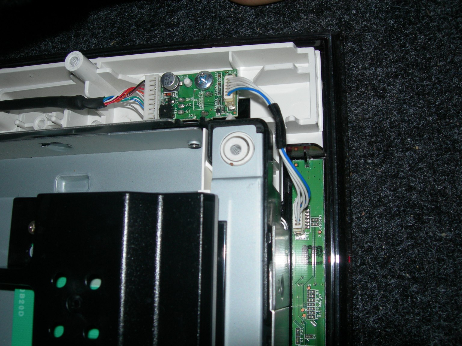

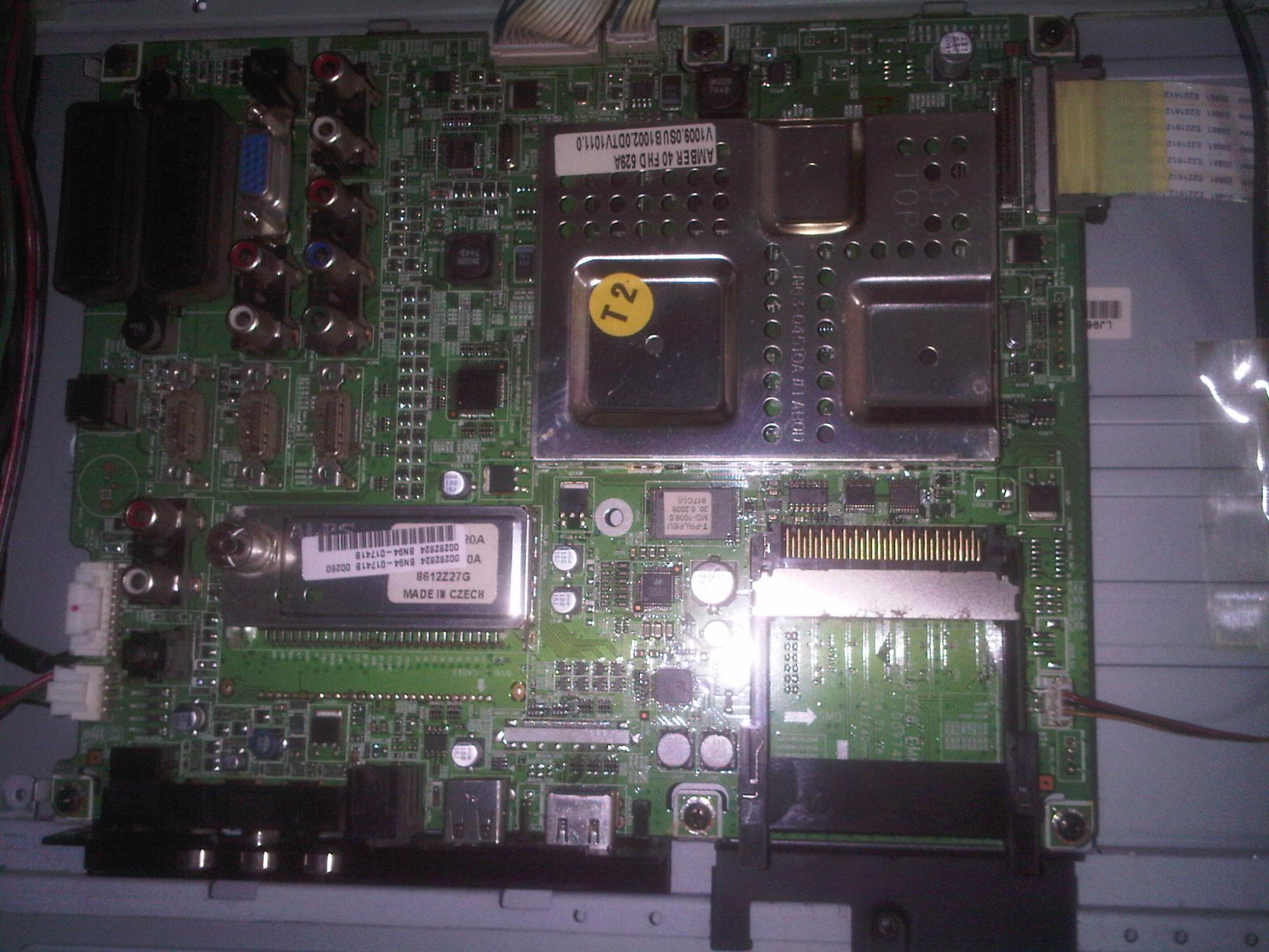

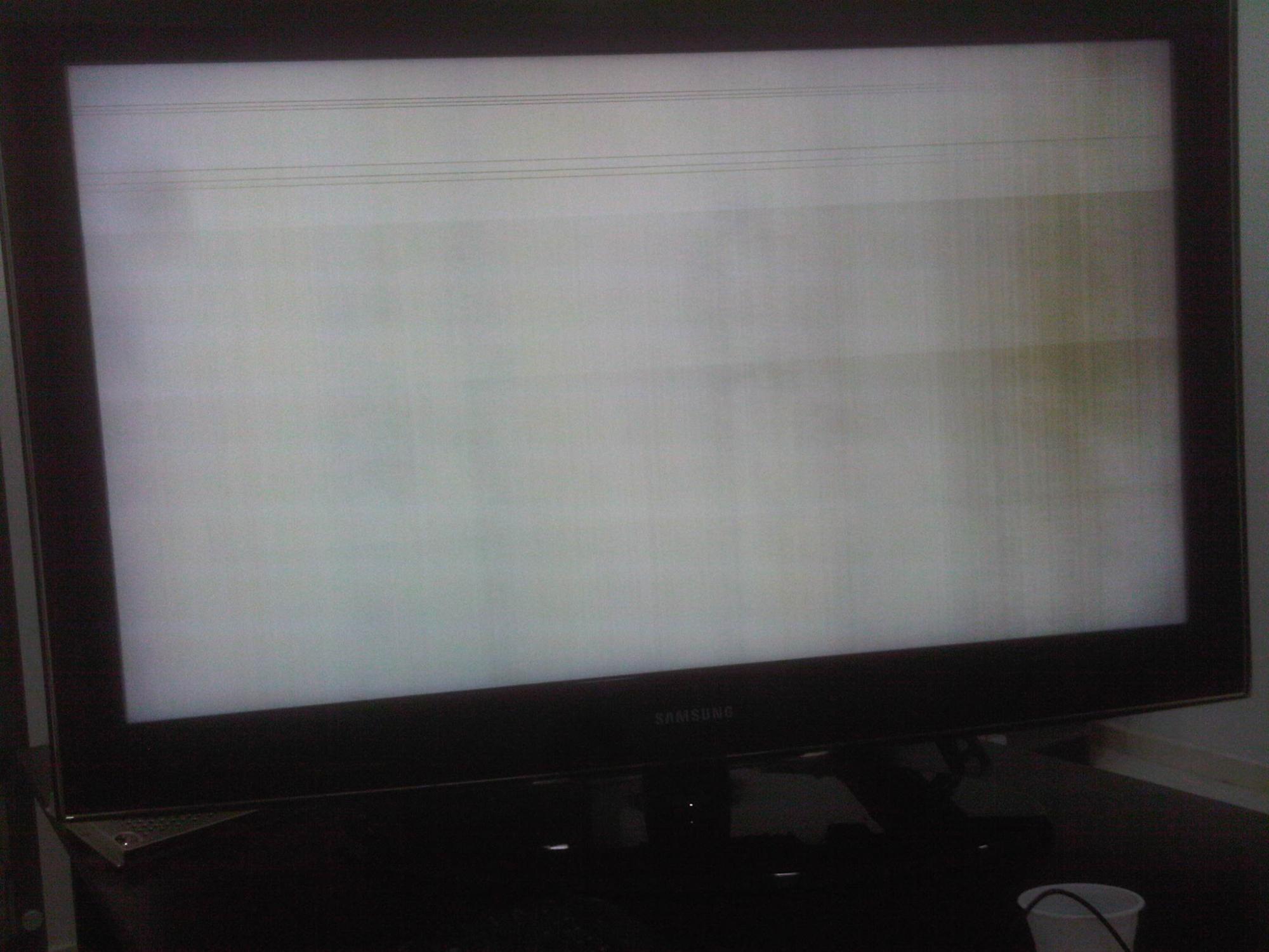

      Got the TV today.
      When I saw the fault, it doesn't seem too bad actually. Definitely still watchable, only faintly noticeable. Definitely doesn't look like panel, it's not on or off, and it flickers. Almost looks like bad SRAM on the T-con or main, the trouble is telling exactly which.
      This TV also has USB though not as good as the Samsung plasma I fixed which could play videos. This one can only display JPEGs and play MP3s.
      I'll crack it open later... it's still in the car. Big beast, very pretty red frame.

            Yes! It does have a Samsung panel.

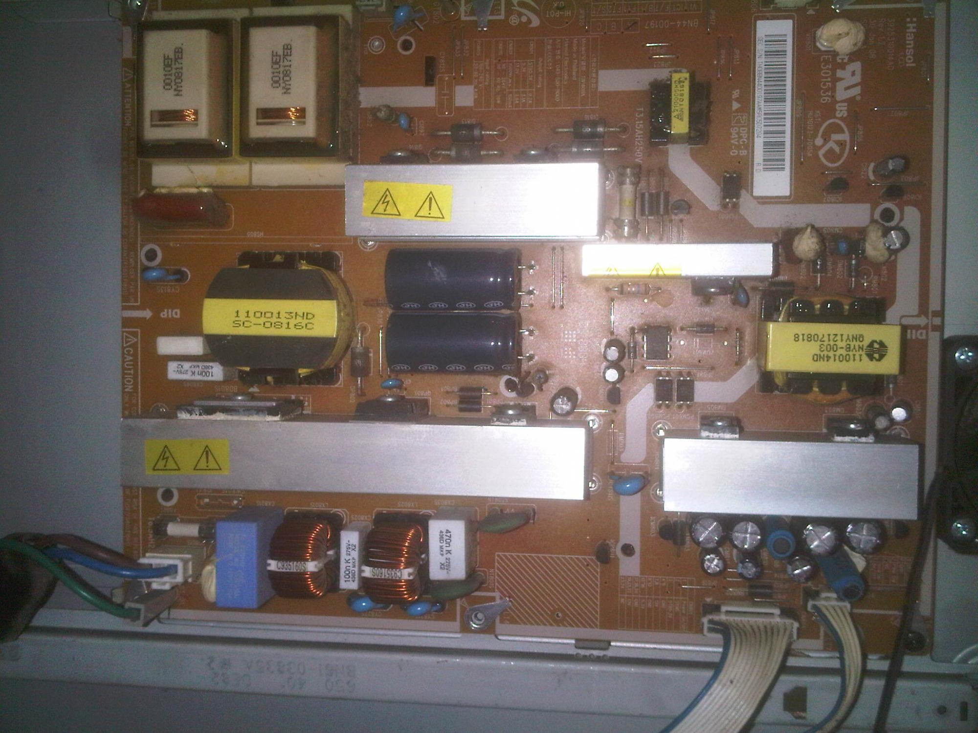

            Okay, when I first got the set, the user remarked the side buttons didn't work, they are some kind of touch sensitive ones. Also I noticed no power LED, which I would usually expect. So, I reseated the connector cable. Result: working buttons, and a power LED. I'm surprised it came loose - it maybe it was not seated properly from the factory. It wouldn't surprise me for Samsung.

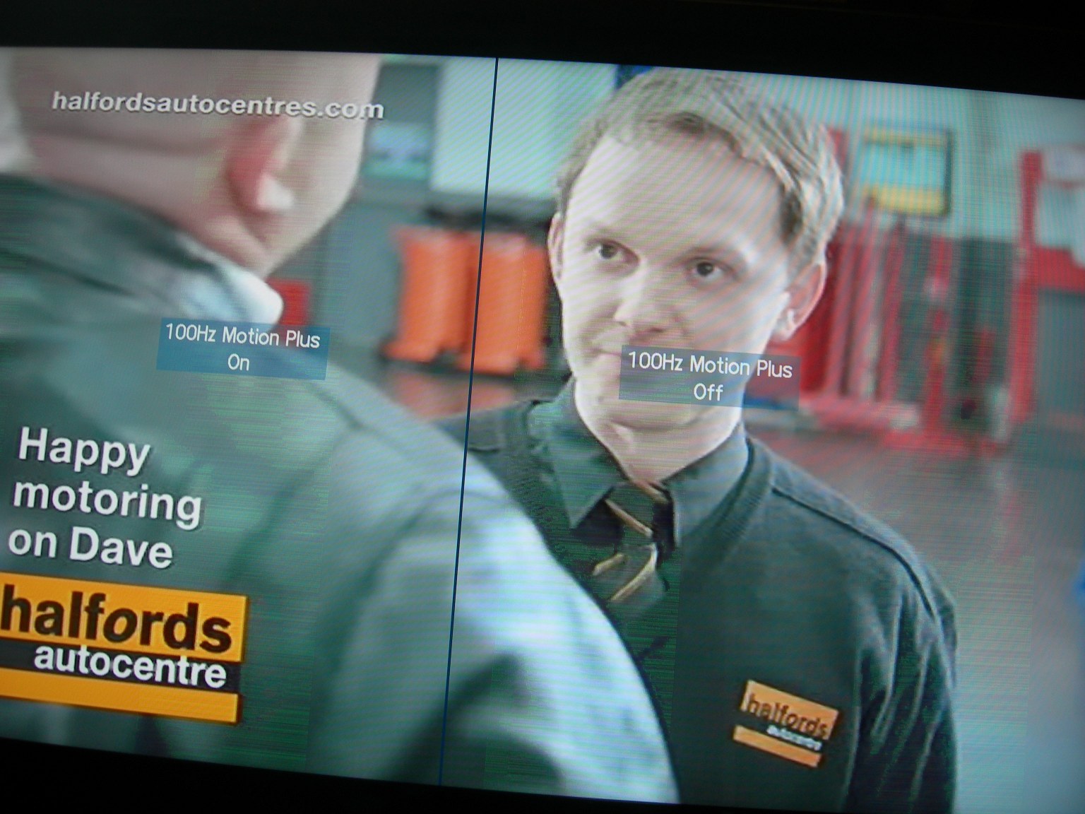

            The picture is worse with brighter images, but it is definitely digital noise. Not a panel problem, I'm fairly sure. The noise isn't stationary, it flickers and tends to follow objects of certain colours. And it is fixed in those locations. I'm thinking it's a problem with the big heatsinked IC - I suspect this is the 100Hz motion processor, as there's a separate IC which looks like a T-con processor, which is simply attached to the casing of the T-con for a heatsink.

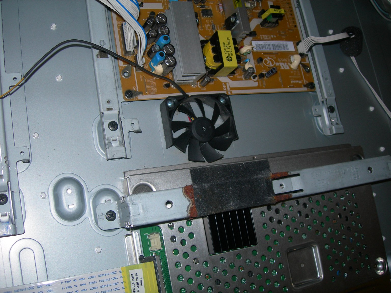

            Also, this thing has a friggin' fan? I wondered when I first plugged it in, I heard a grinding noise from the back of the set, so I'm trying to figure out... does it have a HDD? No, it is just a cheap, noisy fan. Any idea on how to fix it? It's not a normal fan - it's got the top of the housing removed so it sucks air through the 100Hz motion processor.
            And, I did try the 100Hz motion plus technology. It works okay, but only when things are scrolling or moving in straight lines - otherwise, it doesn't really help motion that much. But it certainly doesn't cure LCD blur, which this TV is more or less immune from, except for certain scenes, but it doesn't look anywhere near as bad as a CMO/Chungwha. The advertising where they show blurry objects is completely wrong: it corrects for jagged movements, from the 25Hz update rate of normal TV, *not* for blur. It doesn't fix LCD blur, it can't - the LCD can only change as fast as it is capable of, and having 100Hz motion plus technology wouldn't improve this either way. Marketing bollocks.

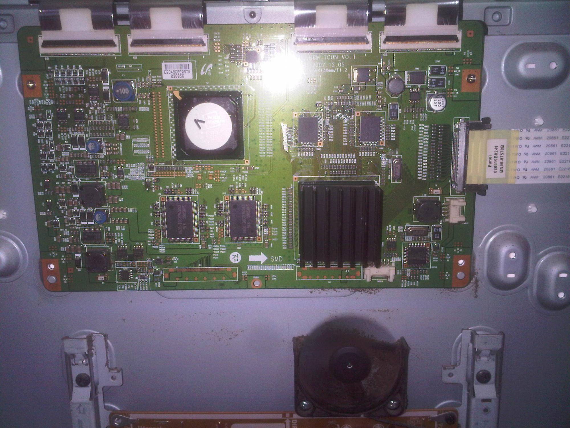

            Oh, and the T-con is different to the one linked, so I'll have to find a replacement.
            I'm going to scope the LVDS waveforms to check if it's a main board or T-con problem, but I suspect T-con.
              Re: Samsung LE40A656A1F - Possible T-con fault?
              Okay, a few tests.
              It only affects the green channel. Red and blue are fine.
              It can't make pixels "whiter than white", which suggests to me it is digital noise.
              Motion Plus doesn't affect it either way.
              Pressing on main processors doesn't affect it.
              It is evenly spaced, but not related to the position of the four ribbons.
              Removing some ribbons doesn't make the problem go away on the rest of the screen.
              I attempted to reflow the board with no luck. (Just to see if it would fix it, then I would order a new board.)
              The T-con looks identical, except it's for a 46" and it's got extra LVDS connectors (not for panel, and it has the one I need... on my board there are pads for them, but they are not installed.) I think it will be fine for the 40" version though. Budm, have you used mixed size T-cons before, does it usually work?

                I checked the LVDS waveforms with a green signal with noise on it, and no noise appears on the waveforms. This makes me think the noise is coming from the T-con. So I am definitely considering replacing the T-con but I would like input on whether the 46" will work on the 40" model. Anyone know? The board looks identical, but perhaps it has been programmed for a certain screen.
                  Okay, so I went into the service menu and changed the LVDS waveform. Of course, this distorted the picture (colours messed up.) But the noise on the screen stayed the same. This tells me that the noise is likely caused by the T-con. I'll probably take a chance on that T-con. Did factory reset, no dice.

                    I've ordered the board. I'm going to take the chance that it's compatible. If it's not, I'll just sell it on ebay cheap.
                      #30
                      YES!!! Another TV fixed .
                      The 46" board is completely compatible with the 40" - even with the jumpers on the board seemingly indicating different versions.

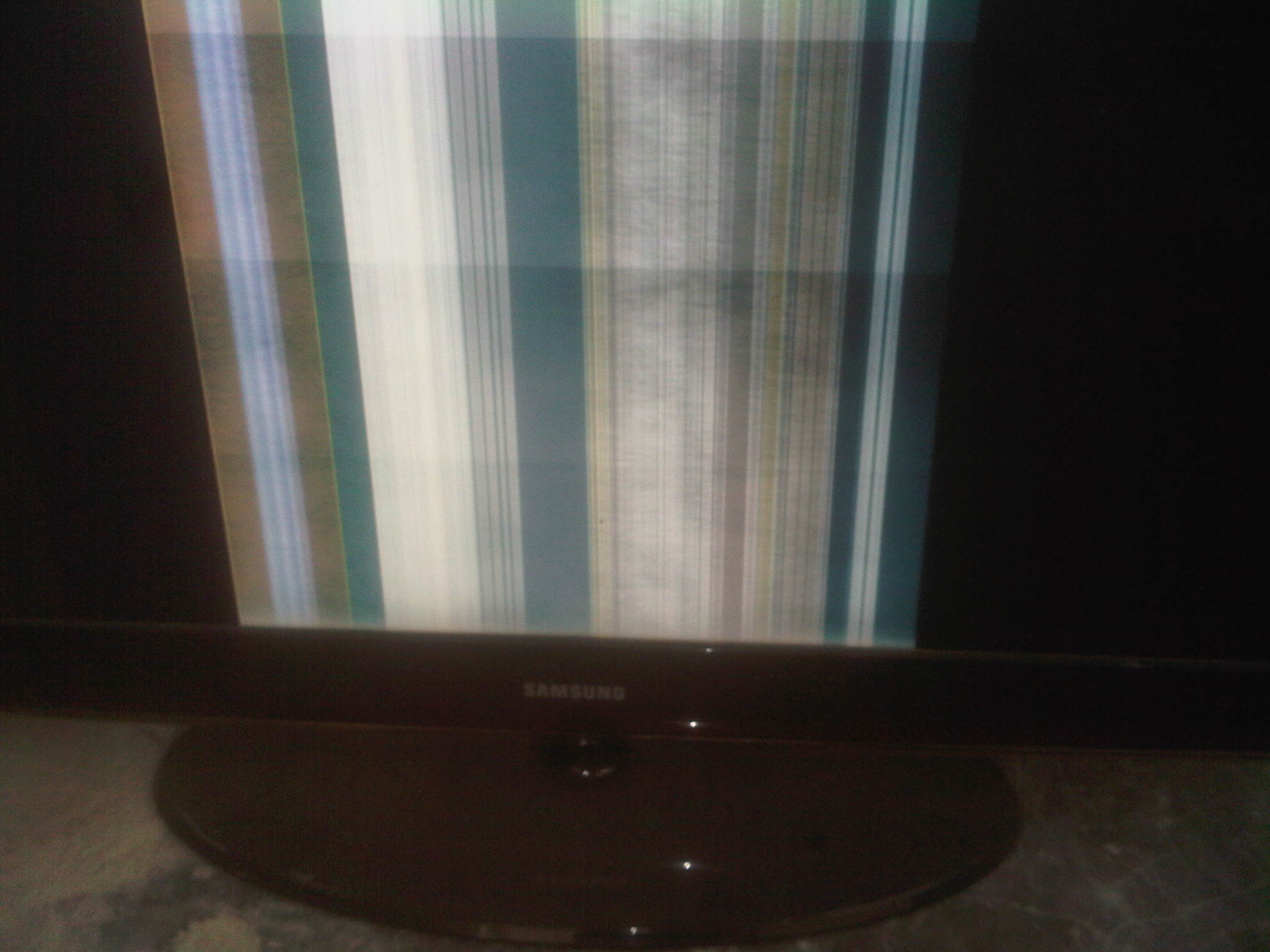

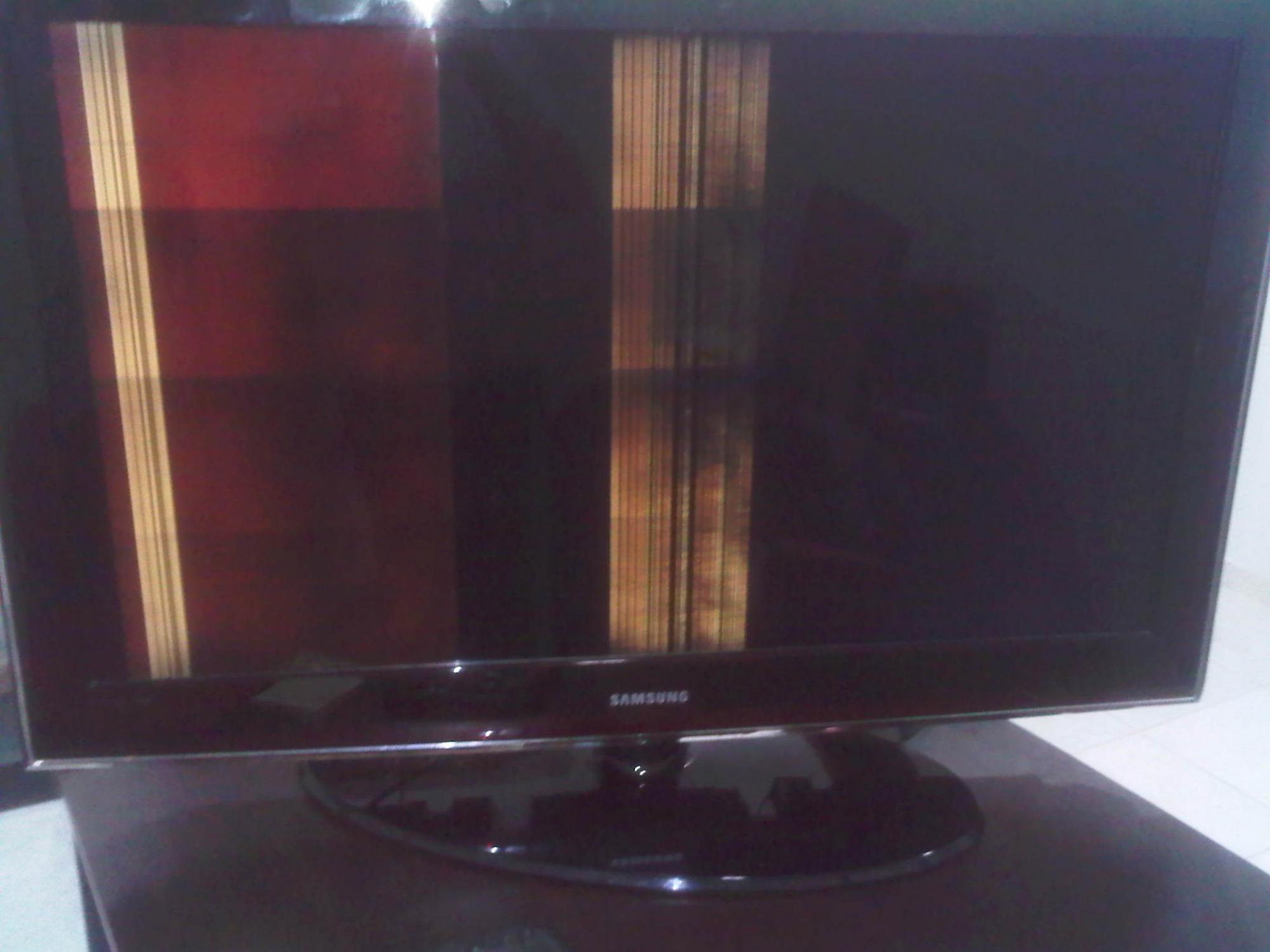

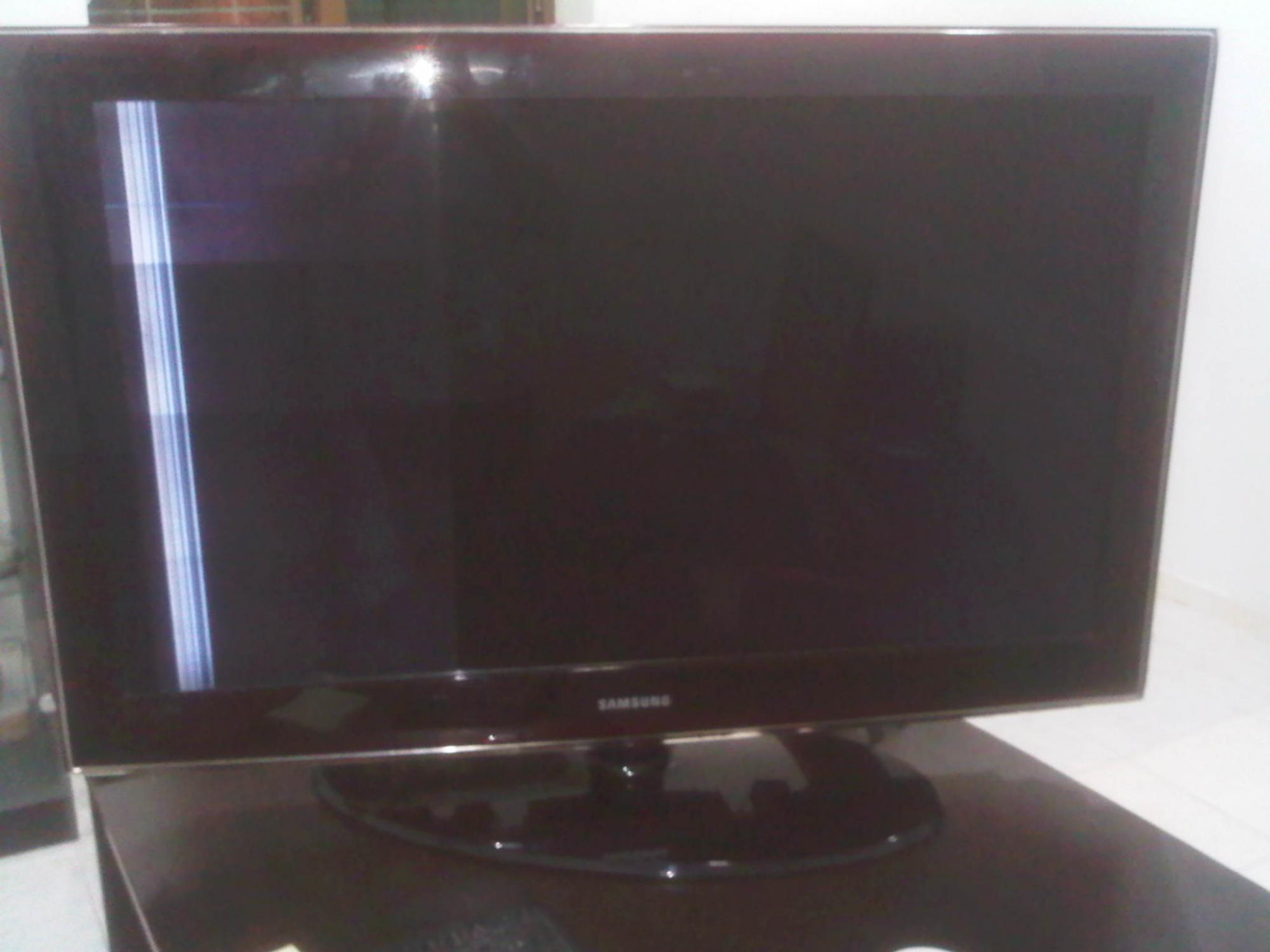

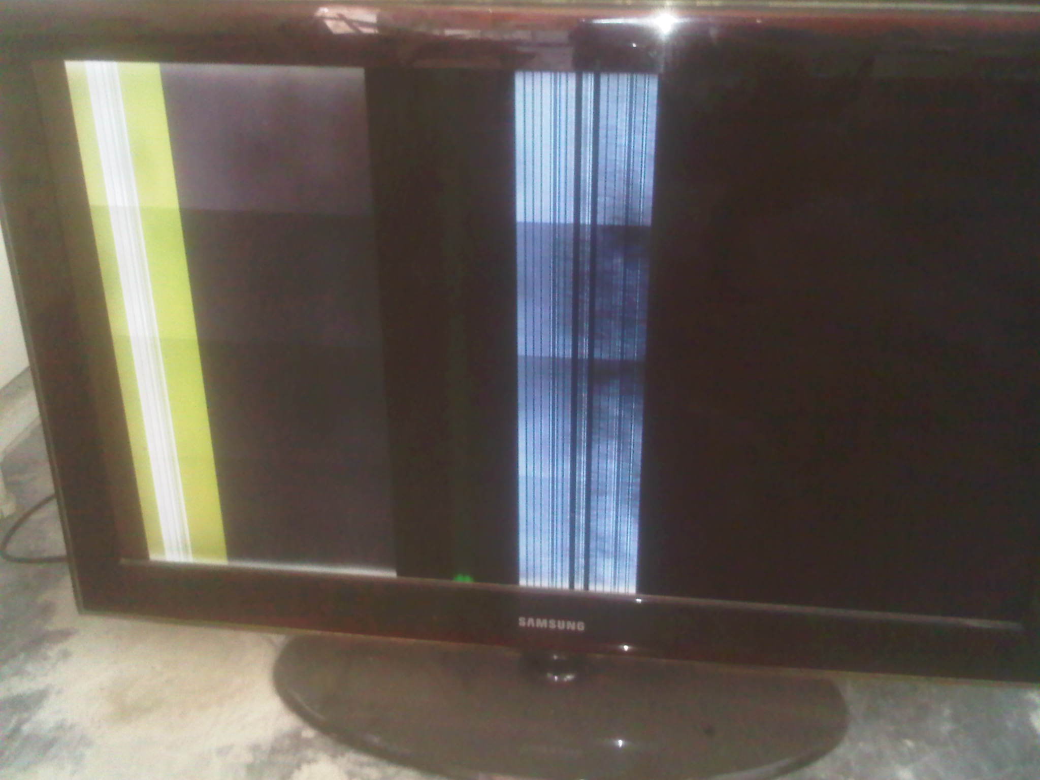

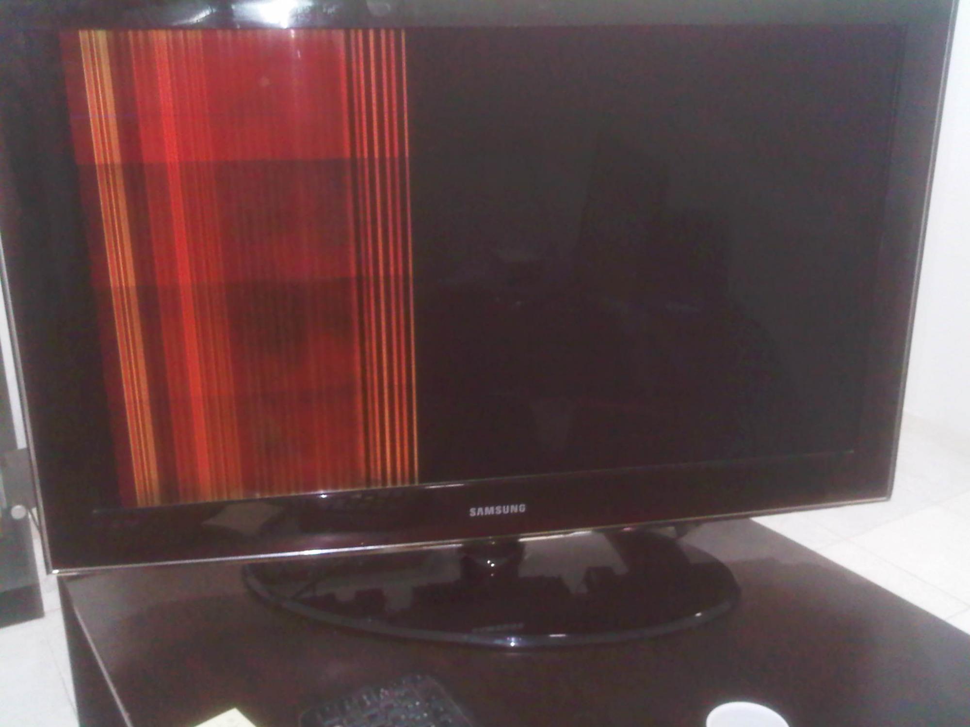

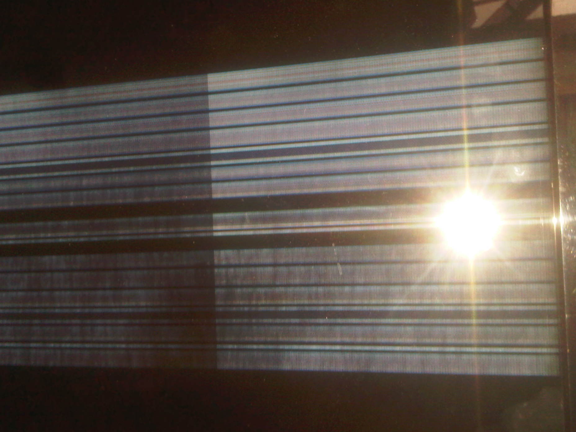

                            hello guys and specially tom66.
                            i didnt want to open a new thread cos the title would be "Samsung LE40A656 - Possible T-con fault?".
                            well, i have got a LE40A656 with the following symptoms:
                            Tv switches on/off correctly with the samsung jingle.
                            switches and functions are ok.
                            the screen displays the following distortions as shown in the pictures.
                            done:
                            re seated the lvds cable. no improvement.
                            pressed tab bonds. no effect.
                            recapped, although voltages are still 5,05 the 5,4V rail and 12,89 the 13V rail.
                            voltage at t-con is 12,4V
                            i guess it might be a t-con failure or panel, which btw is samsung (presumed good quality).
                            steps to do next?

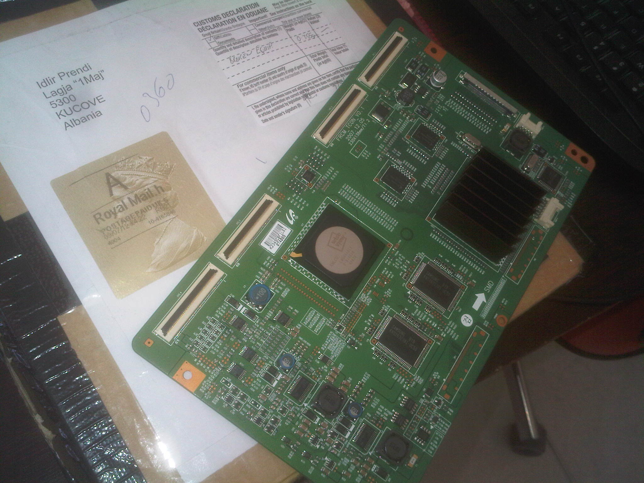

                              If it helps you diagnose the problem, I can send you my faulty T-con (with lines, so not a permanent fix, but it is watchable) for the price of postage.
                              I would suggest you begin testing all LDOs on the T-con.
                                i really appreciate it tom!
                                i am gonna let you know after testing the ldos by tomorrow! thank you very much!
                                  hello again!
                                  the new t-con supplied by tom did not solve the problem. it still persist. any possibility it might be the lvds cable, or i should surrender?
                                    #37
                                    My guess would be either main board, or sadly the panel itself :\. Is the T-con getting 12V (or 5V - forget which?) If you have a scope check ripple and stability. That T-con worked otherwise apart from faint lines on the screen.
                                      #38
                                      Also, try with just some of the LCD ribbons plugged in. If it works, then it could be a shorted driver flex, which would be a difficult thing to fix...

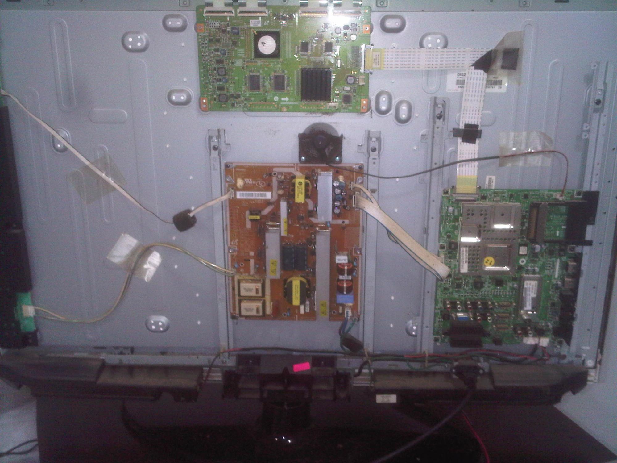

                                        well, thats getting weird.
                                        12V is steady.
                                        removing ribbon 1 (from the right to the left) showed bright colored vertical lines all over the screen.
                                        removing ribbons 3 and 4 caused: the half screen (attached to ribbons 1 and 2) worked ok.
                                        re-inserted all 4 ribbons and the tv was working properly. switched to the old t-con and it is still working ok. by the moment i have switched on/off 10 or more times and it is still ok. i bet the panel is coming near the end.

                                          You probably have a failing flex on the panel, but you're getting somewhere... maybe you can fix it by providing some rigid support? Those ribbons on mine looked really bad.
