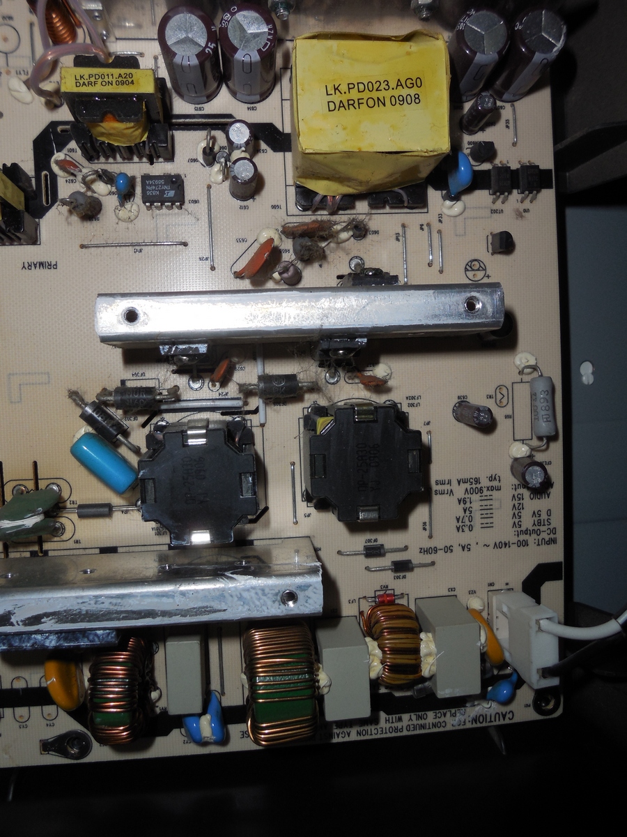

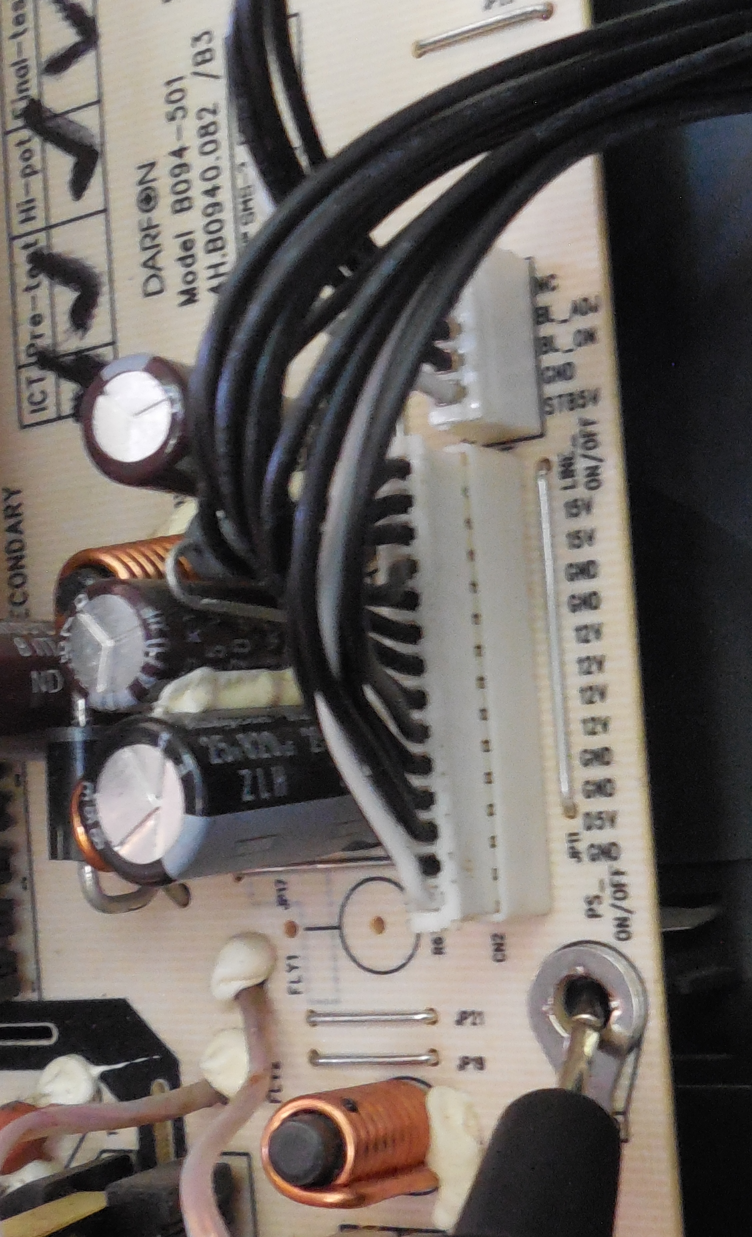

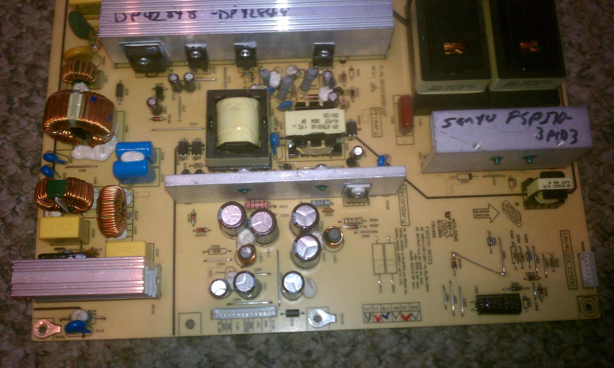

    OK, so you are not getting standby 5V?
    Can you please also take the pictures with better focus, it will make it easier to trace and point things out, thanks.

      Re: Sanyo DP46849 No Image
      Hpw do these look?
        Pictures are really out of focus, please sample on post 1 and 3. Your board is not the same as the original poster, for me to give you the test points, I must be able to see the components and traces on the board clearly so I can figure out how they are hooked up together, it is very hard right now the way it is since I do not have the board in front of me to see.

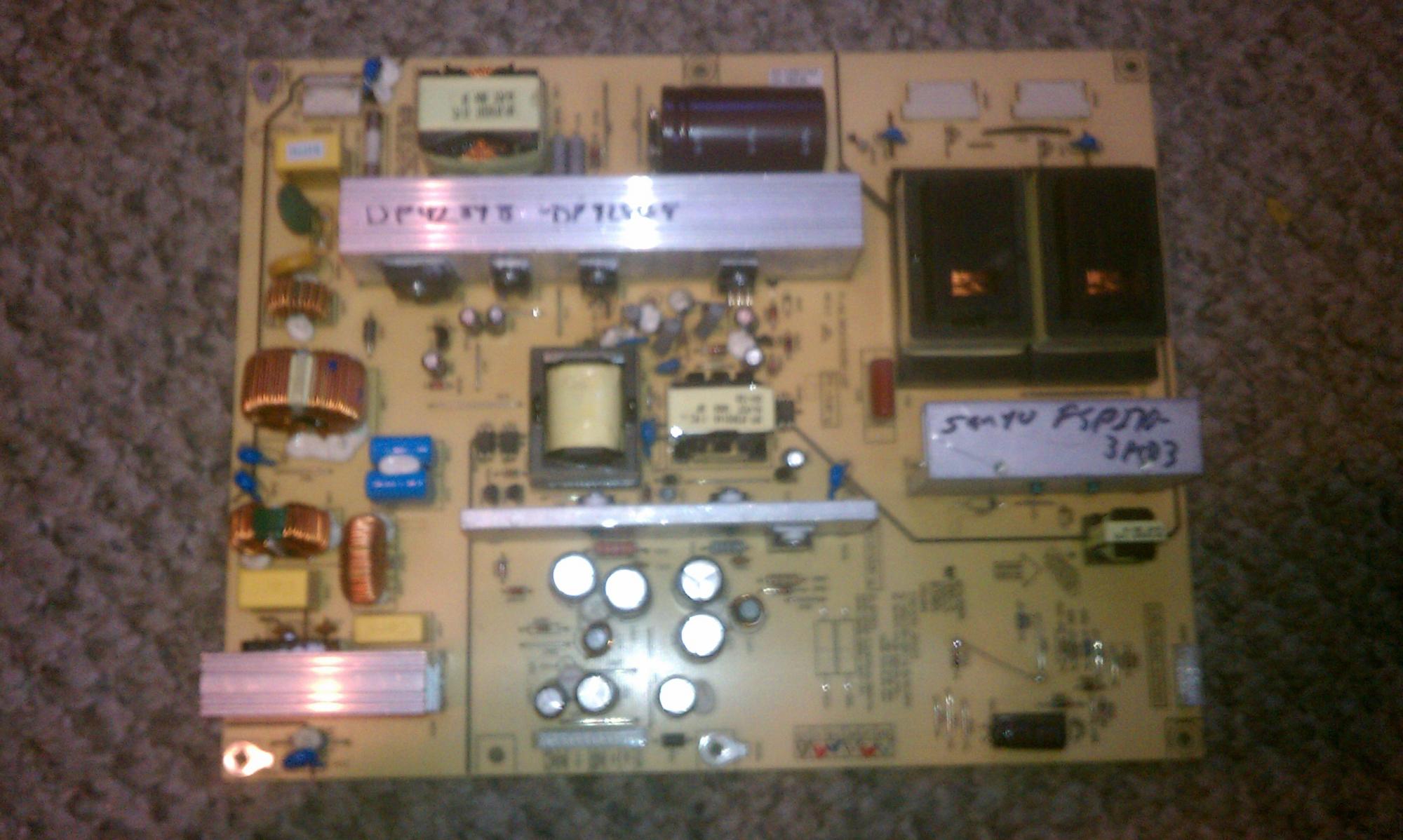

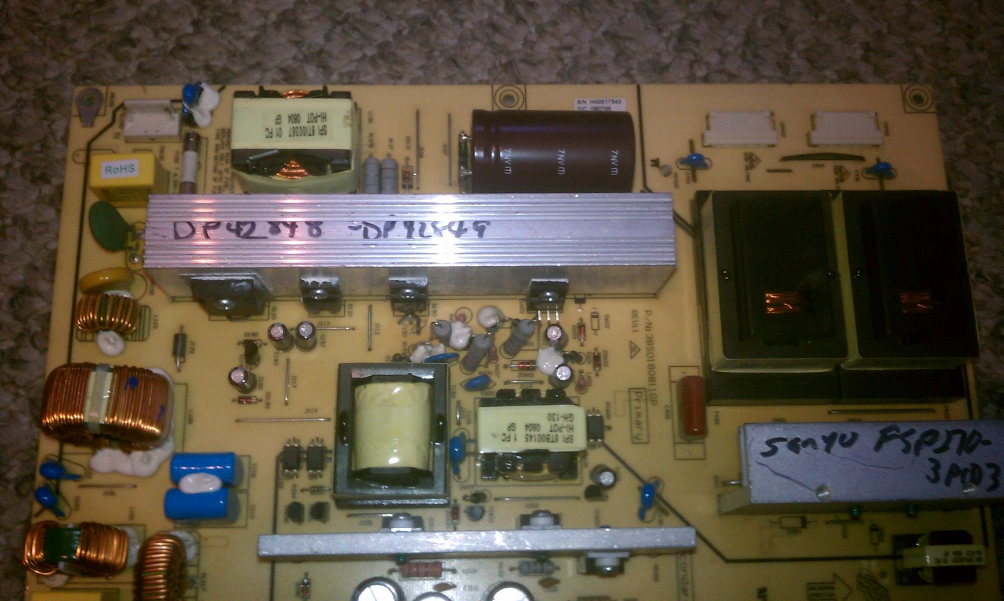

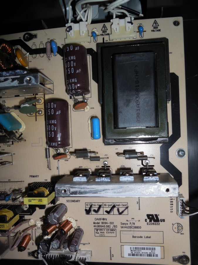

            Another Sanyo DP46849, my Green Stays on, picture comes up for a second or 5 then goes out, green light doesn't flash, it stays on steady. For a while multiple on offs would get a picture that stayed on for varying lengths of time up to bedtime but no longer. Now it goes out after a very consistent 5 seconds? Football season is 10 days off, wife is getting antsy. I checked all the voltages on the two connectors with green light on, no picture, got what is marked at every terminal. i don't see any suspicious caps but am stump dumb. I have no "dim pic" screen goes completely off. Thanks for any light!

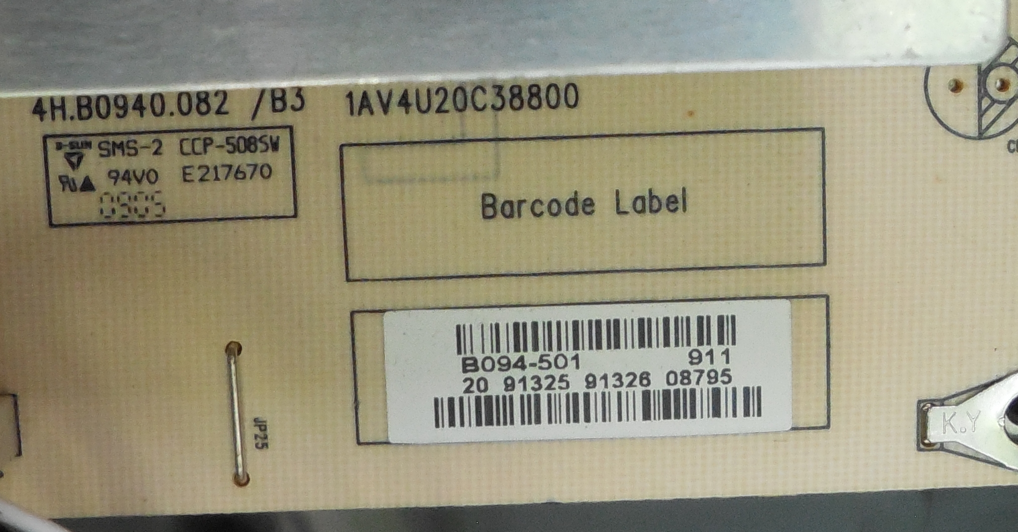

              a few more pics.
              Full disclosure;
              A few years ago a lightning strike took out 1 of 3 HDMI inputs on this set. all else has functioned fine since. We live on ah ill and do get some near by lightning on a regular basis.

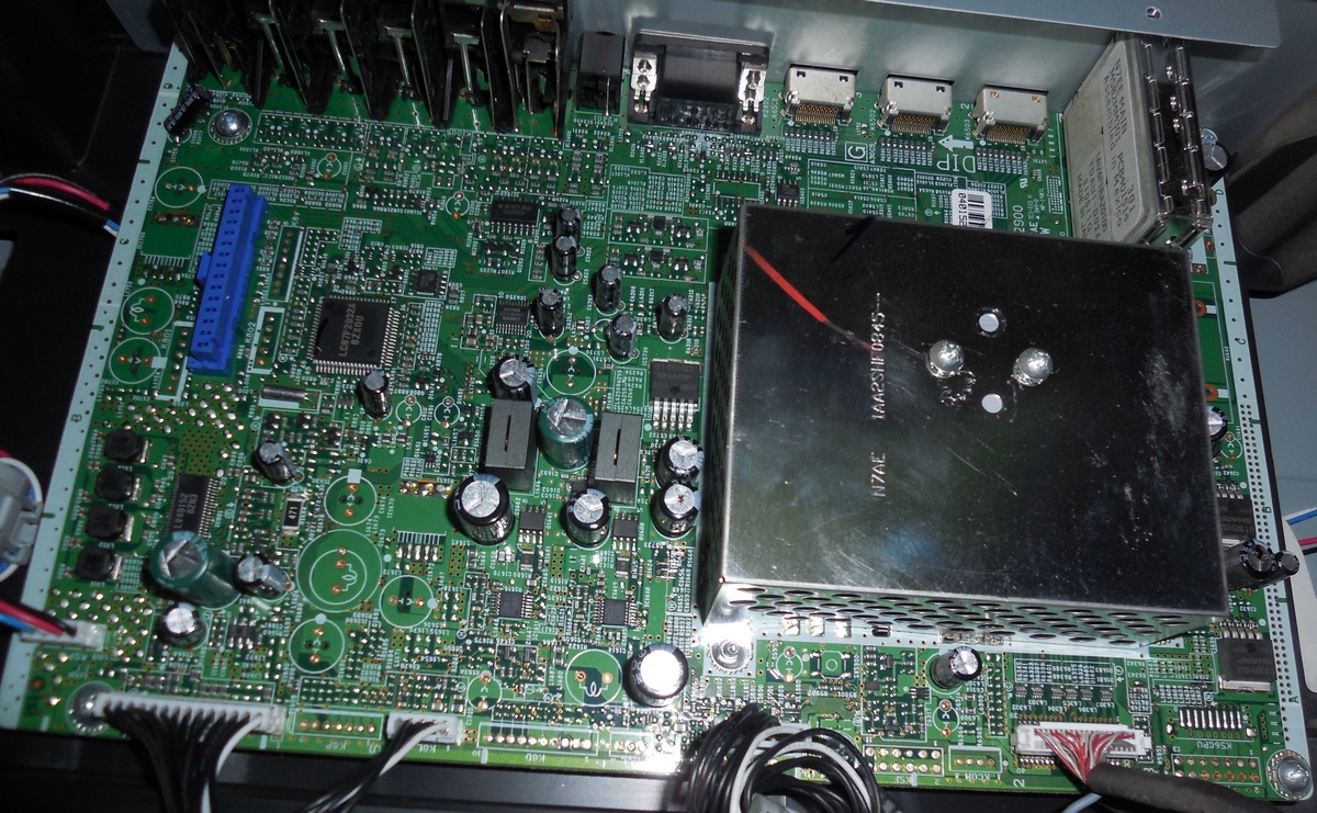

                a few more pics.

                  With flashlight do you get an image showing on screen. If you look from back do you see backlights on
                    No, when the pic goes out, it is totally black.

                      So backlights are going off?

                        yes they light for the same short time as the picture.

                          The green light stays on but with flashlight there is no image on screen
