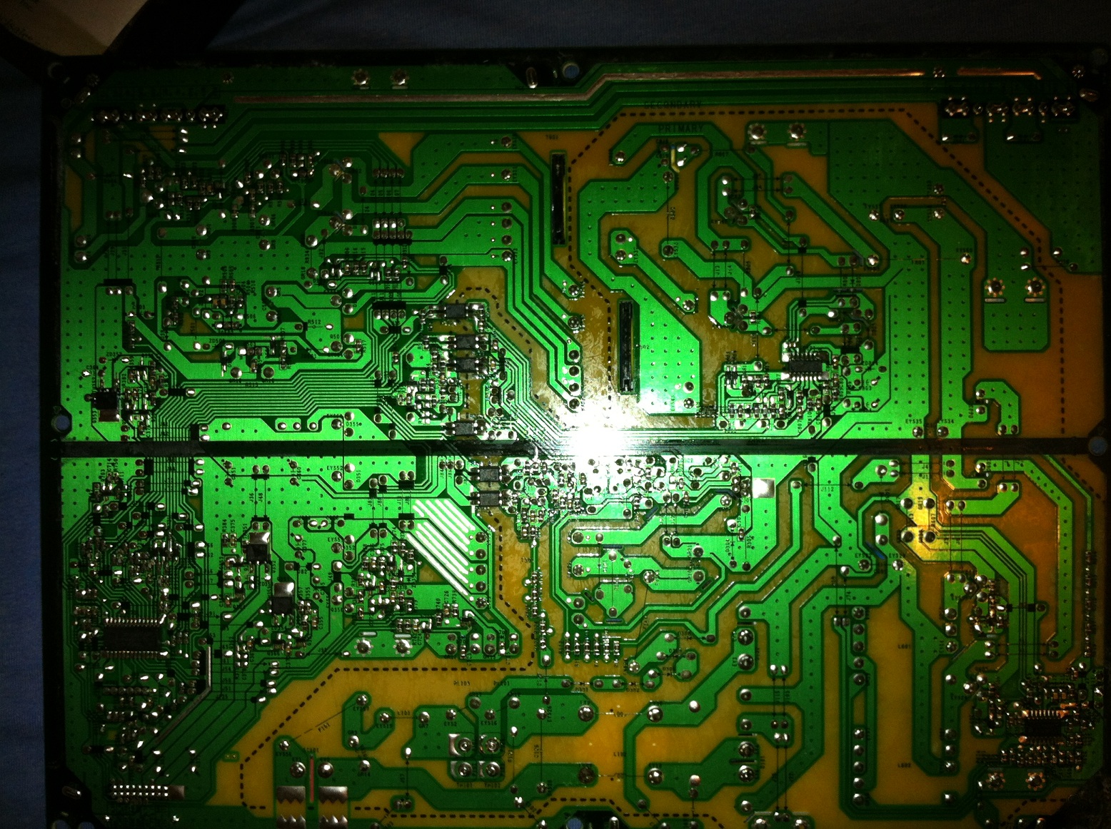

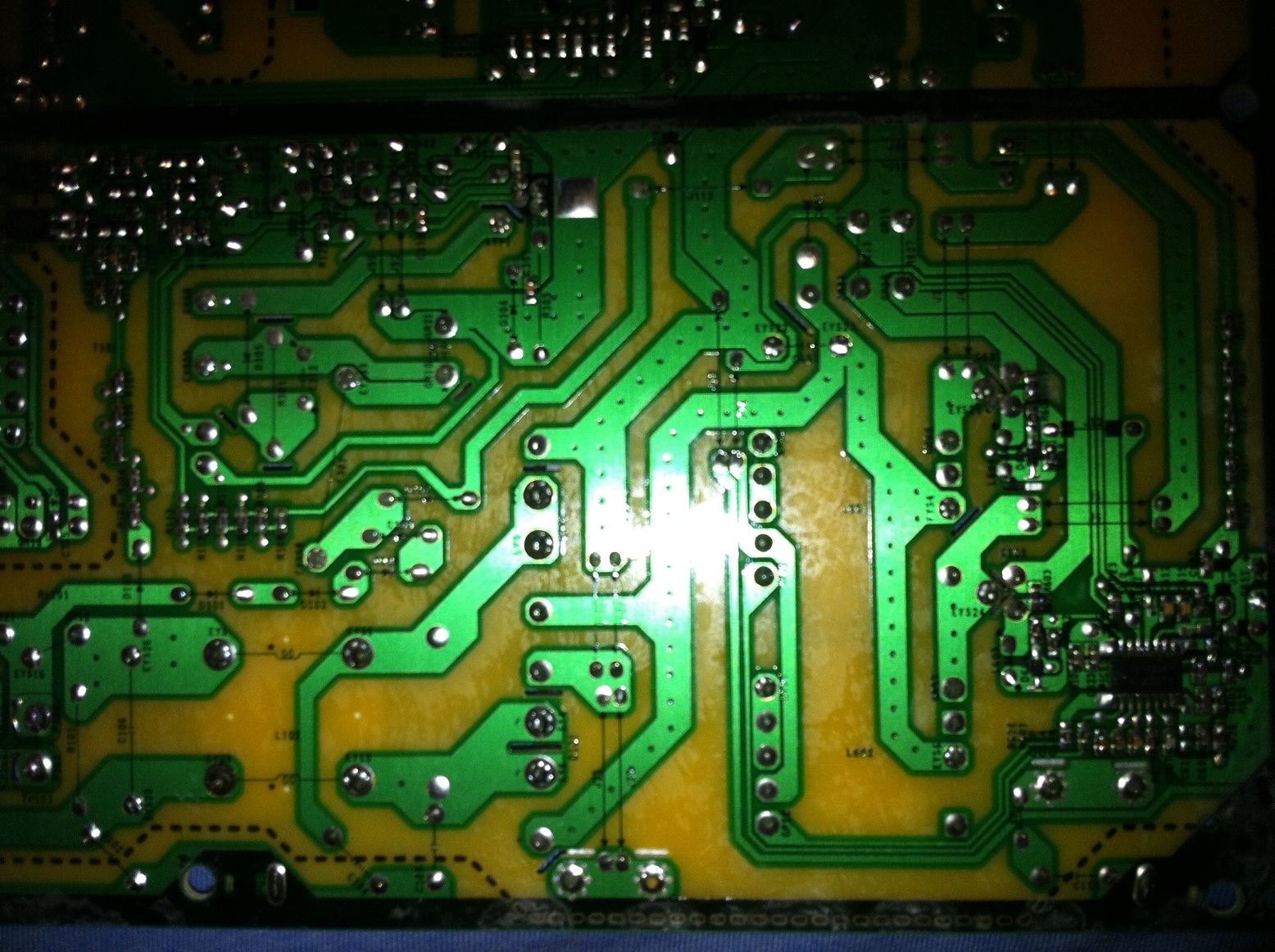

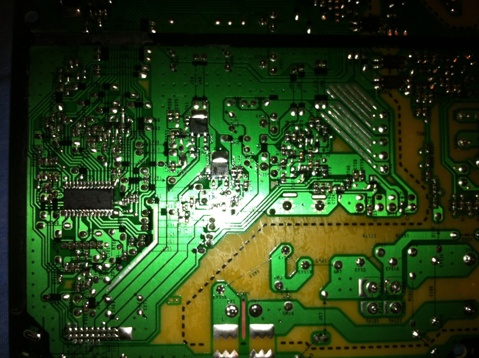

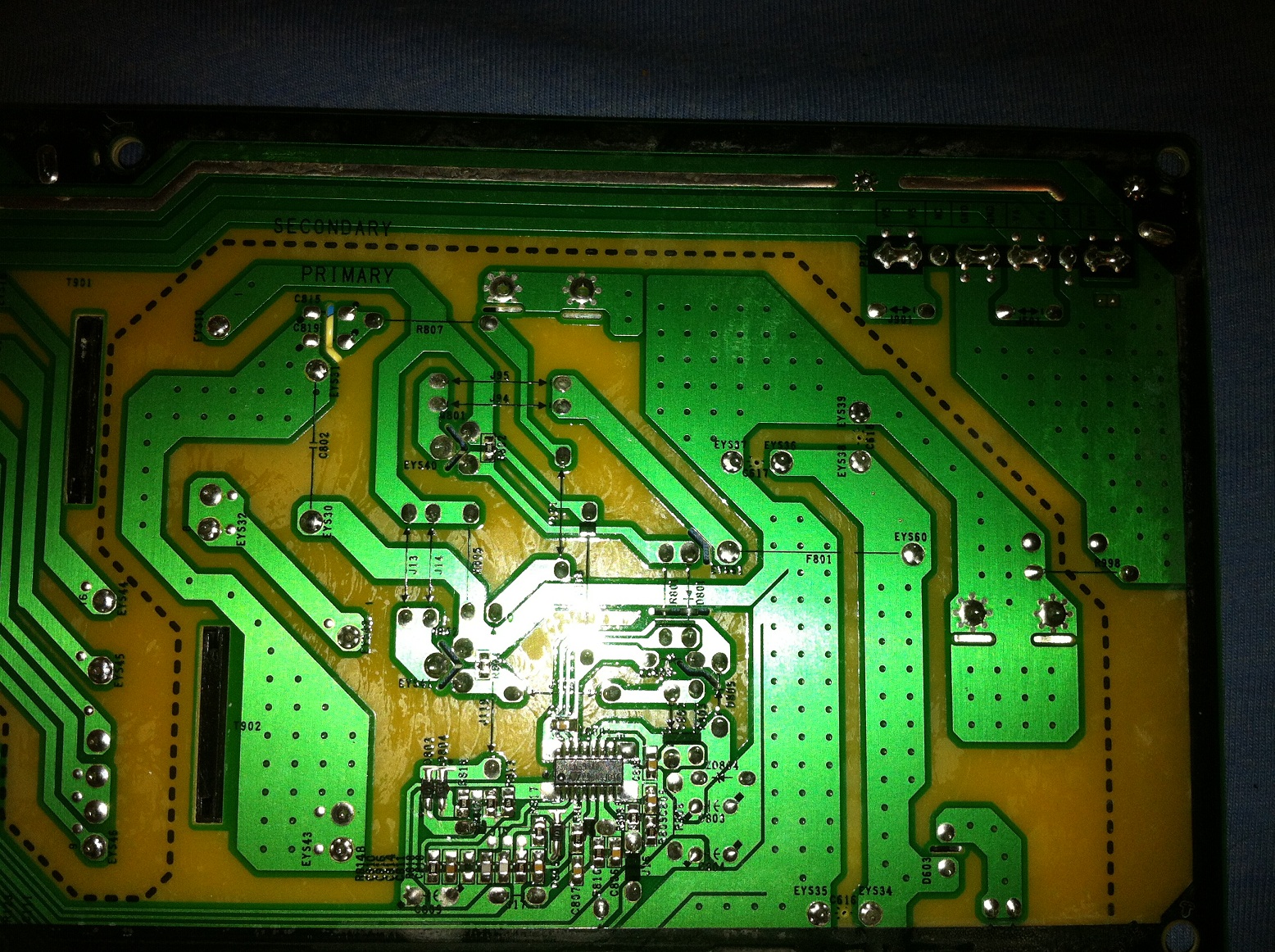

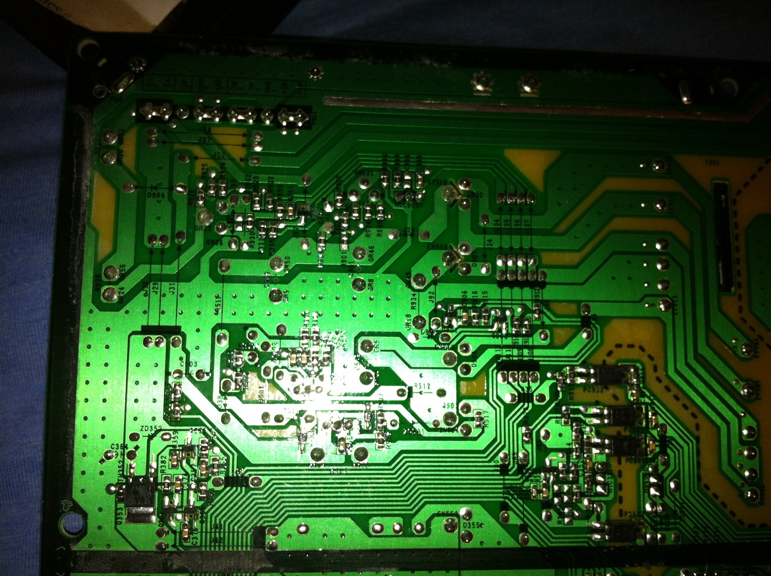

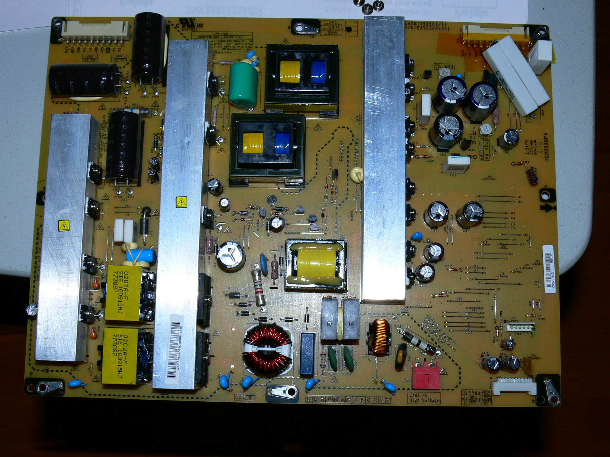

    here is the pic. Thanks again for all the help Tom, I cant wait to have this thing outta the way and put back together, I also have a samsung LCD that is giving me troubles but we can get to that later.
    Im really doing the best with the camera i have haha, if you would like a more zoomed in picture of something just let me know and i wil do my best. I took 5 of the power board so hopefully these will suffice.
      Re: LG 50" PK540 Plasma Clicking, not turning on.
      Can you double check the STBY pin voltage?
      I can see two optocouplers that are facing backwards on the board. The problem is locating which one does AC detect. On my power supply they both did AC detect, one for each polarity (positive, negative) of the incoming AC. So both were disabled for the bodge.
      For taking pictures try taking the board out on a sunny day (or just to your windowsil) and using the macro mode on your camera. Turn off flash.
      Try and get a closer pic of this area - the black things straddling the black dotted line are optocouplers.
        Originally posted by tom66
        One thing I forgot to ask you to check is the standby voltages - check if they are still good during clicking.
        Where are these located? Same method I used to check the AC_del voltage?
          Yep, but check the pins marked STBY.

              I own a LG50PK350 plasma tv and it started to do this click thingy and won't turn on. Problem was Power Resistor on the powerboard (red circle)
              I've heard this is a very common fault in 50pk350 tv's.

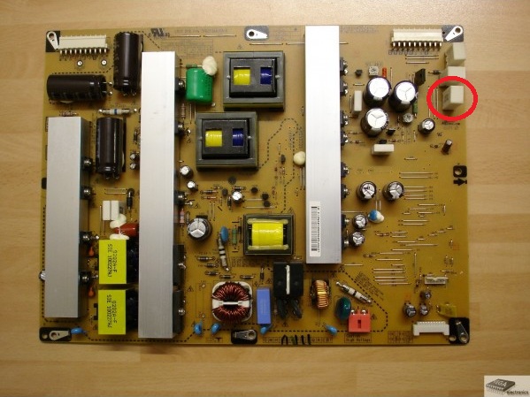

                  Tom66, and the rest of the badcaps crew... You guys are great! I also have a LG 50PK540, and thanks to wisdom and knowledge from the crew, My LG is now fixed. Want proof? Check out my youtube videos..part 1 & 2
                  http://www.youtube.com/watch?v=I9wF0...ature=youtu.be
                  hydex, Iv'e heard about that humming from someone else with that issue.. NOTE: My tv did not do a humm sound.
                  i would like to know what the verdict is on that one.

                      just want to add that tv is now fixed thanks to the repair kit from bafury.He was spot on with everything .You tube videos were great and very informative.
                      Thanks you saved me a lot of money .

                                  I had a 50PK350N brought in, that would apparently turn on, but no picture. Sure enough, that exact 22R/5W ceramic resistor was wide open (electrically, not physically).
                                  Not wanting to wait for a week for a spare (and uprated) one, i decided to "get creative" - i had a few 10R/10W resistors. Slapped a couple layers of Kapton tape over the "butt end" of that connector up in the corner, and squeezed those two big boys as you can see in the attached pic.
                                  Owner forgot the remote, but we'll find out soon enough if this alone did the trick

                                    Confirmed, all is well
