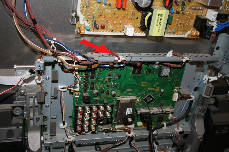

    OK, tried unplugging 2 cables to "D" board and plugging back in with no luck. Against my better judgment I plugged the TV in and probed cables with a wooden stick while watching image in a mirror. As soon as I touched one certain cable the red pixels flickered and picture was fine. Any slight movement of said cable made red pix. flicker / come and go. Now to pull that cable and inspect it and the "A" and "D" board connectors that it plugs in to. I think I've got it!
    See pics for this cables' orientation on "A" board.

      It'll likely be the one which is very fine pitch with a lot of small wires... if there are multiple, may as well reseat them all, takes 5 mins.
        Re: Panasonic TH-42PZ80U Plasma Red Screen Issues
        Thanks for the quick reply. As I mentioned in my last post, it turned out to be the thick brown braided cable going from top center of "A" board to top left-of-center on the "D" board.

          Glad to see you got your fixed, I've been off this forum for awhile so sorry I didn't get back to you sooner. Mine was actually the ribbon cable end which connected to the D board -- just became slightly unplugged which caused this problem. Just pushing it back in place fixed it.

            Had the same red screen issue on a Panasonic 50" TH-50PC77U. After running for about 15 minutes the screen went red as shown in the pictures in the above posts. The connector with the fine individual red colored wires seems to be the problem. The connector that is closest to the screen(so it does get hot) on the board that is under the board with the RCA connectors was the culprit. It has been on for almost two hours now with no degradation. Not sure how to make a permanent fix.

              You guys saved my Panasonic TH-42PA60E. I was getting the glittery red screen problem. I took the back cover off. Cleaned out all the dust with a vacume cleaner and a small brush. I then plugged the tv in and carefully fiddled with all the cables and plugs. I kept an eye on the screen with the aid of a mirror. As soon as i pulled on the cable in photo, bam! Fixed! Thanks guys!

                    Hey, I have a Panasonic TH-42PZ77U, which went totally red about 9 months ago. Just like yours Consult20. It is now about 6 yrs old. I opened it up, and noticed how dirty it was and full of dust. I vacuumed and air blew it out, which cured the issue. Well, last week, the problem came back. After warming up, the screen would go red. After reading your inputs and suggestions, I took the input board out, and as soon as I lifted it out, noticed a connector on the main board was askew, and half way out. I took the time to clean everything up good, cleaned and reseated all connectors I could see -- and rerouted one set of wires so they were not resting directly on the back of the screen, but slightly away from the screen, buttoned everything back up, and the problem is gone. It has not come back this last week. I am confident that was the issue. THANK-YOU for your inputs and help. Much appreciated.

                                It's a high speed digital data link encoding the individual pixel data. If the connection is loose, an impedance mismatch is created, which causes a reflection (think of a water tank: if the end of the tank is a solid wall, the signal (wave) will get reflected back, but if it's a matched end, no reflection is created.) This causes distortion on the signal causing your problem.
                                As for why it happens, I suspect it's related to it not being correctly seated at the factory and slowly working itself loose from thermal expansion.
