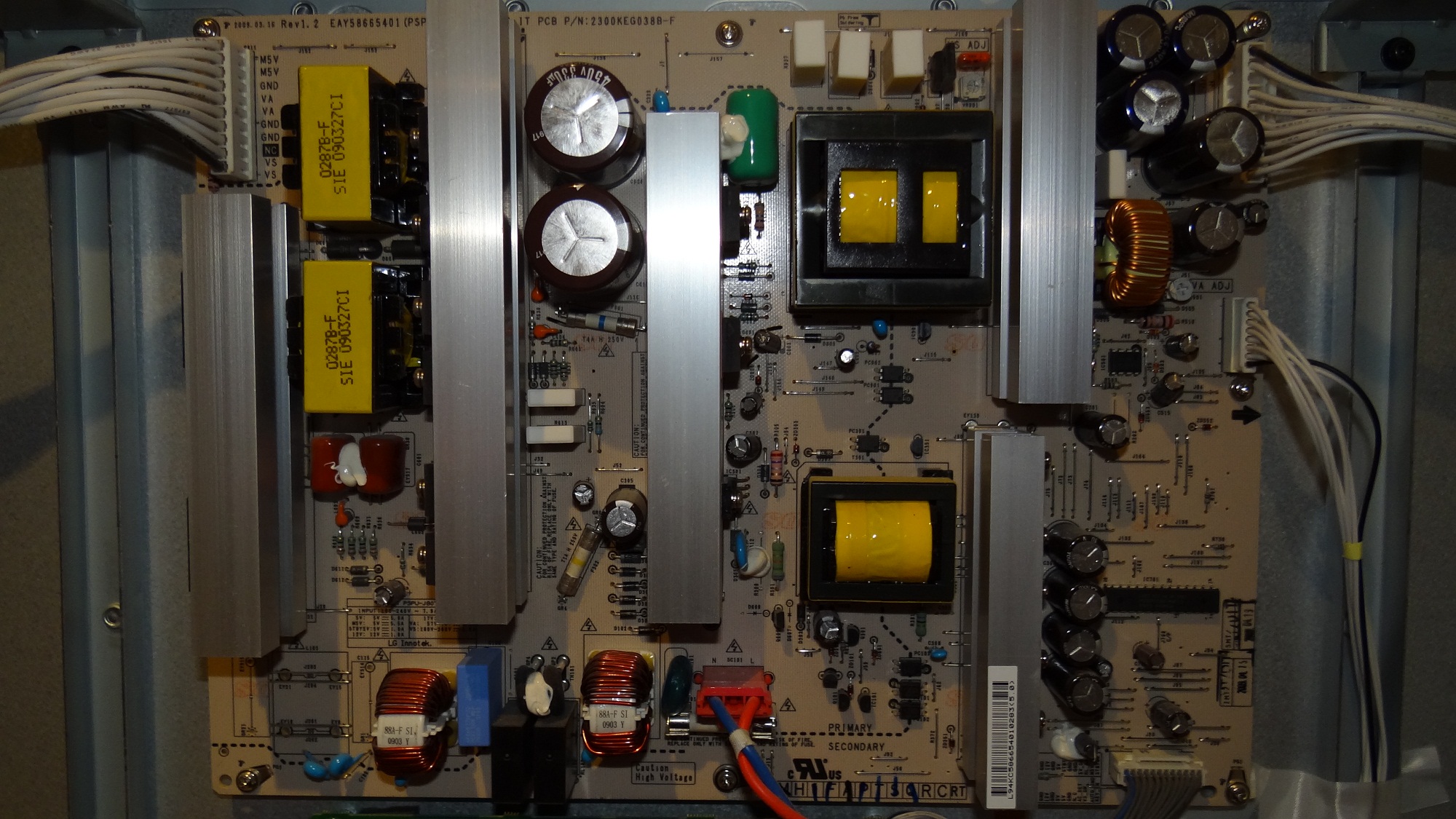

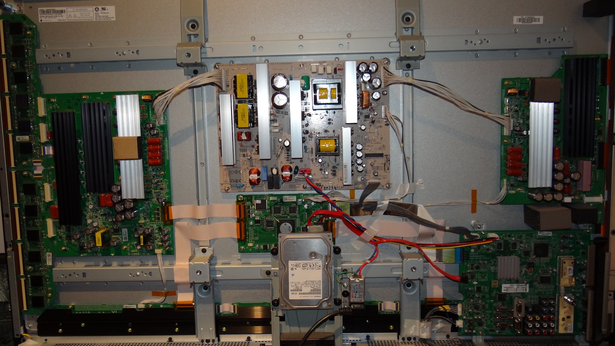

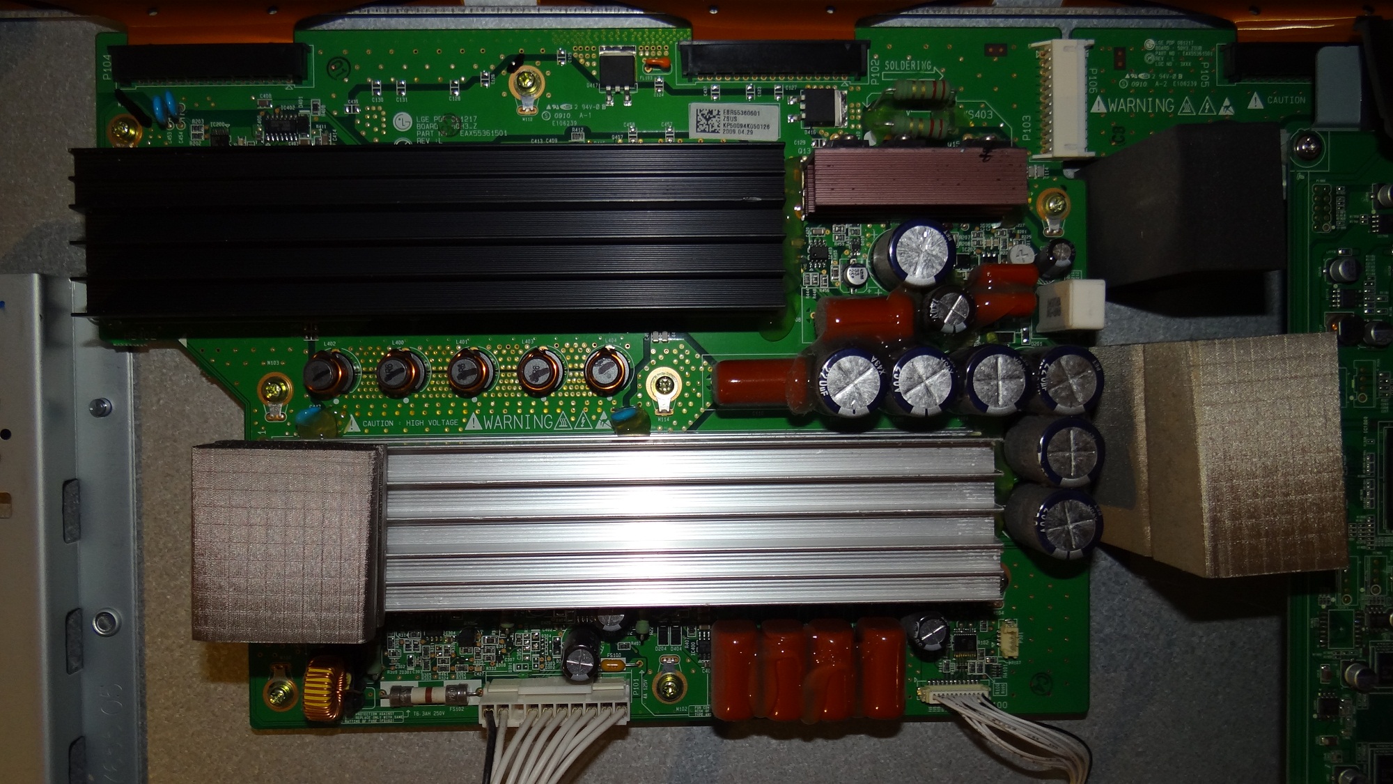

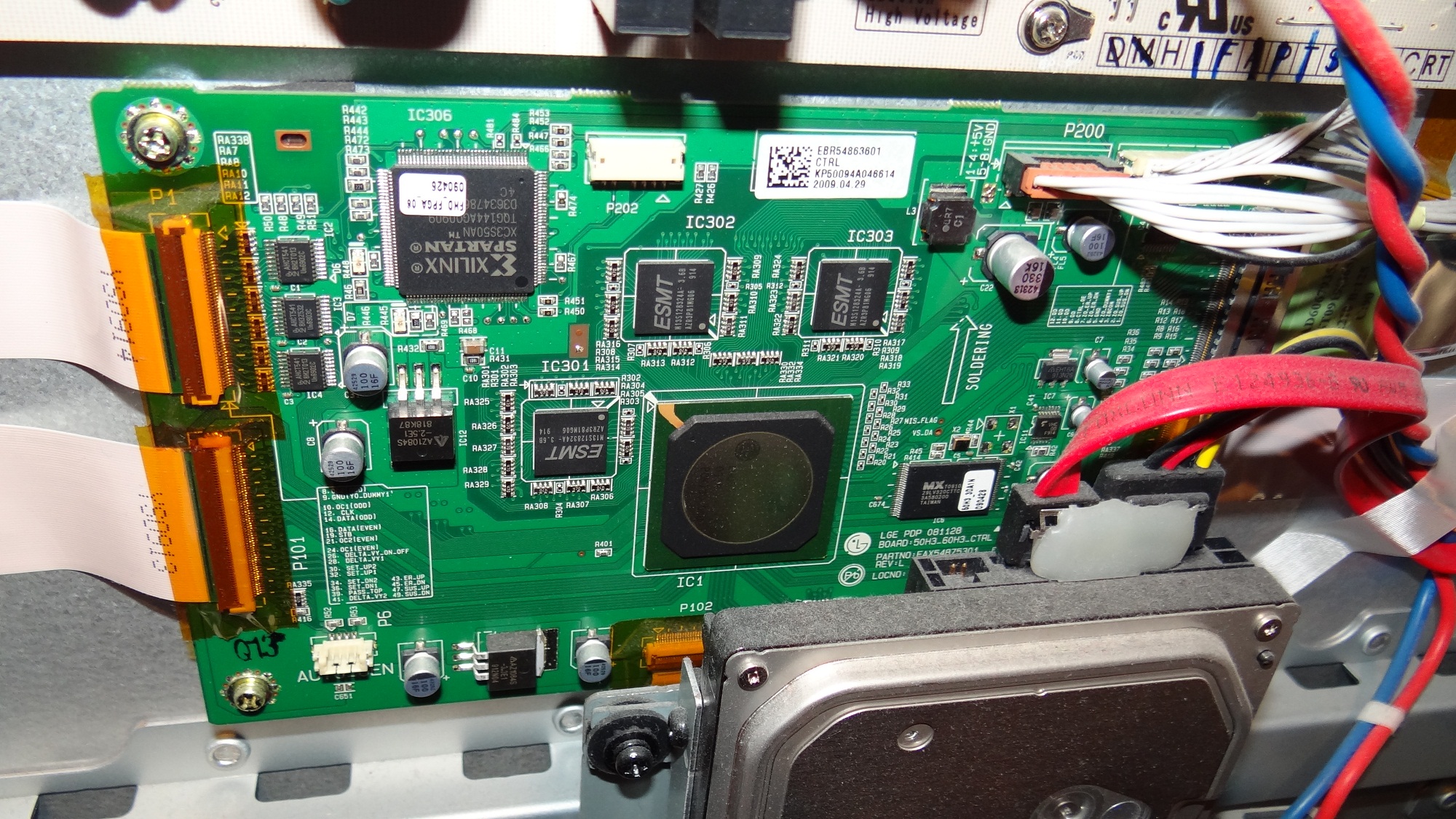

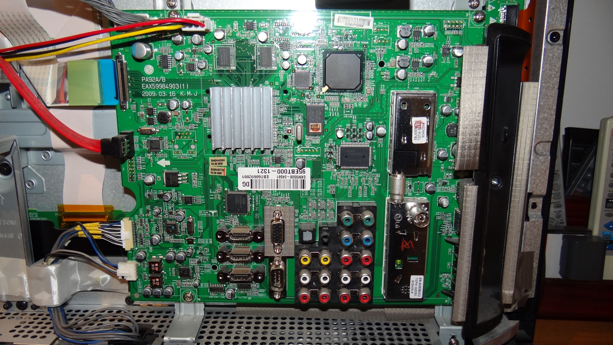

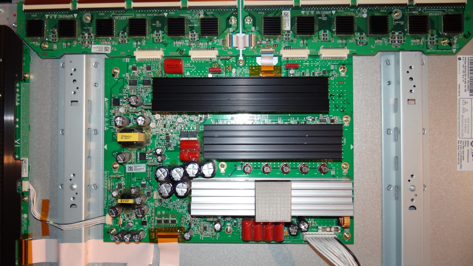

    LG Plasma 50PS80ED problem
    We have a LG Plasma tv. Model number 50PS80ED. The tv will turn on but instead of a lighter grey screen appearing as it boots before the image displays, it comes up with a very bright grey screen which remains for half a second then it reverts to a bright white screen with like pink smudges through it for a further half a second before the tv turns back off to standby.
    It happens if you use the remote or the button on side of telly.
    Same problem happened about a month ago but after leaving it unplugged for a couple of days it's worked ok up to now however I've tried to leave it unplugged for a few days again to no avail. Telly is about 2 years old so just out of warranty...
    Re: LG Plasma 50PS80ED problem
    Have you got a camera? Take the cover off and post some pictures. There are several faults that can cause this. I'm placing a bet on some bad caps.
    • Crackers_c
      • Jan 2012
      • 3
      Here are some photos of the boards inside, 1 general photo then a closer one of each of the boards. On quick inspection, i couldn't see any capacitors or components that look obviously dead. Checked voltages while i had cover open and the main voltage of 5 is running at 5.09, 12 is running at 12.09 and 17 is running at 17.11.
      Thank you...
        What about the Vs and Va voltages? (Be careful when measuring these - they are around 200V and 60V.)
