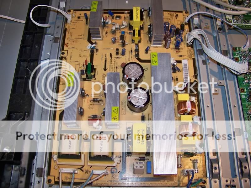

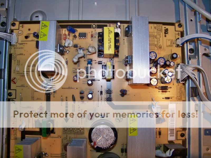

    Samsung LNT4669FX/XXA dark on one side
    Ok so i have the tv staying dark on one side once I turn it on. I checked power supply and found no bad caps. I have seen people with the same problem but no definite answers. Is there something else i should be checking? Any help would be appreciated.

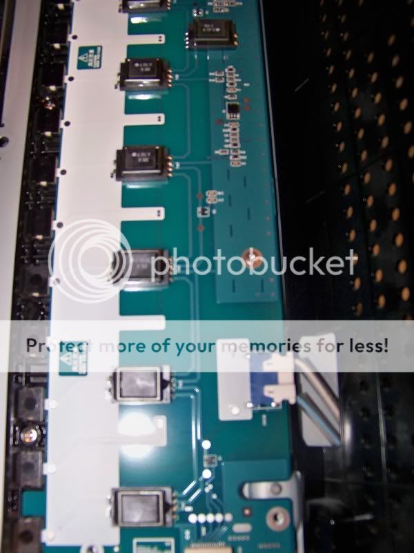

    Re: Samsung LNT4669FX/XXA dark on one side
    Here are pics of the tv boards. Maybe im not seeing something.

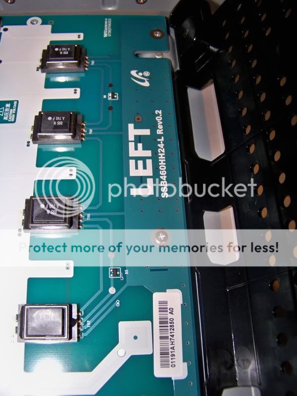

      Does anyine think it could be the left inverter board? Is there a wya to check it?

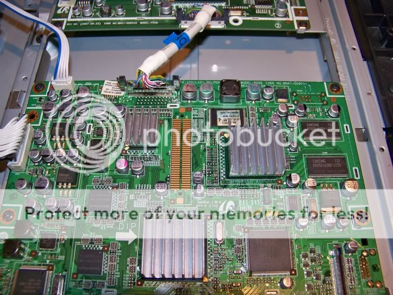

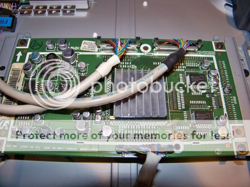

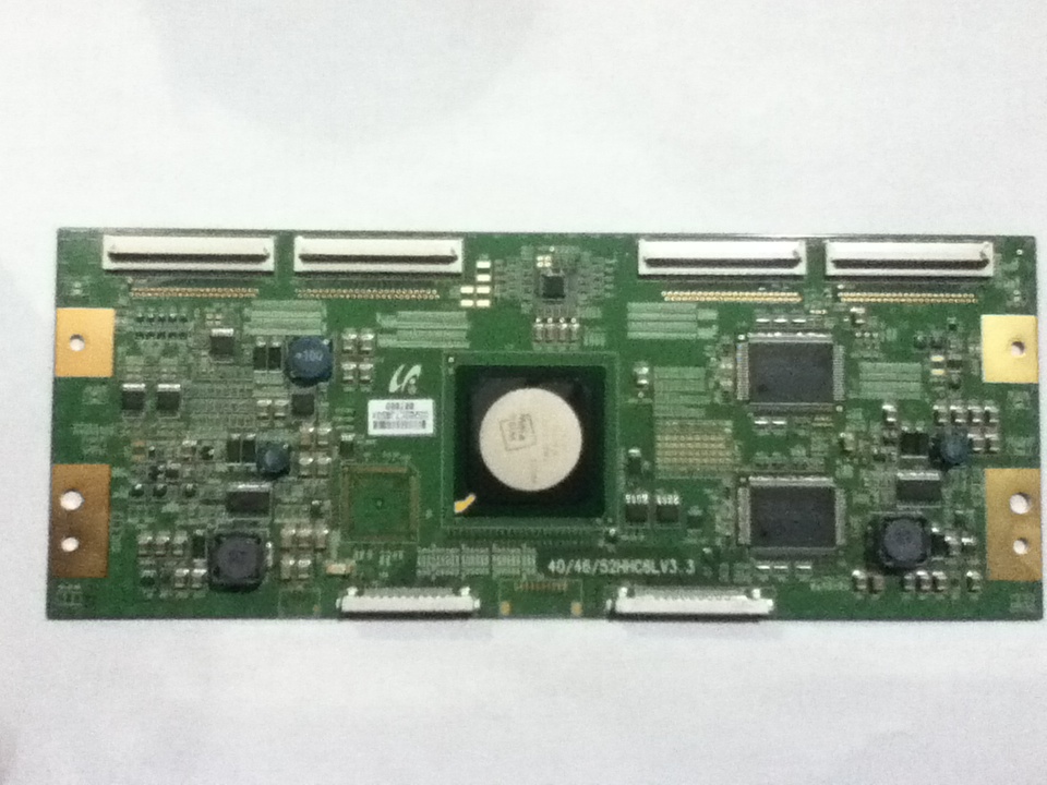

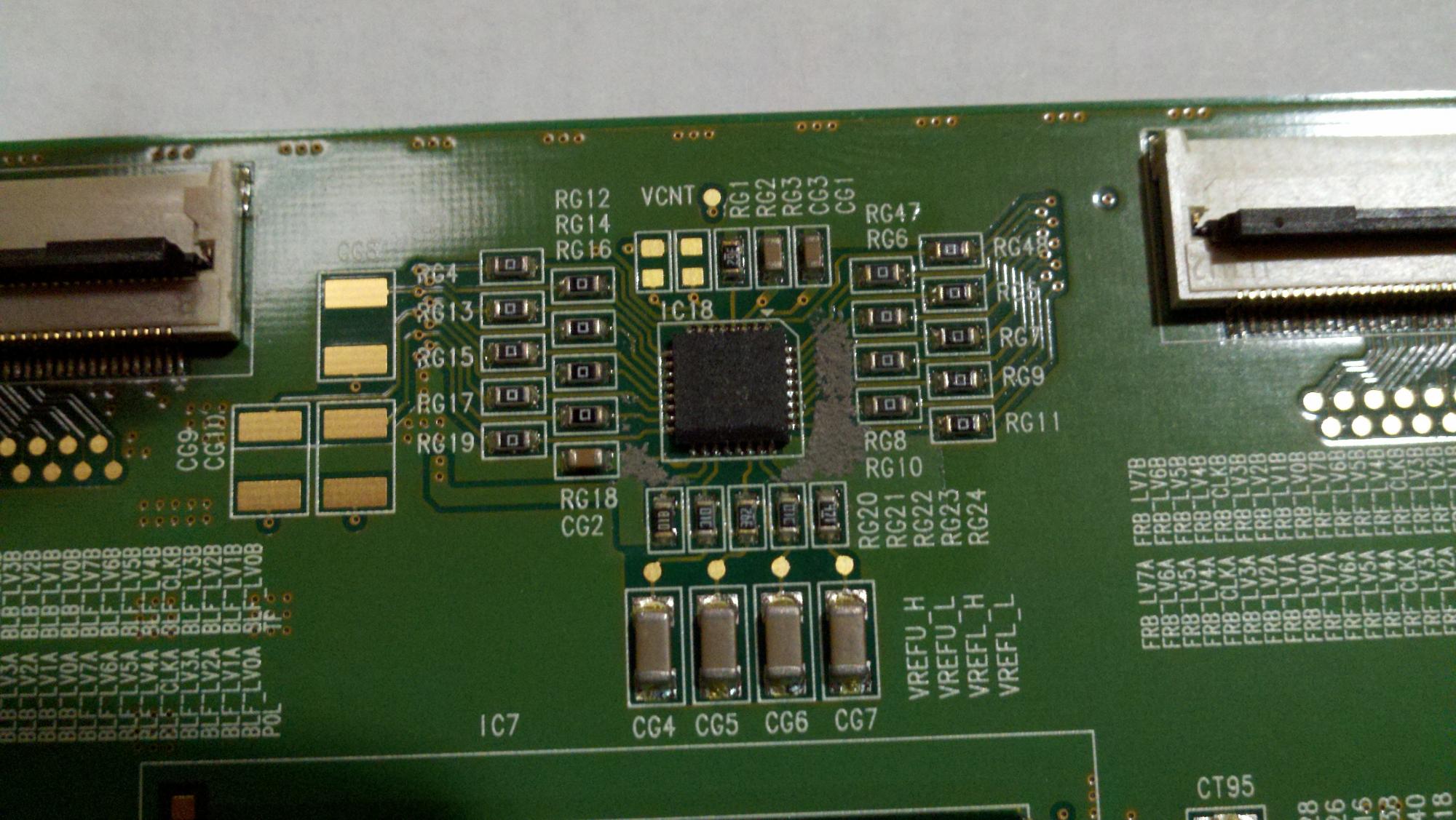

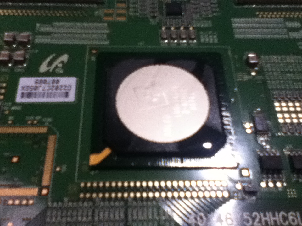

                  OK so I took of the T-con board and here are some things I found.
                  Seems like some kind of fluid on the processor? Maybe glue? Maybe something leaking? I dont know. There was a grey foam between the tcon and the back panel so maybe its glue??
                  Also around the chip on pic shown looks like corrosion. What do you all think?
                  I wonder If I can clean it up and see if this is the culprit.
                    2 lvds inputs?
                    i would try pressing on the big chip and see if things change.had a tcon once that had bad bga soldering. a refolow fixed it.
                    the processor have a thermal pad?
                    i have seen those break down to an oily mess.
                        Originally posted by kc8adu
                        2 lvds inputs?
                        It did have some kind of gray pad stuck on to it. once It came off is when I saw the liquid. There is not much on there but still suspcious.
                        Sorry for the ignorance but what is REFOLOW?

                          i see that the Tcon has a number 40/46/52HHC6LV3.3
                          When I look online for a T-con there are so many that pop up that have that same board # along with serial sticker number. Are they all the same or does it have to be specific to that TV?
                            If the number matches the number you have taken off the t-con board and says it will work in LNT4669FX/XXA then that's the board you want.

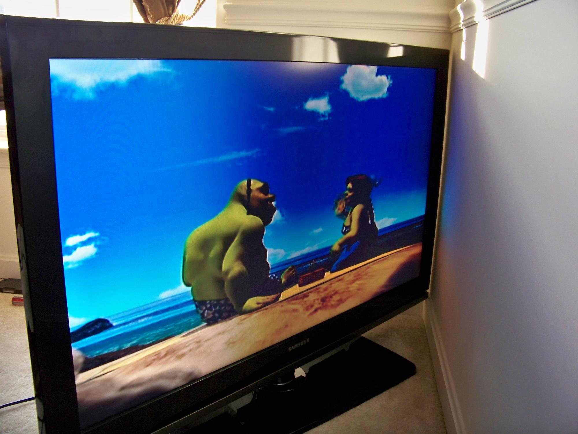

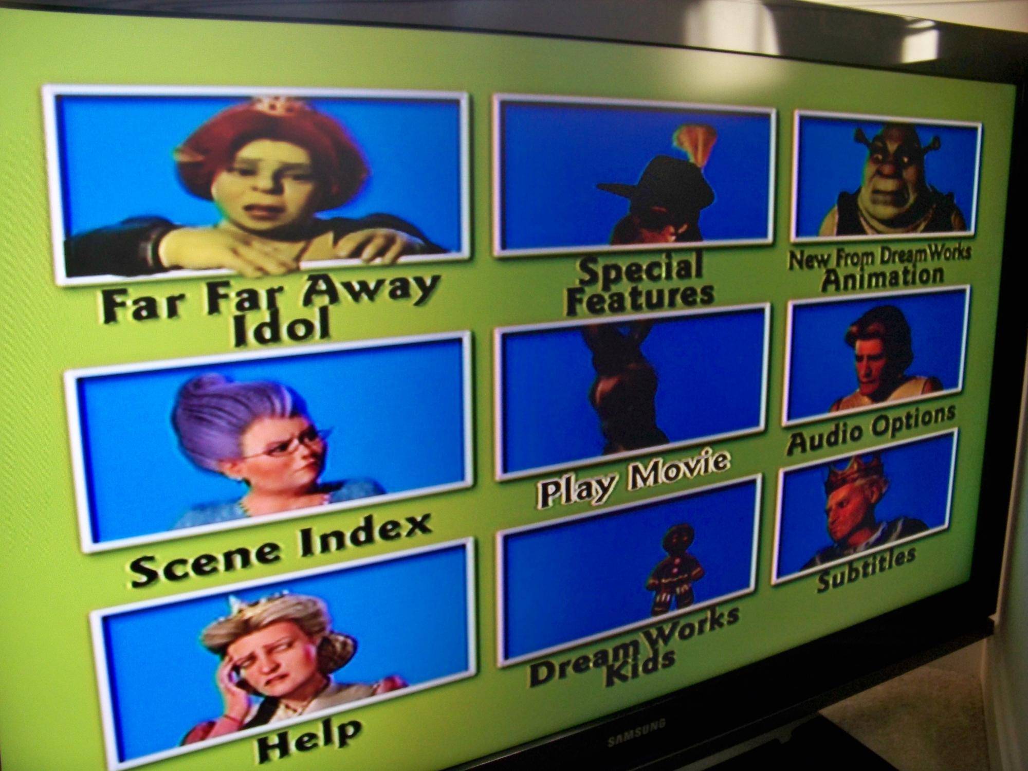

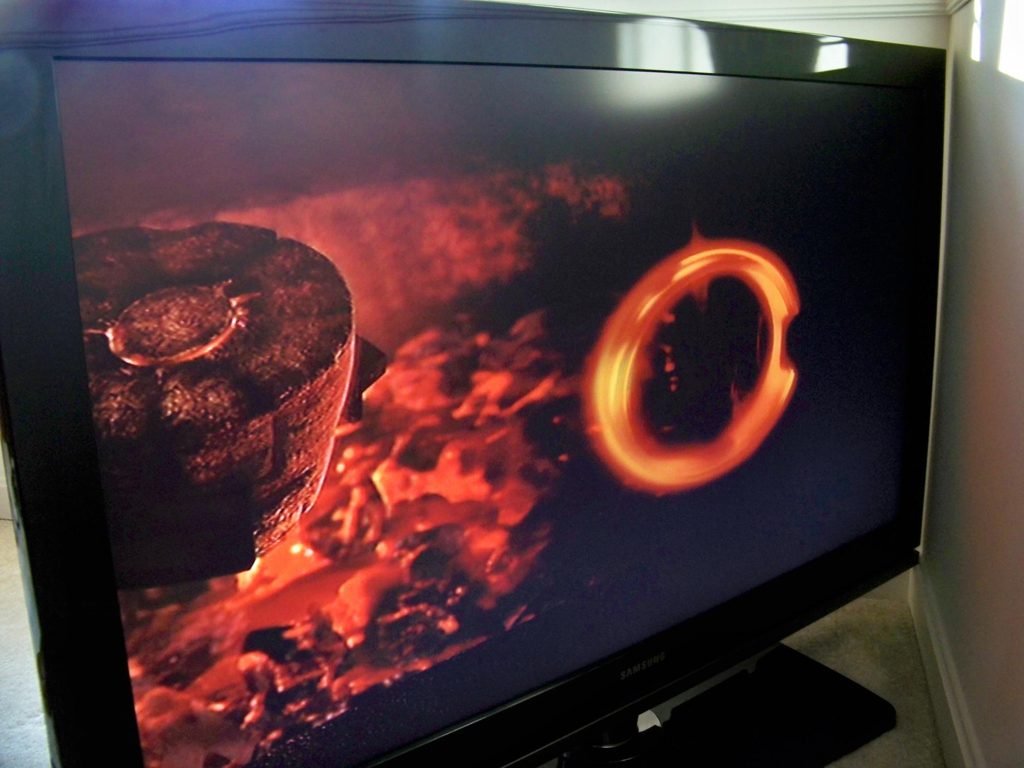

                              Here are some pics of the screen issues. This only happens for the first 15-25 minutes. then the screen looks good. I do not know how long the pics stays good for as I just got this TV and looking to fix it. Shaking or Tapping on the TV does nothing. What I've seen though sometimes when I first turn the TV on it's either dark on the right side, other times looks good but flickers on the right side.
                              Also is a short clip of the flickering and aslo dark towards the middle.
                                The video confirms that it a bad panel. One of the tab bonds is going bad.

                                  Is there a reason on why the pic looks good after 10-15 minutes? I had it on for about 5 hours today and looked great after the 15 min once i turned it on.
                                  • rayrod81
                                    • Oct 2010
                                    • 205
                                    Once it heats up the tab makes full contact with the panel and the picture will clear up. When it is cold the connection is intermittent. Here is a Sony with the same problem. http://www.youtube.com/watch?v=jNQBBKe2pso There are videos detailing how to fix this problem on YouTube but it doesn't always work and many times only fixes the problem for a couple of days or less.
