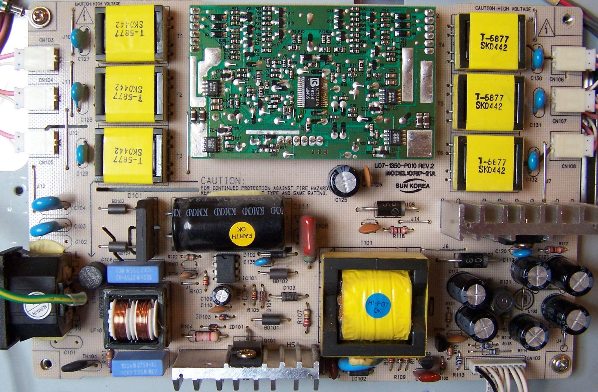

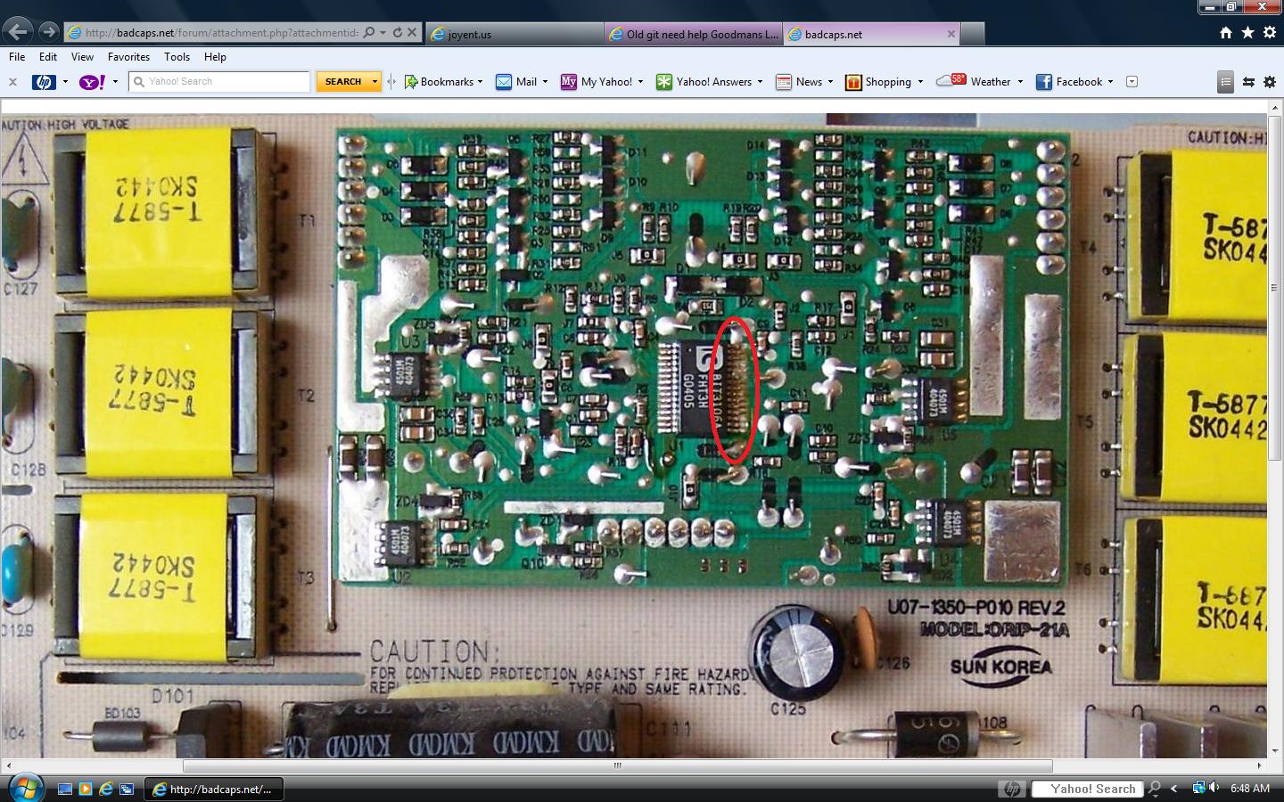

    Next, take a picture of the power supply - from directly overhead, well lit, no flash. Attach it to your next post using 'Manage Attachments' - below the text entry area.
    Third, what are the voltages on pins of CN1 on the main board (or the equivalent on the power supply)?
    Last, what are the voltages on the pins of U801, U802, U803, U805, U806, and U807?

      Re: Old git need help Goodmans LCD TV dead ..
      Hi Thanks for the help ..
      PIC... of the samsung board..
      AS for voltages there are none on any of the connecting cables ( cn102)
      and none on any of the U801 etc .
      There is power up to and into the transformer T101.
      and also to one side of the 4 pin IC (ic102) below the tranny.
      even found a Circuit diag !
      Chris

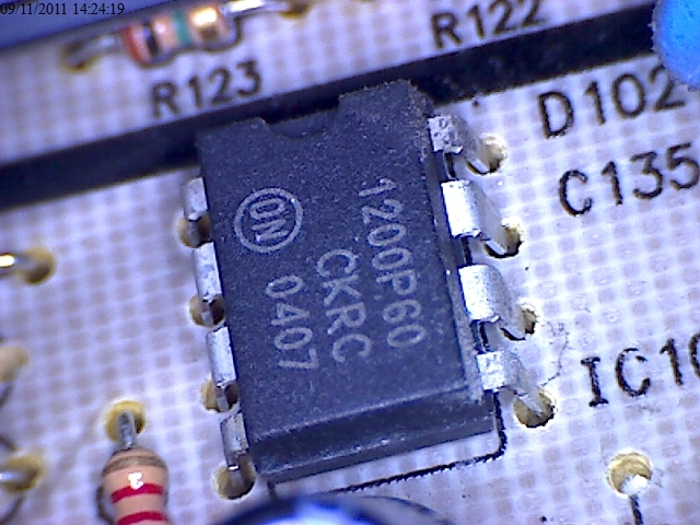

        • cmj21973
          • 267
          It appears as if all the solder leads on this IC chip has been melted.
          What is exact Make and Model of monitor?

            • ceedy
              • Nov 2008
              • 76
              Nope it just the lighting in the photo ..
              The TV just stopped working no drama just went off .
              Pic . excuse to get mu USB microscope out again!!

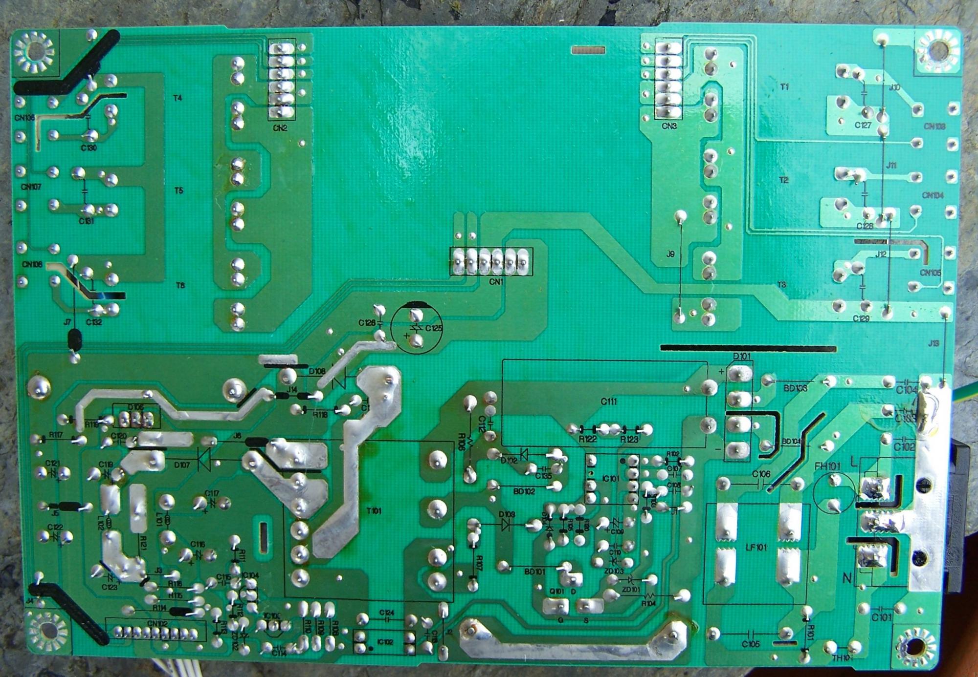

                  Ok, good know. How about a photo of the solder/trace side.
                  • ceedy
                    • Nov 2008
                    • 76
                    Glad to oblige!! , had to dash out in the rain to get some decent light
                    Chris

                      First, you are one old git who is taking some seriously good pictures. And it doesn't hurt that the designer has a very clean layout.
                      What is the part number of IC101? That is the SMPS controller and the first suspect.
                      Also, with AC power disconnected, what is the resistance across C125 (measure it on the bottom of the board)?
                      PlainBill
                      • ceedy
                        • Nov 2008
                        • 76
                        PlainBill
                        IC101 ... 1200P60 Veho M-scope strikes again .. about the best it can do !!
                        Resistance across C125 is approx 1.7 meg.
                        Chris
