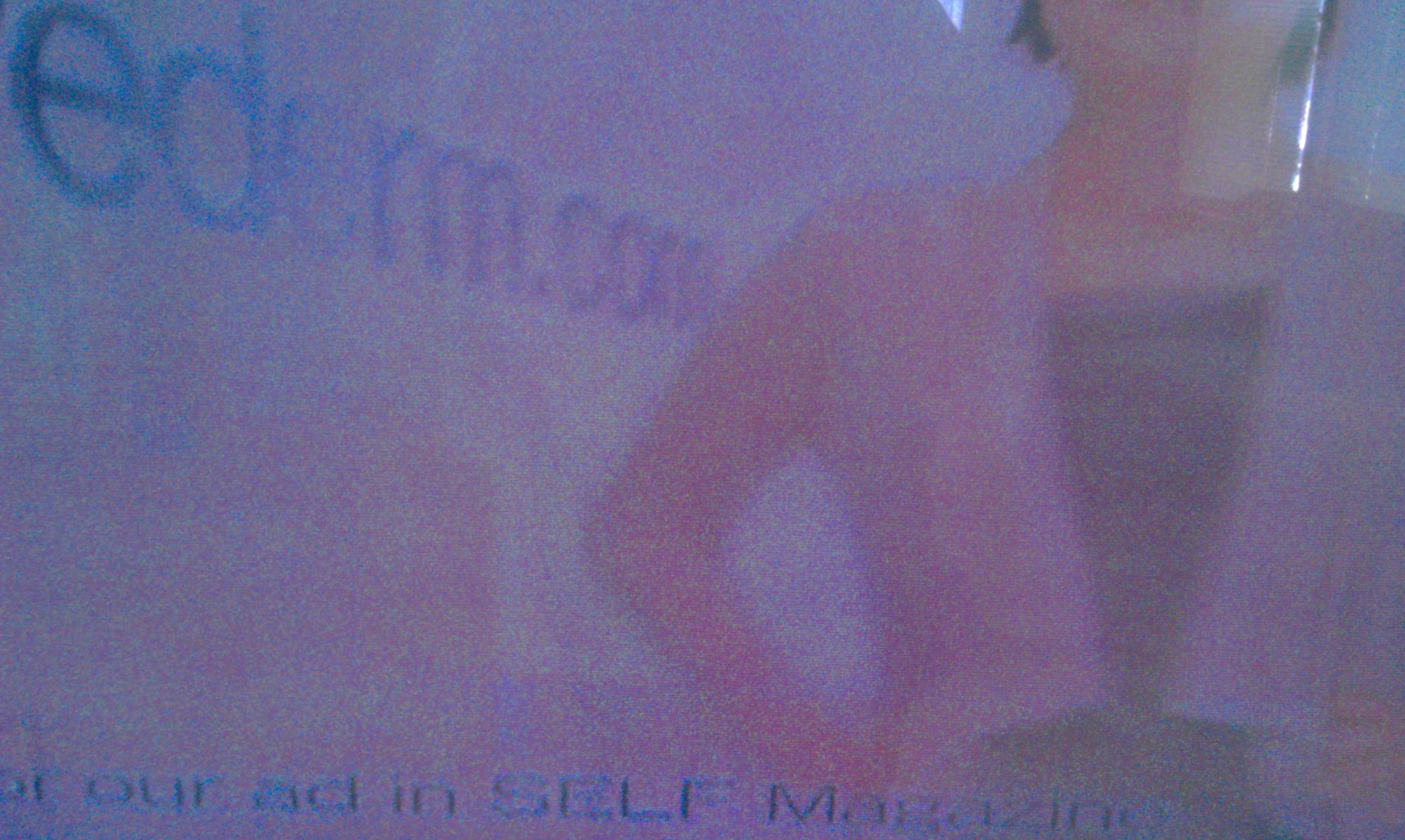

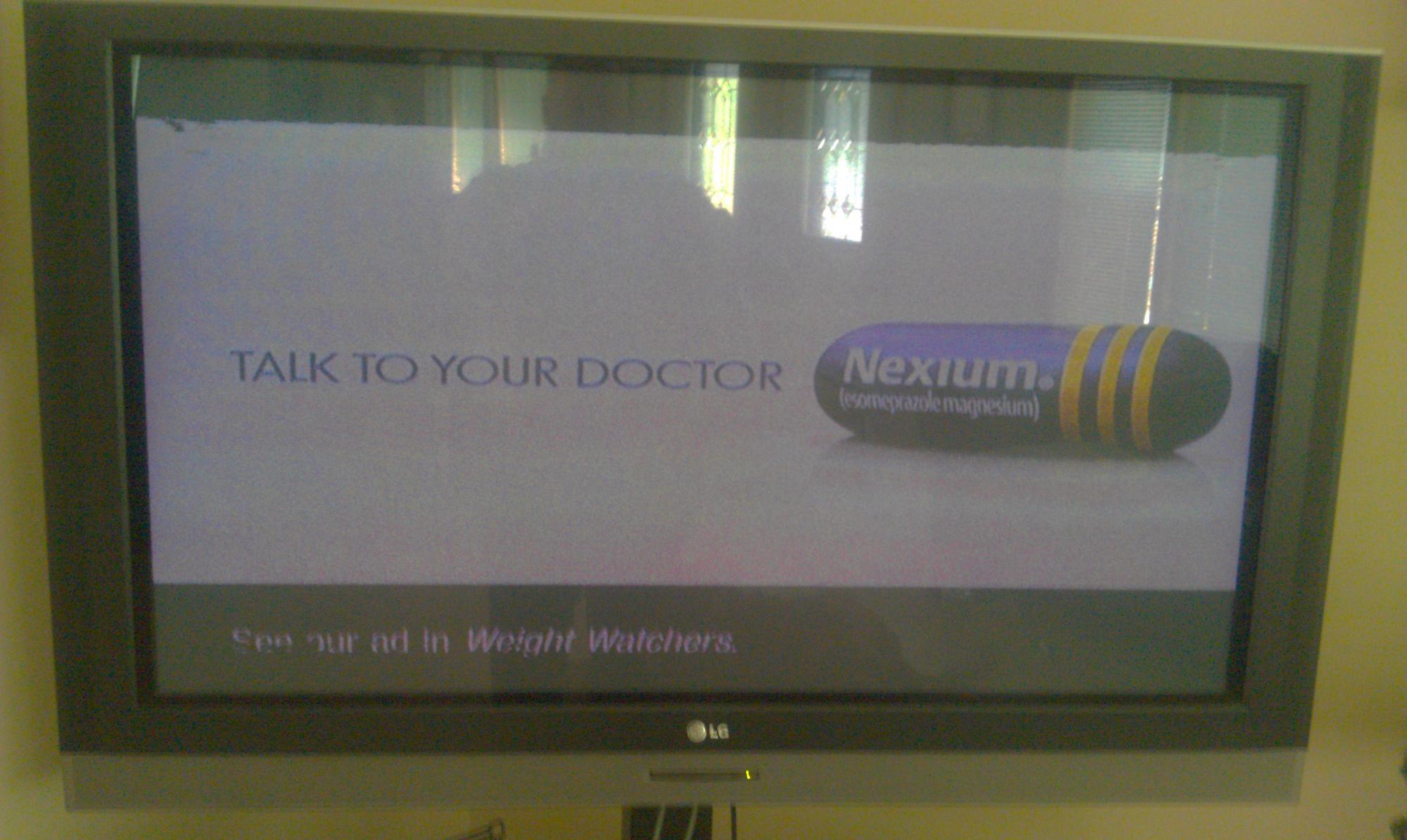

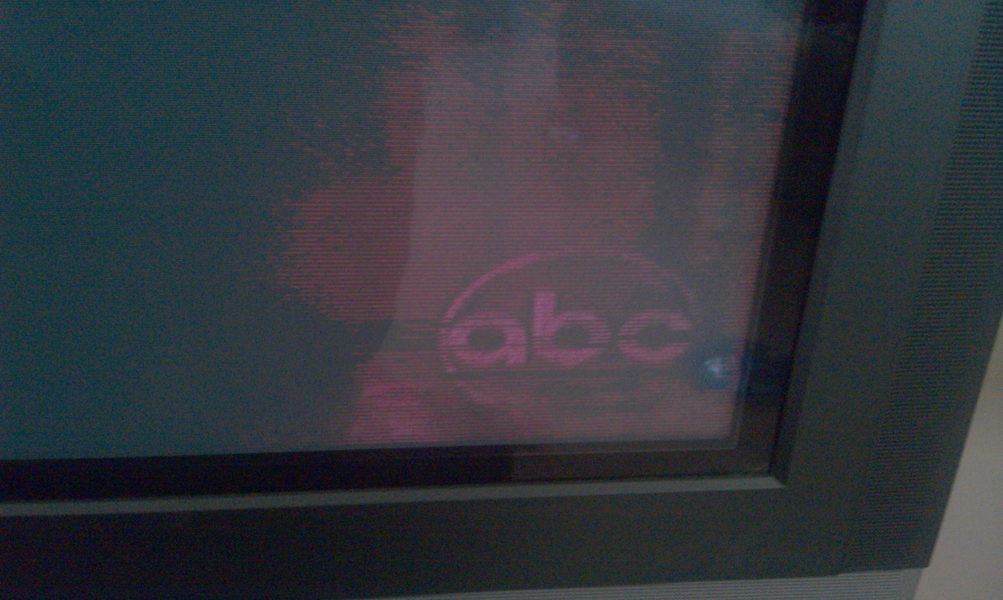

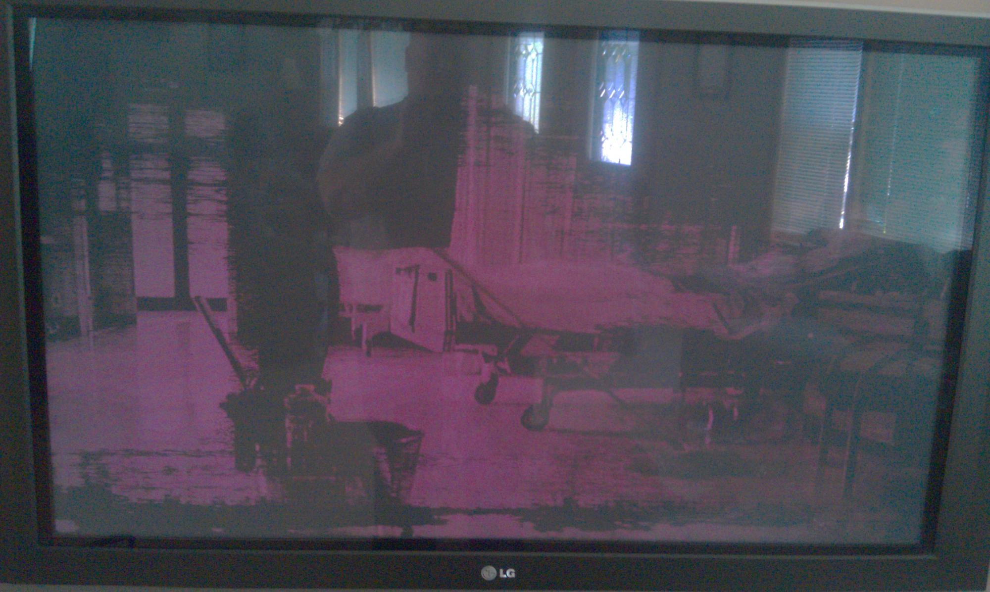

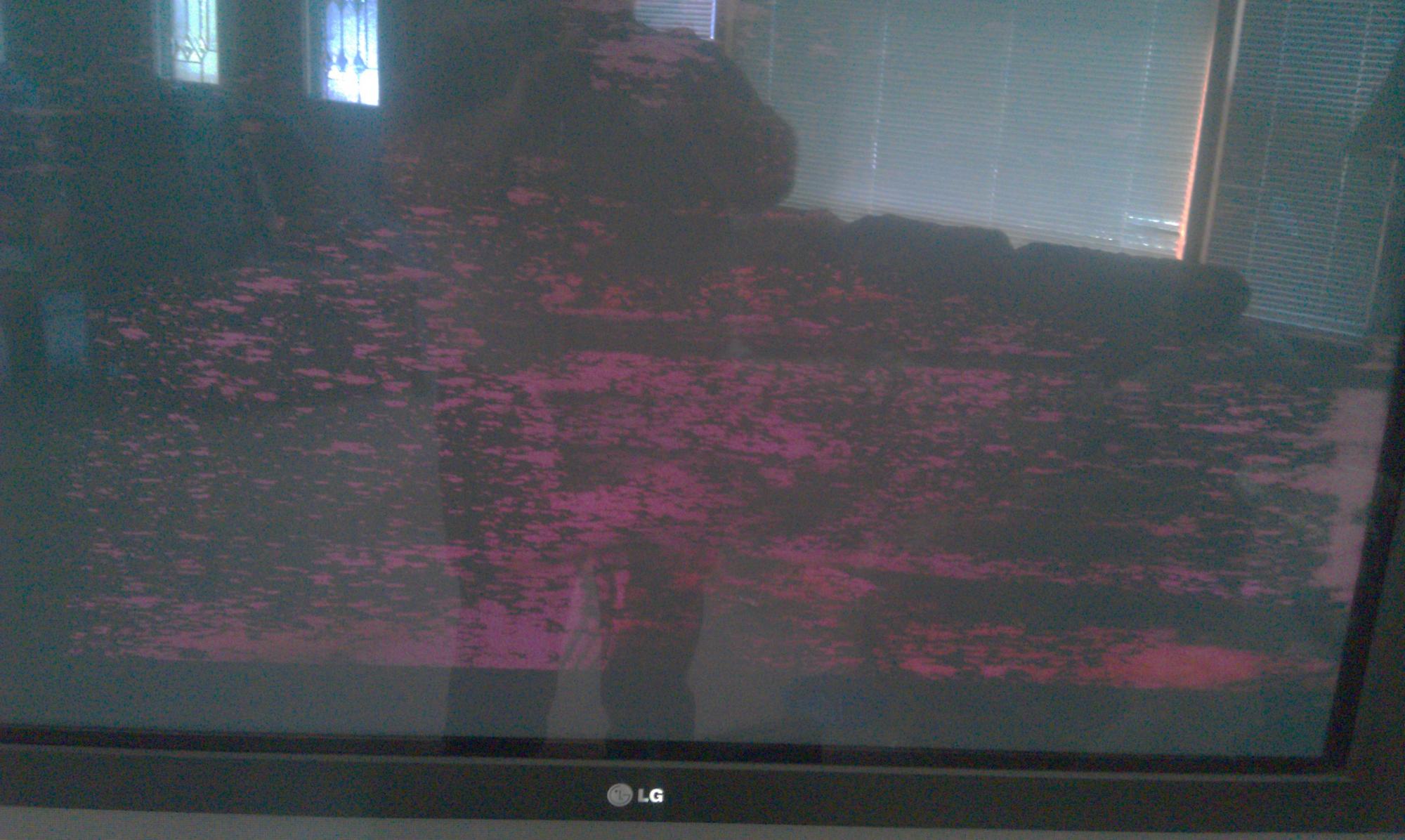

    I have a dark screen that lightens up after TV has been on for a short time. See pictures. The black will fade as the image changes though slower than the picture does. I replaced three boards 2 weeks ago, I believe they were the z-sus, y-sus and the board they are attached to. Sorry trying to do this quickly during lunch so. Any help would be appreciated.
    Re: 50" LG Plasma poor image
    The symptoms you have described and show in your pictures are usually related to a failed Z-sustain.

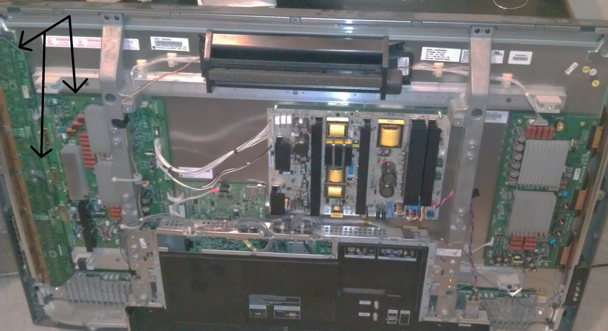

                  Here is the pic. Arrows point to the 3 boards I replaced. When I got the TV it had sound but no picture. After replacing these it was perfect for 2 weeks then a new problem arose as seen in the photos at the beginning of this post. Thanks for any help.
                    Those arrows point to the y-sustain and the buffers. The z-sustain is on the other side.
