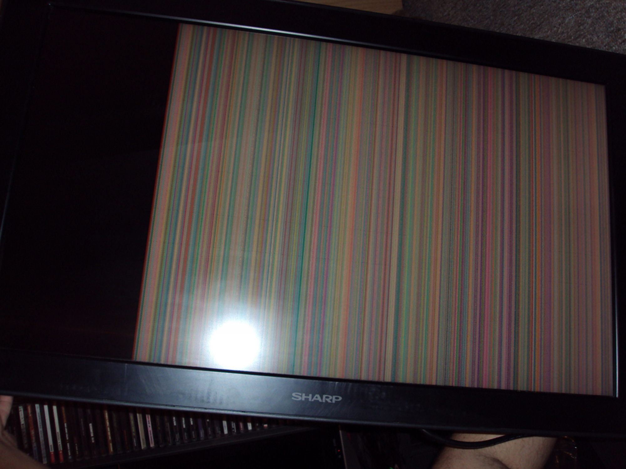

    ok i have this lc-m3700 older lcd tv and it just stopped turning on. The unit will show a red light and will turn on for about 30 seconds and then display 3/4 of the screen in a up and down rainbow screen then turn back off and red light blinks.
    The pic below shows the screen when the rainbow shows up. it only shows up for a few seconds then fades away to black as tv shuts off after that. Also i thought it could be the tcon board so i replaced that with a good one and no change.

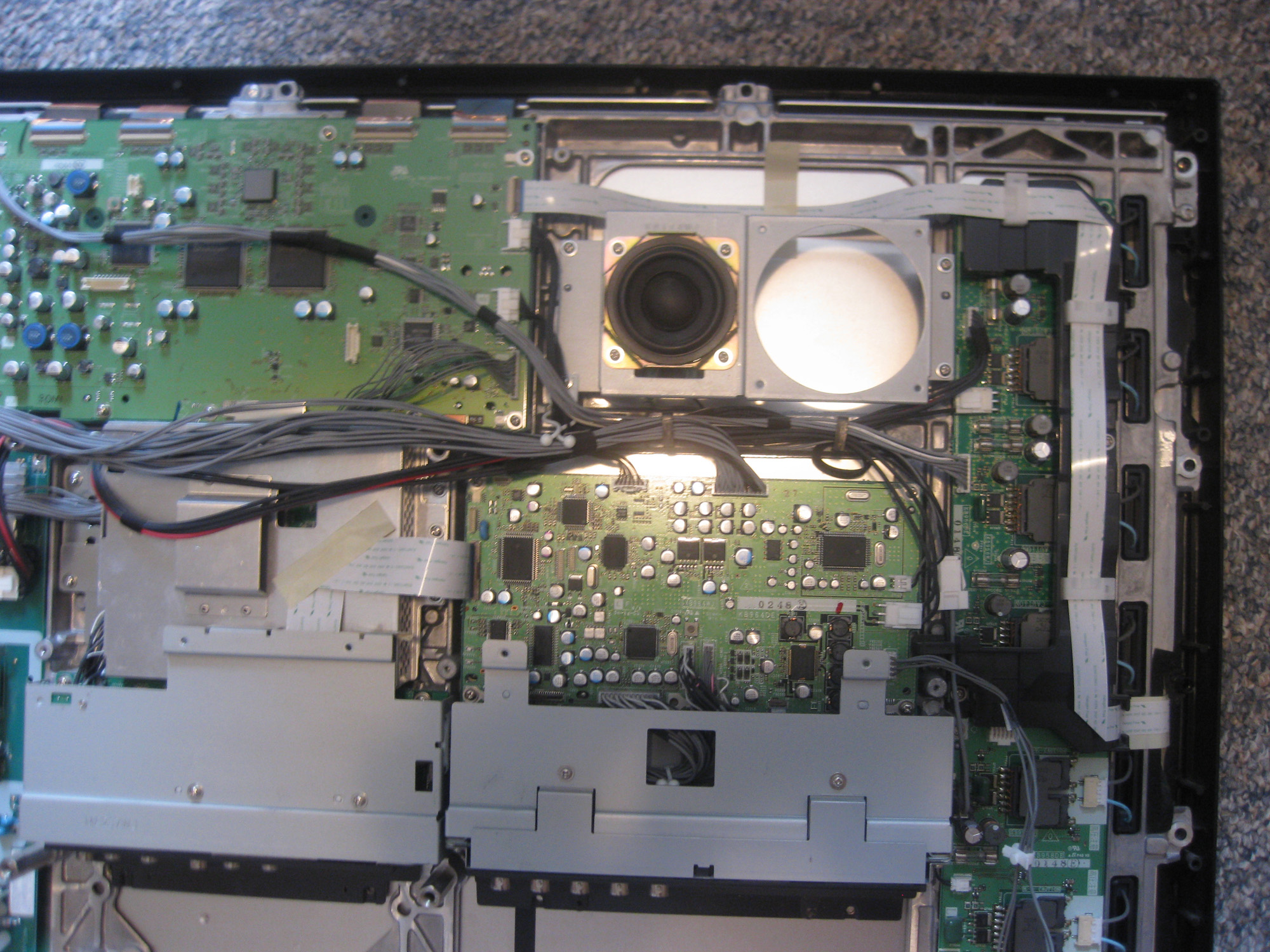

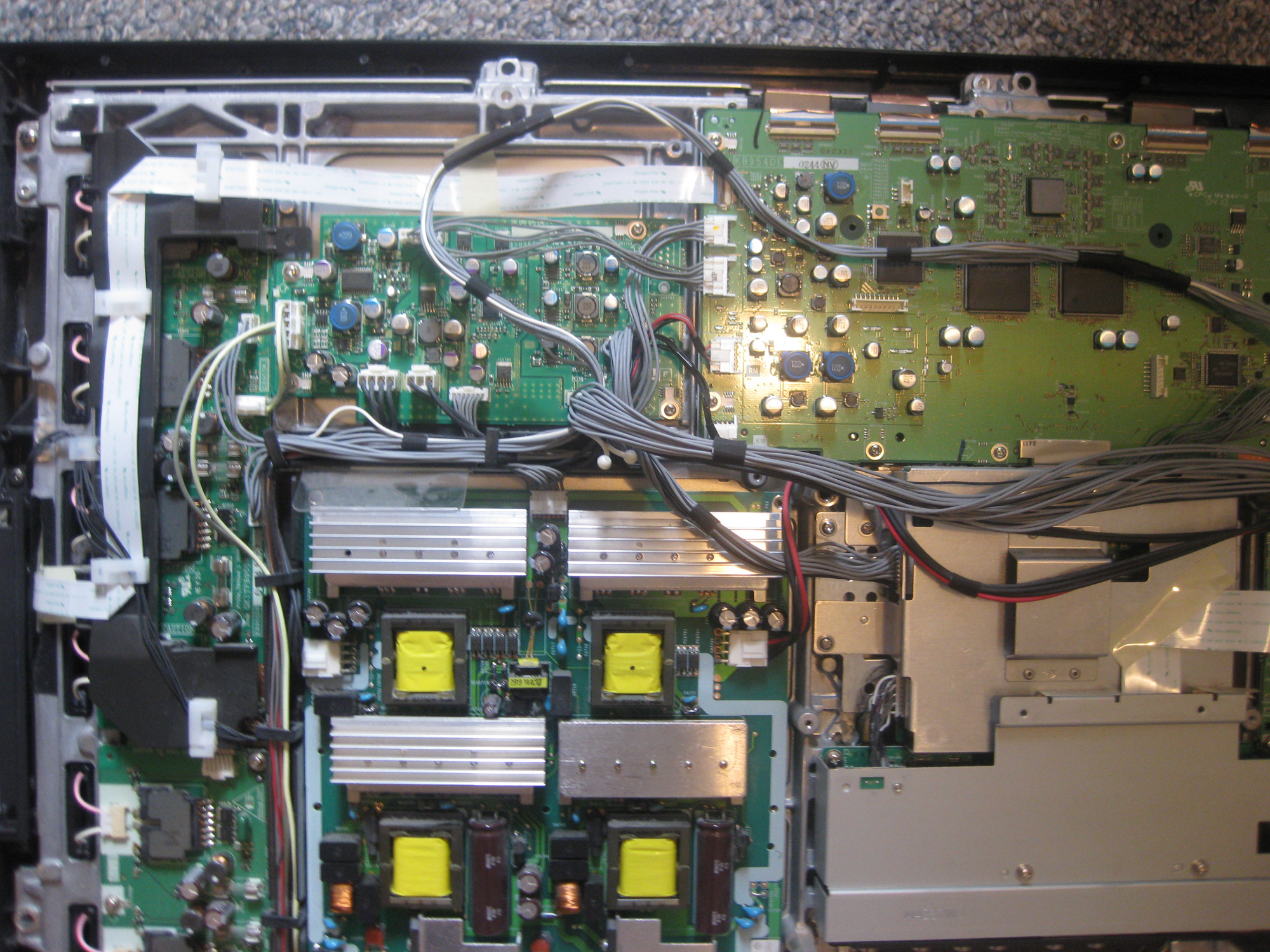

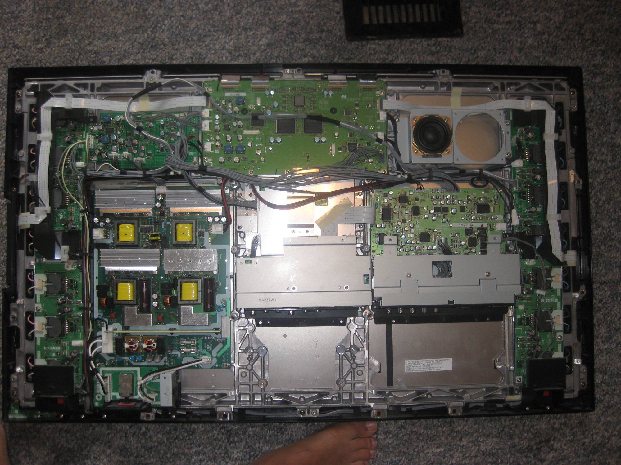

          It's hard to say what the main board is on that TV. I'd say it's the input card - with all the connectors - but what would normally be the Tcon (top of display) looks a lot more complex than it should be.
          One check, try disconnecting the LVDS cable from input board to Tcon, if lines stay, probably the Tcon or, less likely, the panel. Try turning the set on and off with the connector disconnected. Again rainbow lines point to bad Tcon or possibly (although unlikely) the panel.

            TCON or panel, I'd tend to say TCON. Note that there is no variation in the intensity of a vertical line throughout it's height. Note that (roughly) the left 1/4 of the panel is blank. These indicate an addressing problem.

              the rainbow lines never change sides or anything. just fade away after about 5-10 seconds to a blinking red light.
