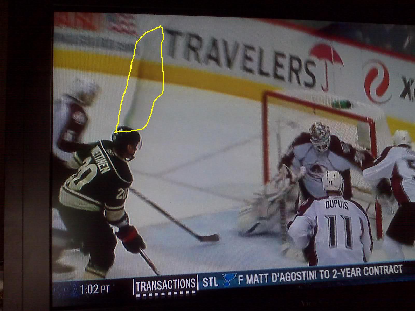

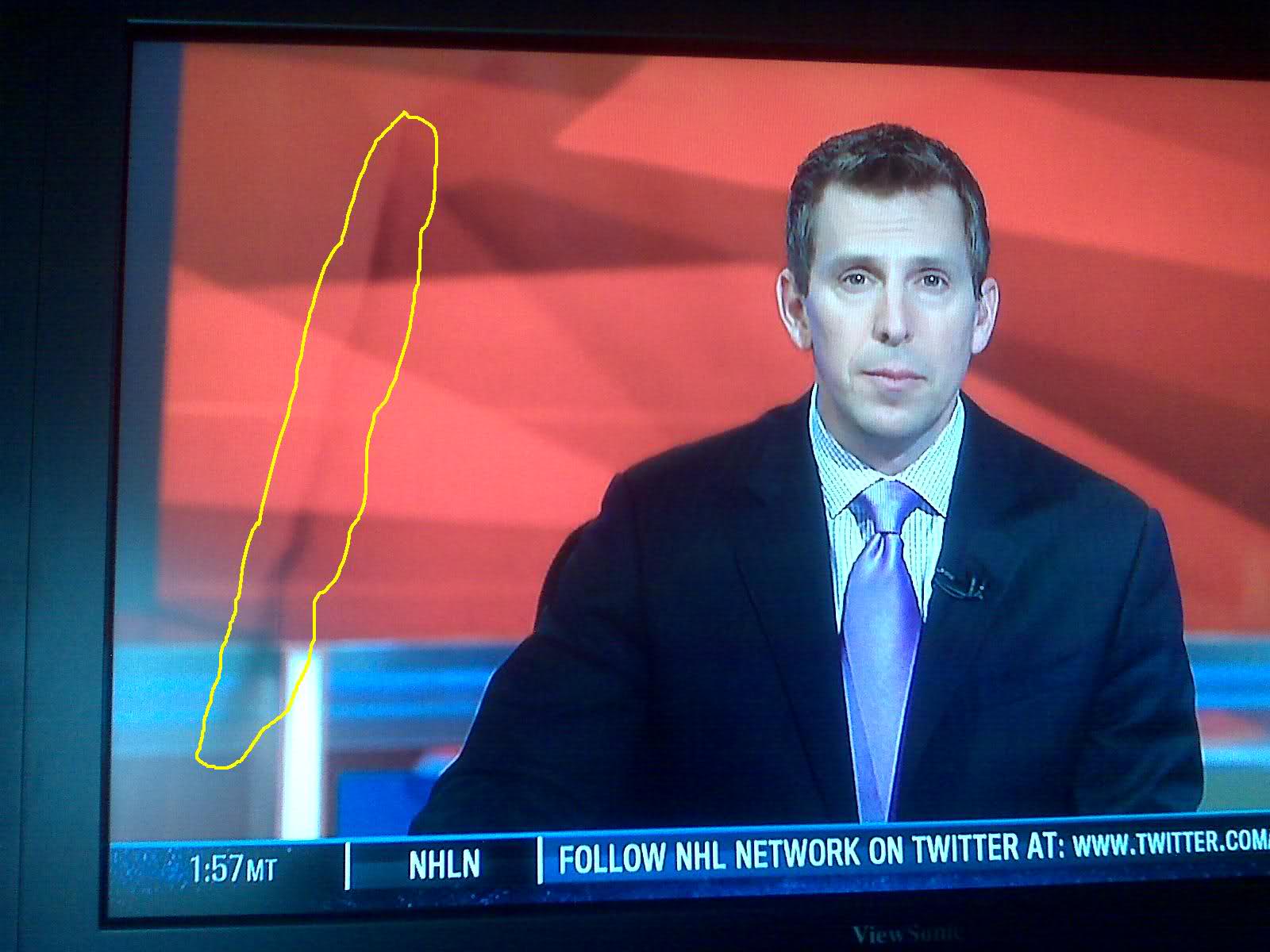

    Hi there,
    I got this TV as a hand me down from my brother about a month ago, and he's had it since about 06-07, and just the other day I noticed that when pressing the power button on the remote or on the TV it won't power up. It just shows the green LED light on for about a second then turns off. I have to hold it and keep pushing it for about a good min or so until it finally powers up. Is there any way to fix this? Or is the tv just simply dying?
    Also the tv has a "bleeding" problem with it as well, and I was wondering if there is anyway I can get that fixed. I mean it's not really noticeable only when the image is really dark or so. The lighter the image on the TV the more it fades away. Here are a few pictures;
    http://i52.tinypic.com/2j1wz0n.jpg
    http://i54.tinypic.com/30jjixi.jpg
    It doesn't really bother me at all. I was just wondering if this kind of thing is fixable. I don't think it's under warranty but hey it's a free HDTV. So I'm not complaining.
    Thanks!

      Re: ViewSonic N3760W Help!
      Looks like a pressure mark to me. Not repairable (OK repairable by replacing the LCD panel, which is prohibitively expensive).
