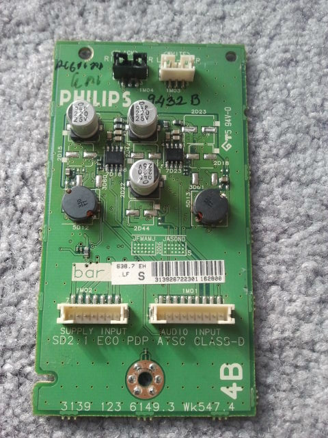

    got this tv on the bench just now. power light goes from red to green when powered on, no flashing lights at all. looks ok.
    but theres no display. unsure of sound as i cant switch on.
    theres a little led8001 on the power supply board. it flashes 10 times. anybody know anything about this fault code?
    thanks. hope you can help.

        Re: philips 50pf7521d/10 no display fault
        update: unplugged all cables from psu one by one.
        plasma is now up and running as i unplugged the audio amp card.
        NO SOUND.
        when i plug the amp back in, the tv will not come on.
        any ideas?
        • rayrod81
          • Oct 2010
          • 205
          I think you confirmed the problem yourself. Bad audio amp circuit.
            Correct. A fairly common problem with Philips. Possibly the amp IC itself.
            PlainBill
              i tried searching everywhere for the part. no luck.
                  And you expect us to guess the part? Post the numbers on the IC.
                  no, i did not expect you to guess, i wasnt asking for help to find it. i got enough help identifying the problem, which i am grateful for.
                  the part no: 3139 123 6149.3
                    That number is the number of the bare board. As a very simple rule of thumb, ALWAYS use a number on a printed label in preference to something screened on the board.
                    The number you should be searching for is 313926722301. It is available from suppliers in the USA, England, and France ad widely varying prices.
                    PlainBill
