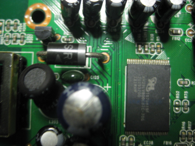

    My set top box stopped working, the green LED was dim.
    Opening the lid, I found C125, Aishi CD288Z, 16V 1000uF, bulging. Replacing it brought back operation to the device.
    I have posted some pics on my blog if you require more verification.
    Are you bragging, or just explaining why you are drinking?
    'It ain't bragging if it's true.' Congratulations, you did well.
