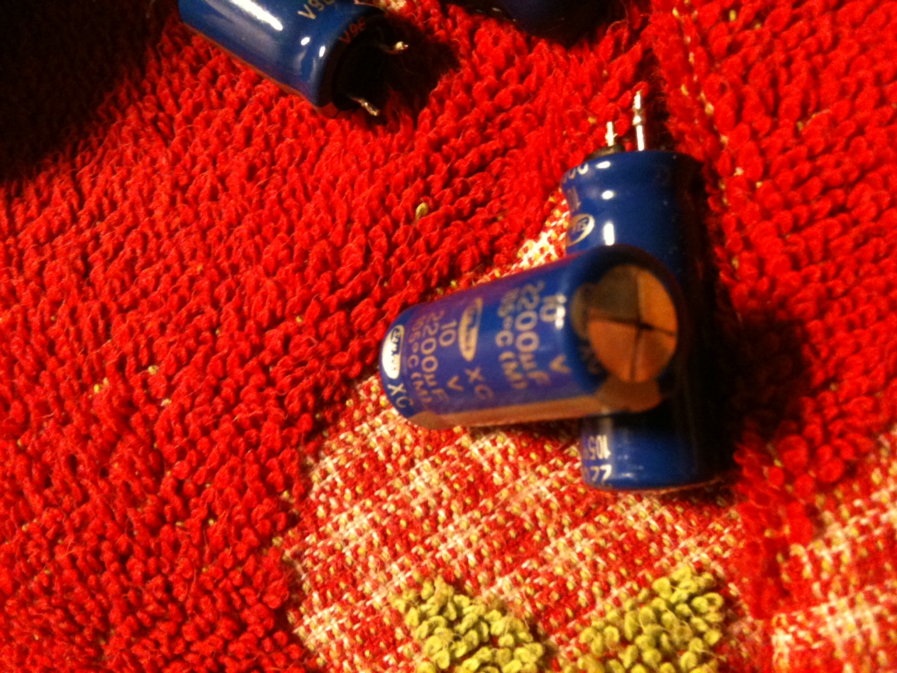

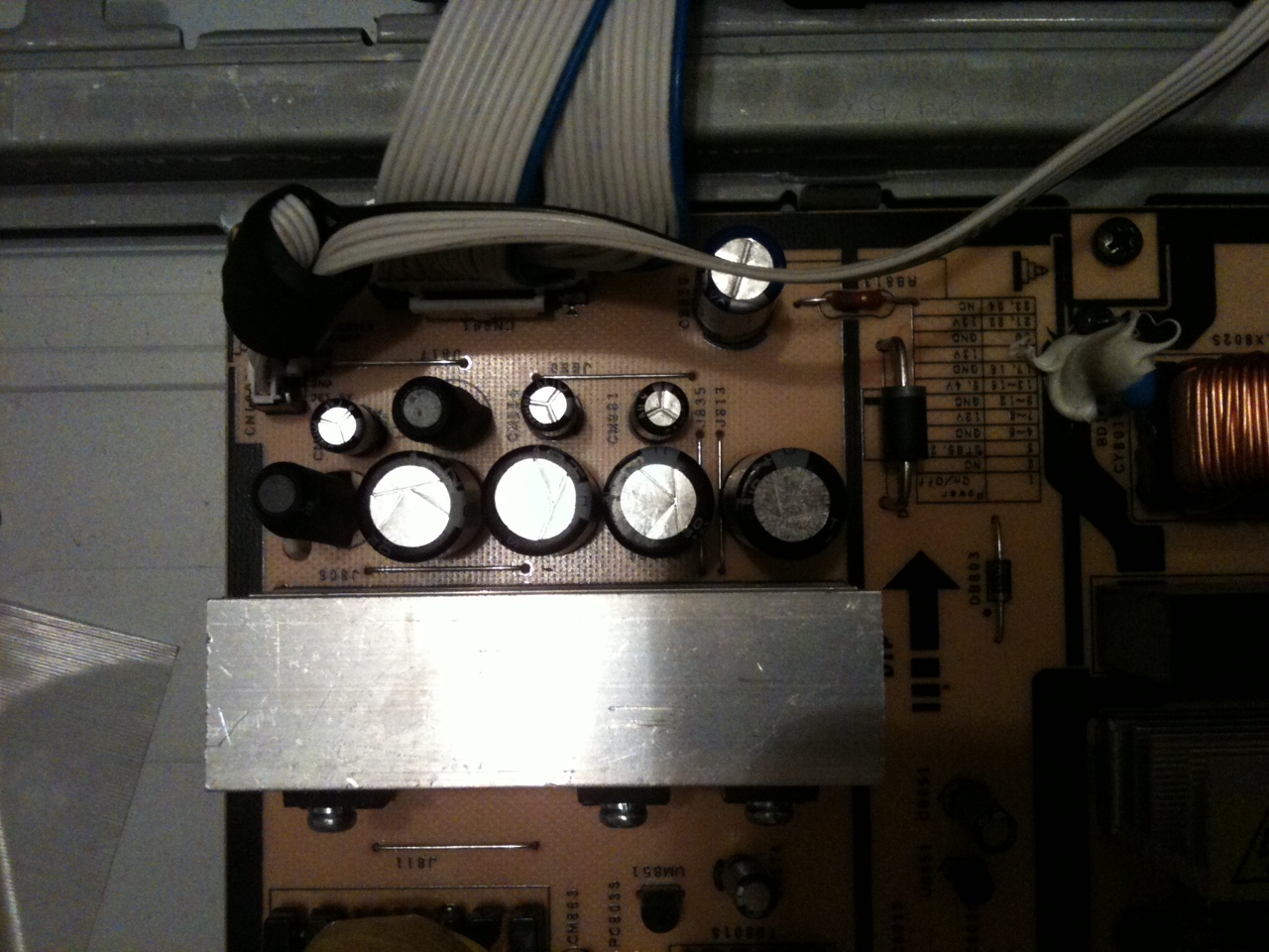

    I know there are several posts on Samsung and bad caps, but I am a bit stuck now. My TV stopped powering on, just kept on flashing the red diode 5-6 times before clicking, then repeated flashing 3 times before a new clicking sound. So I opened it up and found two bad caps, one leaking a bit the other just bulging. As suspected, crappy caps from Samwha, 2200 uF. I ordered new Rubycon caps and at the same time got some 1000 uF as replacement for the ones that looked fine.
    After replacing the two, I still had the same symptoms. Then I tried holding the power button on the TV (the touch button) in for 10-15 seconds. That stopped the flashing and actually started the TV. I haven't tested it over time, just saw a clear good picture with sound and all.
    I opened it up again, replaced two more blue 1000 uF Samwha caps - I actually ordered one cap to few But still no luck.
    The remaining one was a 10v, so I decided to temporary try to use the 1000 uF 25v I pulled out (yes, I know, bad thing to recycle this crap, but it still looked OK), but still the same. And just like earlier, I am able to turn the TV on by holding the power button in for a while.
    What should be my next move? There are other smaller and more odd looking caps around there, but from an non-expert view, they look OK.

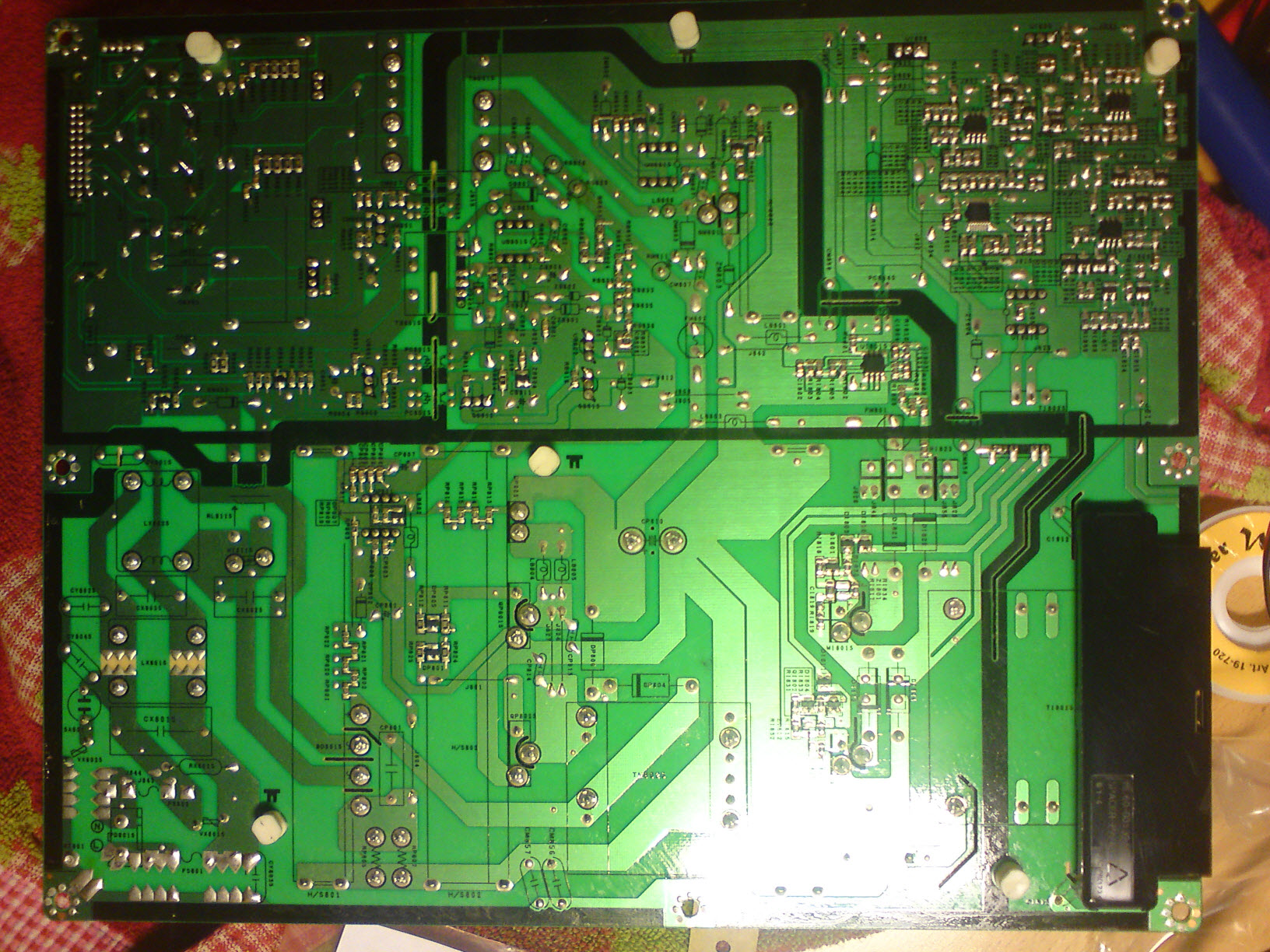

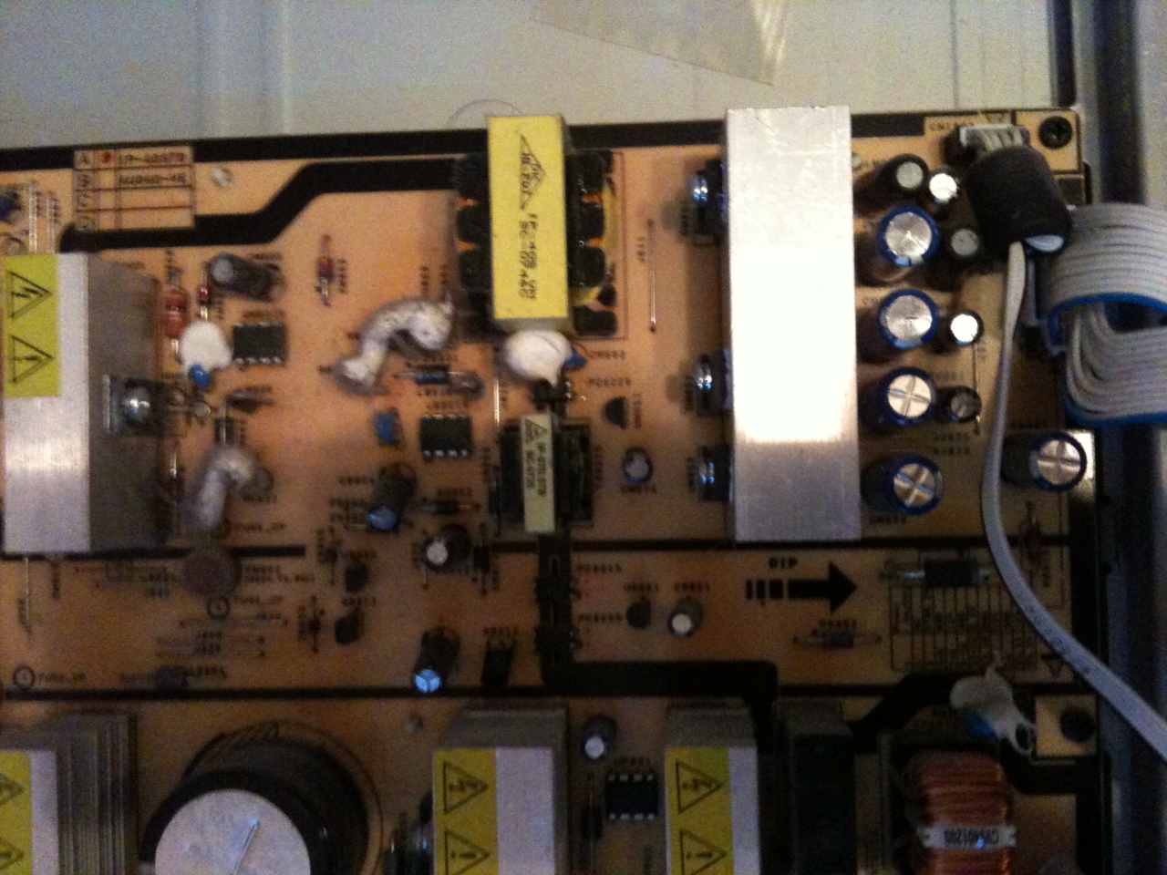

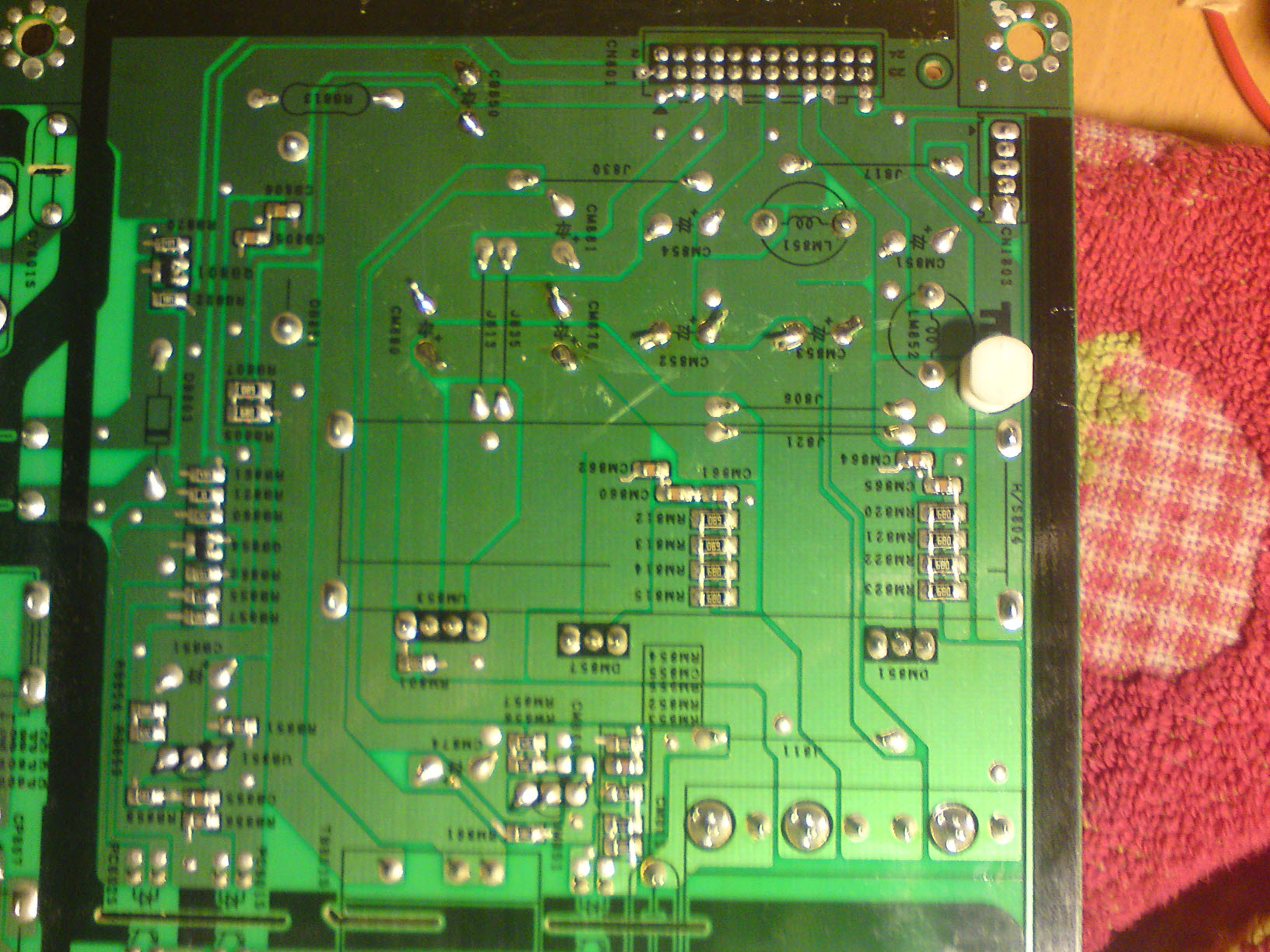

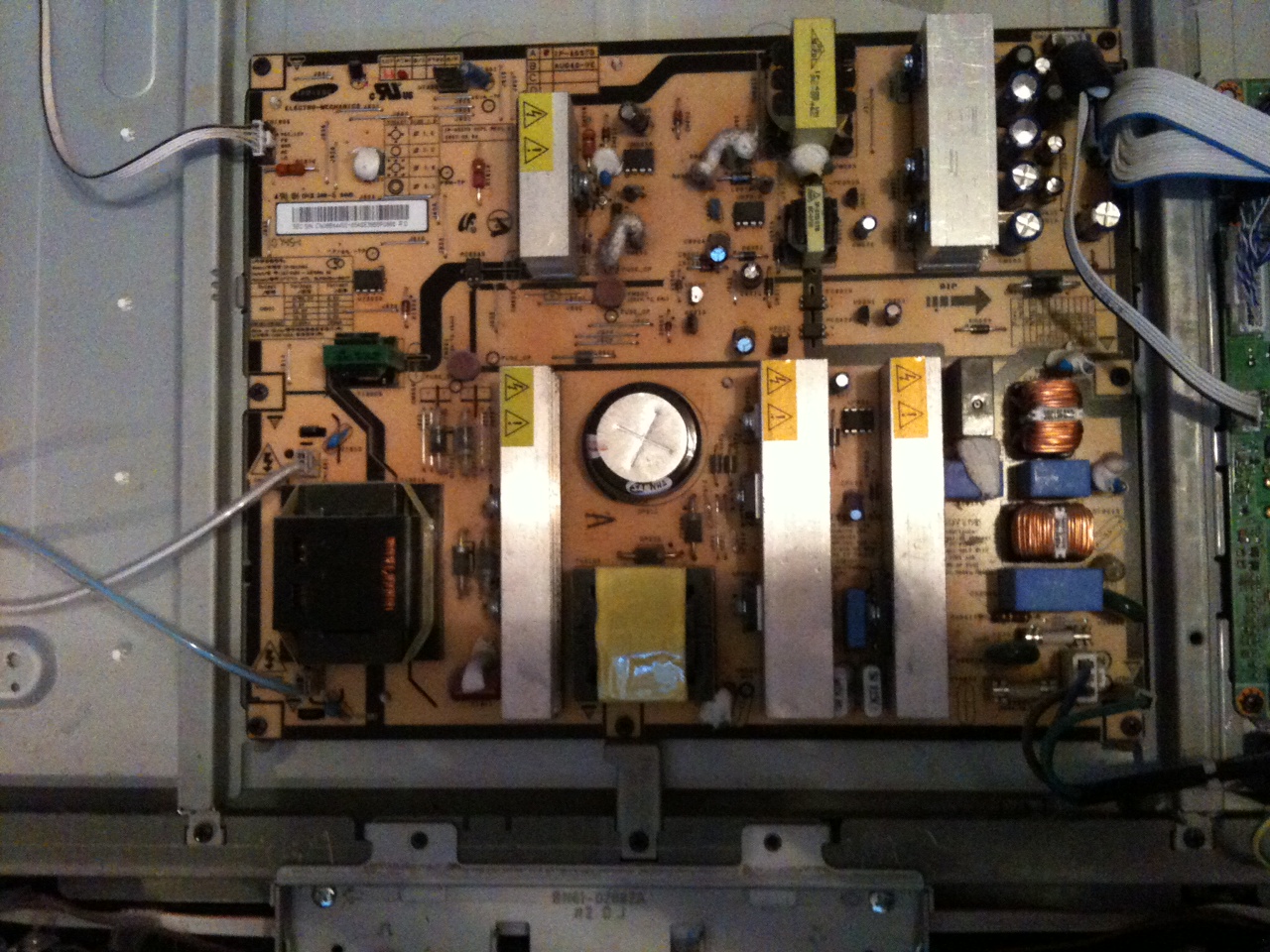

      Sorry for the picture quality, rather crappy. The last attachment (bilde1) should have been the first. In the upper right corner you can see the two blown caps. The third attachment is after I have changed the caps. The fifth is a closeup of where I did the soldering.
      This is what I changed from and to:
      CM853 and CM852: 2200uF 10v => 2200uF 16v
      CM876 and CM880: 1000uF 25v => 1000uF 35v
      CB850 is the one I tried replacing with a used cap, just to see.
      If the soldering job I did was poor, would I still be able to force on the TV (holding the power button)? I will have to get a replacement for the last cap, but I fear that something else is causing the problem.

          I have now also tried replacing CB850 with a new one, but no luck. I am thinking of replacing the other 47uF 50V caps in the same area - not sure if any of them can be bad or if they have anything related to the symptoms with the click and blinking cycling. The ones I plan to change are CM851, CM854 and CM881 in addition to CB851 which is 10uF 50V.
          As you instructed, I have downloaded the manual (two different ones). And I did buy a multimeter the other day, but I am not very skilled at using it.
          On a different note, considering the Rubycon caps I bought, what is the likelihood that one of them can be bad from production or that I have somehow damaged it when while replacing it. I did try to use the multimeter on both ohm setting and uF to test the Samwha caps and also the new caps to see if I could spot any different, without making much sense out of it.

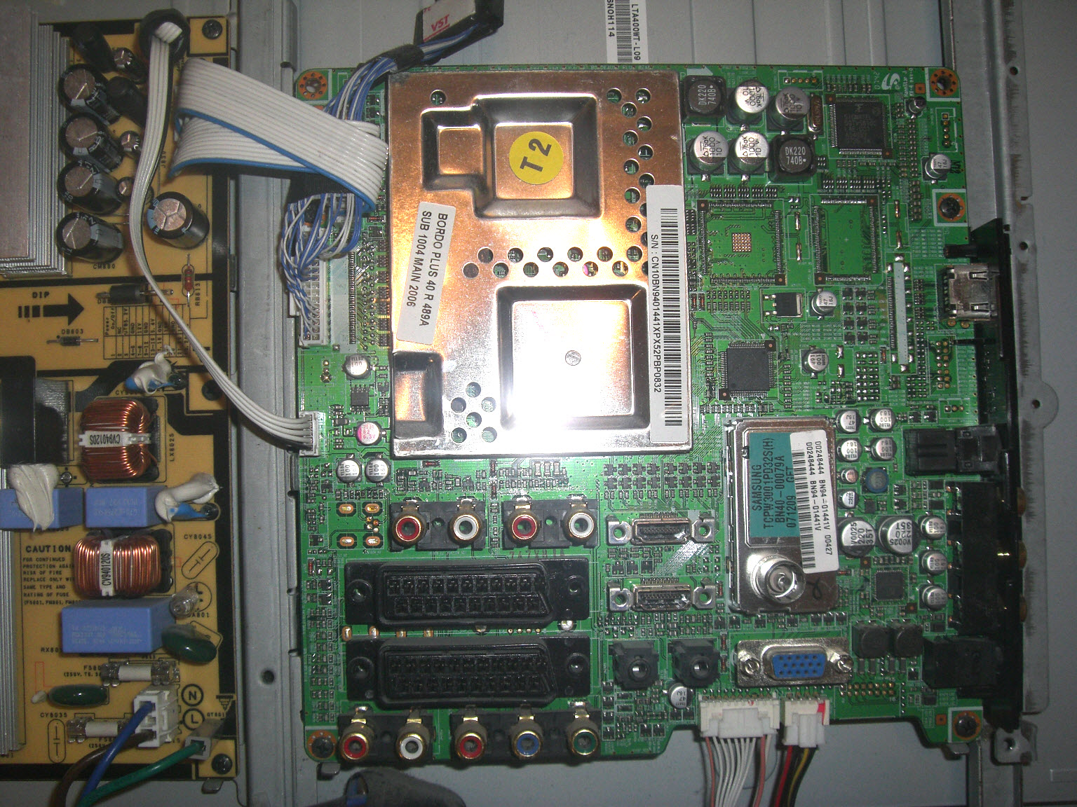

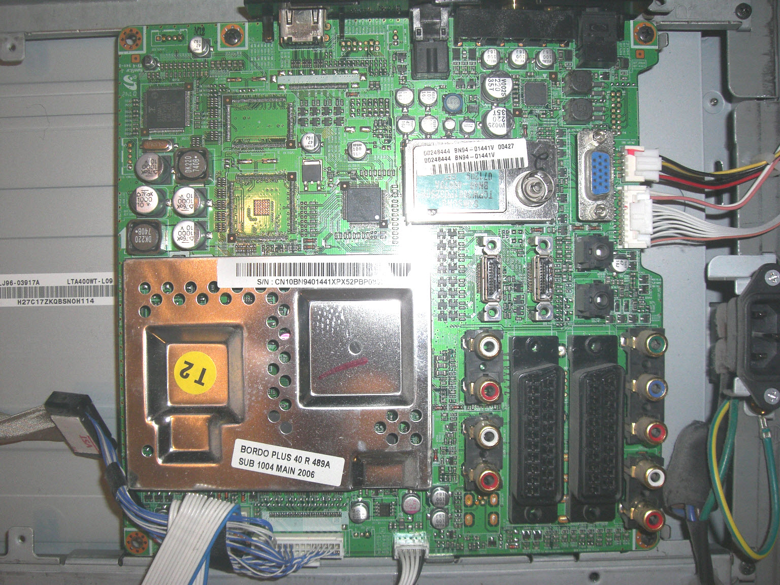

          I attached two shots of the main board.

            Re: Samsung LE40R81B and clicking
            I've had several LE40R86 and LE40R88, after standard cap failure doesn't come on due to problems in mainboard (the one with all the A/V connectors on).
            I've verified that the repaired powersupply is working, by swapping in another working set. Also tried another working powersupply together with the mainboard in the failing set, this gives the same results.
            So my conclusion is that something bad happens to the mainboard when operating the tv with bad capacitors, like memory locations getting corrupt, firmware problems, and so on.
            So I'm afraid this might be the problem with your set aswell.
            I've two units which I cannot bring to life after cap replacements, which I then think is the mainboards is now out of order.
