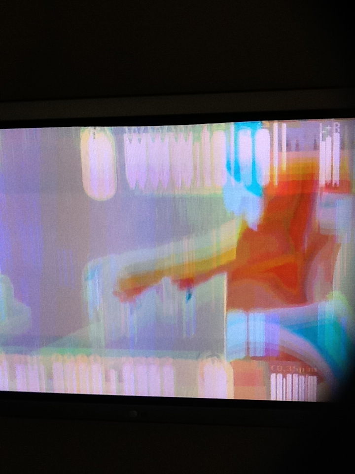

    My LG plasma TV gave a rare screen before something in the tv has broken or blown. First it looked like a wet oil painting. Then suddenly a sound like exploding a capacitor. After inspecting the the electronics i could not find any damaged capacitor. Nor some other part that has blown up. On the Y-SUS board i found one of the two fuses was broken. After replacing this fuse the tv powers up, for two seconds the green light goes and then it turn back to red. I disconected the Y-SUS board and then the led stays green. Removing the fuse and reconecting also result in a normal power state (green light). Disconecting the controll board (the bottom board connected to the pannels) gives the same result. So i think the Y-SUS board is defect, but I am not sure. Is there any one who can help me out on this? Does anyone know where i can buy this Y-SUS board (6870QZE009H)?

    John, It's obvious you born in the USA - your English is too good. Also, you have done a good job of describing the problem and troubleshooting. Thank you.
    There is one mistake. The 6870QZE009H is a Z-Sustain board; the Y-Sustain is at the other side of the TV. The symptoms you describe match a failed Z-sustain. There are several available on eBay, including a new one.

      Re: LG MZ-42PZ44 42" Plasma Television switches on 1sec and then turns of
      Hi, PlainBill.
      Thank for your advice. I bought the board on eBay (tvpartsguy) and received it.
      I replaced the board and the tv works fine FOR 2 DAYS. Now again after a while the same simtoms as before. See the picture. With the previous board it got damaged after a few days. To prevent this, i rather not use the tv until i know the real cause.
      Does anybody have suggestion of the real cause of this?
