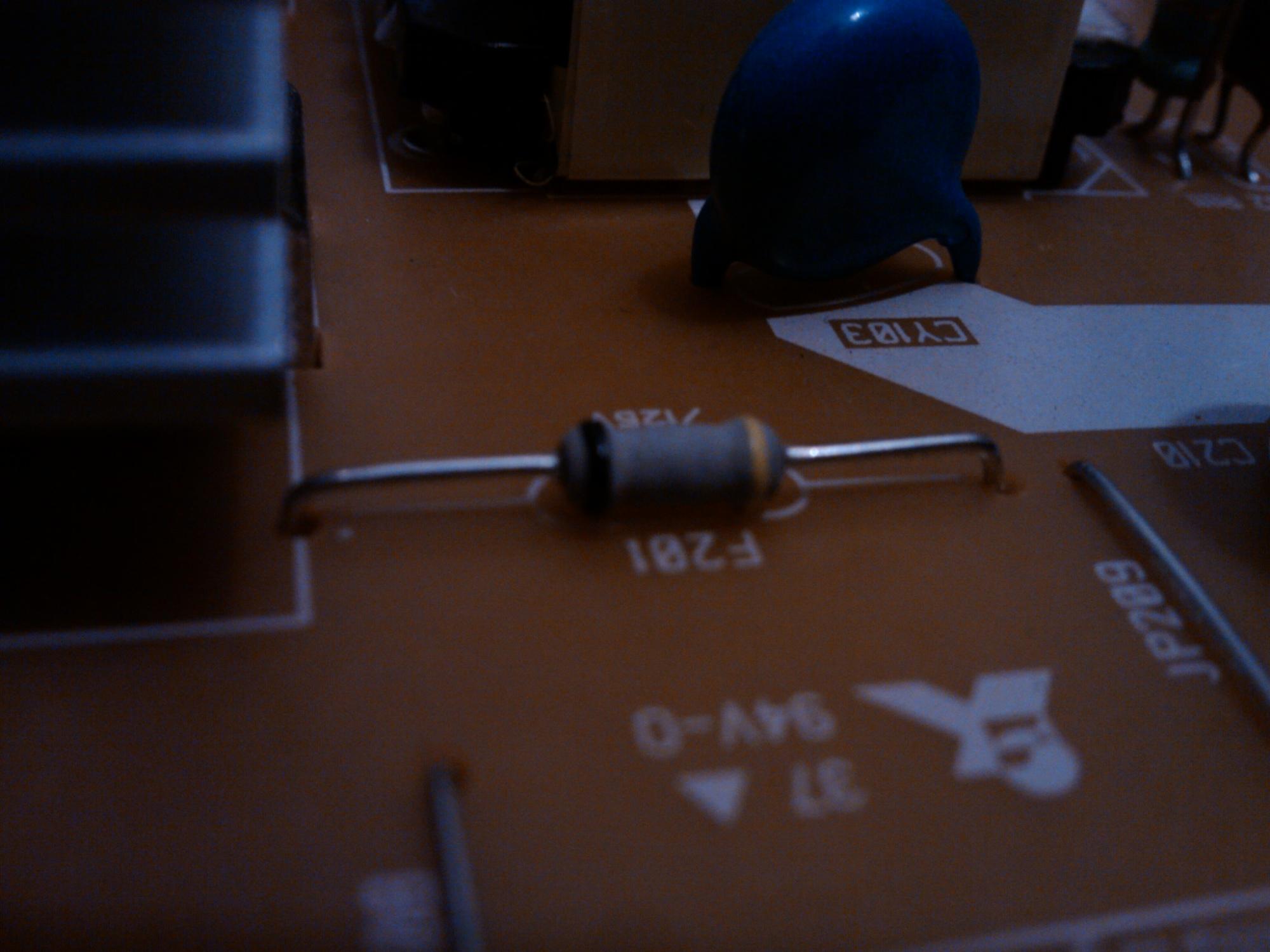

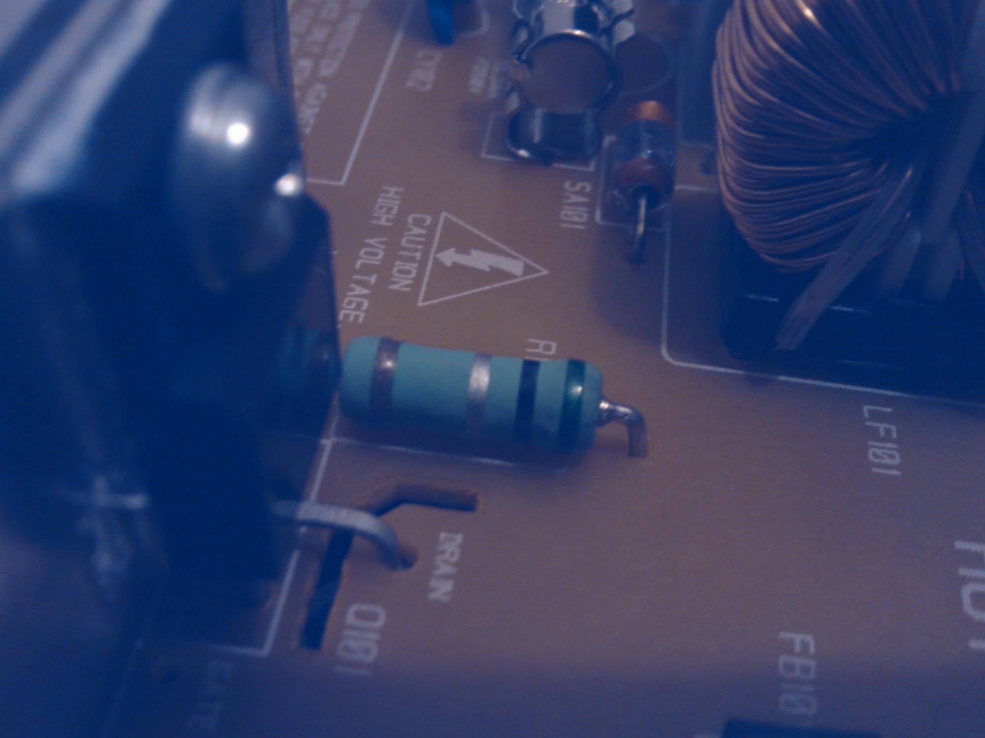

    I have a samsung 933HD which is being a pain it sometimes turns on and the blue light displays but no responce when pressing the power button but other times it turns on but off after a few seconds and then other times it works fine untill I put it on stand by again
    I have replaced all the capacitors on it apart from the large 450v 100uf

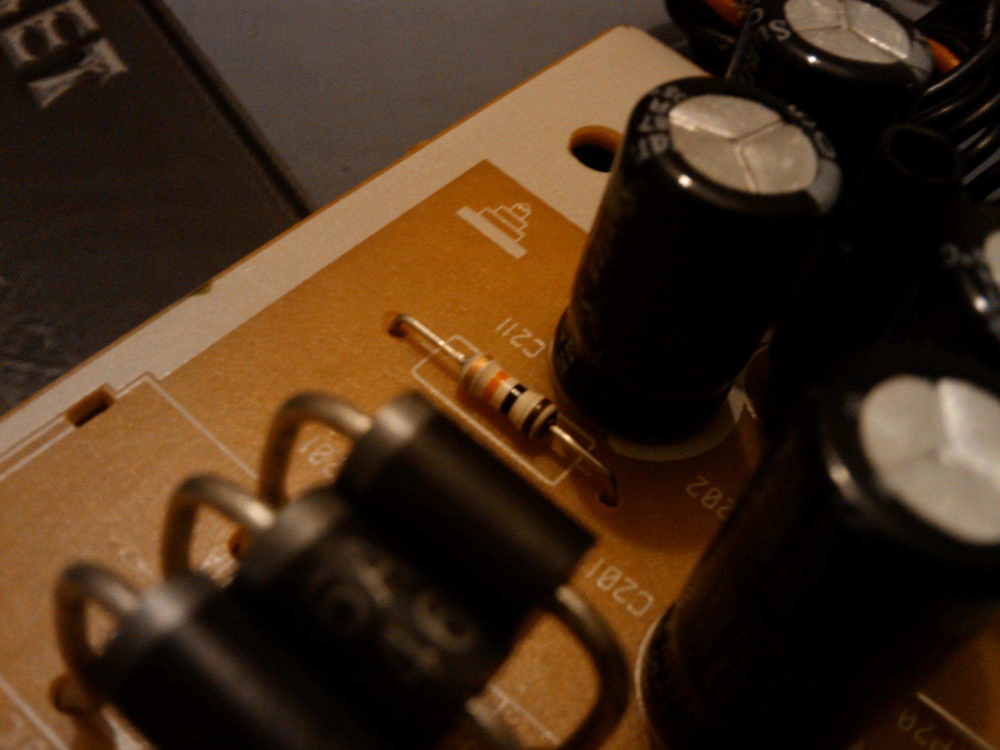

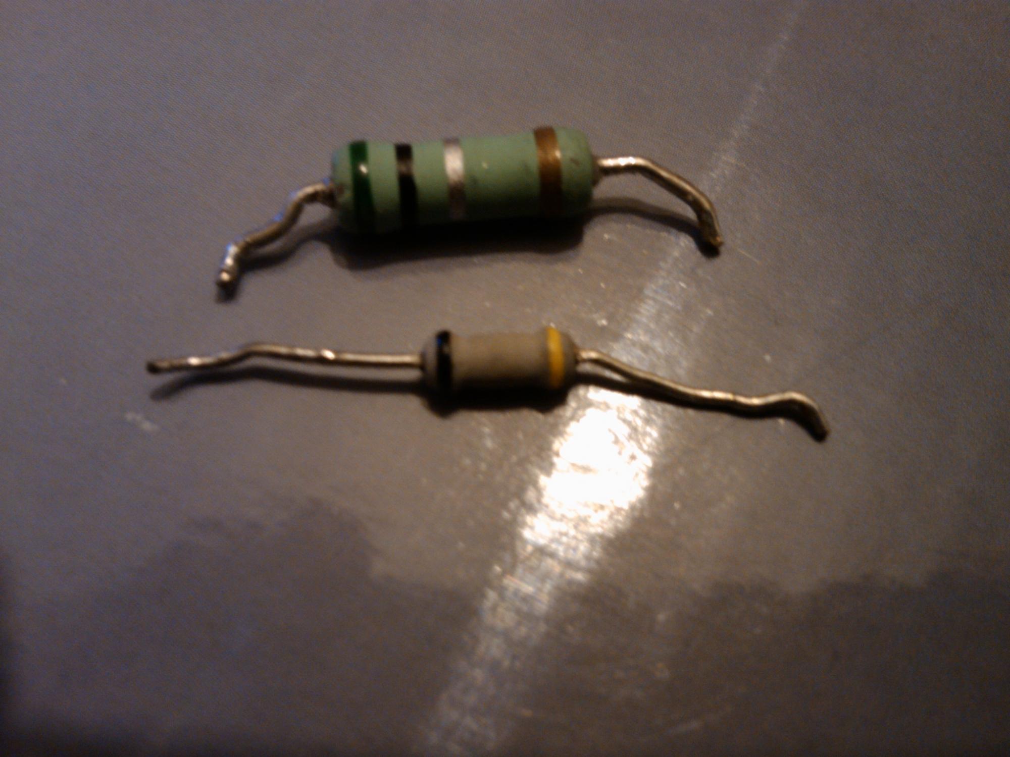

    I was going to replace all the resistors but hit a snag - there is one with only 2 bands on either side a black and a yellow and on the board next to it it says "F201 F4.0AL 124v" any idea what that is and where i can purchase one from?
    Any idea what could be the problem? Also how can I test the components? - I have a multimeter.

        That's because it's not a resistor - it's a fuse.
        PlainBill
          PlainBill
          I thought that as it has f201 and not r*** written on the board - where can i get this fuse from? what is it called?
          -Thanks
            -Thanks
            It's called a 'Fuse'. Now, I'm going out on a limb here, but it sounds like it could be a 'Picofuse'. You see, I'm a certified electronics genius (my brother-in-law says certifiable, but you know how in-laws are), but without a clear look at (or picture of - hint) the part in question, I have no way of knowing what it looks like.
            More to the point, why are you replacing parts without determining if they are defective? I've known 'techs' who 'shotgunned' by replacing half a dozen components at the same time, but what you are doing is more like a hand grenade.
            PlainBill

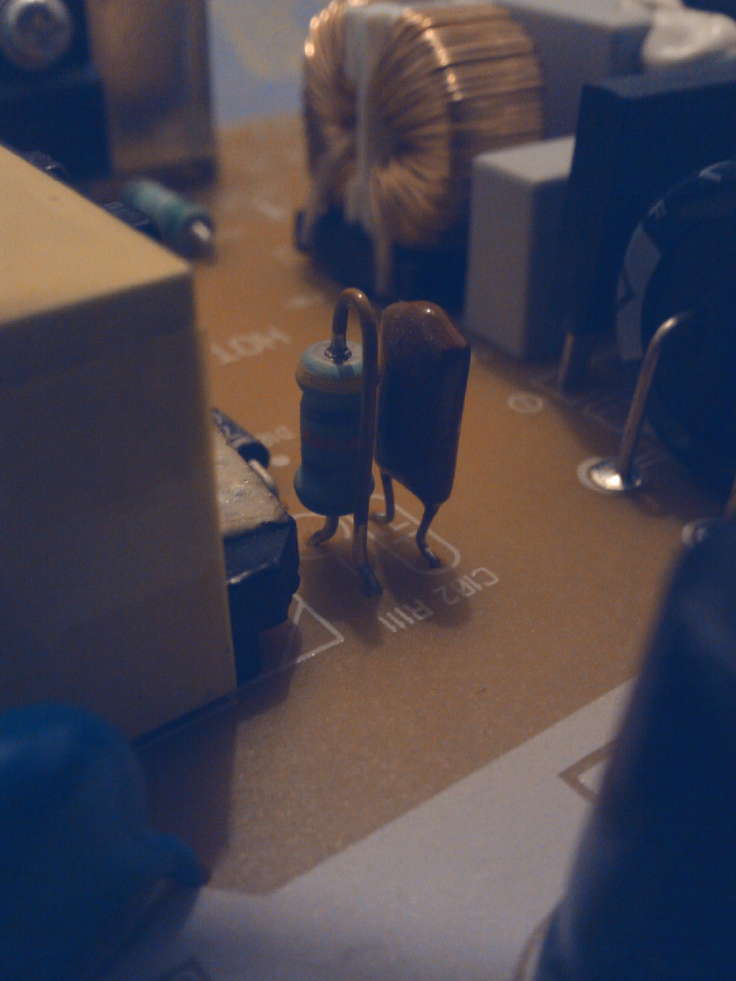

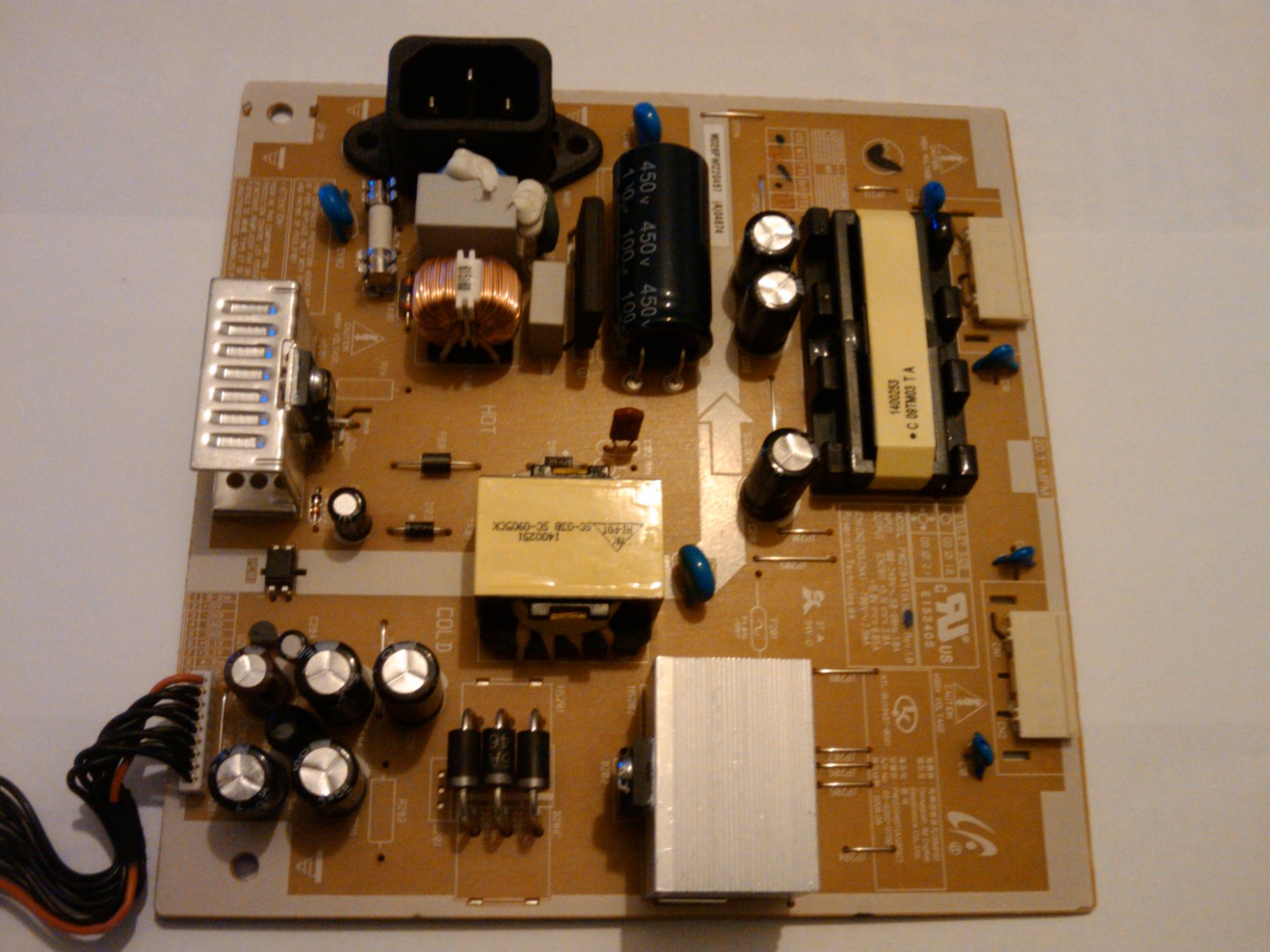

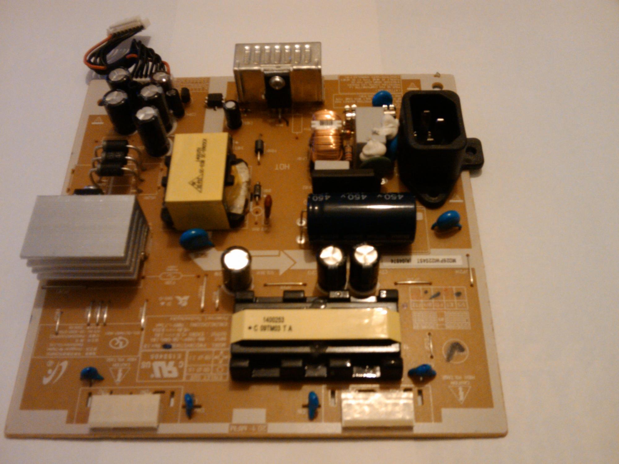

              hi,
              Yes i hoped i would hit the problem by firstly replacing the caps then the resistors as they seem to be the main cause to most problems but main reason is i dont know how to test them.
              I have attached the pictures.
              Thankyou for your help

                  Let me state this clearly: You are using the wrong approach!!!
                  If you took your car to a mechanic because the acceleration was sluggish and the handling was sloppy would you be happy if he started by making sure every bolt was torqued correctly? Would you be appreciative of his thoroughness if he then wanted to check every screw in the car?
                  Or would you be a little more confident if he started by checking the tire pressure, checking for play in the steering linkage, looking at the air filter, and checking things like shocks and alignment?
                  There are a few basic voltage tests that can help isolate the problem area. I hesitate to suggest them because I question if you know enough to avoid electrocuting yourself!!!

                    The two components , that have been pulled off of the board already, can be tested by using the ohms resistance scale. Measure these components and record what you see. If that one is a fuse, it will either show one of two things: zero ohms, if good, or infinite if bad (blown)
                    For the record, resistors rarely need replacing if they have not burned. If I were you, I'd put it back together and start over with a better method like Plainbill suggests. Peeking and Poking is the wrong way.

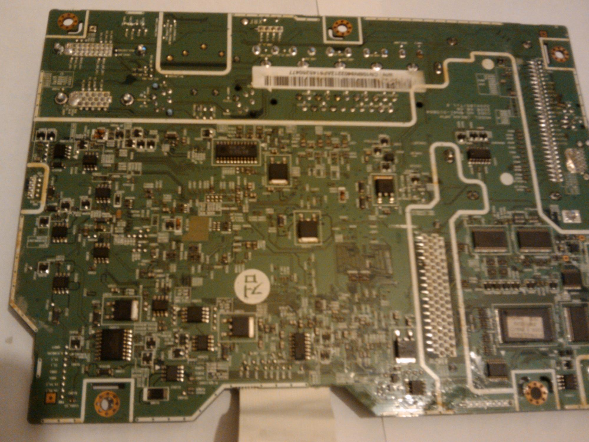

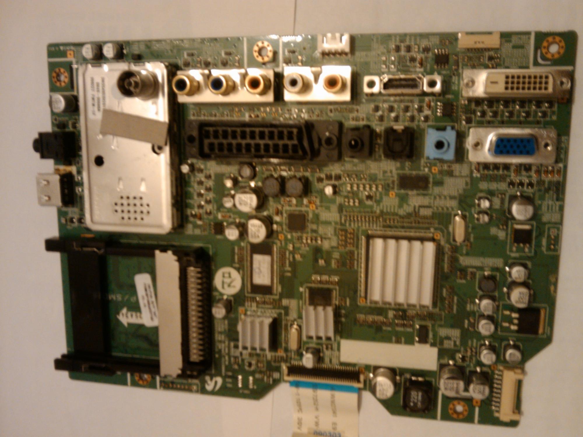

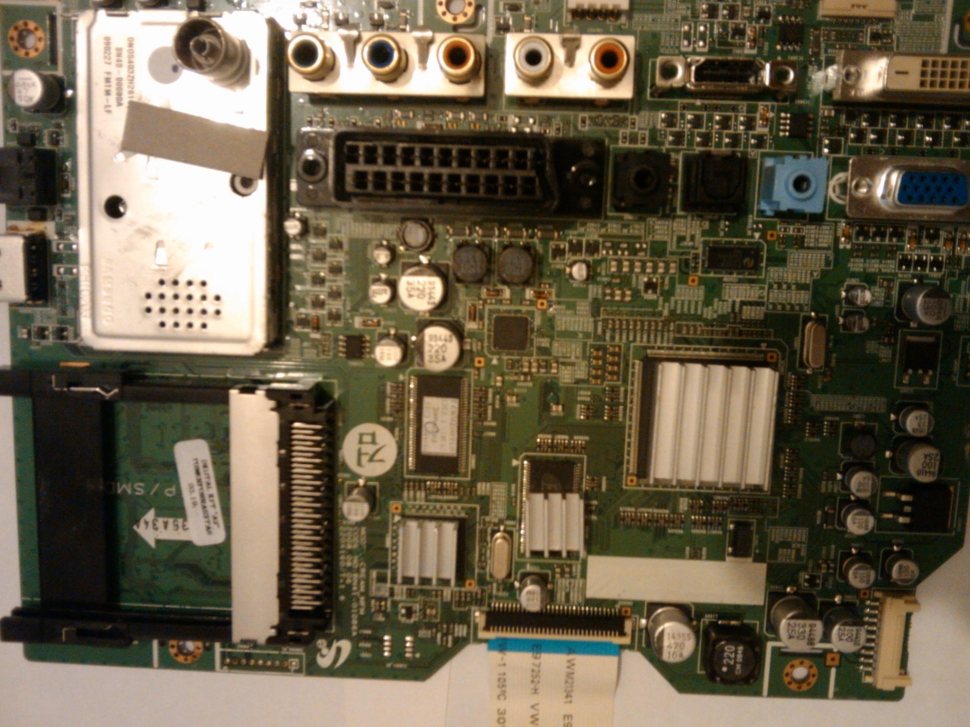

                                    • alexanna
                                      • Mar 2010
                                      • 1346
                                      Re: Samsung 933HD not staying on help

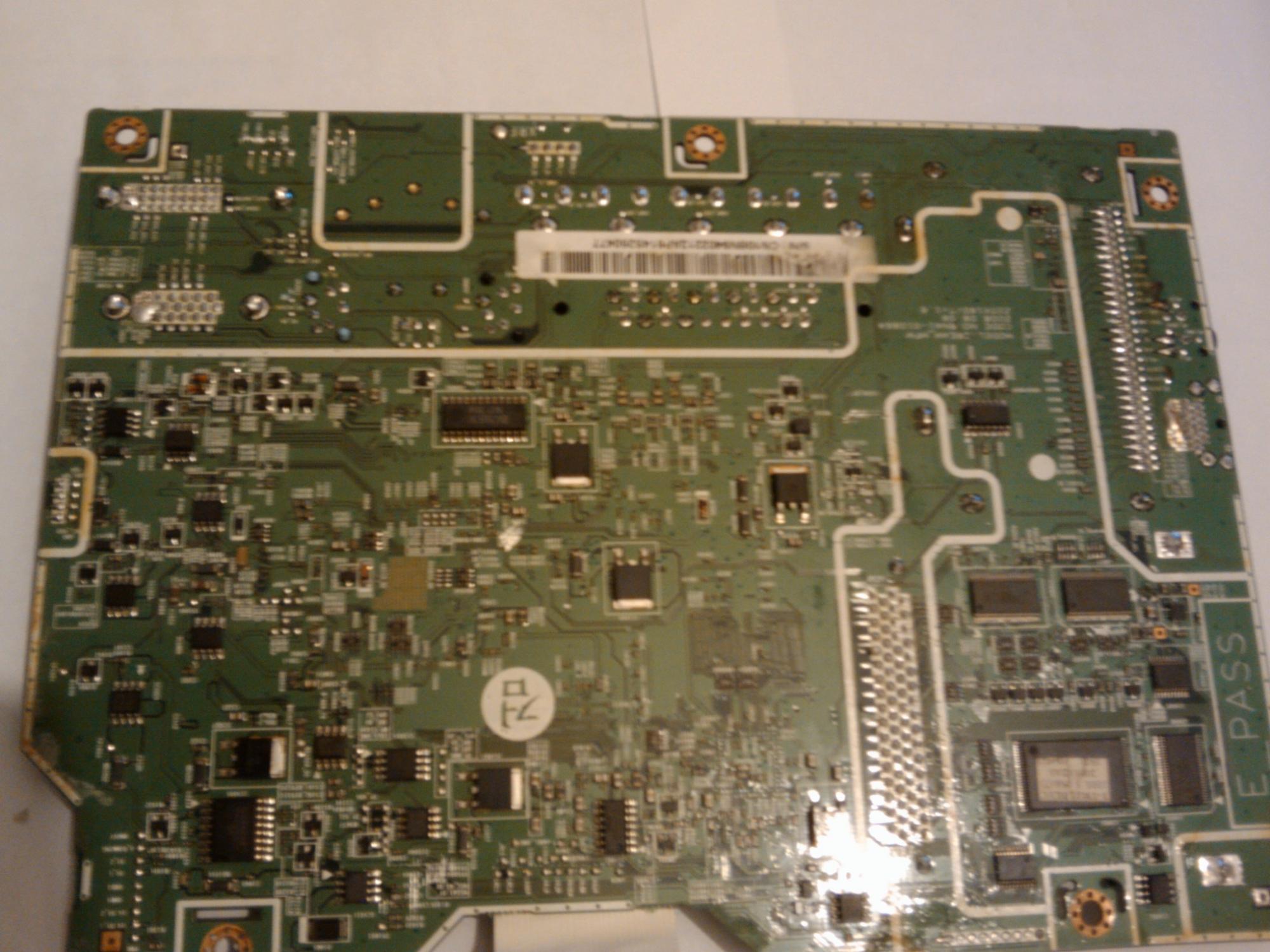

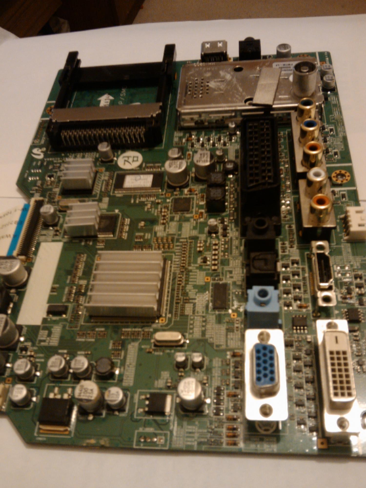

                                      The problem you're having with the power LED being on but no response when you push the button, sounds like a problem I have noticed when one or more of the voltage regulators are starting to fail.
                                      I f you could post a picture of the logic board
                                      Whatever I do, I consider it a success, if in the end I am breathing, seeing, feeling and hearing!
                                        The readings changed when i plugged everything in and turned it on, they are as follows;
                                        1) B-Dim = 1.50
                                        2) +15v = 15.44
                                        3) GND
                                        4) GND
                                        5) GND
                                        6) +5.1v = 5.18
                                        6) +5.1v = 5.18
                                        7) A-Dim = 0.70
                                        8) On/Off = 5.02
                                        I have attached some pictures of the logic board, is there any way I can test the voltage regulators?
