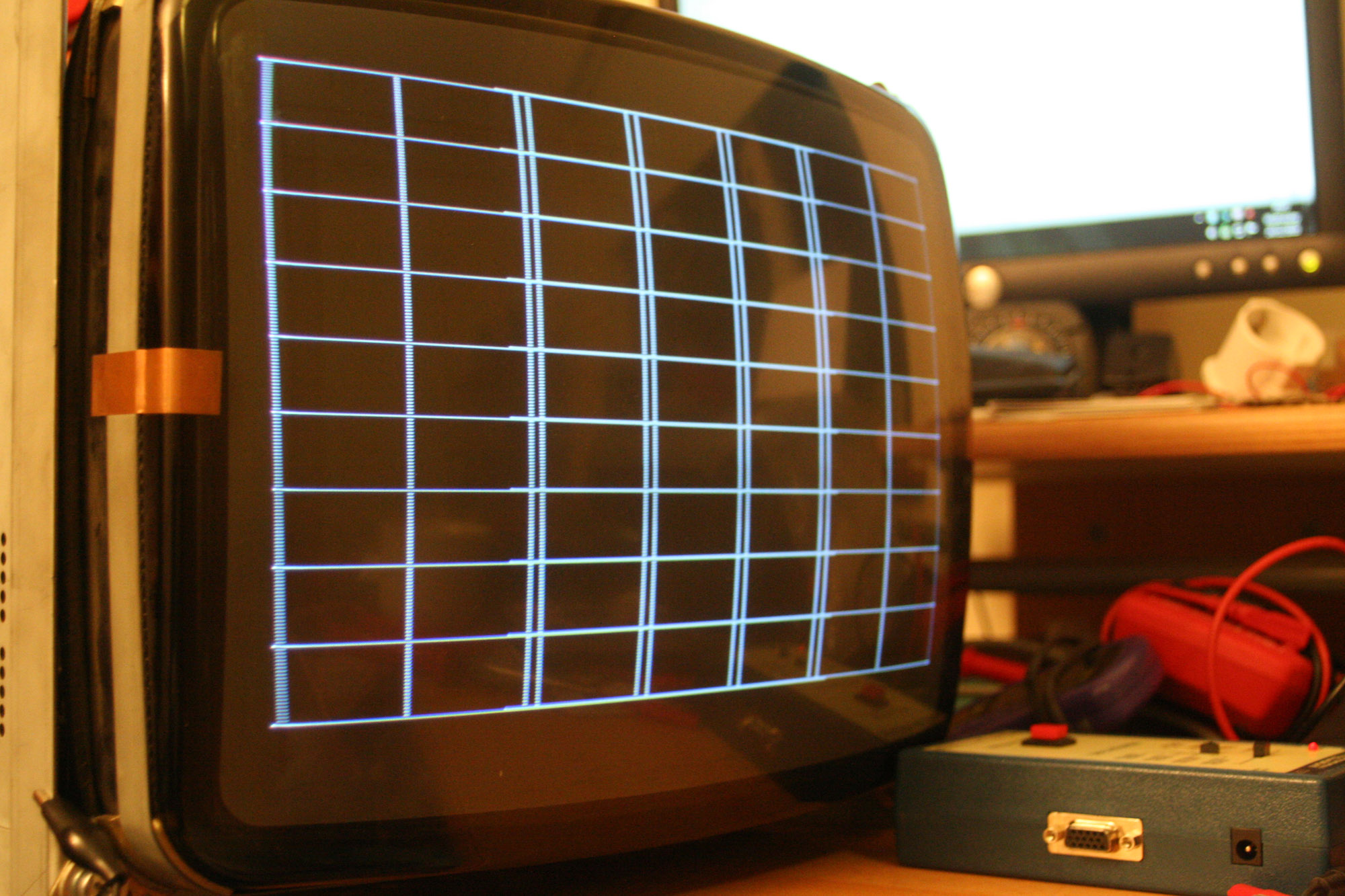

    Anyone remember CGA? I havent seen one in years. This is an industrial CRT monitor with some problems. Model is Lucius & Baer CC14VAO-CH.
    It came to me dead. After replacing many electrolytic caps, it came back to life. I generally check capacitance and ESR on all once I find a few suspect.
    Probably more trouble than it's worth, but I like old stuff. This monitor requires a H-sync signal before it will run.
    The only CGA source I have is a BK Percision 1275. I made up a connection from a serial cable and built a 'gender adaptor' to sort out male/female issue at the monitor. Now, this could be the issue!

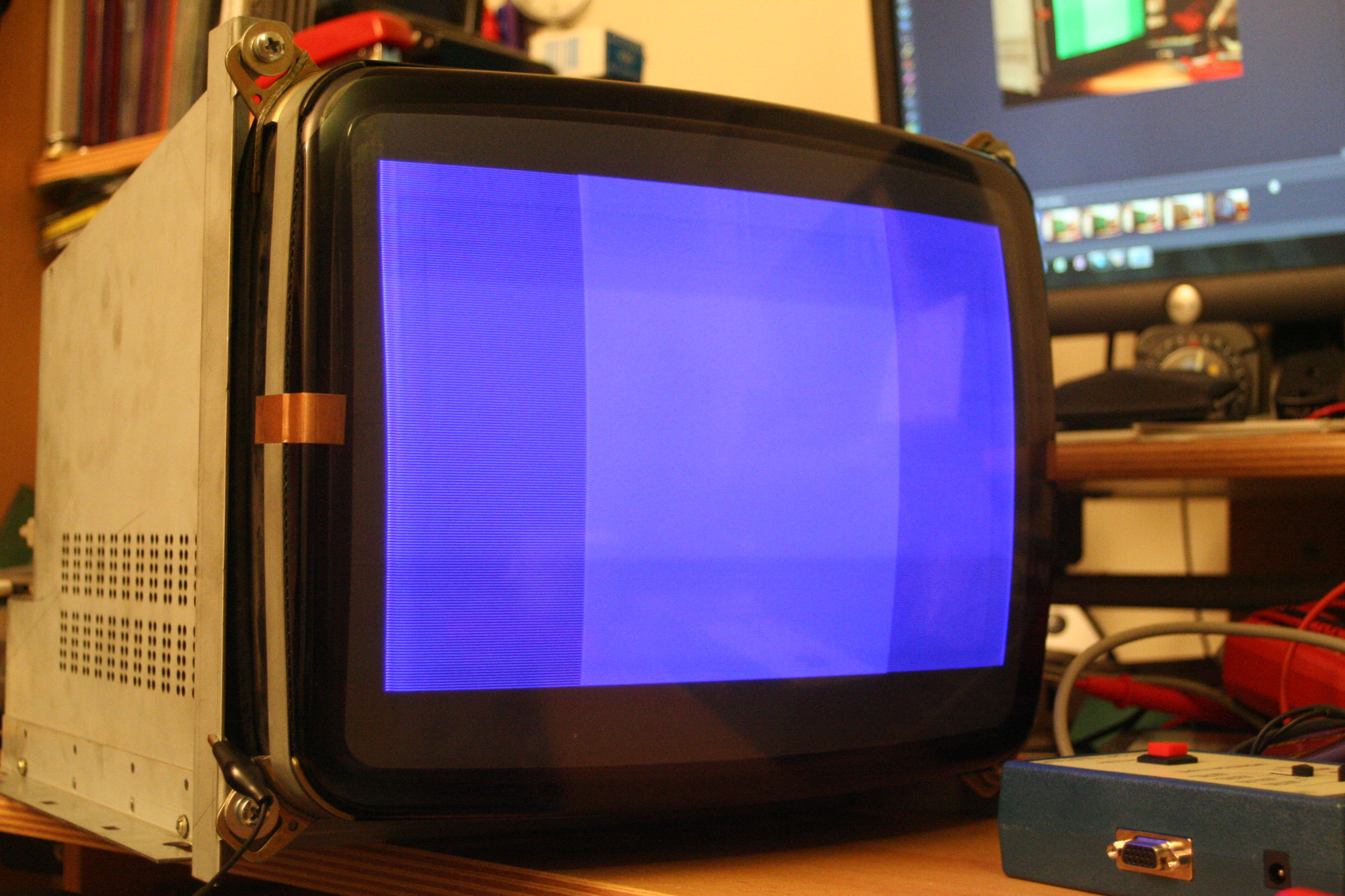

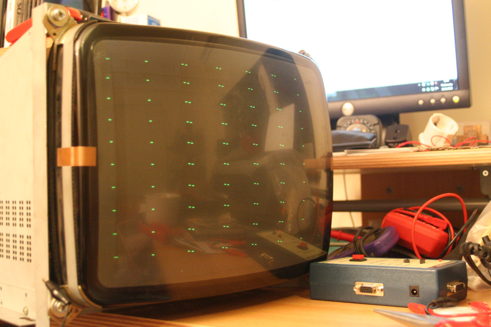

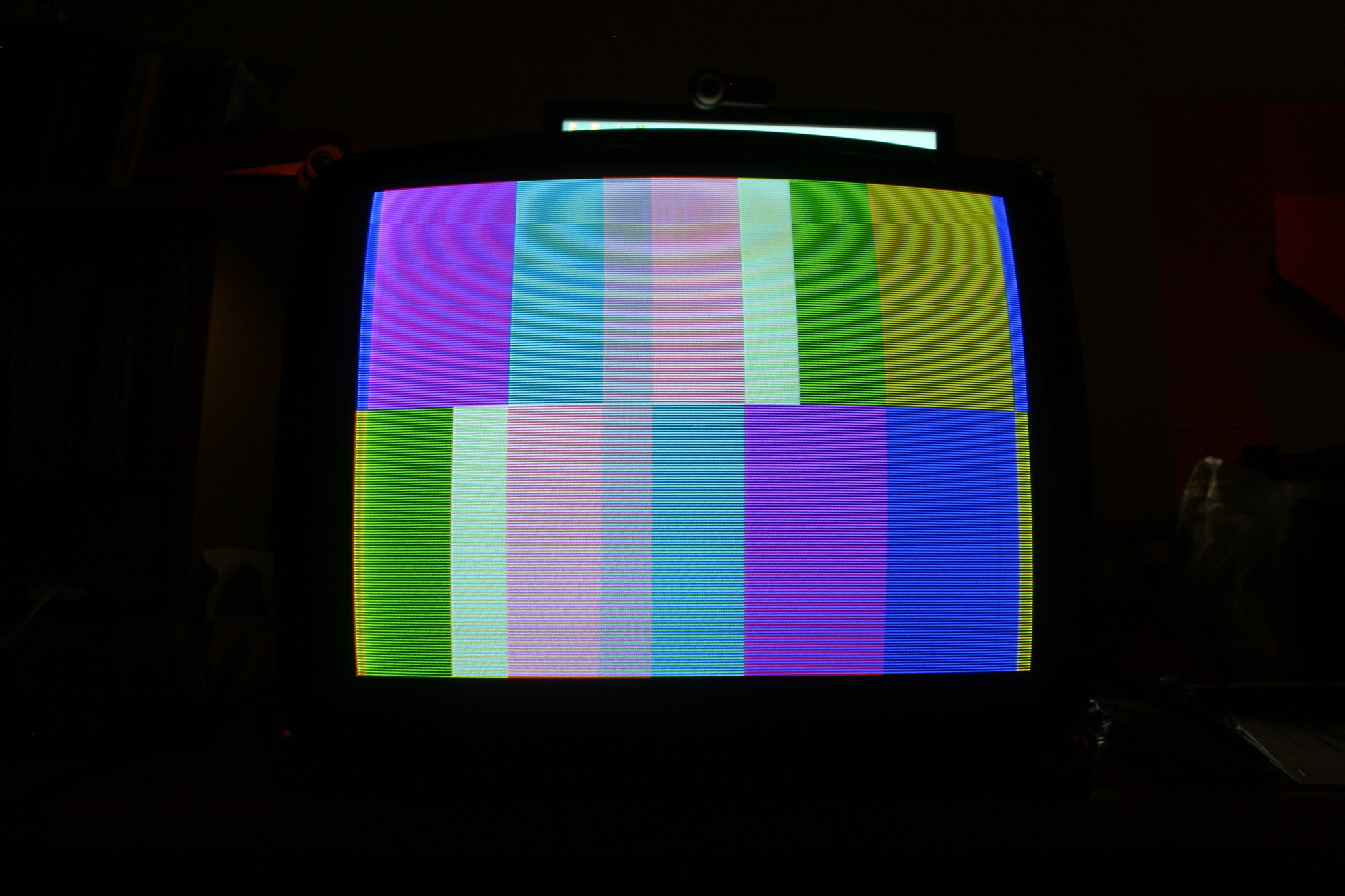

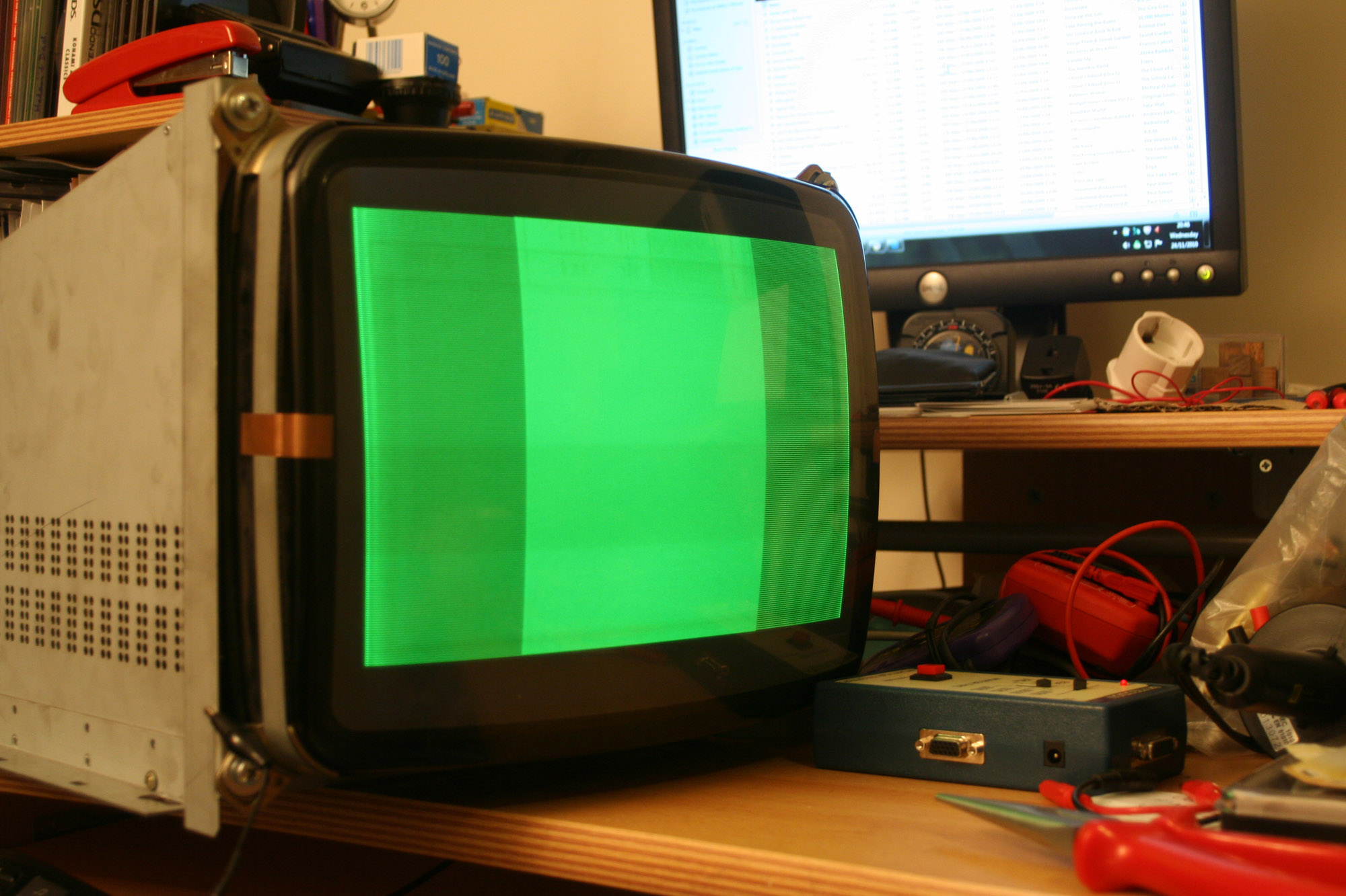

    In the attached pictures, on solid primary colours, and white, there is a solid wide vertical bar down the screen. This can be moved across the screen with H-Pos pot at the rear of the monitor. On other test patterns, vertical lines look split, and on the color test, RGB looks just a bit odd as in the attached image.
    I'm not an expert on monitors, so would appreciate your help. See attached pictures. Any opinions, checks, what should I expect?
    Have an basic tools, oscilliscope, DVM etc. and willing to learn more!

    not cga.maybe ega or vga.possible nonstandard scan rate.
    the image shows its set to the wrong scan rate.
    edit.
    its a vga.
    i remember fixing one a while back.was in a husky plastic molding machine.

      Your interlace is off, need to find more small value capacitors around the IC that takes inputs and outputs horizontal and vertical pulses.
      CGA is TV chassis type without tuner, video is fed in either by composite or TTL. The timing is same as TV.
      15.7Khz 60Hz. Plucked from wiki on CGA:

          Yes, confirmed the H-sync at 15.76Hz, and V sync at 60.1Hz. The CGA system is based upon TTL level signals. This is smilar to EGA with the intensity pin 6 providing additional colors. It's a TV without a tuner! It's not possible to treat this as a VGA input signal.
          H and V signals go trough an XOR arrangement and then on through a 74LS123 'one shot'. From there a NPN transistor provides drive, possible level shift. Will have to explore the board some more to understand the circuit. It's a real pain to access!
          There is an analog multiplexer (4051BE) in there also. Not sure why. Guessing this could be a switch depending on scan rates?
          I did try to vary H-hold pot on the PCB, to get a lock on the images I attached. I also tried EGA source from the BK1275 but could not get a lock. Measured H-freq at 21.82kHz and V-freq at 59.6Hz. Checked on a scope etc.
          From your experience, is this issue more likely to be H-sync related? Will be checking Vertical and Horizontal deflection IC specs.

            Yes!! Horizontal is way off. Should be 15.7KHz.
            Where is 22KHz pulses coming from while inputting 15.7KHz H and 60Hz V? That's your hint, trace back.

              again its vga not cga!
              try 31.5 h

                    This thing has a hex buffer behind the 9 pin d-type input at the rear... it only accepts TTL level logic. The pin out matches with CGA and EGA standards which both have lower sync frequencies.
                    You have a point though, I also have seen some wierd industrial stuff. Just need to figure out how to get 31.5kHz into it?

                      Monitor all ran fine when returned to owner. The H-sync was 31.4-31.5KHz. Monitors such as these do not conform to CGA/EGA standards, in this case, recapping and the occasional faulty power supply seem to be the only issues. The TTL levels, and pin outs match these standards but timing is everything!
