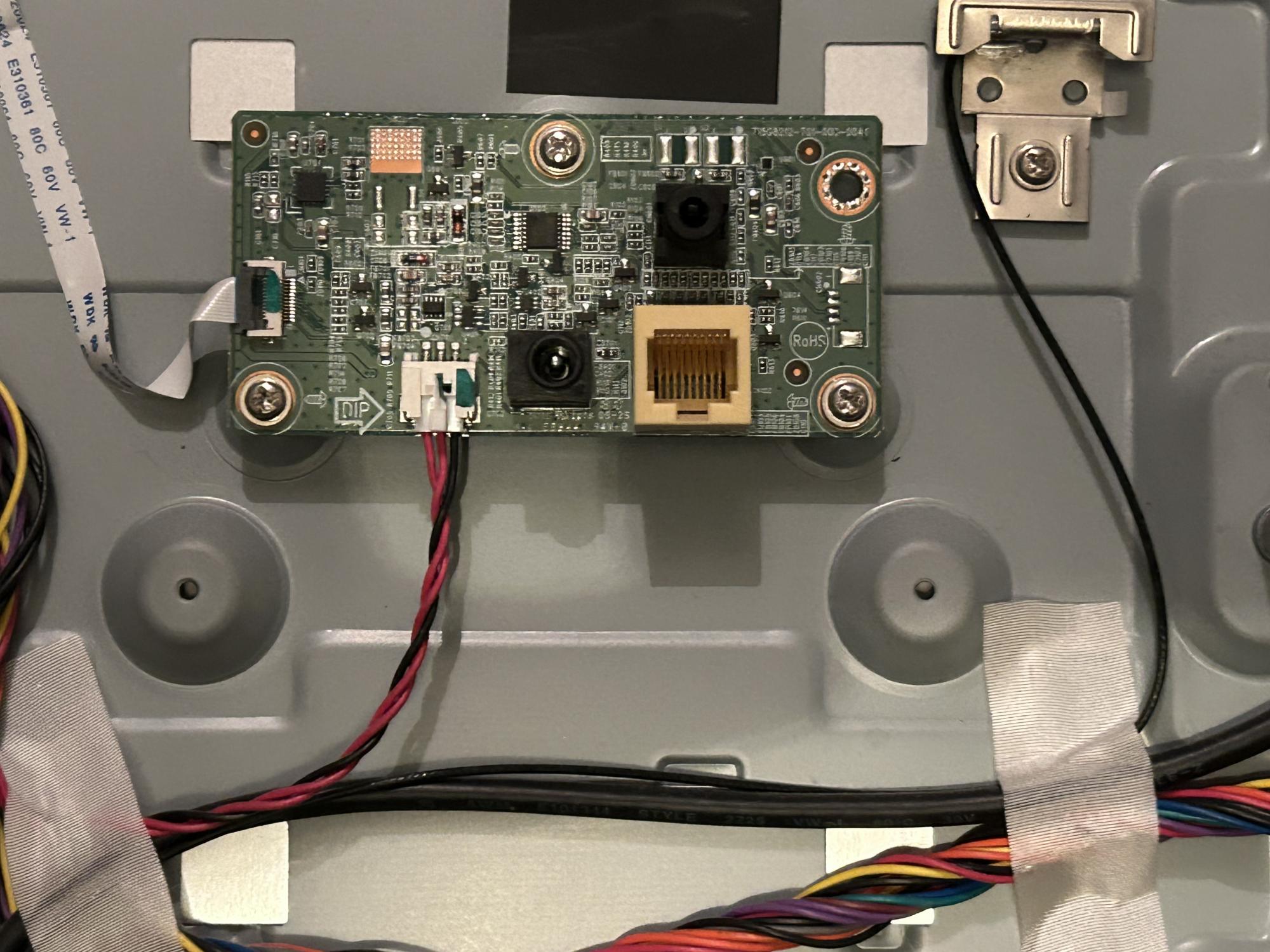

    Hi not sure if anyone in here can help but here goes.
    I purchased a job lot of these Philips to sets 40HFL5011T/12 all power on fine but was set to professional mode. I can turn that off no issue. But I wanted to know if it's possible to make these in to a normal fully working tv?
    Thanks in advance for any help.

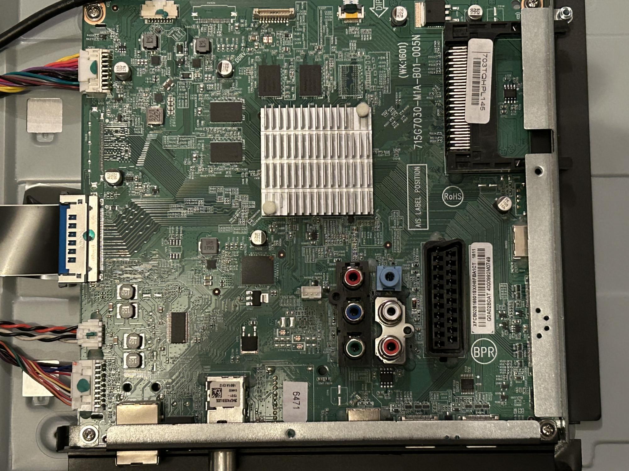

      well its nice challenge LOL... TV made for Hotels,, but the MB look like for me like first Generation from Vestel... however its under name TPM16.4H
      so please upload high resolution Photo of the Main Boards.... attached also the service manual.... under Factory Service menu ..... see ORT Mode.... try to turn it to OFF

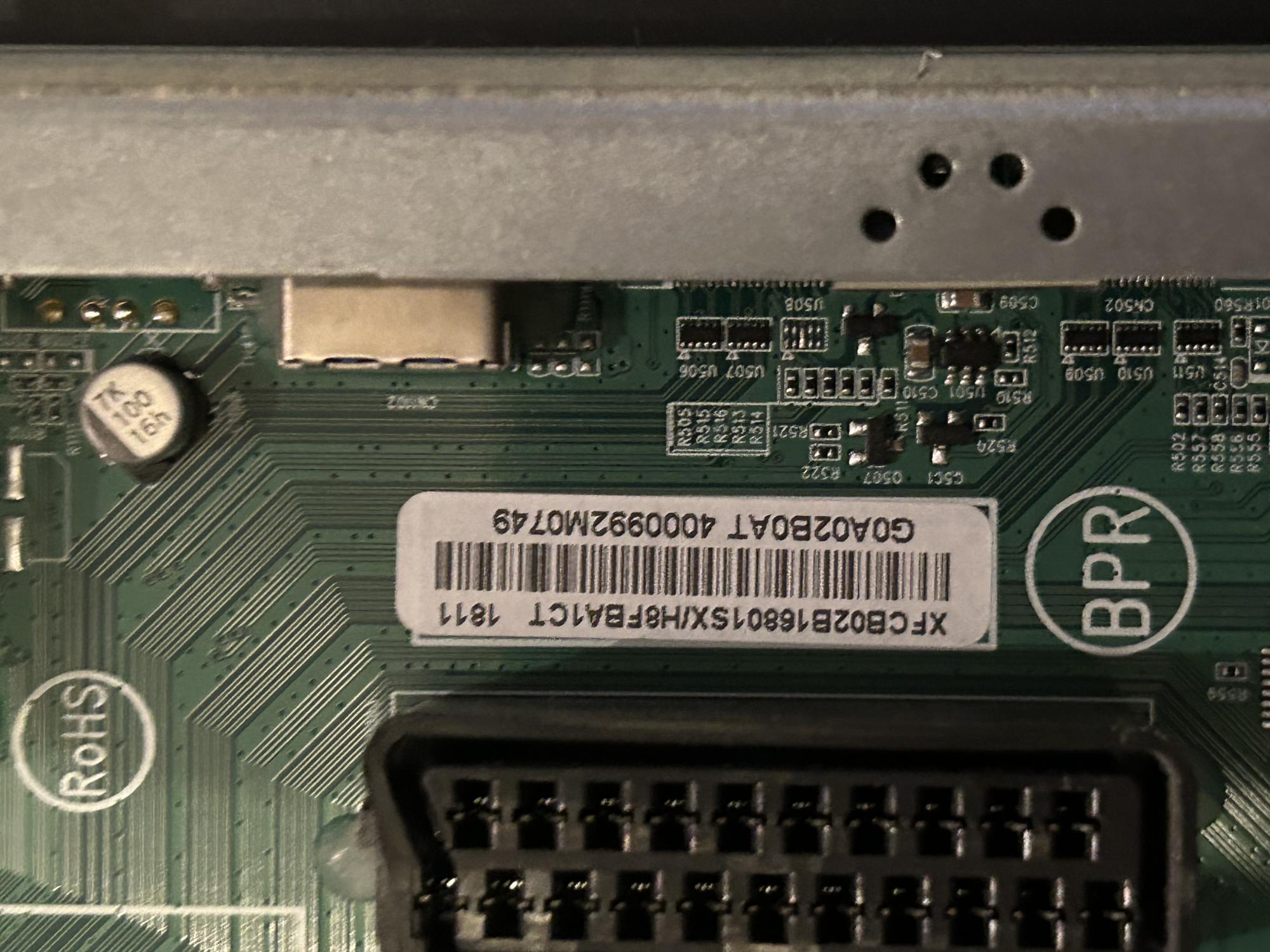

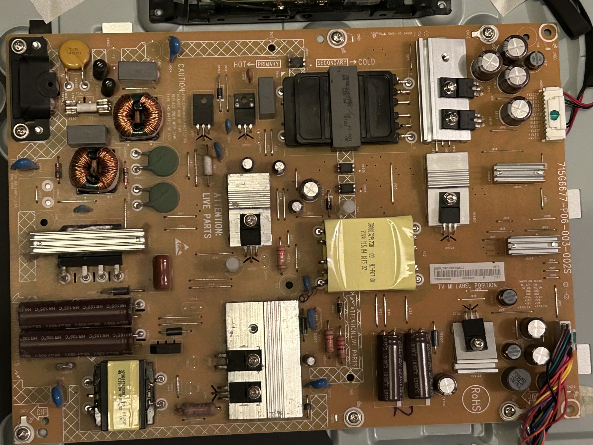

        Re: 40HFL5011T/12 Hotel mode
        Thanks for the reply I appreciate any help.
        I’ve attached pictures of the boards.
        Also under factory service mode I don’t see ORT mode

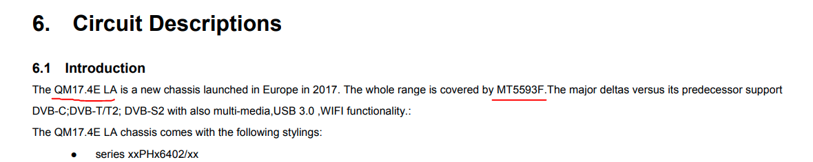

          This motherboard is used in the Philips 32PFS6402/12 chassis QM17.4E LA.
              y0u mean QM164E
                here upgrade_loader to the mentioned boards
                you need first to make NVM copy on USB with FAT... and PQ copy too.. before you play with firmware... so you go back.... read the service manual it listed how to make all copy of the TV

                  Originally posted by Diah
                  y0u mean QM164E
                  I don't know what the update number is, I didn't look, but the panel is only on “32”.
                    I don’t know what the update number is, I didn’t look, but the panel is only on “32”.
                    yours link to android.... not unix/ linux also different SOC too from MT
                        TPN171E had same SOC MT5593 Firmware upgrade_loader i could find... but if any can find the service manual of this chassis to check the Soc
                        upgrade_loader
                          They have the same SOC - MT5593F.
                            LOL.... but it used only for android .... the one above had as my research ssame SOC but unix/ linux
                                lotas in the service manual you linked it say SOC MT5539
                                    Tpn171e
                                    yes,, its SOC MT5593 so my post #12 firmware passed... but need the original PQ because of the size no 40
