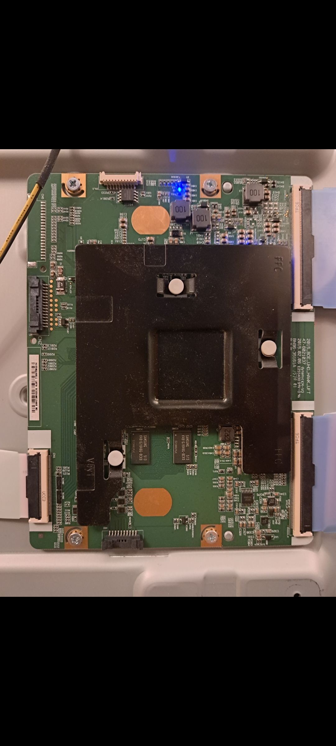

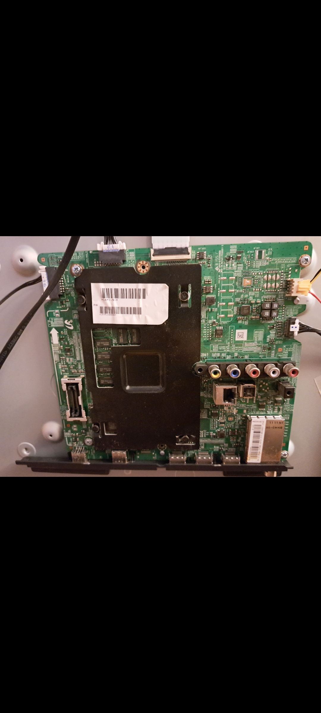

              Well, seems it wont start up now, just 5 red blinks.
              Shall look for a replacement main I think.

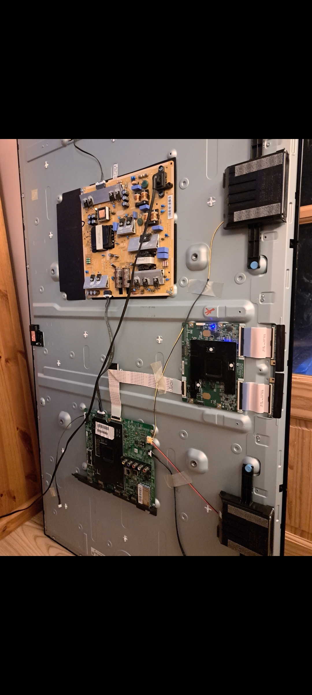

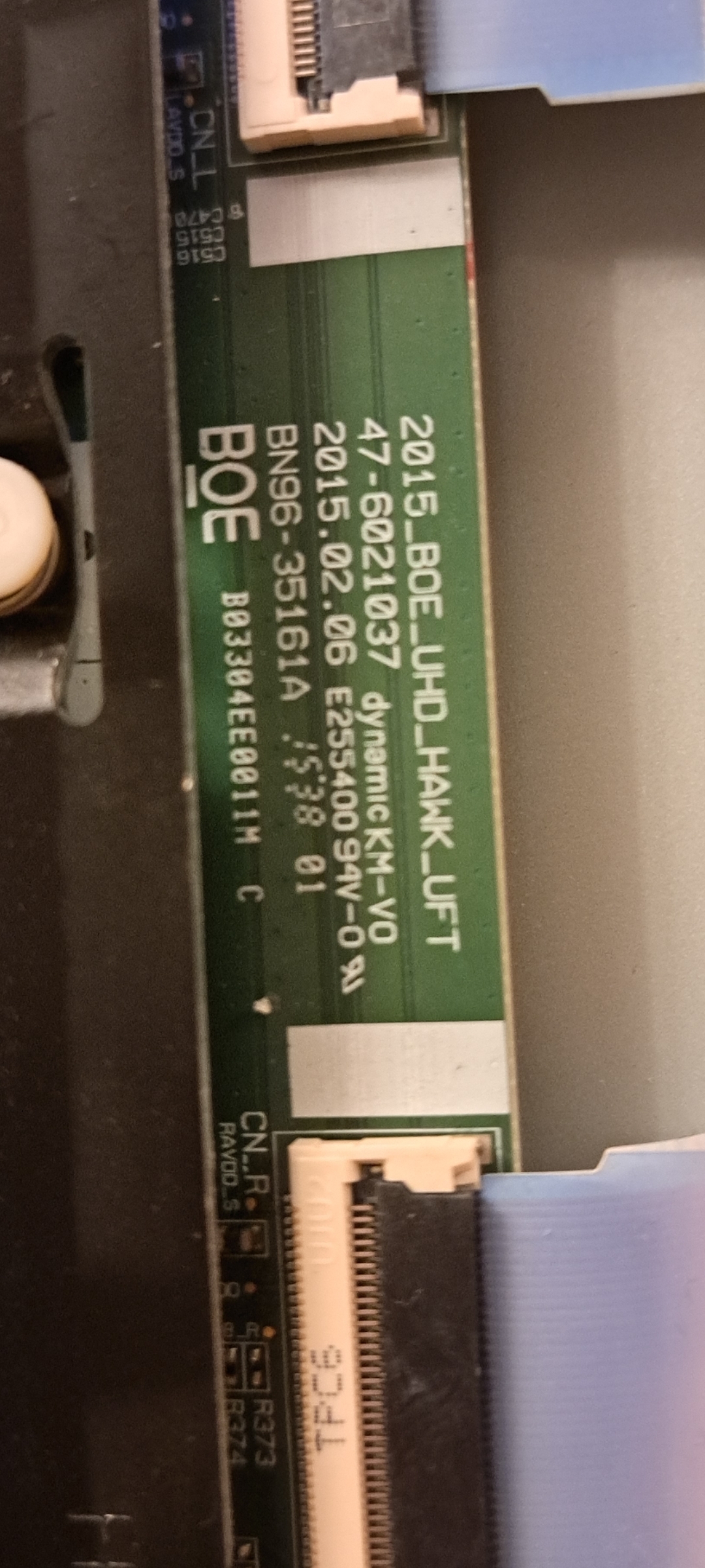

                Just as a note for anyone that comes across this later for help I have also disconnected the panel one side at a time, then both, then t-con from main but still 5 red flashes, no backlight, no image. Oh yh and only getting 1 static blue light on the t-con board, not sure but possibly
                should be 2. Actually there are 2 static blue leds on tcon, 1 is under the heat shield plate.
                Disconnect main from psu and get backlights come on.
                For reference the red standby light comes on from power being applied, then press remote on button. 5 red slow flashes then goes back to red standby then 5 red flashes, cycle continues.
                Just to be clear its not 6 red flashes.

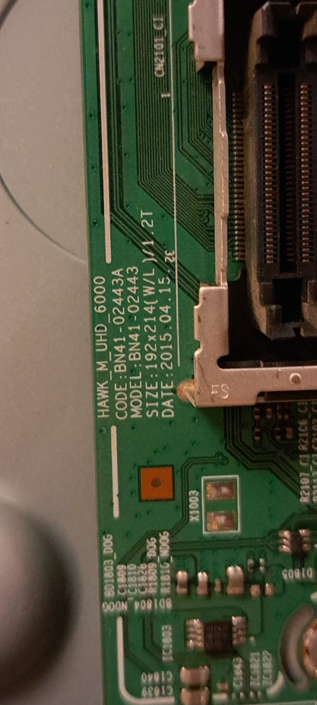

                    Anyone know if its necessary to pair the main and tcon?
                    Would I need to do anything else other than just replacing the main or is it plug n play?

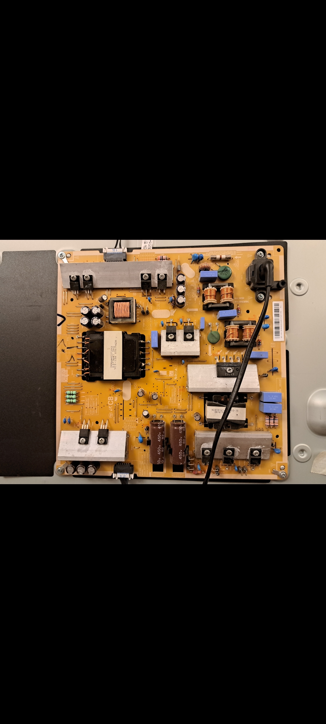

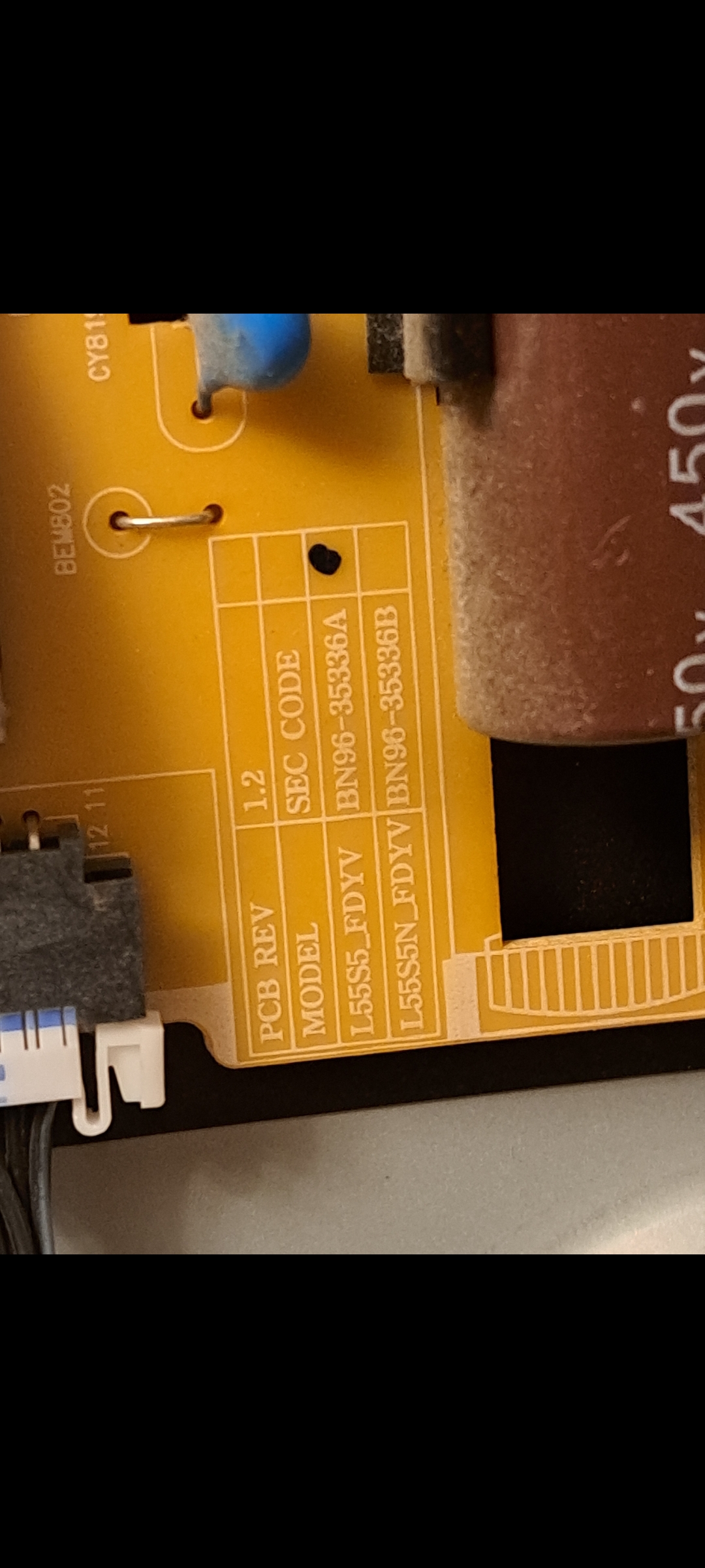

                      Re: Samsung UE55JU6000K stuck at 'Setup Conplete'
                      Photos
                        Just the main replaced and now working again though still waiting for backlights.
                        It has exactly the same boot sequence, 5 red flashes and both tcon blue static leds.
                        So looks very likely it was corrupt fw or faulty chip.
                        Comparing the voltages the only difference is blu_pwm 0.46v this is with backlight set at 12 whereas set to max 20 it reads 0.5v.
                        od-on/off is 0.3v lower but dont think this is of significance.
