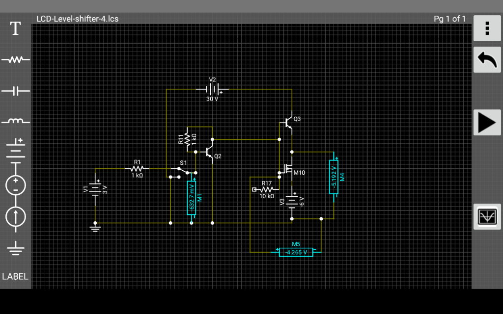

Hola... i suspect a faulty circuit on a tcon board, i'm almost newbie on schematic creation, i ' ve made many and many attempts with various Android tablet simul. software but all them fails, not sure if simulation is ok, i need a clock signal level translation from 0-3v to -6-+30v, with those last voltages taken from the board, thank you a lot.. this repair is still since years!
Level shifter circuit schematic project request for Samsung TV, please!
Re: Level shifter circuit schematic project request for Samsung TV, please!
As all the clocks, is 2 levels square wave, freq. about 15khz if i recall, the third question i can't answer, is the clock for gate cof of lcd panel.. bye.
PS: this weird thing is the s@#t i have done until now (hihi!)
I did some search for you.
I couldn't find an IC that does it all, your supply voltage is pretty high.
You need mosfet gate driver, low side.
I found these parts: UC1707/2707/3707 and MIC5020. IXYS may have some too.
Connect ground of IC to -6V and VCC to +30V.
Then you need level shifter for input, so that logic low is -6V.
I hope you can figure it out.
Make sure you don't exceed absolute max voltages for the pins of IC.Comment
Thanks for the effort but i need a schematic that i can test without buying parts or expensive parts without knowing the result, i hoped there were a simple discretes components schematic that i can build with my spare old boards picked components.. and if is possibile some schematic that i can pass to the simulators, it would be the best and also useful for future use of the sim.. bye..
PS: if i will be enough free of time in these august holidays maybe i will be lucky to find a schematic on the web or by tries on the simulator.. for a matter of pure ass...Comment
