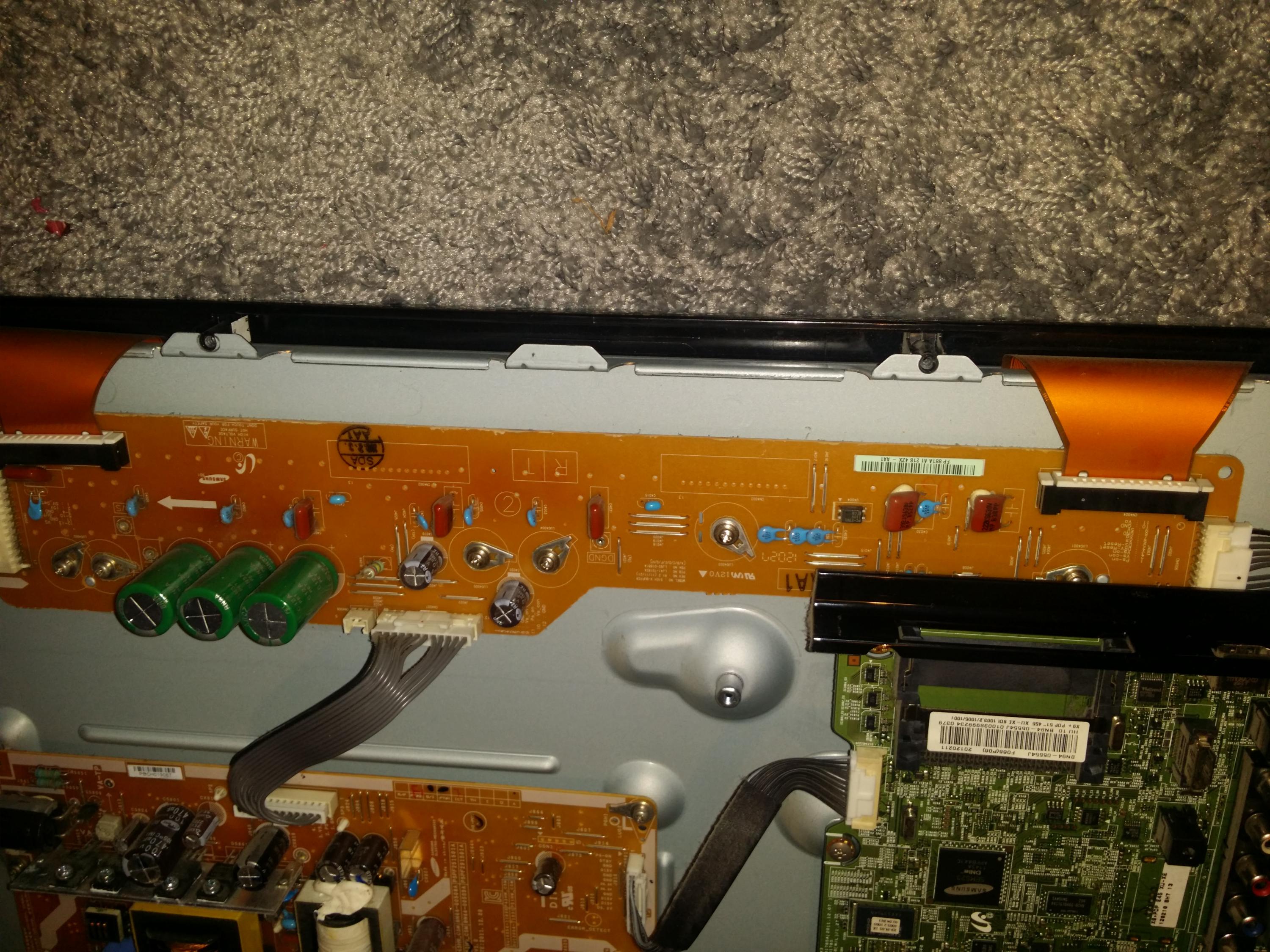

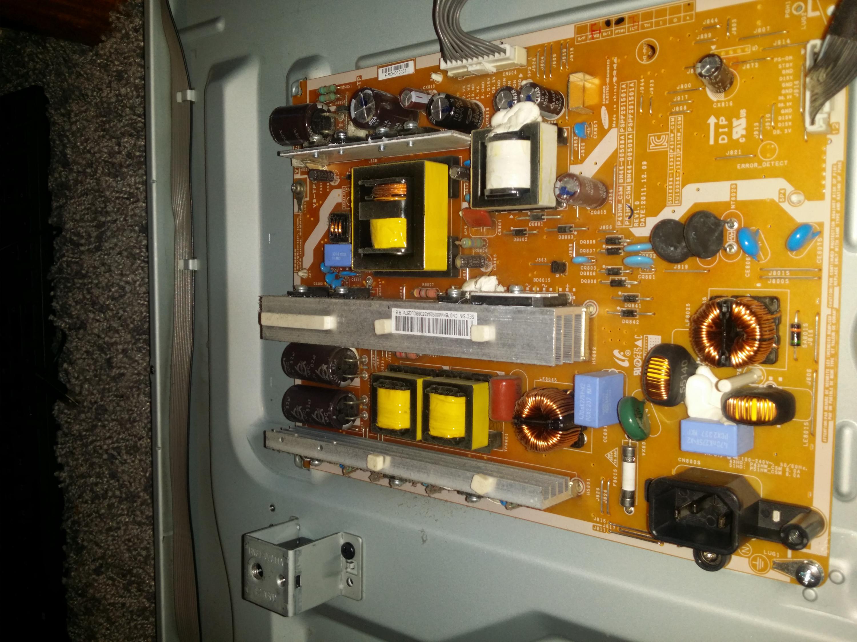

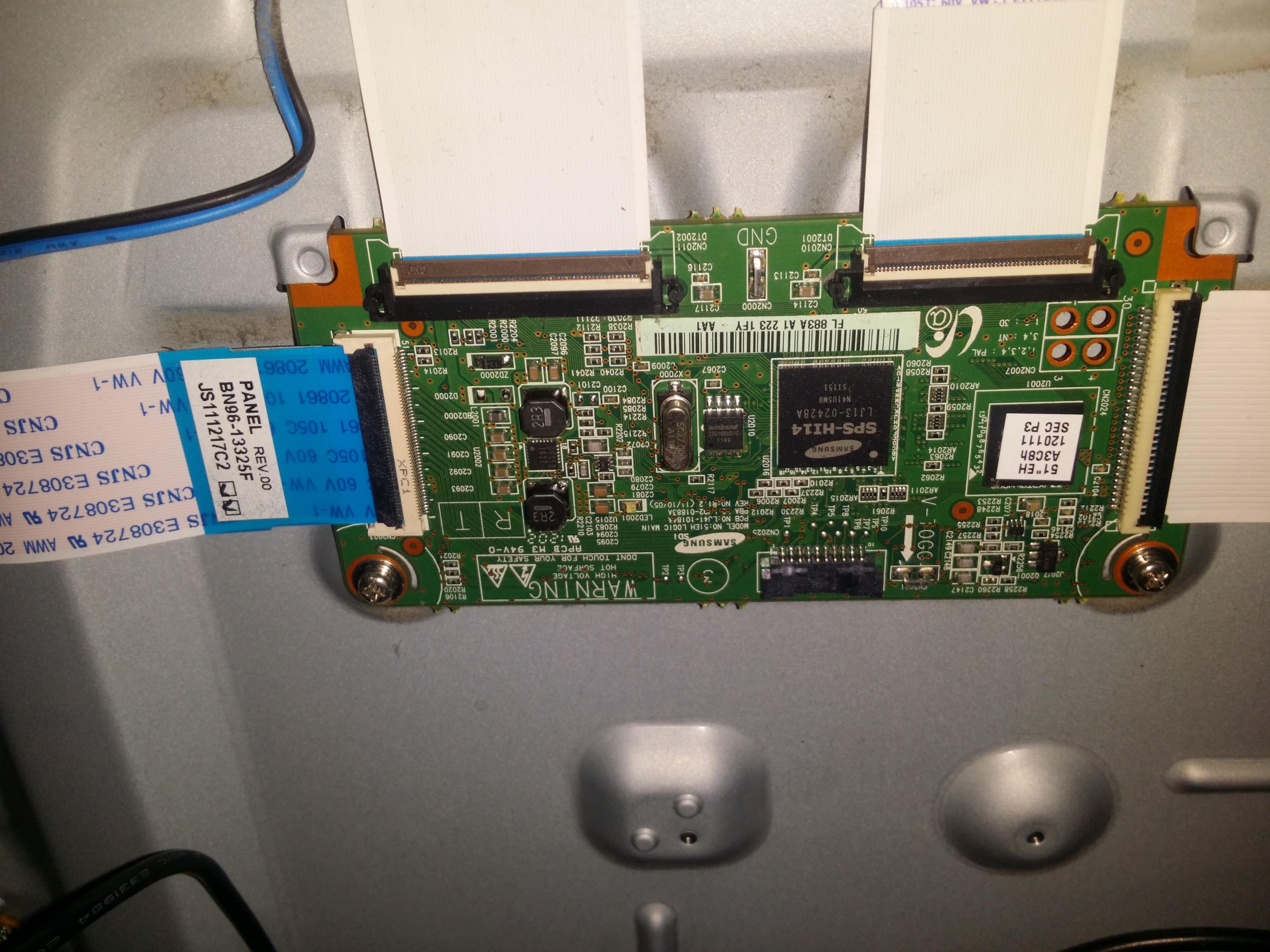

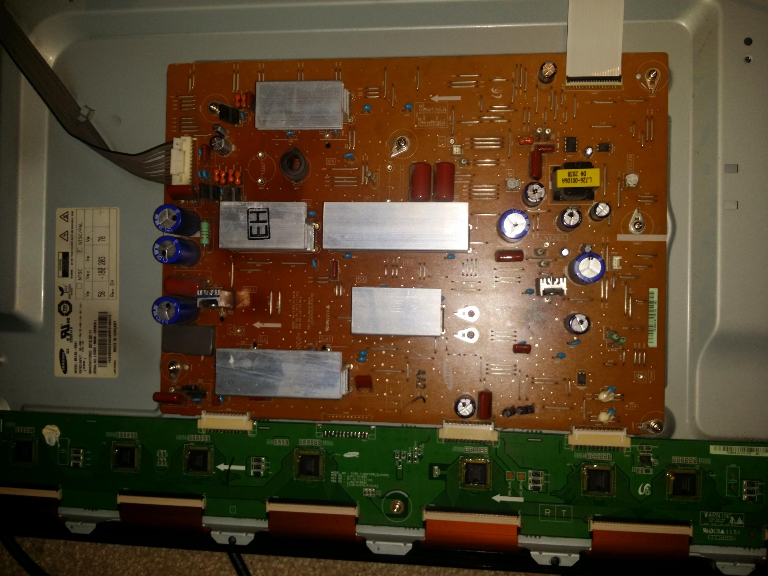

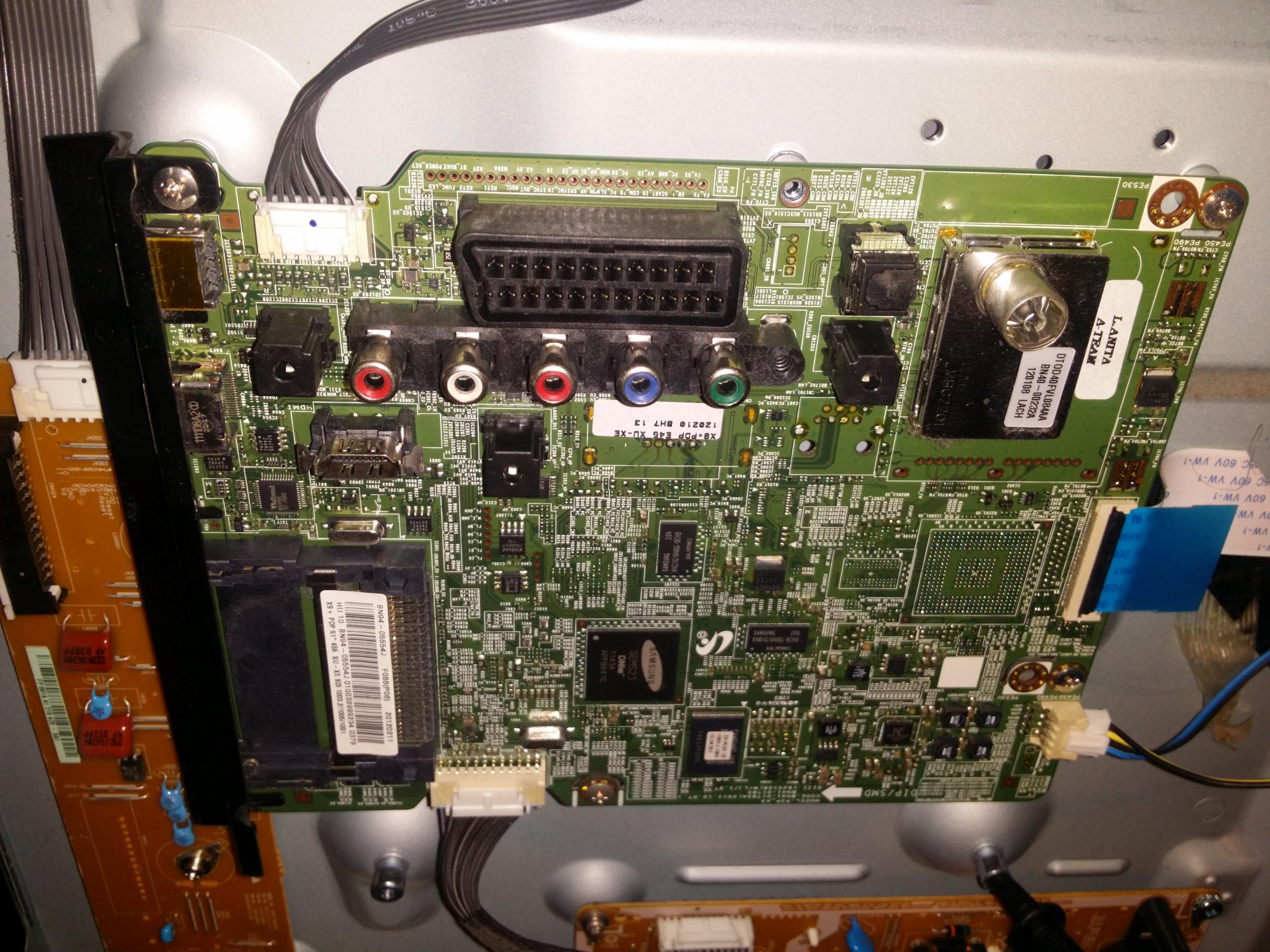

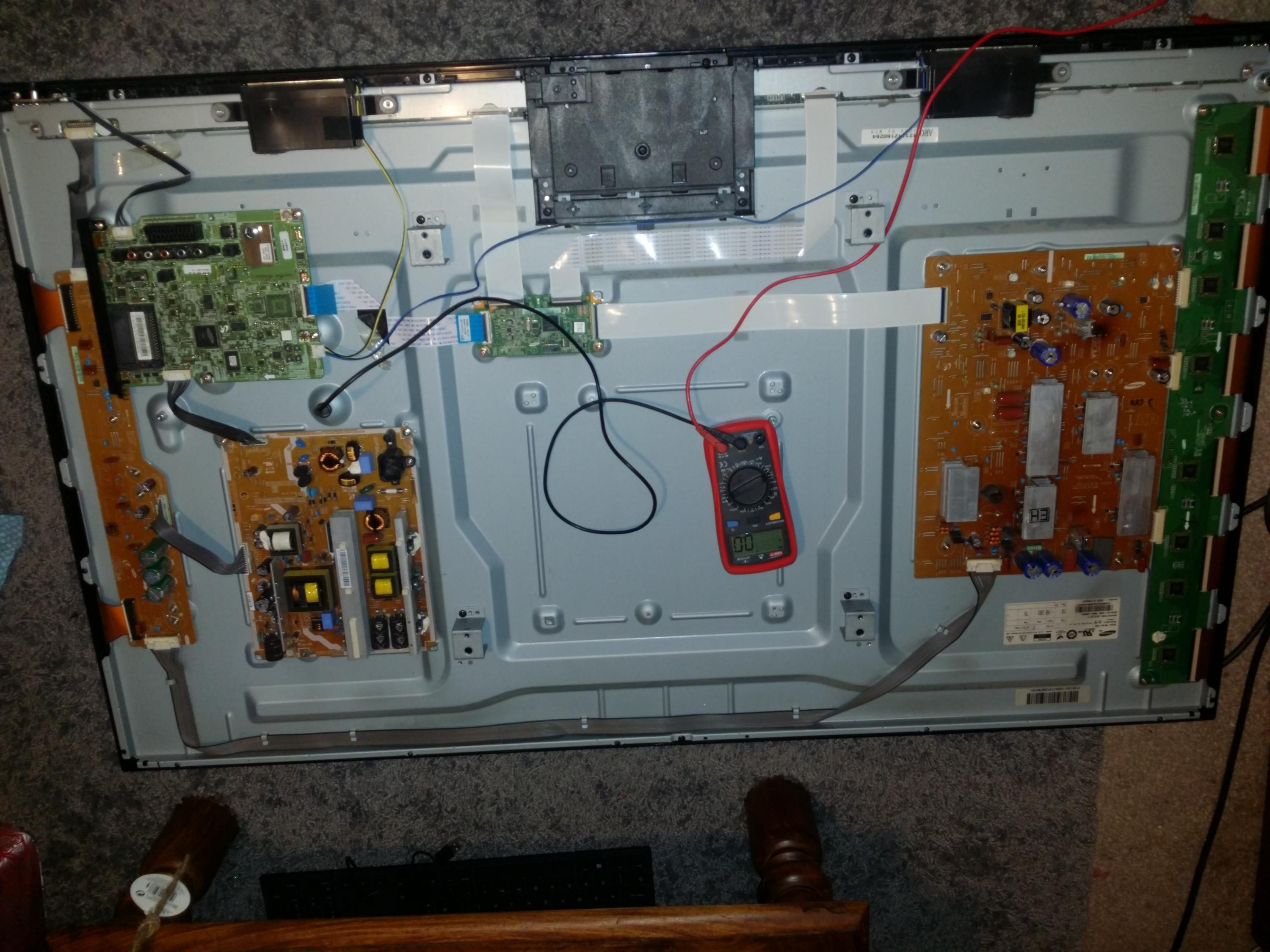

    Hi all.
    It's a great place you've got here. I've learnt a lot in the last couple of days researching my problem and diagnosing this tv. It's a Samsung PS51E450A1W with no picture. Here are the symptoms and what I've tried. Any help is hugely appreciated.
    symptoms:
    No picture
    No chime on start. (maybe turned off?)
    Powers on, small flash of screen, 5 slow red leds on the front, at the same time: 1 slow and 14 long on the green led on the logic board. Then reboots and does the same.
    The sticker with the voltages are:
    VA 58
    VSC -180
    VS 203
    VE 78
    Voltages for the SMPS measured are
    VS 203.6
    VS 203.6
    NC 0
    VA 58.3
    GND
    D15v 14.3
    D5.3v 5.2
    GND
    Vs-on 3.2
    Vs-con 1.5
    Ps-on on start jumps 3.4 pulled low to 0.1 (normal I think?)
    GND
    On the SMPS the VS-TP = 203.6 and the VS-TP = 58.5
    On the X-Buffer VS = 203.6
    On the XY MAIN the VS = 203.6, The VE =78 and the VSCAN = -180
    Disconnecting the logic board from the main board and shorting 1 & 2 on the logic board on reboot shows the white backlight but the reboot happens again after the leds.
    Shorting 3 and 4 (should bring up test pattern I think?) it shows white then red but restarts as per led operation again.
    thanks for any and all in this.
