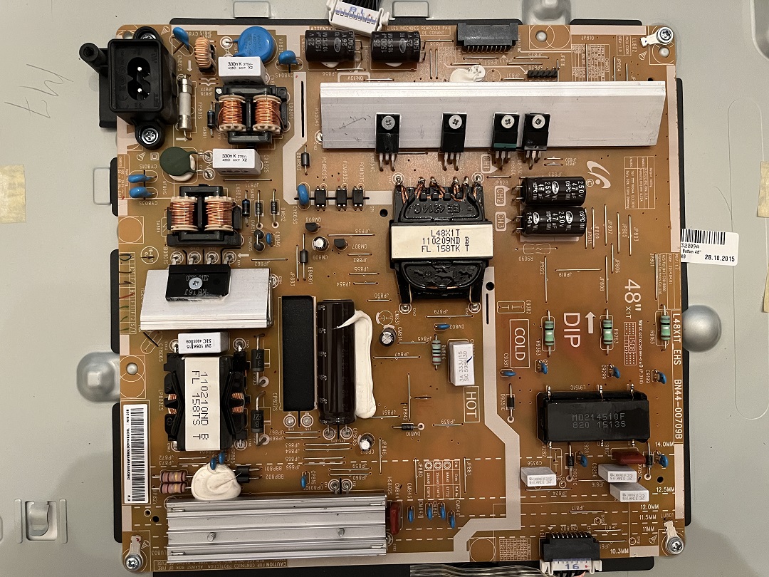

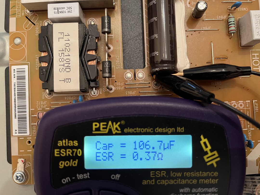

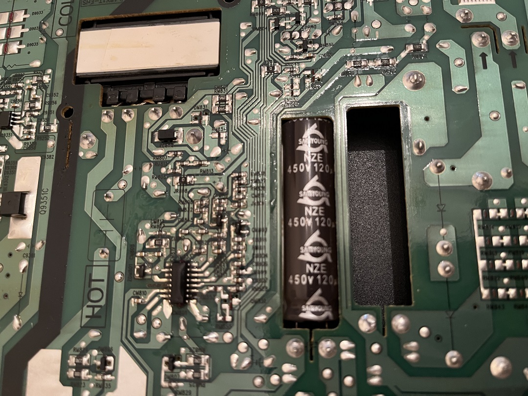

    I have a Samsung 48H6400 that experienced a T-con failure, which I fixed by replacing the board. The TV is now working; however, upon further investigation of the power supply board (BN44-00709B) I found this capacitor on the "HOT" side (shown in the picture) with a rating of 120uF / 450V that troubles me. When I measured it with my Atlas meter, which I bought recently, it showed a capacitance of 106.7uF and an ESR of 0.37ohms. Isn't the ESR high and the capacitance a bit low for a rectifier capacitor? Unfortunately, Samyoung's datasheet from the official site does not mention the ESR of the capacitor (https://cdn.badcaps-static.com/pdfs/...11323e6efa.pdf). What is your opinion? Should I leave it as it is or replace it with a new one?
    Thanks.

    I don't know about ESR but capacity is ok.
    Datasheet says +-20% so 96-144 would be ok.
