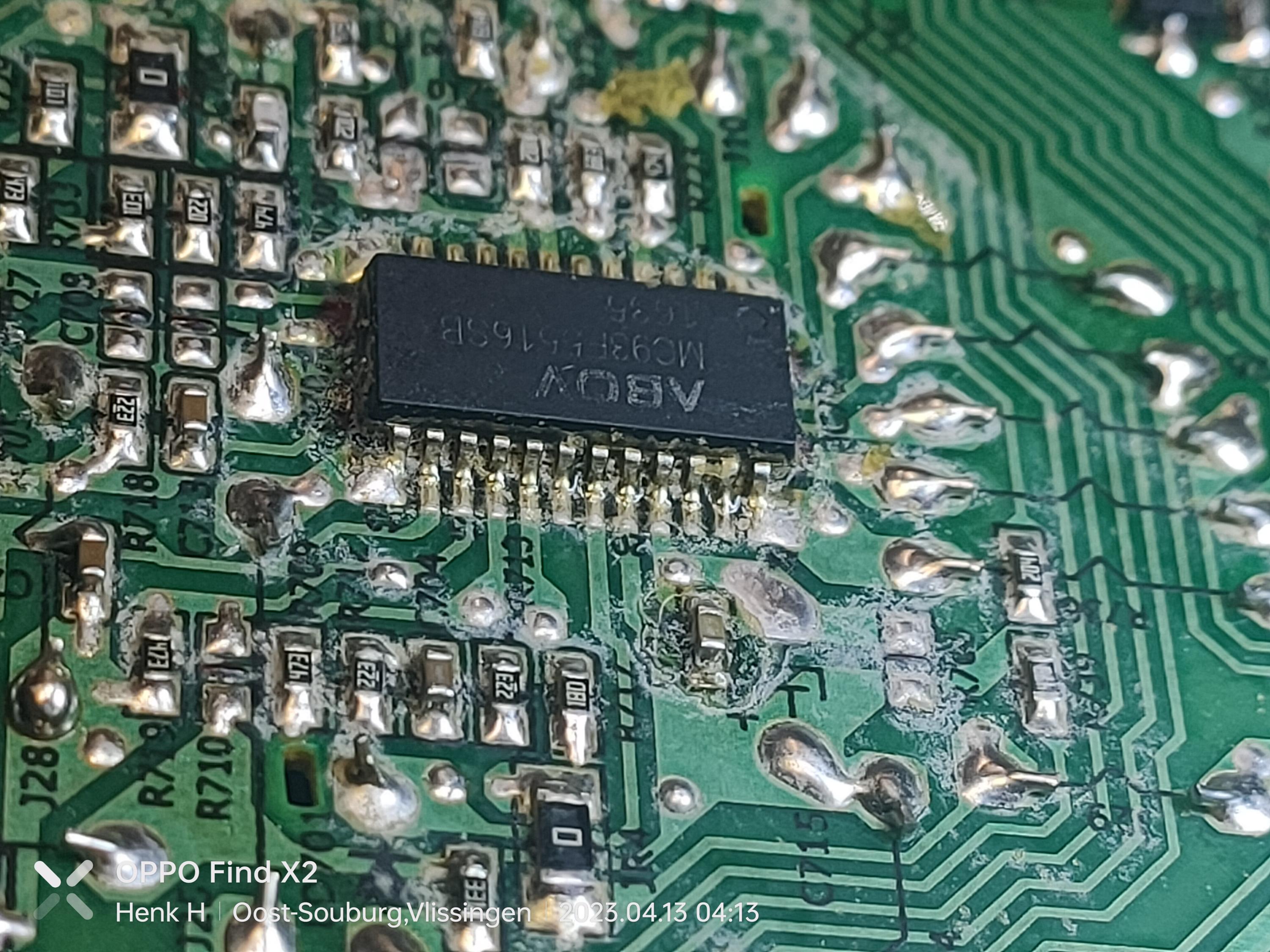

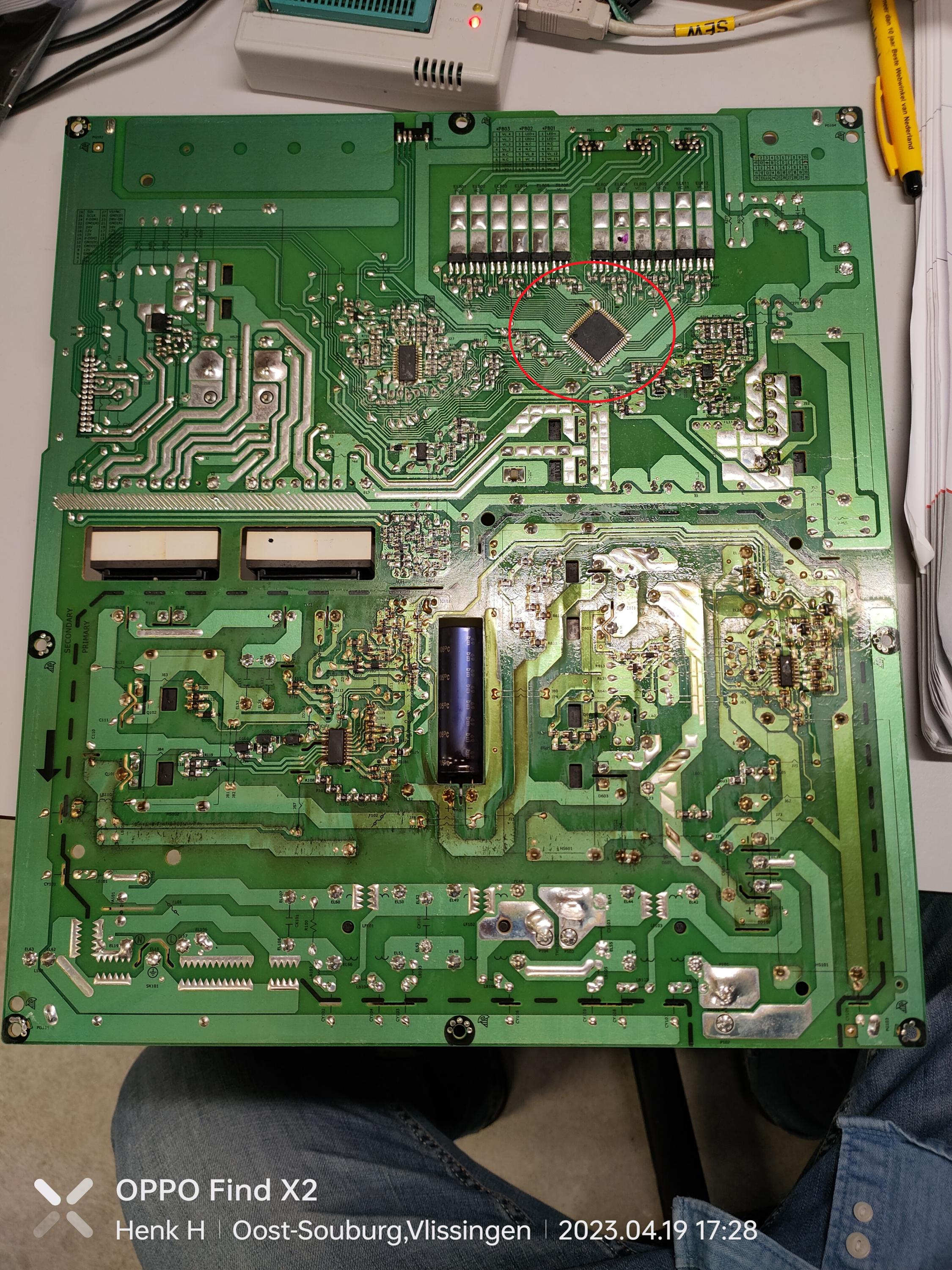

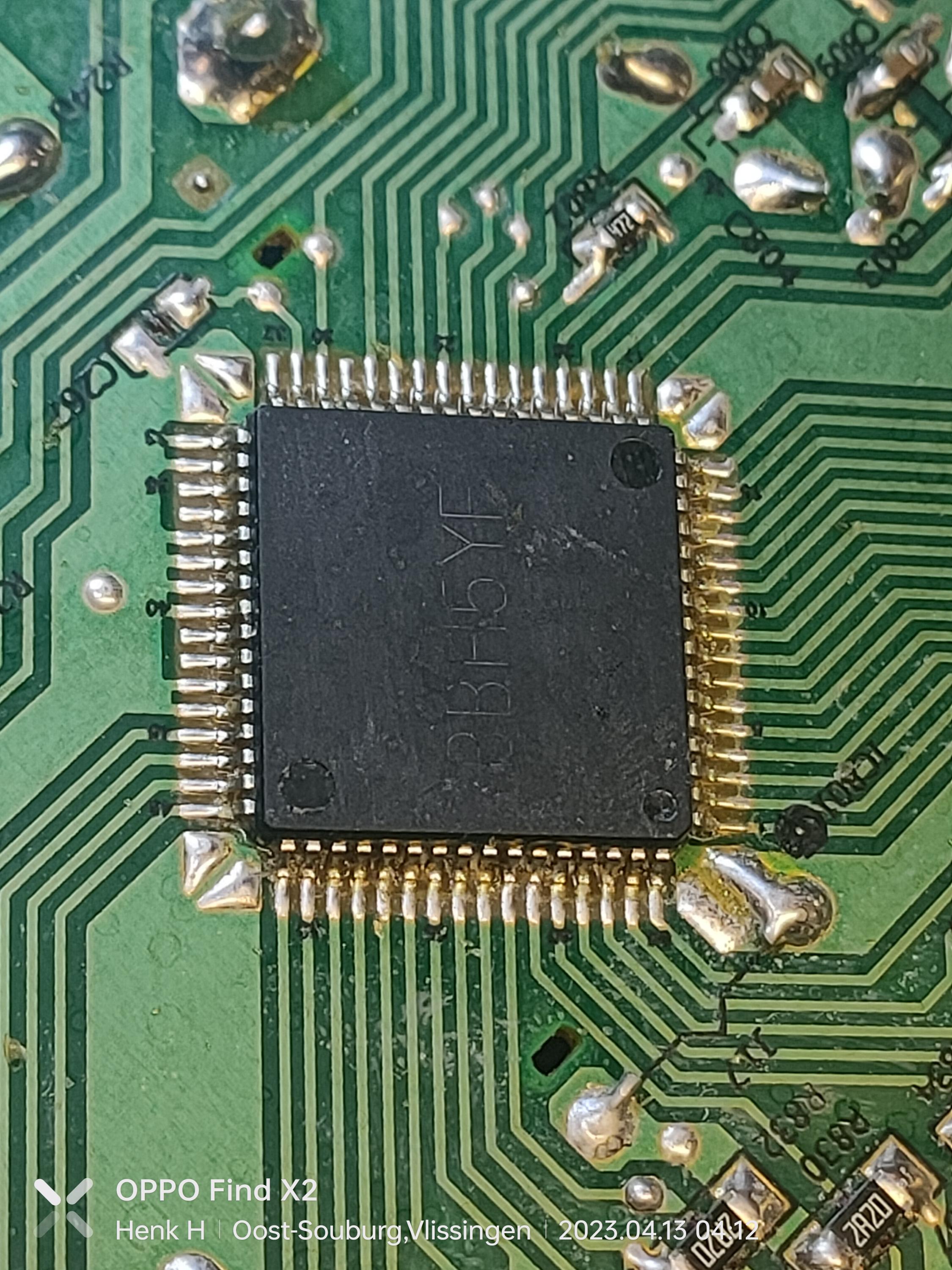

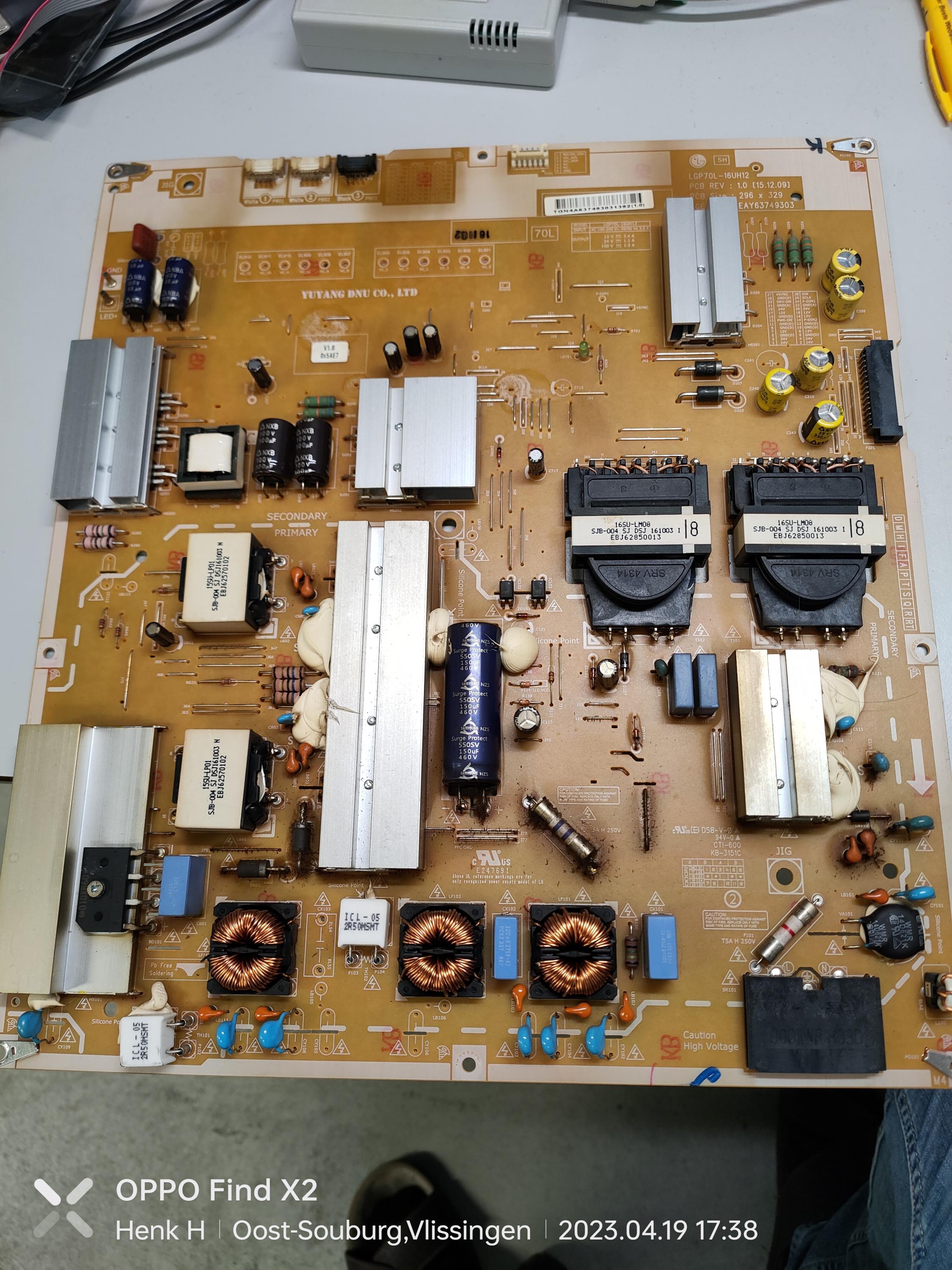

        The backlight of the tv is only lit for a few seconds. de backlights are oke, tested with a backlight tester. al led-strings has the same voltages and stays on when i use the tester. No voltage dips on de led-strings, also tested it with a fluke recorder for hours. I want to measure some signals on the driver chip. Its a BBH5YF. I can't find any datasheets for this driver. There is an MCU (MC93F55168B) that controls and operates the led driver. All voltages of the power board are present.

          1- first you need to clean yours PSU from top the dust. and from downside the moisture on it with alcohol 99%
          2- BL turn on at start up only to show LG logo then turn off and TV remain on with sound and can see the picture with tourch light its 99.9% LED BL fault.
          LG INVOTEK LEDs used at BL each LED unit contained build in zener Diode at the reserve way to A G for limited currents and protection. LED Tester cant handle this and know if this zener open or shorted however the LED lit on.
          this mean only LED with DMM one by one in Diode mode to test the lit on and the reserve zener. in yours case the edge LED even if one turn off you will not notice the light of it on screen.
