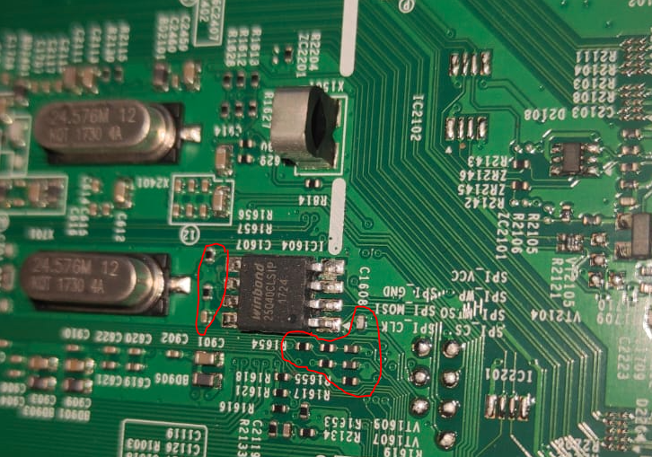

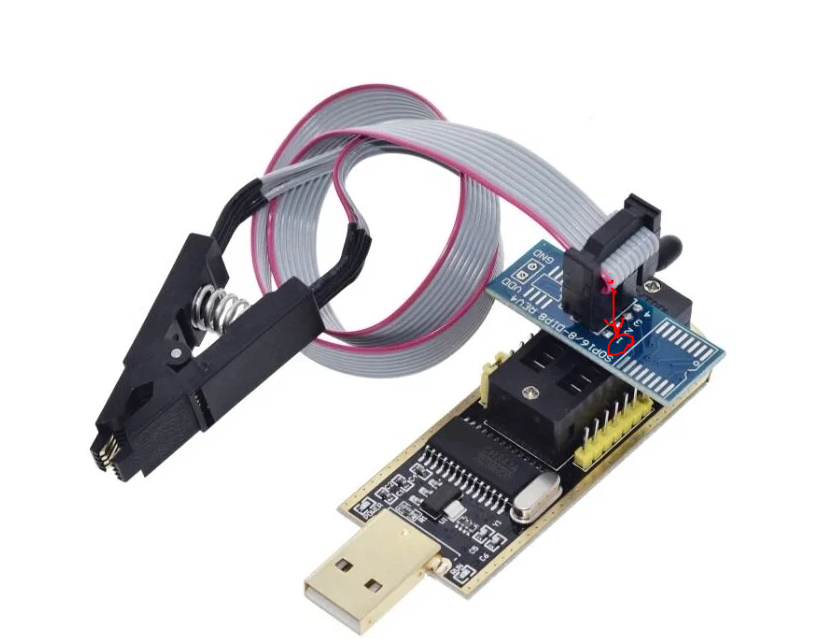

    Hi there,
    i have a problem with the tv in the description. The stand-by led is always off. I controlled the power board and it is ok. A friend of mine told me to try flashing the motherboard bios with a ch341a programmer, but i've some questions.
    I have read some guides and i assembled the usb programmer like this (i think it is correct):
    https://ibb.co/7NcMD5P
    https://ibb.co/KzBwBwn
    Bios chipset:
    https://ibb.co/6Z6LgQZ
    I installed the drivers and the ch341a appears on the devices and i downloaded some vers of programmer software, but when i connect the "pincers" to the bios in the programmer software the "detect" button turn gray and it's no more clickable. The red cable of the pincers is on the chip connector with the "little hole" so it shouldd be correct.
    I'm doing something wrong, but i don't know what.
    More photos of the tv mainboard and lcd pannel:
    https://ibb.co/RTN64Jm
    https://ibb.co/TP1YwP2
    https://ibb.co/3WCpTXb
    Thx for the help

    Never use this "clothespin", carefully unsolder this flash (without damaging nearby components) and read its contents (dump) and post it here.

        Re: Dead Samsung ue55mu6120kxzt
        I didn't understand your question, I wrote about the components near the flash (resistors, capacitors), when you solder, so as not to damage them.

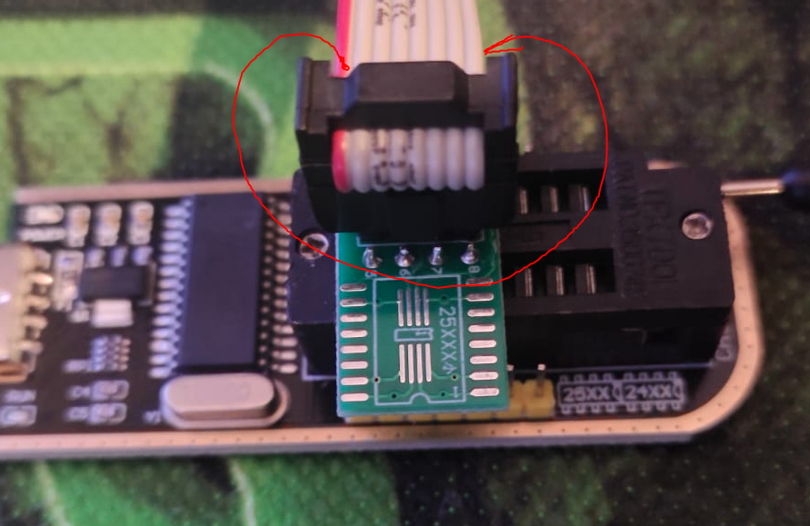

          sorry, i meant the ch341a connections. This ones:
          https://ibb.co/b15rjtG
          https://ibb.co/zxV5nkQ
          https://ibb.co/4TGFQK0
          • lotas
            • Jan 2016
            • 4850
            • Russia
            Not right! You have 1 red wire should be on the other side.

              Ok, so i use ch-341 programmer v 1.43 (chip w25q40cl). The detect function works fine, but i have this result:

                Yes, your dump is not working, try the corrected one, do not forget to set and write the status register (0x88, 0x42) after writing the dump.

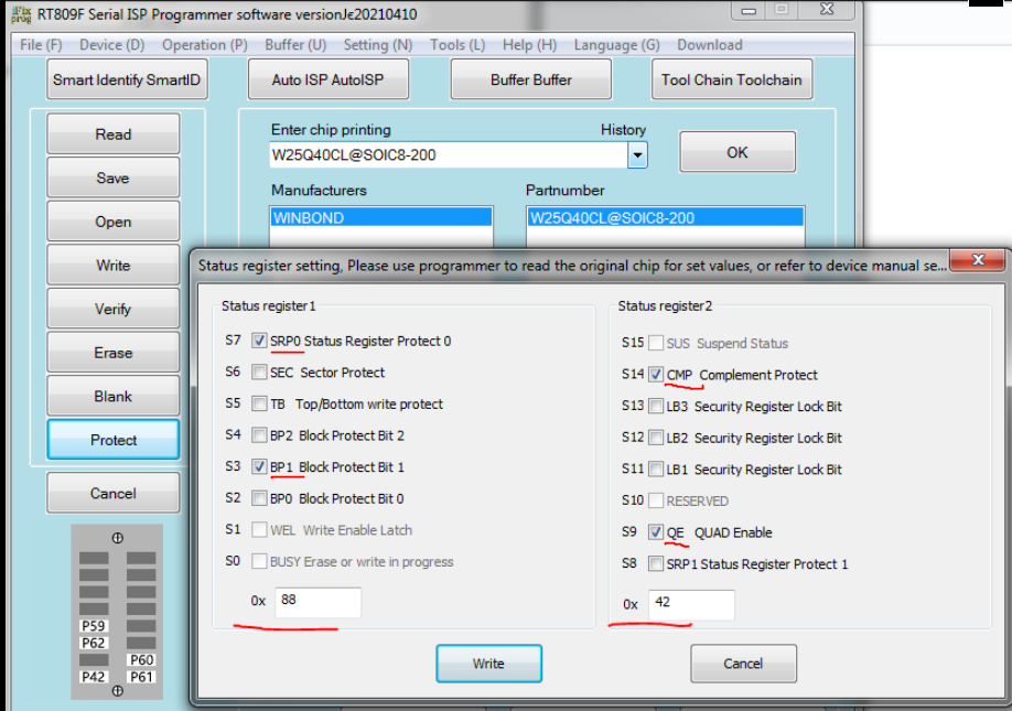

                    ok, i found an old post made by you:
                    https://www.badcaps.net/forum/showpo...9&postcount=74
                    and i saw you used 2 more programs to set and write the status register. I have to use that or i can set and write via ch341 programmer?
                    thx a lot
                    • lotas
                      • Jan 2016
                      • 4850
                      • Russia

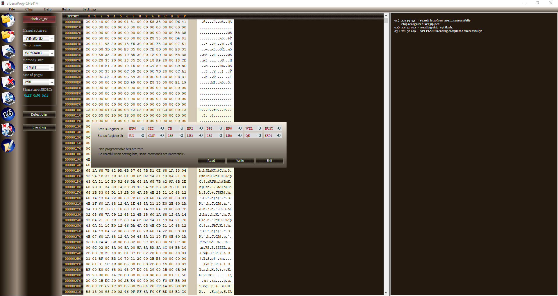

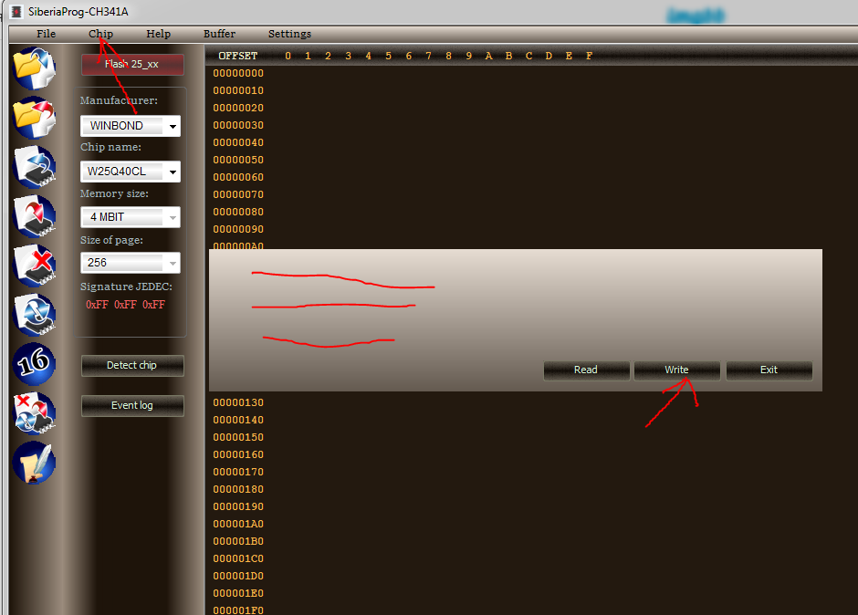

                      After writing the dump, click on "Chip" and at the very bottom select "Status Register" and check the boxes to receive (0x88, 0x42, 0x00) and click write. And that's it. ready.
                      • mennyx
                        • Apr 2023
                        • 12
                        • italy

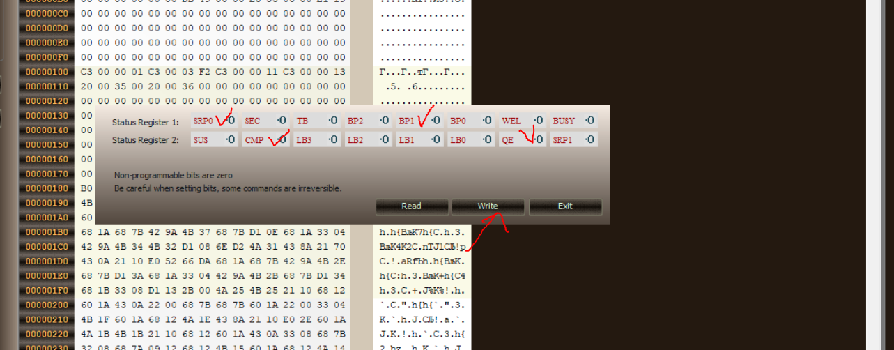

                        this is what i see, but i don't understand the boxes to check. Is it correct? Or i have to click on write without any modifications?
                        thx
                        • lotas
                          • Jan 2016
                          • 4850
                          • Russia
                          That's how it should be.

                            ok, done. I try to put it back in the tv and i see!
                            Thx for the helps! You made my day!

                                IT WORKS! Lotas thx a lot for the patience and the accurate tips you gave to me!
                                Thanks, thanks, thanks!

                                  you finally read / written using the clip?
                                  • mennyx
                                    • Apr 2023
                                    • 12
                                    • italy
                                    yeah i use the clip without desoldering anything
                                    • mennyx
                                      • Apr 2023
                                      • 12
                                      • italy
                                      the initial problem was the wrong connection between the clip and the usb programmer
