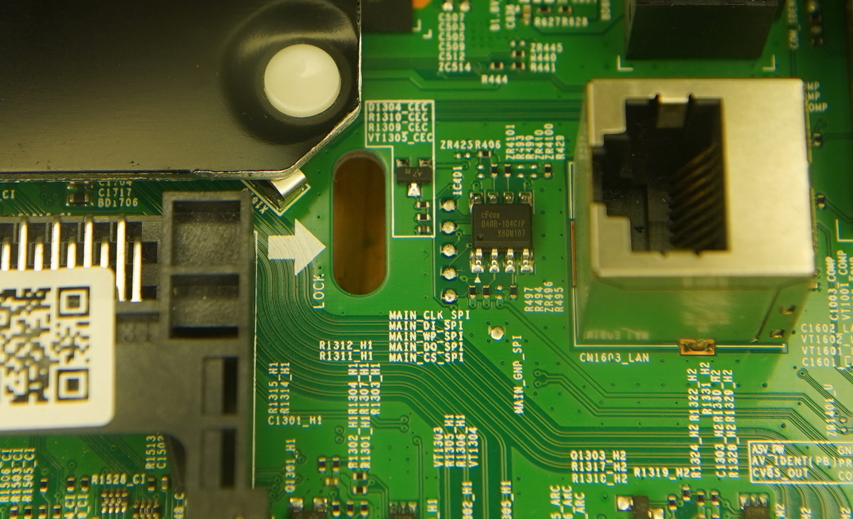

            Thank you lotas- This worked for me, too. A decent TV set has been saved from landfill. The picture that Rekap69 posted was exactly the same as my TV. I de-soldered the IC from the motherboard using lead solder & hot air at 286 degs C for one minute. I used a CH431A EPROM programmer to read and re-program the chip with the Neoprogrammer software. I installed the CH431A driver to make it run with Neoprogrammer. I didn't do the mod to the CH431A to limit the data lines to 3.2V. Some YouTube videos say it is required, but others do not. The first image file "UE32T5300AU dump 25q40.rar" gave me an error "buffer size not equal to ic size", so I used the second image file "EN25Q40.zip" instead. This was good. I checked the downloaded file against the image file using GuiffyBD which showed 27 random errors before reprogramming the chip. After reprogramming I checked the EPROM against "EN25Q40.zip"; zero errors. The same EPROM works fine, I didn't even need to buy a new one. Woo-hoo.

                  Please advise the ratings of the resistors connected to pins 1,2,3,6,7 of the EN25Q40 microcircuit board.

                          I'm late to this particular party but a very big thank you. Your zip file rescued my granddaughters Tv. It woke up when a replacement EN25Q40 with your zip file was fitted.
