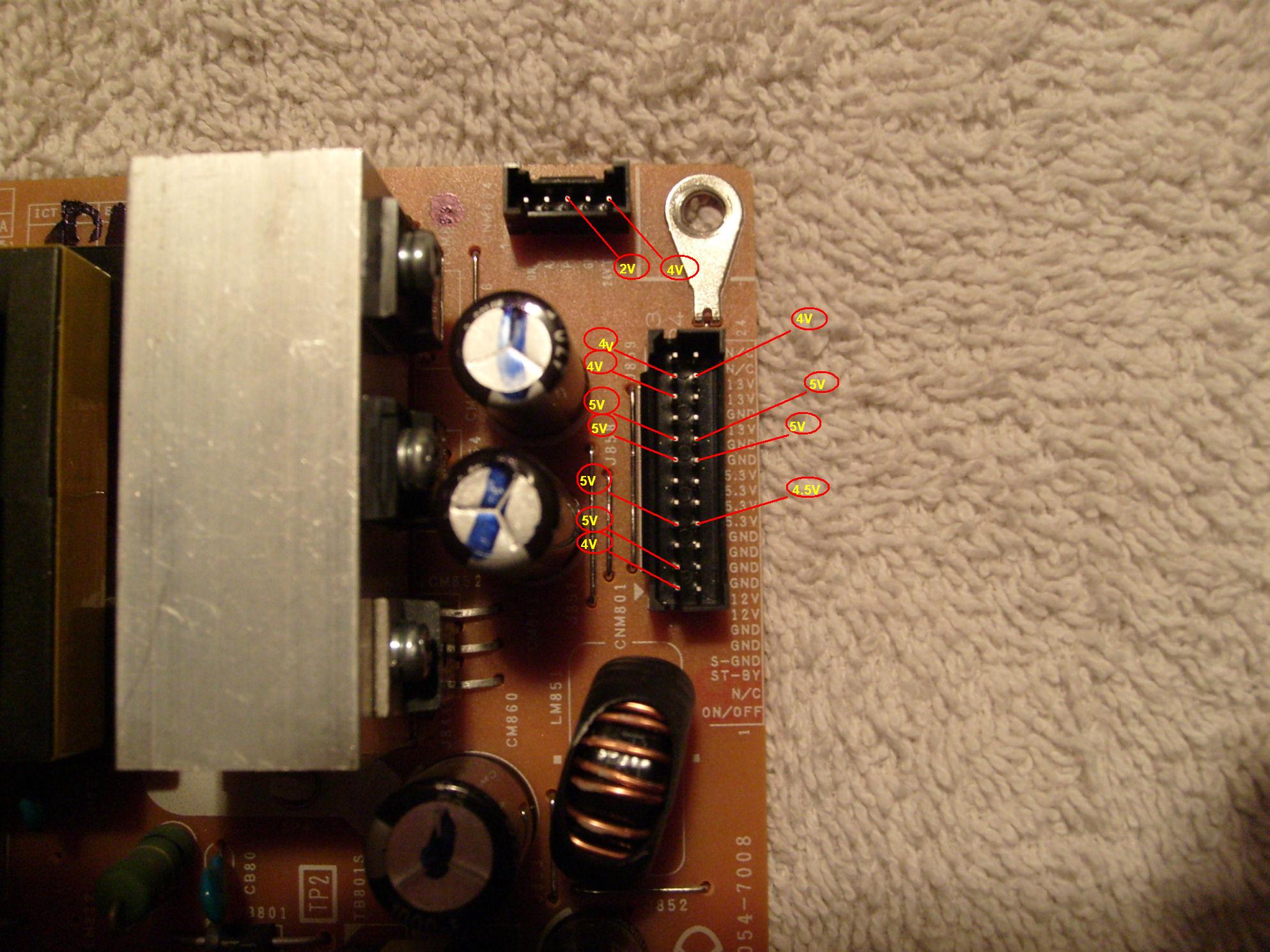

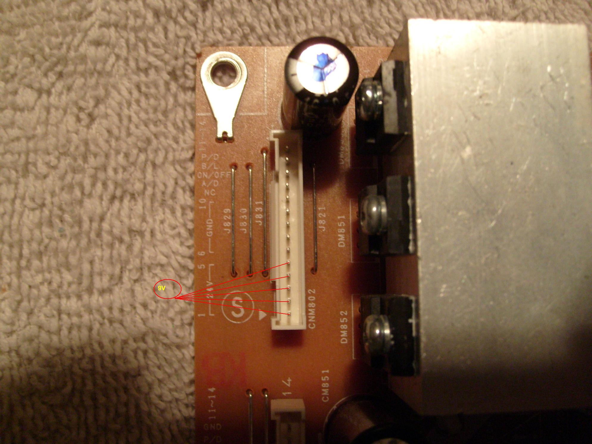

    5) Measured voltages on most of the PS input/output pins (see attached pics).
    The 5V are close enough I suppose, it's the 12V, 13V, and 24V that have me scratching my head as they are way too low.

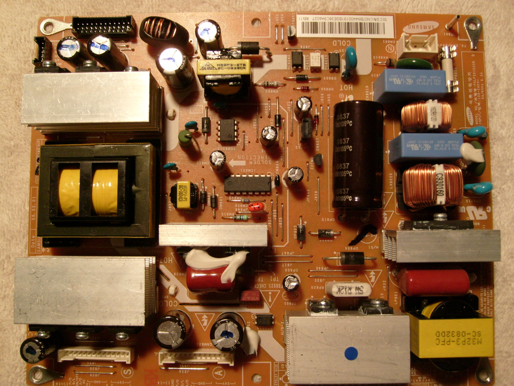

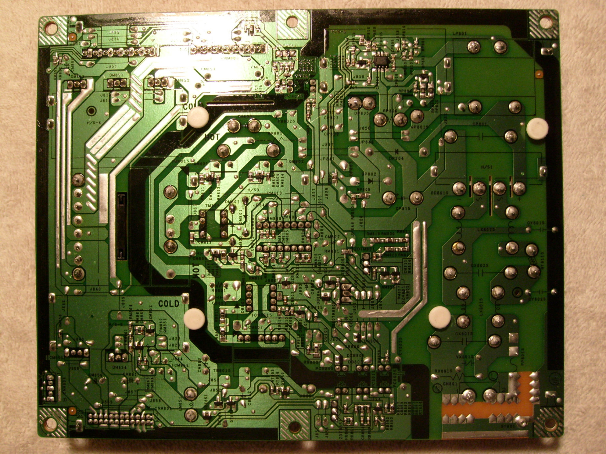

                        See pics #3 & #4 that were initially posted.

                            Dig through my previous posts and you will find my dissertation on the operation of a SMPS. In a nutshell, there are a very few reasons a SMPS will not have the proper output voltages. Excessive load on one output, bad input cap, defective regulation components, bad SMPS controller.
                            One common feature of TV power supplies is a dual supply. There is a 5 volt standby supply that is always on. There is the main supply that is switched on only when the TV is on.
                            Another common feature is a PFC front end that is enabled only when the the main supply is on.
                            I took a look at this several times, and while you have pretty good pictures, I had a hard time figuring out where the 5 Volts comes from. Sure enough, it's the small transformer at the top of the first picture.
                            How about checking the input voltage to the main SMPS, and identifying the part number of the main SMPS controller?

                                  It's late, I'm tired. On the picture of the top side of the board there are two ICs. The 8 pin one (ICB801S??) is almost certainly the controller for the standby supply. The 16 pin one (ICM801) seems to be the controller for the main SMPS.
                                  On teh picture of the bottom side of the board there is an 8 pin IC in the upper right corner. I believe that is the PFC . I would like the numbers of those ICs, please.

                                        Re: Samsung LN32A300JID Whacked Voltages
                                        Thanks for the boost PlainBill....
                                        This is what I have found so far, the 16-pin is a MC330167P found at http://pdf1.alldatasheet.com/datashe.../MC33067P.html
                                        The V at Vcc is 15v with Vref showing 5V.
                                        The 8-pin is a Q0165R which I believe is found at http://77.221.132.234/datasheet/FSQ0165R.pdf
                                        There is not a FS is front of the number on the chip but this is all I could find that made any sense. The V at Vcc is 16.3V, Vfb = 800mv, Vsync = 1.7V, Vstr = 160V, and the drains are showing 163V.
                                        On the back is a FAN7530 found at http://www.fairchildsemi.com/ds/FA/FAN7530.pdf
                                        I'm scratching my head where to go on this one.
                                        All readings were taken with the ground clip at the neg. leg of the big cap.
                                        Also the correct readings for the transformer at the lower right corner is 162V at the 2 top right corner pins, 0V at the pin by designator LP801 and 0V on the 2 lower pins at the bottom edge.
                                        Did notice something while probing around taking V readings on various components. The V on the DP802 diode (directly below + leg of big cap) is 162V on stripe side and 130V on the opposite side. DP804 (raised diode directly below big cap) is 162V on both sides. There are also a couple of more diodes on this board showing voltage on both sides. I thought diodes had voltage in one direction only or am I missing something....
