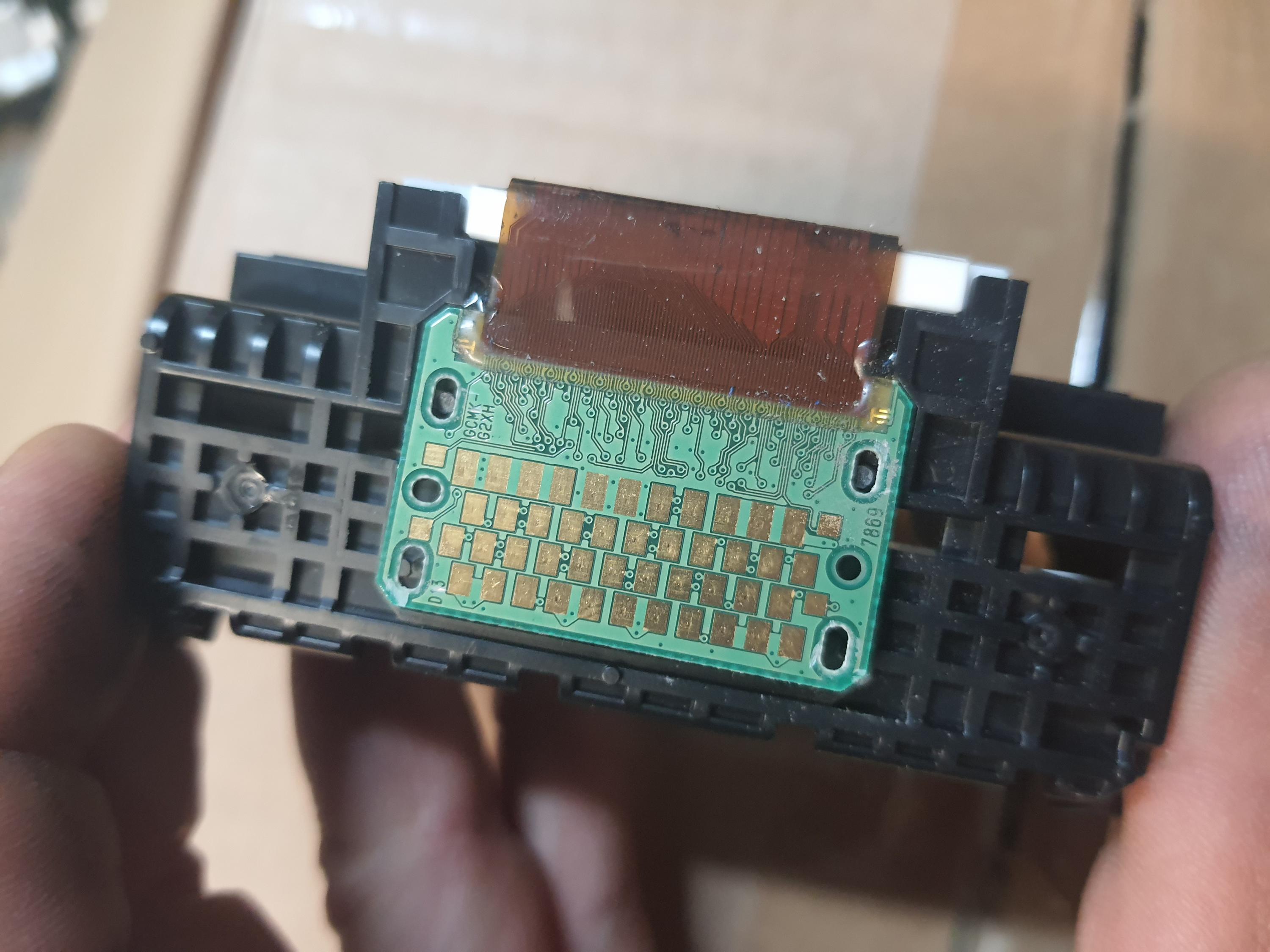

    Hi There,
    I'd like to read/write the contents of the eeprom chip.
    This is located on the print head of a Canon inkjet printer.
    It is likely that this disables the head after printing an xy copy.
    Unfortunately, I can't identify the chip, so I can't read it either.
    That is written on it: TO2 (T null? 2), KU
    Does anyone have any idea what this could be?
    Many thanks for help

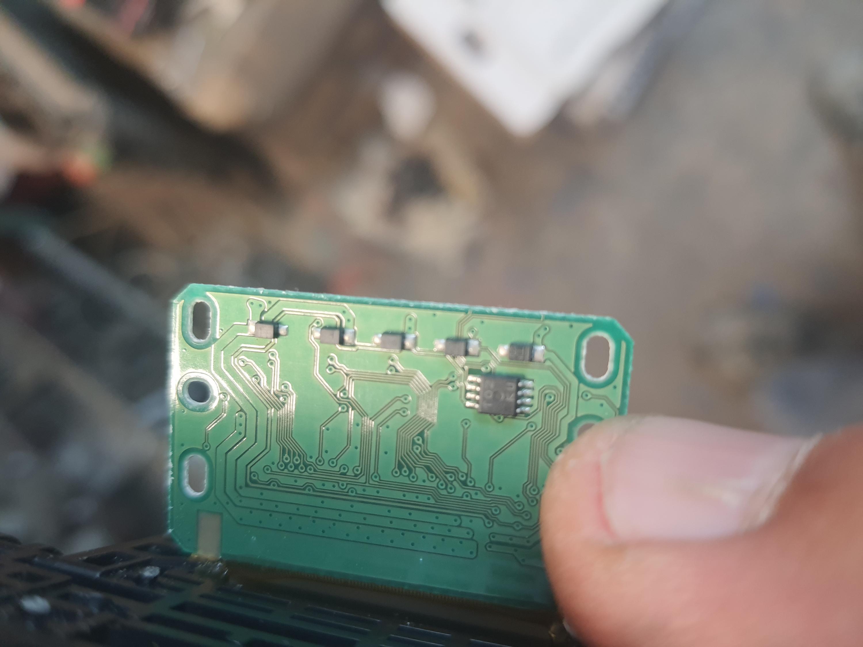

    • 30985
    Re: Canon printhead eeprom chip identification, and find pinout
    the first 4 pins grounded points to a 24c series eeprom - maybe a 24c02?
      T02 - br24t02-w-rohm

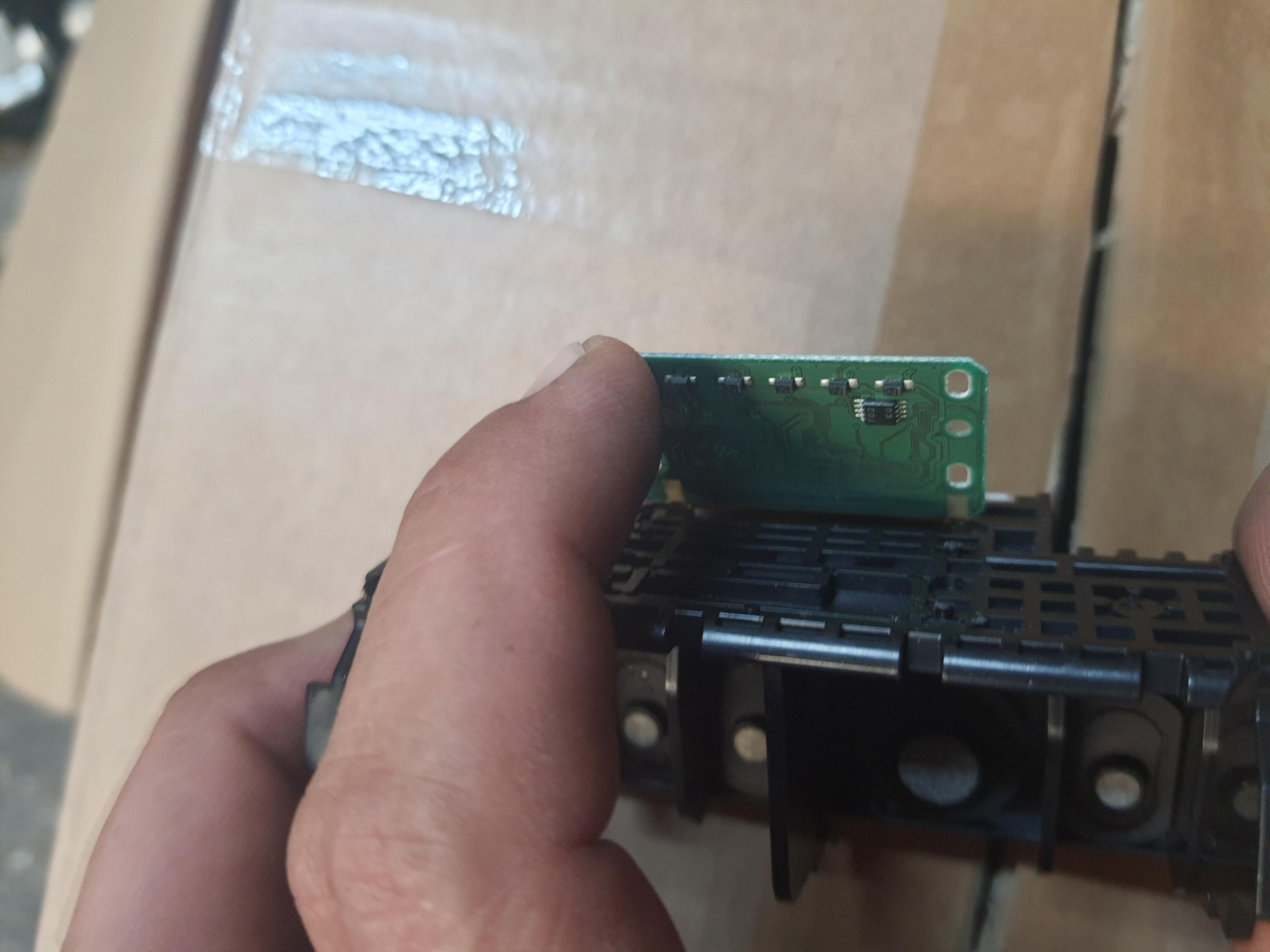

          Unfortunately, it is so small that the smd foot clips could not hold it.
          I needed to unsolder it. That's when I noticed that even my smallest adapter is too big for it.
          Do you have any ideas on how to proceed?

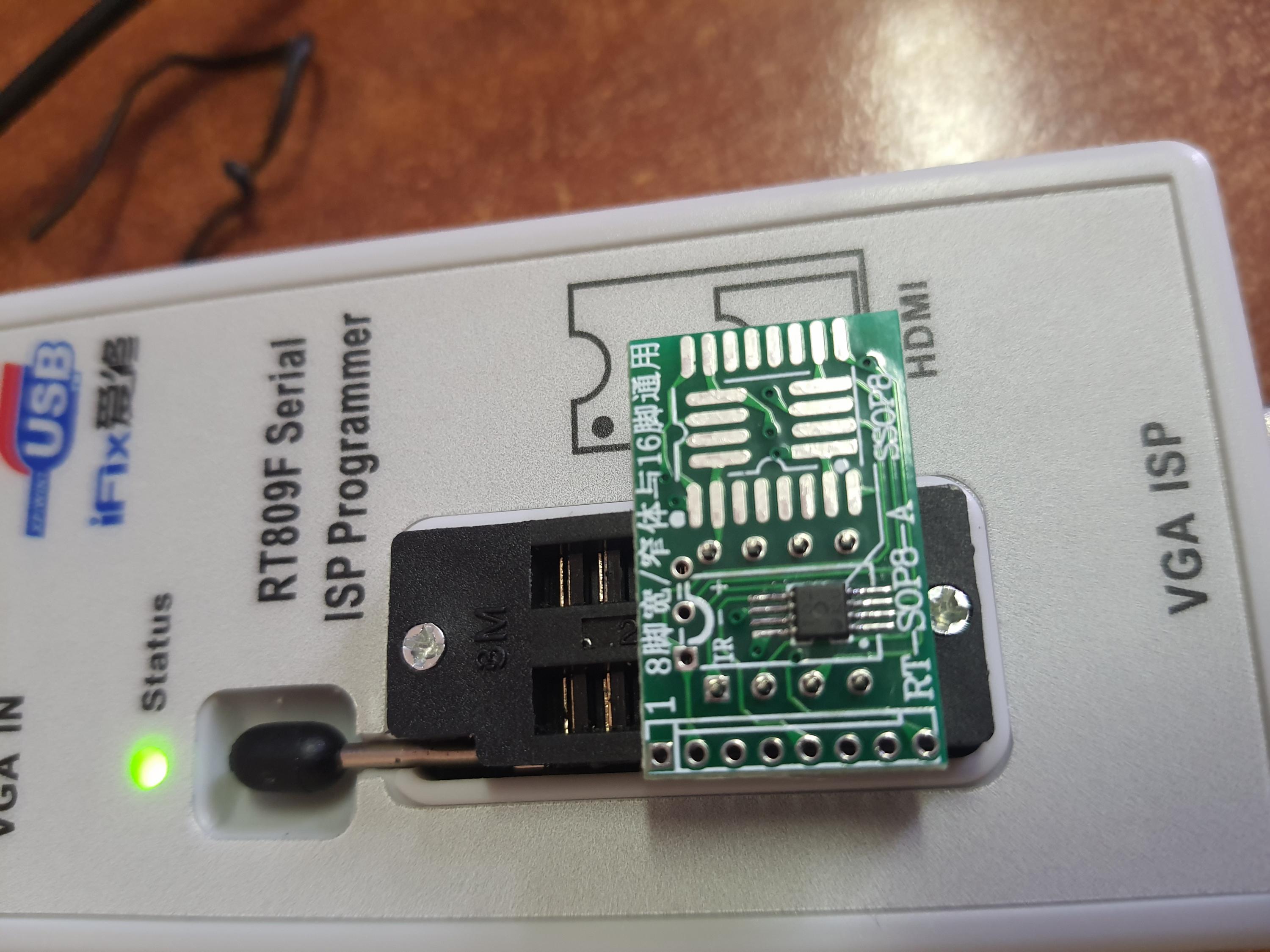

          Another question, my eprom writer is an RT809F type, can it read this type of chip? Perhaps an even smaller socket can be purchased?
            If it's too small for TSSOP, there is only MSOP8 in the datasheet that is smaller (with legs).
              According to your idea, you should have such an adapter in the kit, solder it on it and connect it to the programmer.

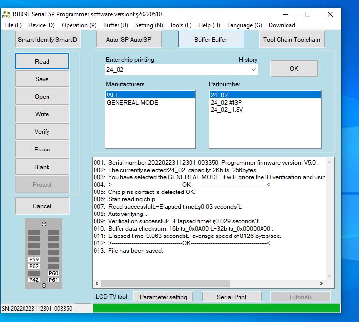

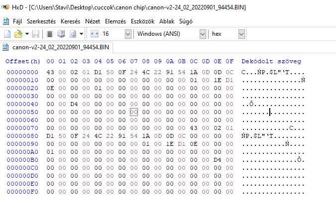

                Thanks for the tip.
                I can successfully solder it up and read it .
                Its contents should be decoded. I found a separate topic for the canon printer, I will move there in the future.

                  • Lerkor80913
                    • May 2024
                    Here are the print head EPROM data for a Canon MG 5750. The print head was functioning properly before the chip was removed.
                    PS: After re-soldering the chip, the print head still functions perfectly
